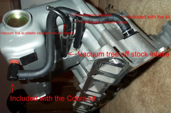

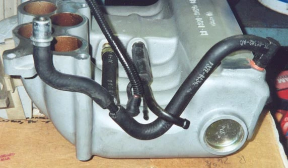

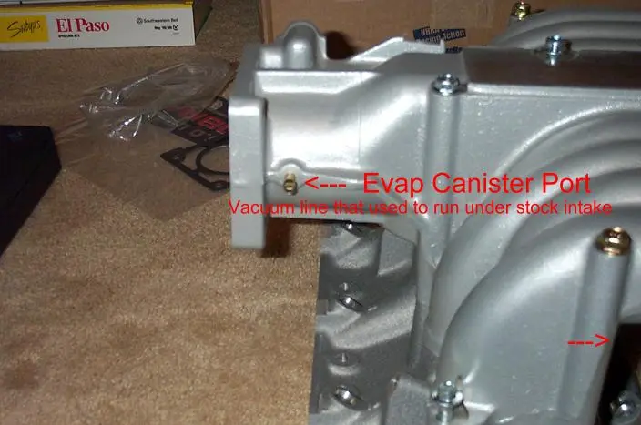

You put a cobra intake on? You don't run the coolant lines into the cobra intake. The spacer that is used with the stock intake isn't used with the cobra, you'll need to plug those coolant lines. Hopefully someone can put up a pic, but if they don't I'll try and respond back tomorrow with a pic of what I'm referring to.
Fred
Edit: I think you just have those lines mixed up. Just plug both of them.
If you hooked up the coolant line there, it's definitely the problem......

that is what i did...glad i'm stupid
so what do i do with that post then...just plug it and vaccuum all the other stuff?.....so glad i didnt start tearing it apart yet.....you guys are good...so thats probably what it didnt like to start right away every time (cause water is mixing with the fuel and stuff)?????thanks for any feedback!!!!!!!!!
