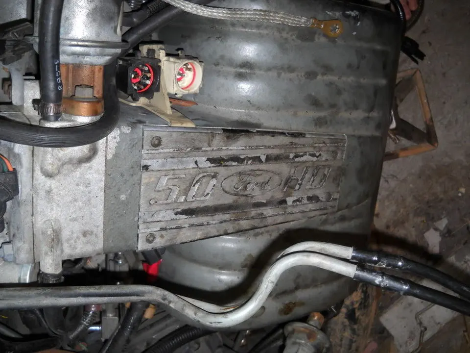

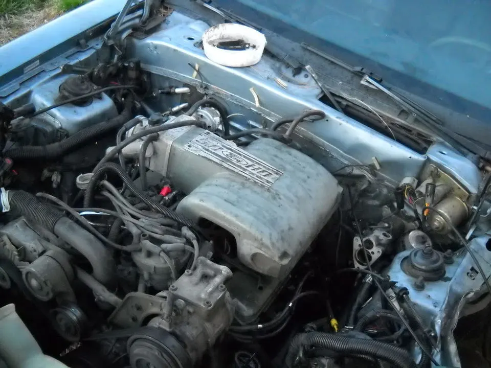

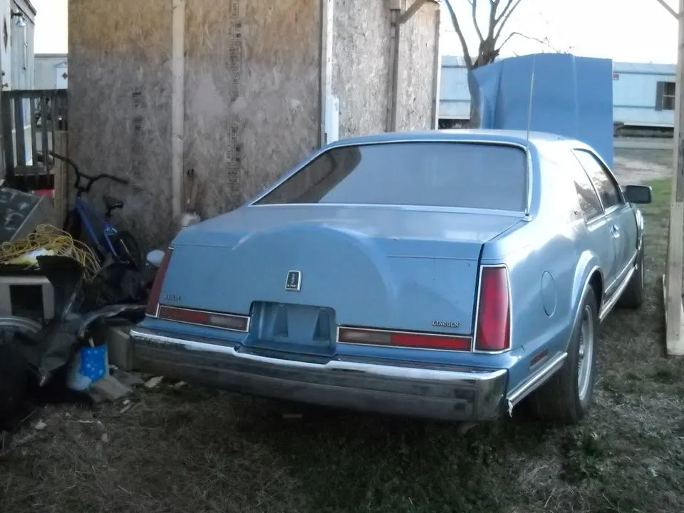

My $800 parts car im picking up Wednesday. A 1990 Lincoln Mark VII with a 5.0 HO.
I believe this car has a 8.8 rear end but it is a tad bit longer then the foxs. I think it only stick out like half a inch on each side so itll match my front SN95 5 lug spindles. I have a question about my options for a transmission though...I have a factory 4 cylinder T5 in my car right now. I know the bellhousing are different, but most people are telling me the 4cylinder family t5 wont last long behind the 5.0 so what are my options? I know the best bet is to find a t5 from a 5.0 gt but no luck with finding one in my area. I know the 94-95 5.0 t5 you have the cut either your driveshaft or either change the pilot bearing and all that, sounds like more trouble then thats worth. What other options do I have?

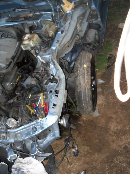

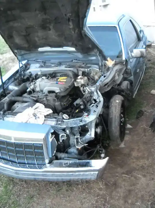

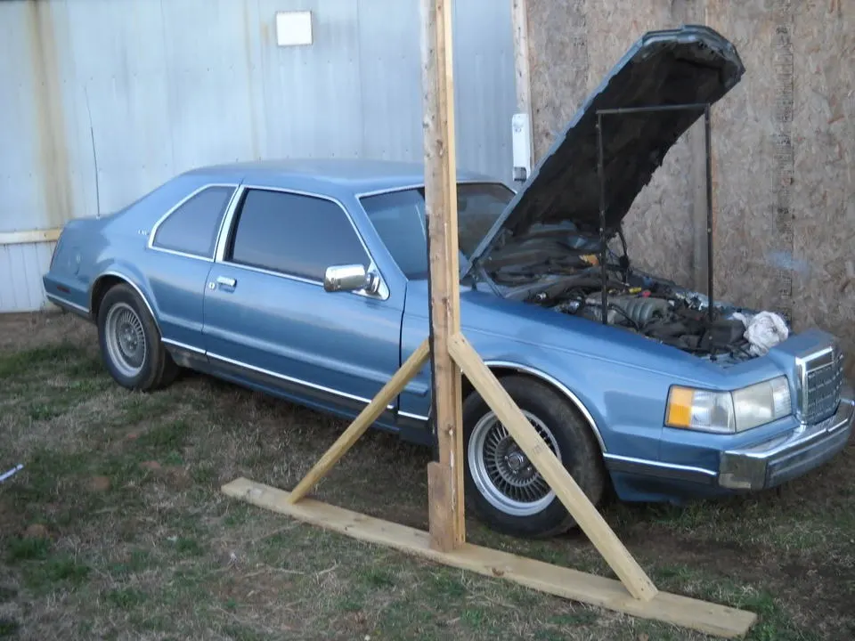

Got my swap car, 90 Lincoln Mark VII LSC 5.0 HO $700 105k miles

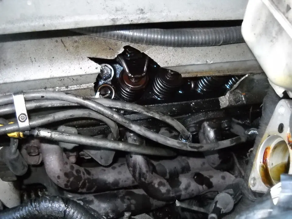

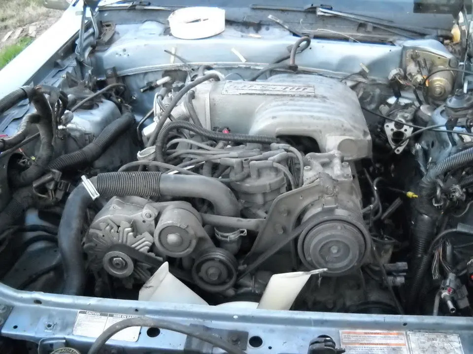

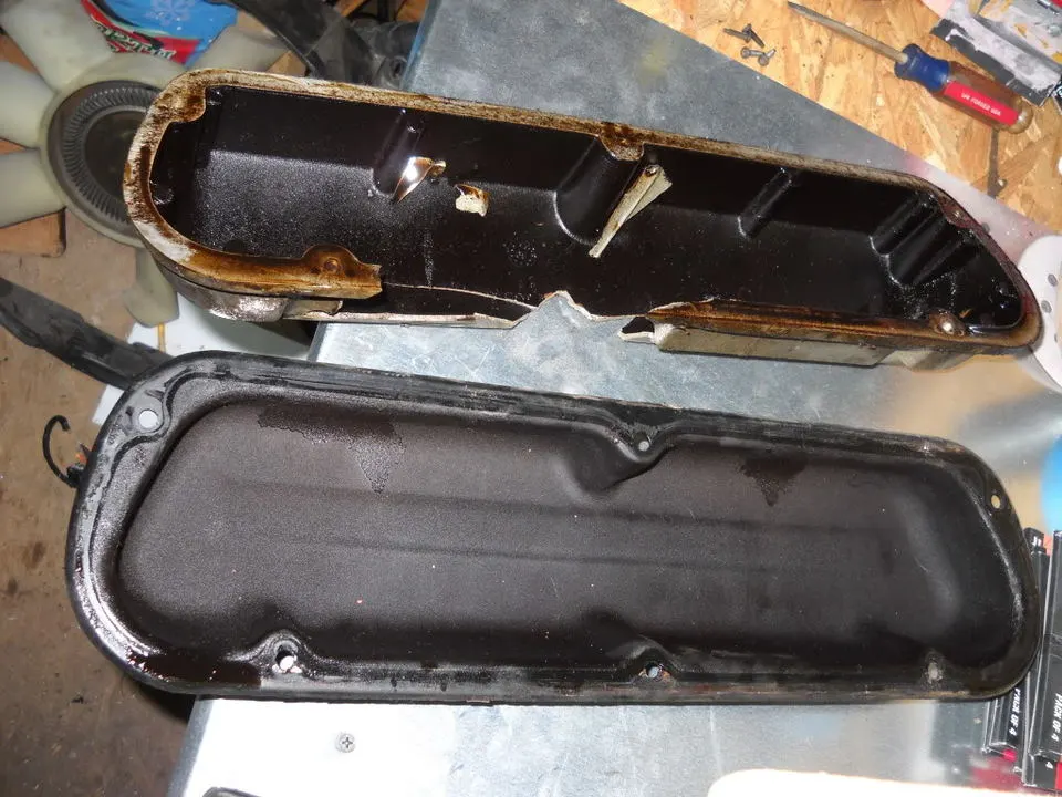

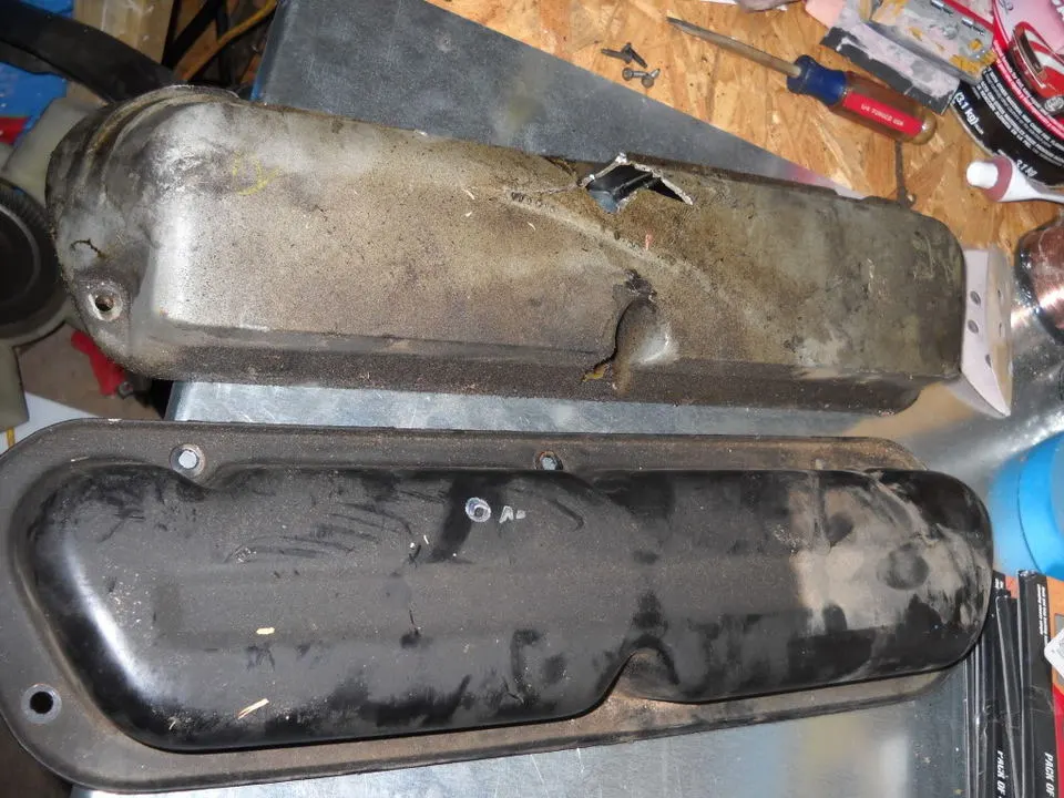

Bought it got it home backed it up to where it sits now and let it run for about 5 mins. Started smoking, thought it was just the busted brake booster leaking on the headers, i was wrong :( Busted valve cover.
I haven't read this post in a bit-please tell me you're planning on pirating the suspension and driveline parts too. You'll get all kinds good stuff outta that car. Valve covers are cheap and available just about everywhere.

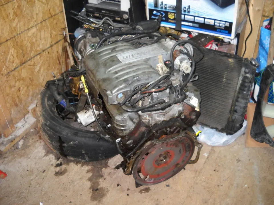

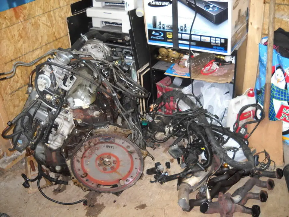

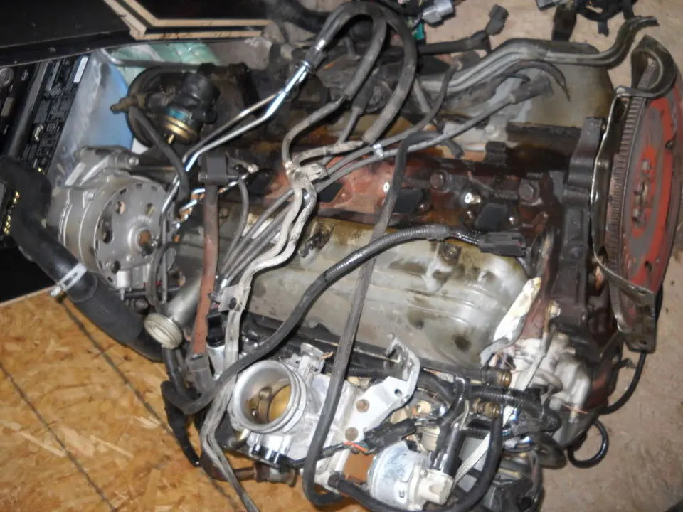

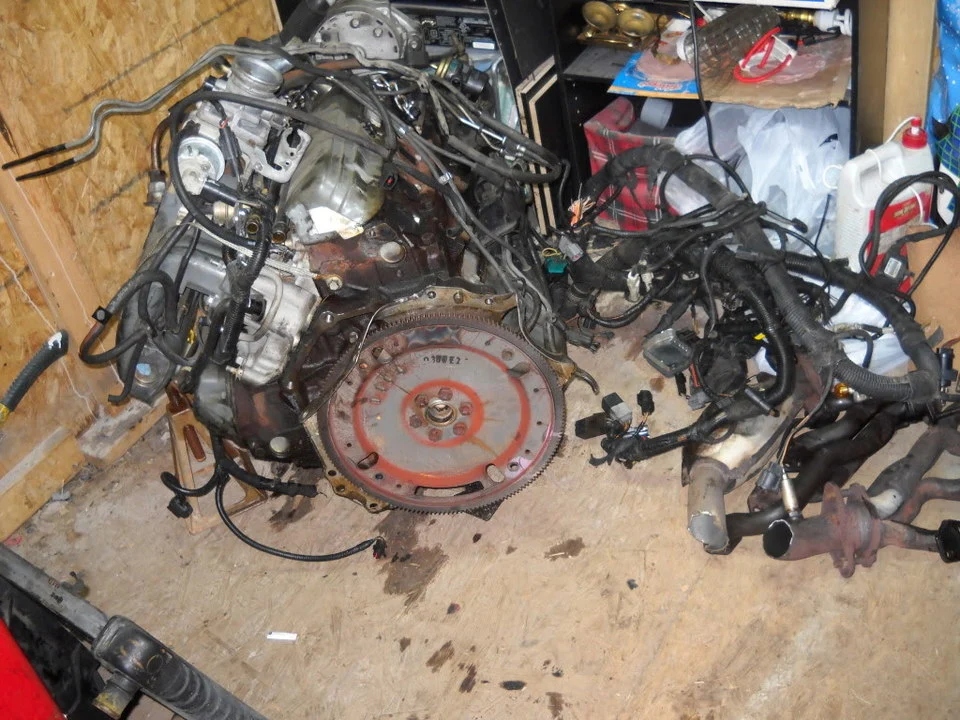

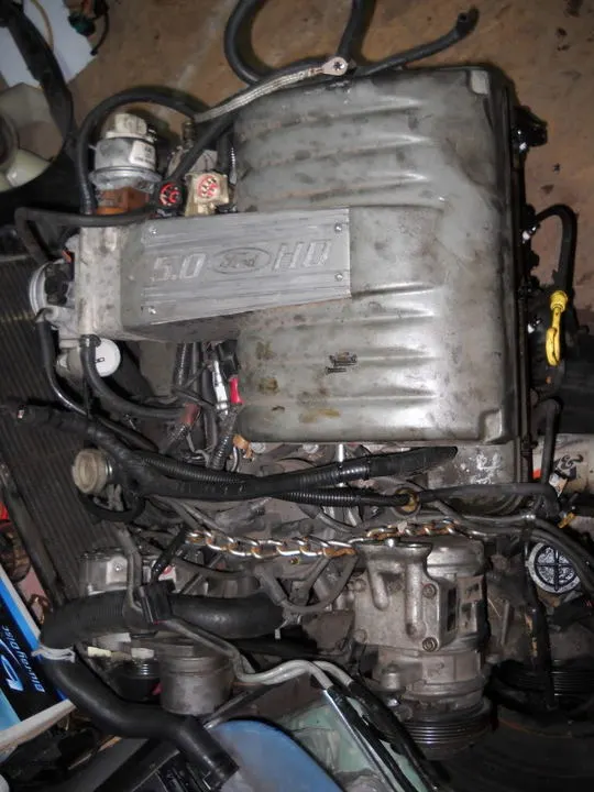

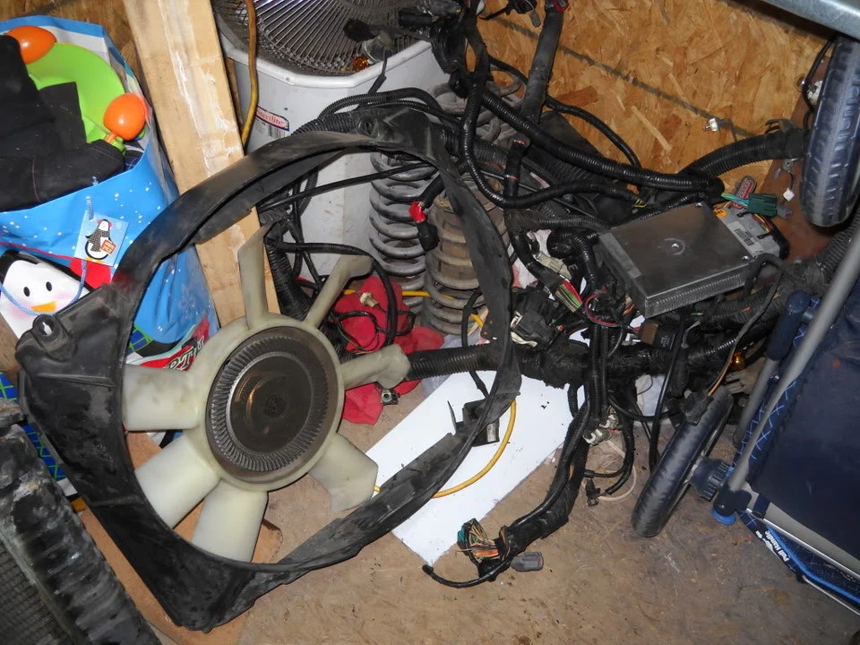

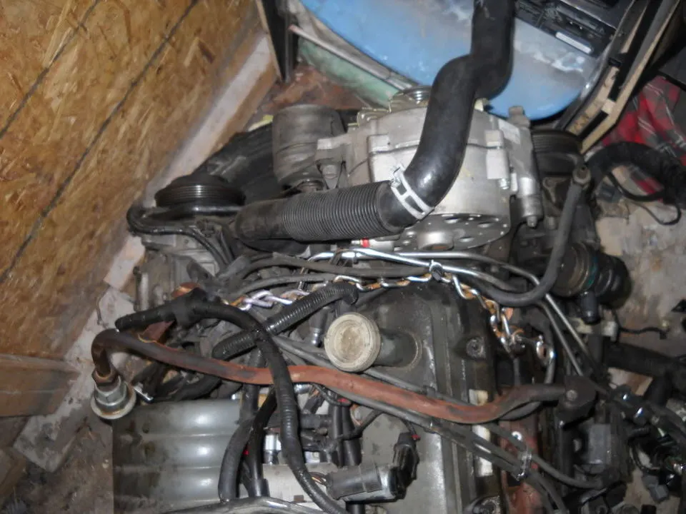

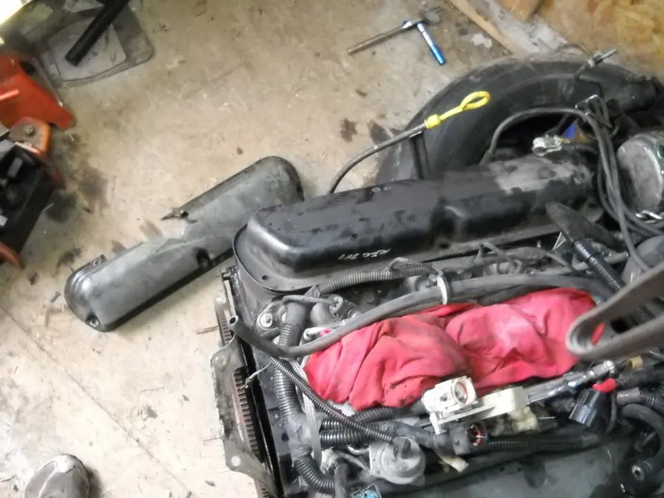

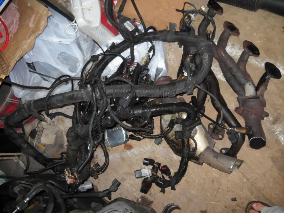

What I got done today. Not bad for just me working alone for a couple hours, got the computer out, passenger side wiring harness out, motors completely unbolted from transmission and k member. Its just chilling there till I pull it out tomorrow :) Took about 50 pics of wires just so ill remember where they went lol

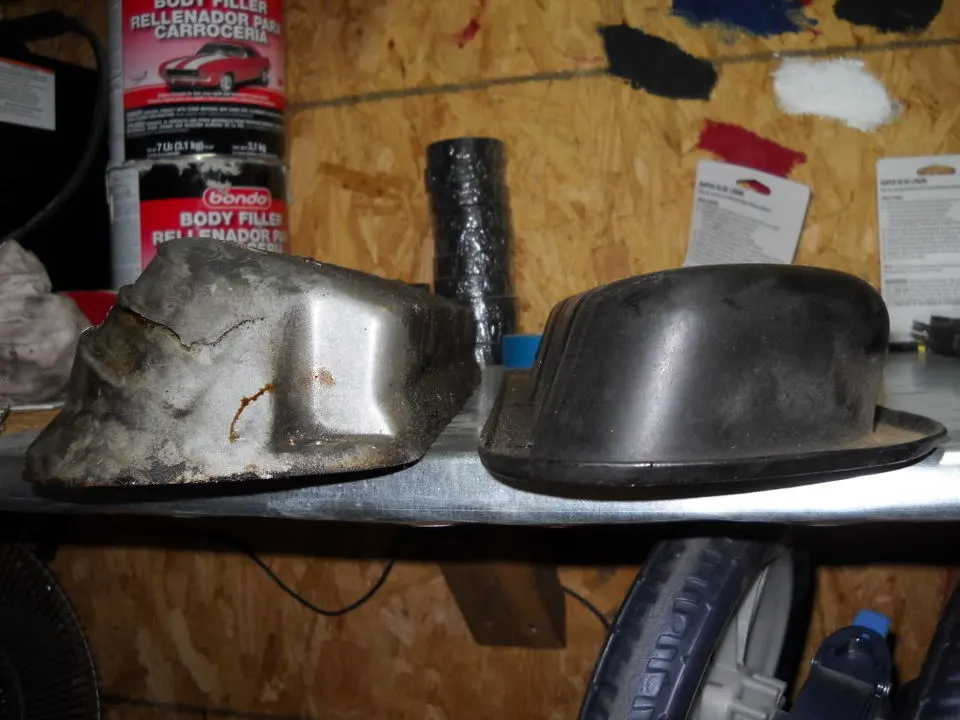

Went to lkq in search for a valve cover. Came back with
$10
I already have one of these on my car $10
Not bad for $30, better then the $180 price on ebay

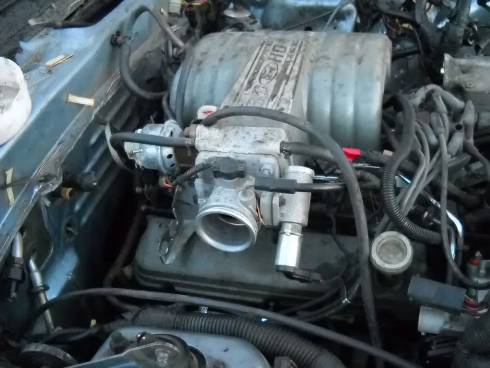

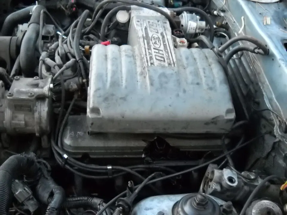

Im worried about the valve cover clearance tho...
Mine are like bigger thicker aluminum and the ones i got off the v8 thunderbird are smaller thinner steel i believe, there not as deep as the aluminum ones and im worried about the rockerarms hitting...they fit with no problem tho...
