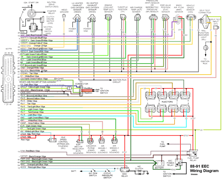

The 89 Mustang 5.0 harness if you want a used harness.
Ford Racing has an aftermarket harness if you want to shell out $500.
Here's website with lots of wiring help.
Diagrams courtesy of Tmoss & Stang&2birds
See the following website for some help from Tmoss (diagram designer) & Stang&2Birds (website host) for help on 88-95 wiring Mustang FAQ - Wiring & Engine Info Everyone should bookmark this site.
Complete computer, actuator & sensor wiring diagram for 91-93 Mass Air Mustangs
