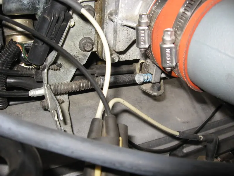

Can you rotate the throttle all the way open by hand WITH the throttle cable hooked up? I don't really know what to suggest... I took a picture of my stock throttle setup in case that helps somehow. Pics not great since there's not a lot of room in there.
There is definitely no adjustment on a stock throttle cable.
Jeff
