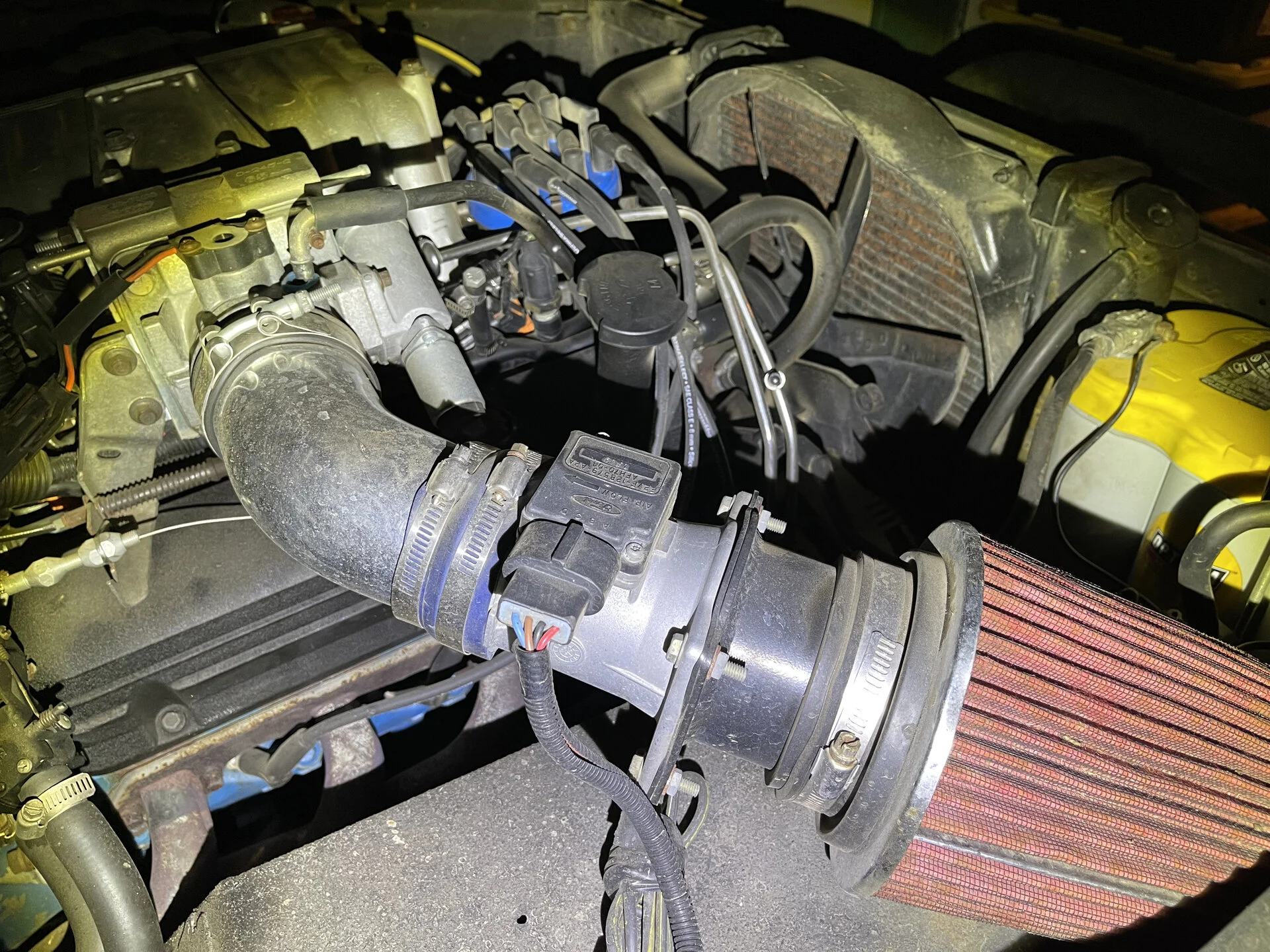

- The MAF housing is from a 93 fox body. It is 70mm.
- I am using the 94-95 MAF sensor which I understand to be comparable with 19lb injectors. The part number is F2VF-12B579-A2A
Is this a 1993 cobra MAF housing? The standard 93 maf housing was 55mm. Do you have a pic to confirm?
Those electronics will work fine in the 1993 cobra MAF housing which is the same as the 91-93 thunderbird MAF housing. I run this combo and it should work fine.
But we should conform you do have the correct housing as those electronics in a 55mm housing would cause you to run lean.
How do you know you are rich at idle / lean at 3000 RPM?
I agree with Mustang5L5, that the A9L is looking for a 55mm MAF. 70mm MAF without some sort of calibration factor will give the ECM a reading of less air than actually going into the engine (will give lean condition). Increasing fuel pressure could help to a point (depends what current setting is).

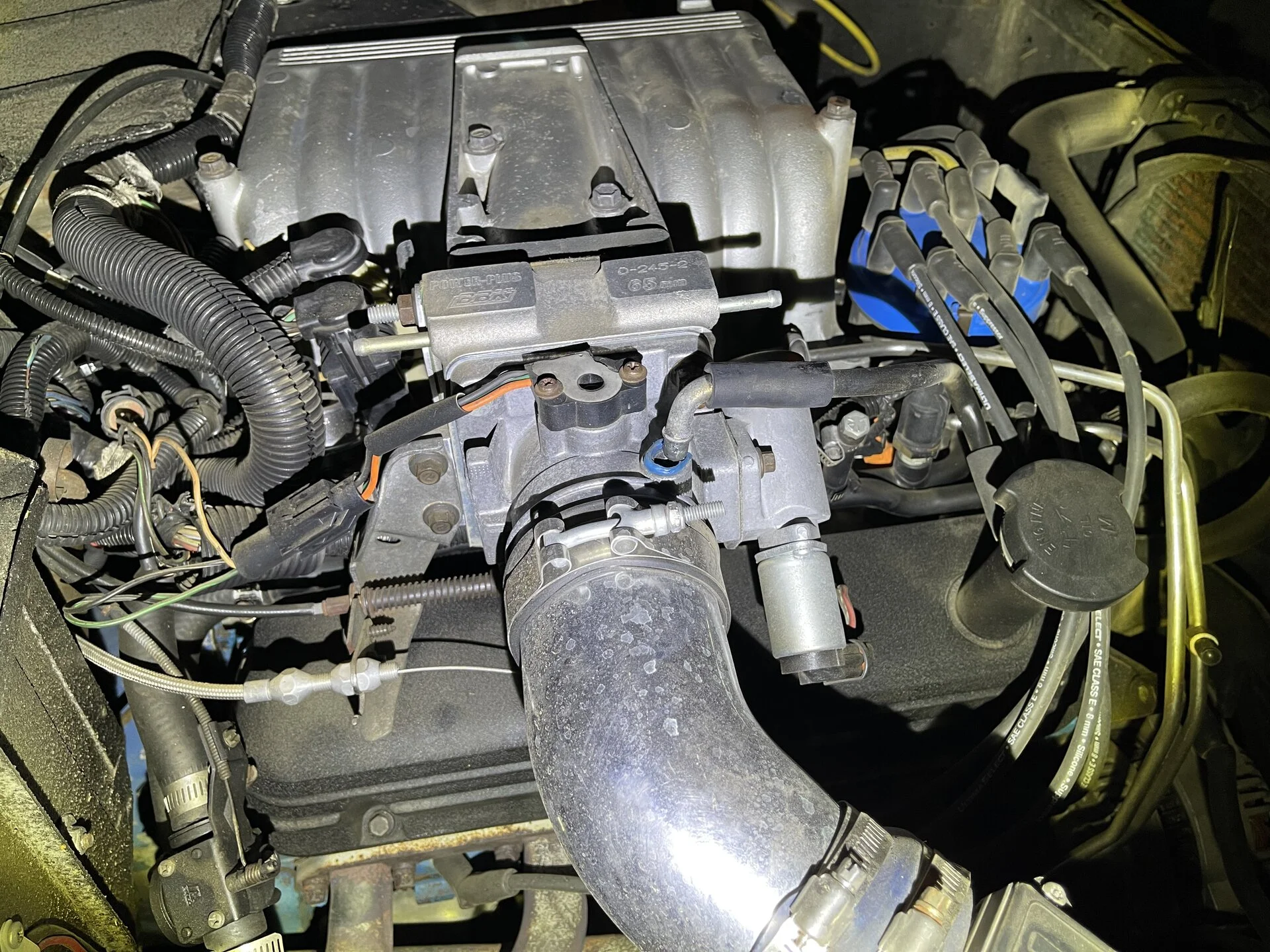

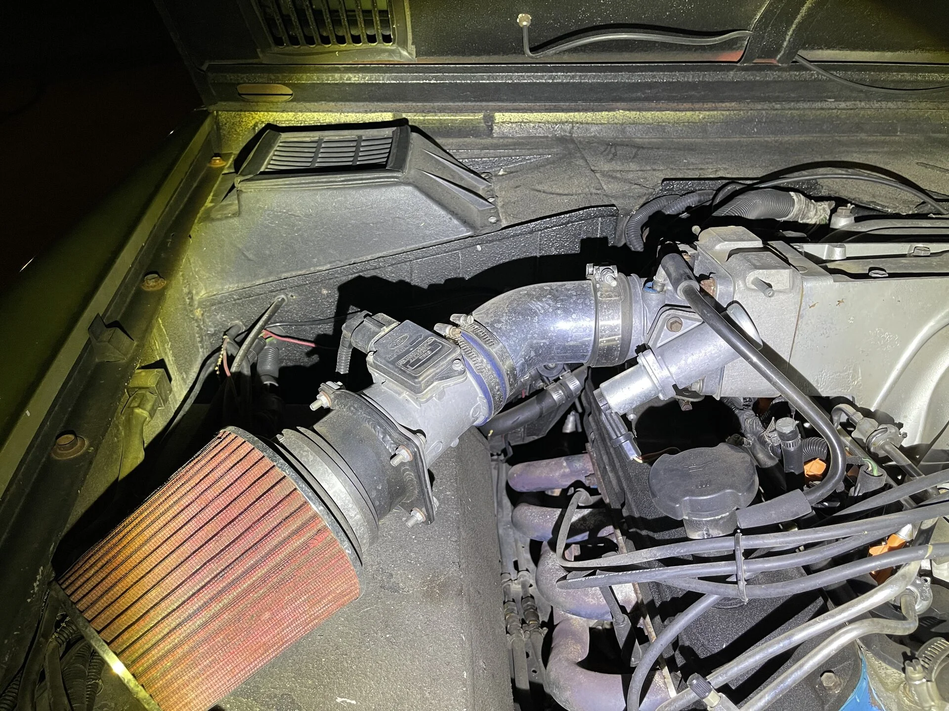

I never got any emails about posts so I’m playing catch-up. Posted photos. The mass air is 70mm and the intake is 65mm from explorer. Sounds like I put the wrong year for the MAF. I’ll see if I can’t track down the source again, but photos uploaded. Thanks!
