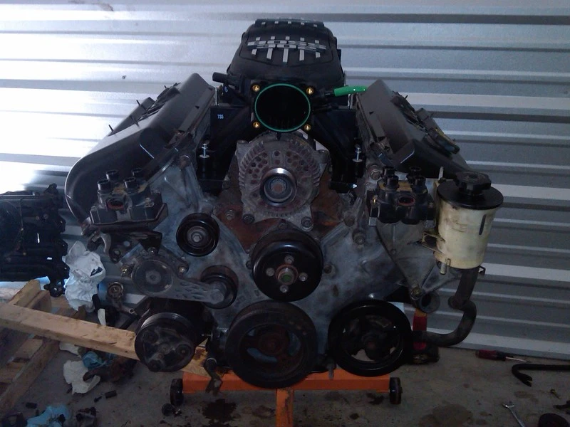

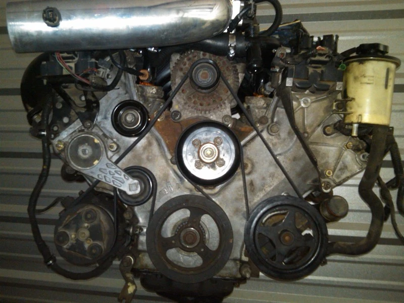

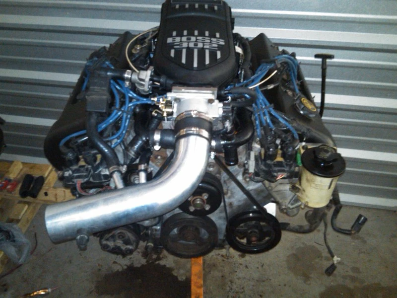

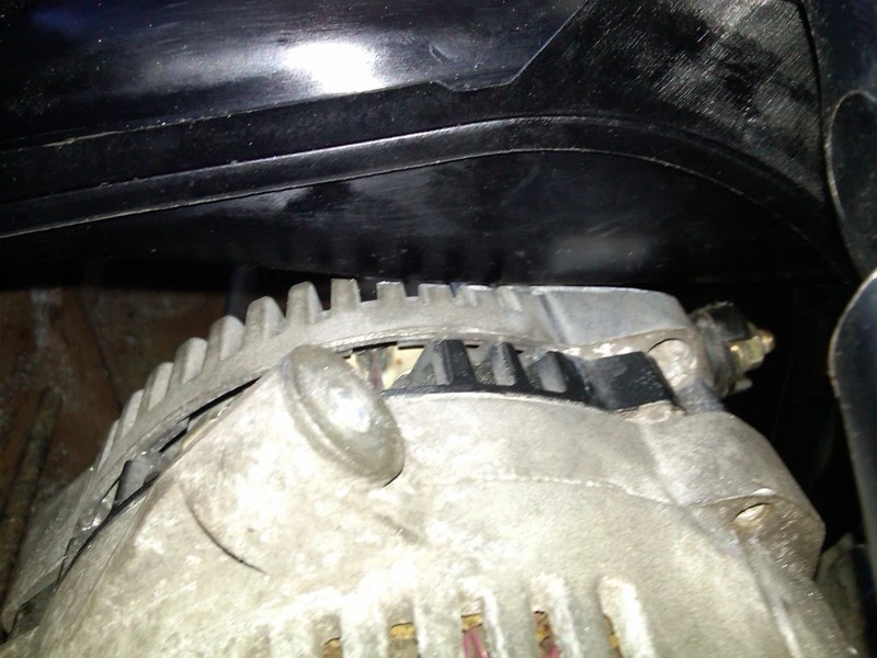

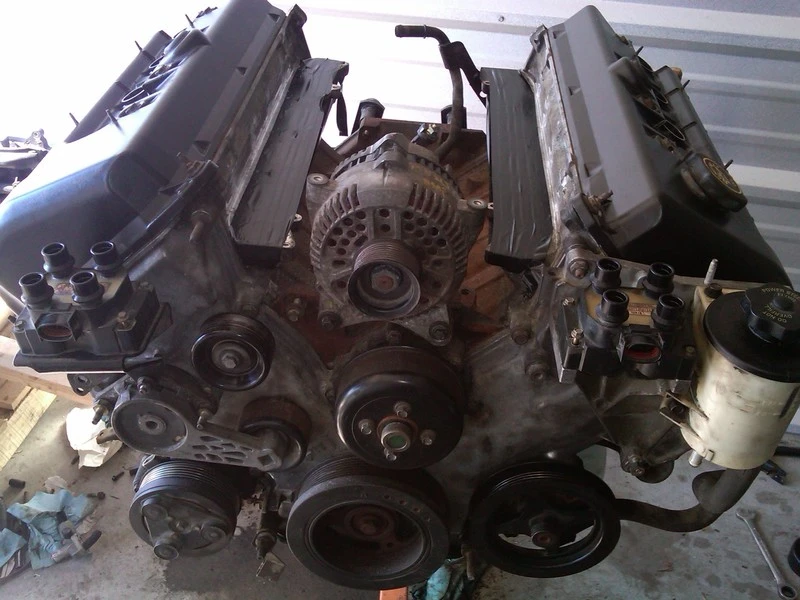

long due update-
started my hectic schedule of school and work a couple weeks ago so im starting to adjust: work at 11pm-730am and school at 810am-3pm monday through saturday morning!

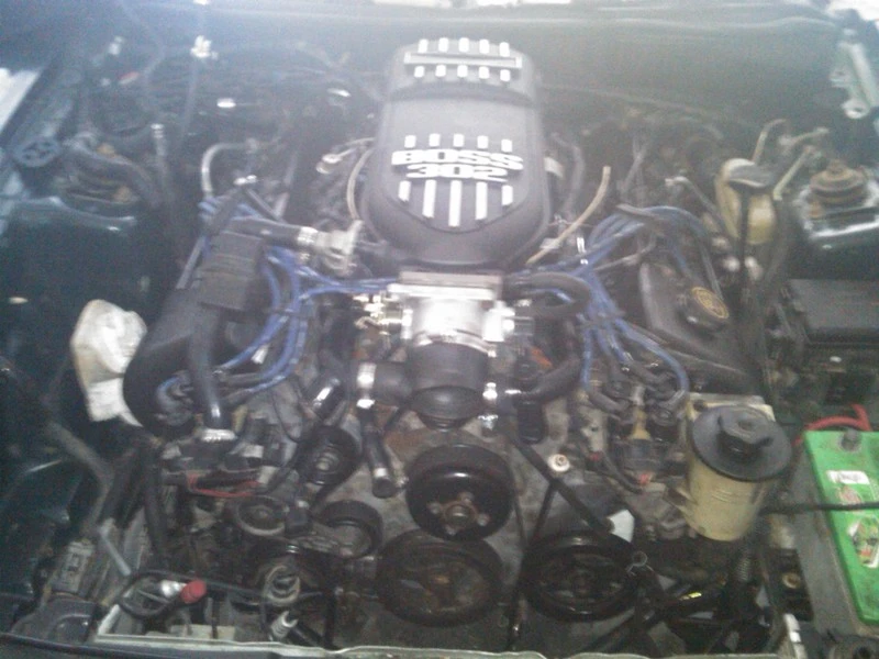

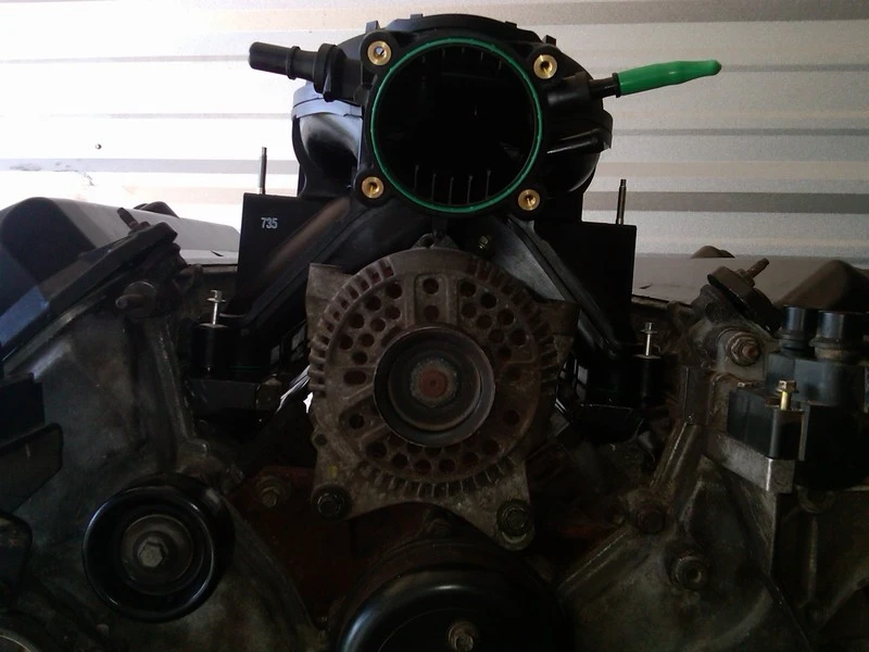

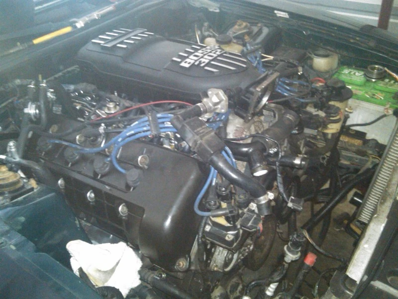

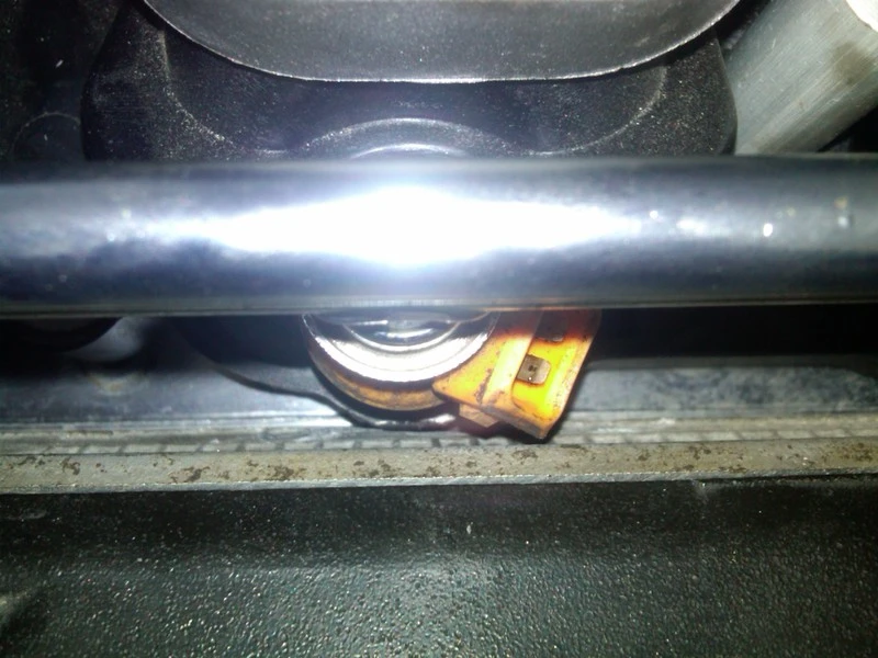

i found a way to mount my coil packs and the power steering. i swapped out the COP valve covers for the 1998 cobra valve covers for my spark plug wires. my plug wires came in and they are Ford Racing blue wires. they fit great. also my brand new Boss 302 intake manifold came in from Canada last week. the plastic around the intake ports and injectors are about a quarter of an in thicker than the coyote intake manifold. i already got the coyote intake to fully bolt down great, so with a little bit of sanding my new intake and smoothing out where i ground some aluminum off the heads, i got the Boss intake to fully bolt down and fully seal. it looks great so far. when i first put the intake on it hit the back of the alternator so i ground away and took off 1/8"-1/4" and i drilled a new lower mounting hole about 1/2" above the original location lowering the alternator a bit. the intake is now clearing the alternator by 1/32". today the hardware store was closed so i couldnt get the bolts and screws i need to mount my throttle body via adapter plate or spacer which is 1/4" steel and all 8 holes are drilled and tapped. will take care of that tom. i also installed the navi fuel rails and my 30# Bosch injectors and new fuel lines. the original fuel lines that connect the fuel rails arent wide enough for the coyote intake but might be for the Boss intake. so far all accessories are bolted down, fuel system is all ready besides installing my new Walbro 255 fuel pump, coil packs and wires are mounted with new valve covers. new polyurethane motor mounts are also installed. tomorrow and the rest of this week calls for swapping the 8 rib navi crank pulley for my 6 rib, installing all the sensors and engine wiring harness and altering it to fit, dont have much to extend. also install cobra 11" aluminum flywheel and Valeo 03-04 clutch kit including pilot and throwout bearing. there are a few more odds and ends but will update when i get there. now for a few pics
tight fit of injectors (maybe 1/16")
new valve covers and all accessories on and coil packs mounted
intake/alternator clearance (hard to get better pic)
notice the alt bolt adjustment
what do you guys think??
HOW IS IT LOOKING???

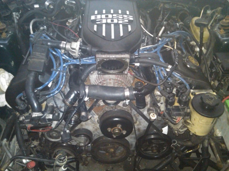

it fired up and drove home last night. ive got to say wow a huge difference from my pretty much stock 2v to the new motor. i only drove it for about a mile because of legal reasons (no hood, expired tags, oh and open headers ). i am not 100% finished but everything is working great so far. all thats left is a new hose and clamps for the thermostat housing, a throttle body spacer, throttle cable and a new way to route my cold air intake. the coolant overflow tank is right in the way of the intake hose along with the radiator hose. i think i can just get some flexible radiator hose and lengthen it a bit to get it out of the way. i dont know what i can use for my intake tube because it has to avoid the tank and i would like to get the air filter in the factory location or in the fenderwell so i can get a cowl hood to fit. its sitting right inside the top of the front fender right where the hood closes. i will upload pics later to illustrate better. im on the last couple of steps to making this my everyday driver. WOOOHOOOOO!!
98stanggt22
Oct 10, 2011
65
Illinois
Oct 2, 2012
#36
  • Oct 2, 2012
  • #36

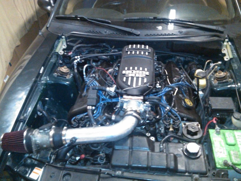

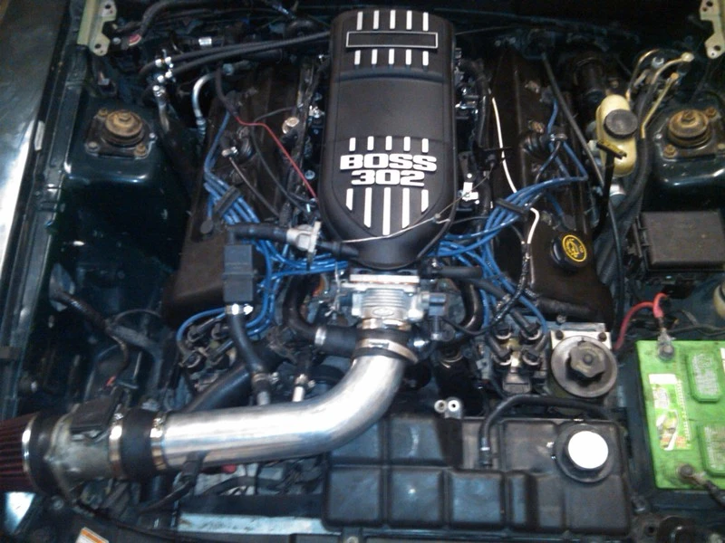

update-
before i put in my car
one view of the engine in the car
another view
another...
here it is after i drove it and dont make fun of my last minute life saving throttle cable haha idk let me hear it and yes that is what it is
one more for now
so what do you guys think?? how does it look so far. it will be cleaned up a bit more when 100% completed. thanks for looking

looks great so far
how about a flexible intake tube like people have used for the 3V conversions. Or getting one of the aluminum expansion tanks and cutting off a corner of it?

+1, I would get an aluminum tank and chop it up and have it tig'd back together
