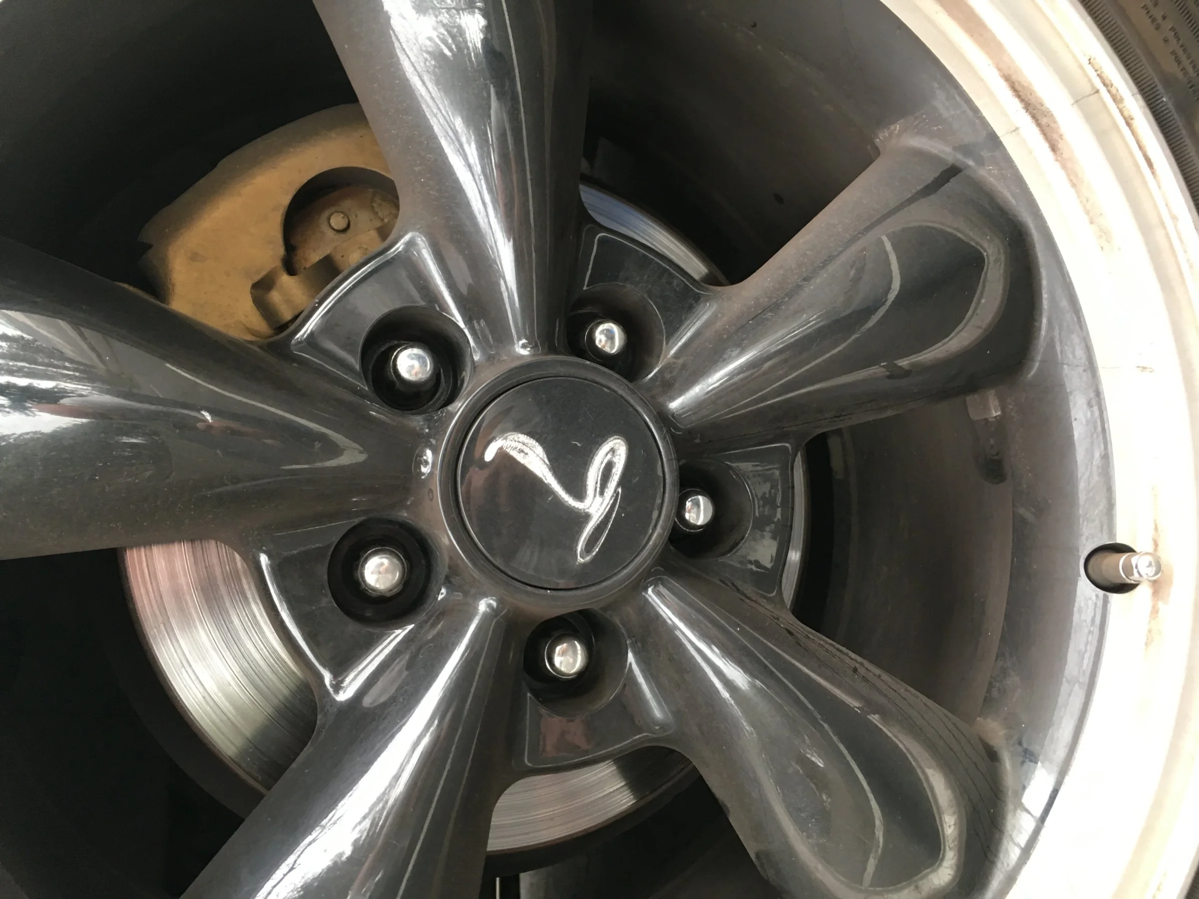

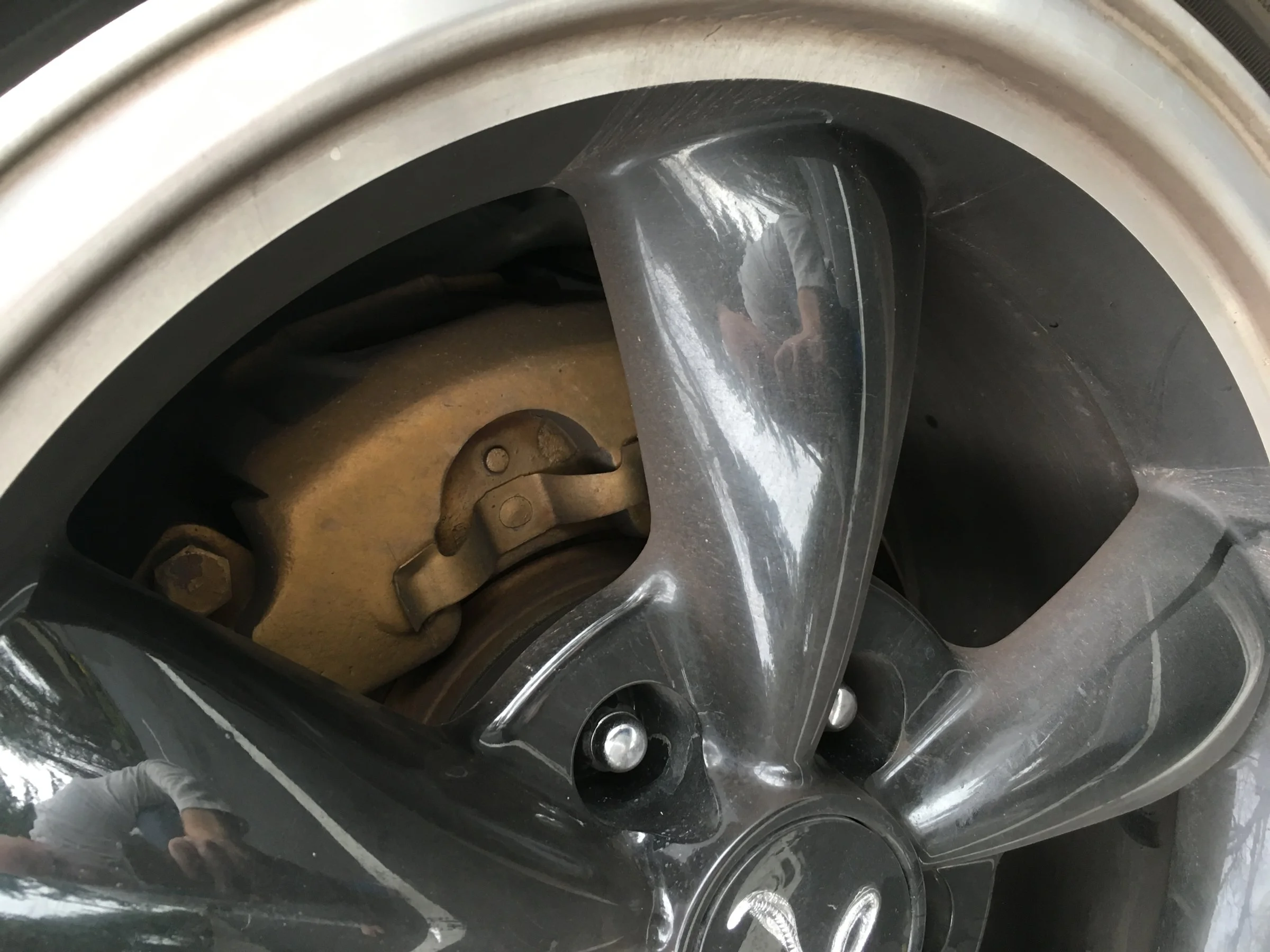

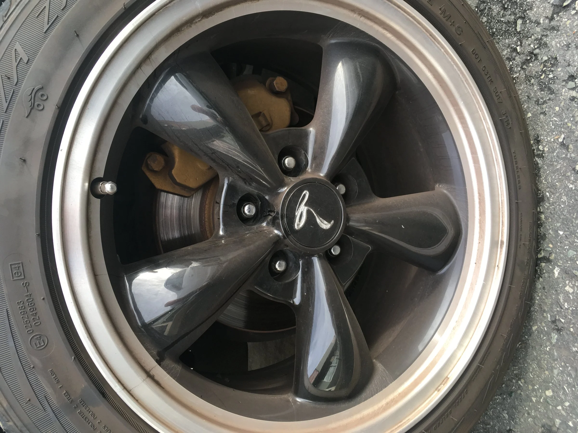

Need pics of the front brakes to ID them. There are differences so you can't just use any rotors.
I'm gonna bet they are actually just the 5-lug conversion rotors which are 84-86 SVO 5-lug rotors, with stock calipers. Need a pic to confirm
Without taking the tire off that's what they look like. Let me know if you can't tell and I will take the tire off.

Yup. Just 5-lug conversion rotors. If they are 10.8" in diameter they are 84/86 SVO rotors. Assuming your car is an original V8 car, this is what they would be.
Brake pads would just be original fox stock pads.

84-86 SVO or 84-92 Lincoln mark 7 front rotors are what you have
