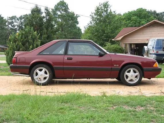

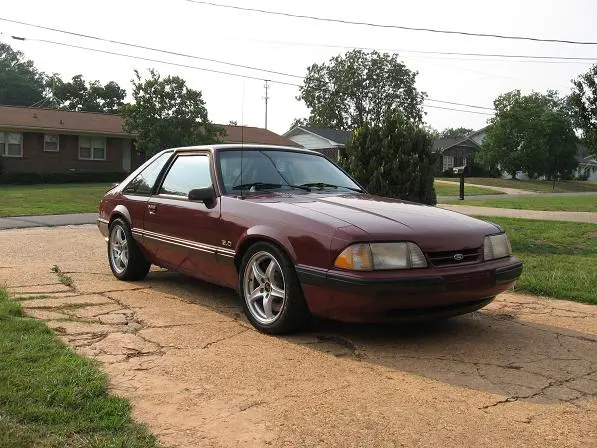

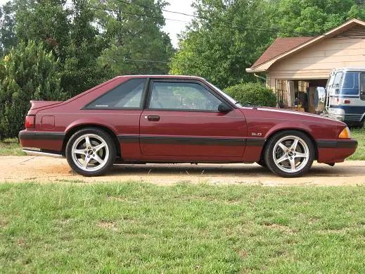

Finished up my five lug, cobra brake swap. Also installed Eibach Pro's and MM Rear lower control arms.
Though I'd show everyone the before and after.

Thanks for the comments. I was on the fence for the longest time. Didn't know whether to buy a new car or build this one. You can see what choice I made.:D

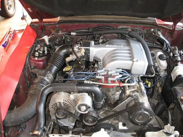

Can't wait to get new track times after intake install. When removing the stock intake I discovered the dist bolt was loose.:eek: Timing was around 8 BTDC. Hoping to run btw 8.5 and 8.7 in the 1/8 on street tires.

How does it run now? I have a 70mm T-body and EGR Spacer. I was thinking of installing it, along with some sort of intake, but honestly, I want to keep my notchback stock as possible...(engine wise) I don't mind my current mods, as I have all my old parts.

P.S. In case anyone is wondering. The fronts have no isolators at the bottom of the spring. The rears have both isolators. Those pics are after 2 weeks of driving. So everything is nice a settled.

It runs very strong now. This Thursday I'll have track times. Hoping to run 8.5 - 8.7 at about 84 mph on street tires. It ran 8.8 with the timing at 8 BTDC with the stock intake and TB. After the swap its a whole lot faster.

That's good. What did you set your TPS sensor at?
