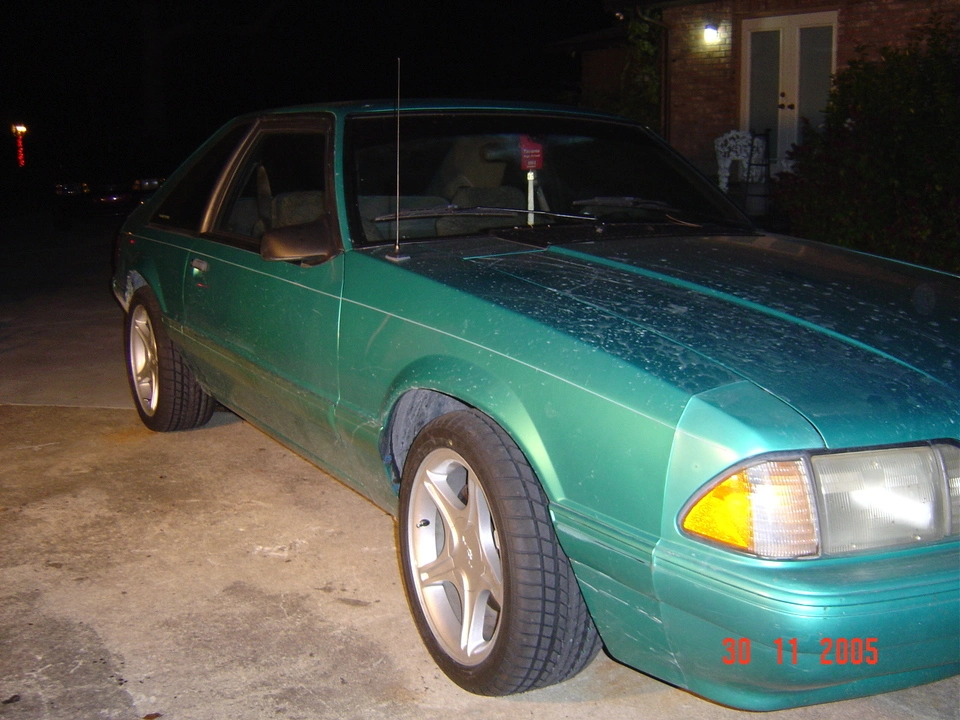

You can use 96 and up spindles,but they will leave the wheel outside the fender. L
ook at how my front wheel is outside of the fender...

Same with the 8 inch. I had a set of stock 98 Gt wheels and they noticably stuck out the fender..I will change to 94/95 spindle when I find some..If you just want to do the swap get the 96-up and change later...
