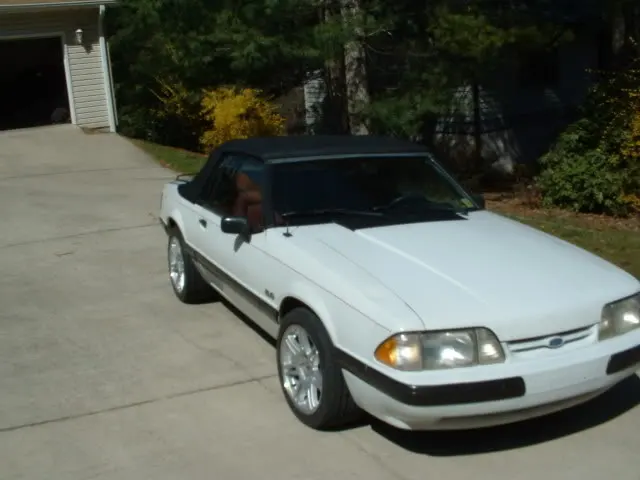

The first pic shows the 98 spindle and how much the wheel sticks out from the fender with a 9" wide wheel.

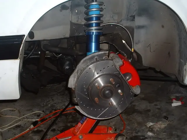

The second shows the 98 6cyl spindle,brakes,and coil overs. I also bought the Maximum Motorsports braided brake hose ($80). It has the proper fittings to adapt the fox brakes to the SN 95 caliper. If you are creative you can get fittings to fit the SN95 caliper for less$$$. I like the Braided lines and the ease of application...
