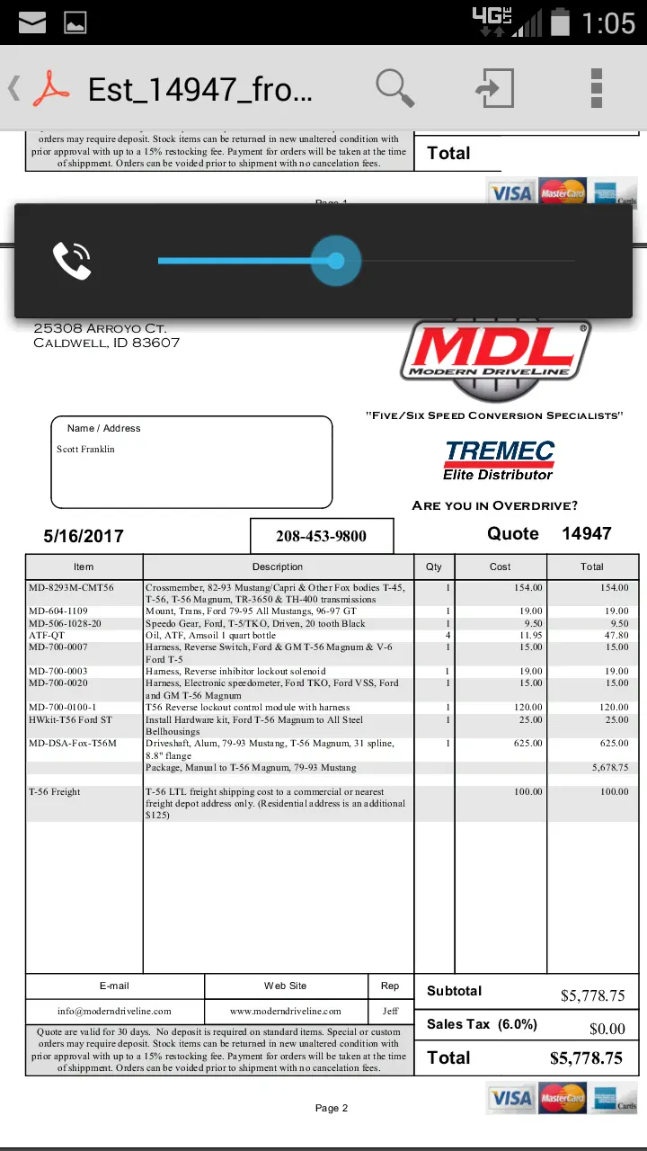

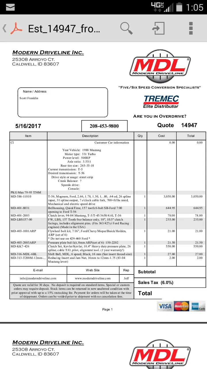

A basic decent mechanically inclined person can install the swap....here's the swap list I was quoted....
It is 5778...not 7k....smh. Might as well be 7k to me...smh
