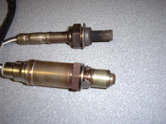

We'll I bought 4 new Bosch 02 sensors, all of the stock ones look pretty fouled from carbon. The OEM 02 sensors are made by NTK and look pretty cheap compared to the new Bosch ones. Hopefully I won't have to mess with these for at least 100K.
Looks like I answered my own question. 52K had taken its toll on these. Did they still work yeah, but probably not at peak efficiency. Don't wanna chance my new cats on the x-pipe to crappy old sensors that were probably living on borrowed time anyways.
They are a lot cheaper at oxygensensors.com ($41) compared to the various autoparts stores ($59 NAPA to $65 O'reilly). You can also get the splice in type for a few bucks cheaper, but I opted to get the OE plug-n-play style.
The Bosch 02 sensors are a quality sensor. Preventative maintenance is key, and you are on the right track and wise for doing this.
