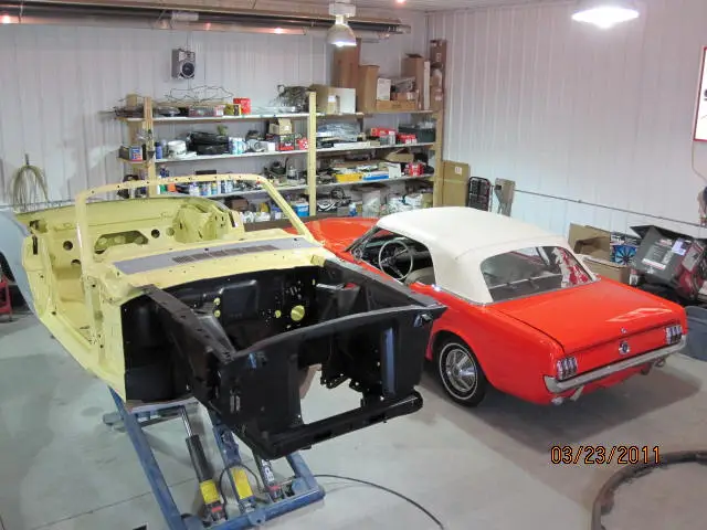

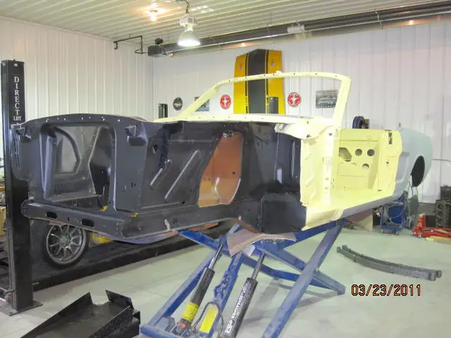

Hello,
My dad is restoring a 64.5 convertible and it is primed and ready for paint. He is wondering what color the inside of the fenders were painted in the factory, is it body color or a black? Thanks in advance.
Here are some pics of the restoration...
Hello,
Hi,
From my research, they were body color. the inner aprons (wheel wells), mud shields, were black. Do re-check that rad support. The early cars had a unique front support with vents on the battery side.
Nice setup,you've got there.
