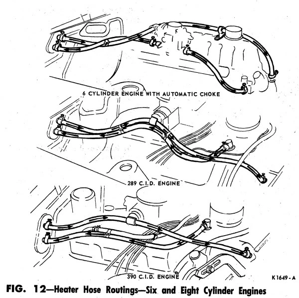

T TeamEntity New Member May 4, 2005 130 1 0 Jun 10, 2010 #1 Jun 10, 2010 #1 how does the heater hoses route to the heater core? The one off the manifold were, and the one of the water pump, were. I'm looking for the top or bottom hole for the heater core. Thanks.
2 2+2GT 10 Year Member Apr 25, 2009 3,333 10 79 Southeastern Pennsylvania Jun 10, 2010 #2 Jun 10, 2010 #2
Az Pete 10 Year Member Mar 30, 2005 711 18 49 Panama City, Fl. Jun 10, 2010 #3 Jun 10, 2010 #3 I have always run the intake manifold one to the lower, the water pump hose to the top.
