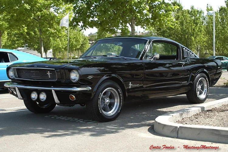

Hello-
I'm looking to add center driving/fog lights to the front of my 65 fastback. While I'm not too sure if I would like them above or below the bumper, I would like to place them together in the center. I ran across these on Ebay, but im not too sure how the quality is. Do any of you have ideas or options that you would recommend for this kind of setup?
Thanks in advance...
http://cgi.ebay.com/ebaymotors/ws/eBayISAPI.dll?ViewItem&item=230011294353

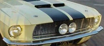

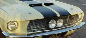

i was thinking something like this...
or like this...

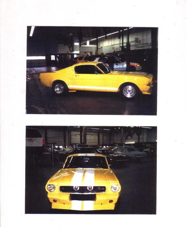

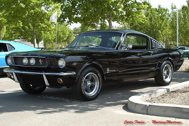

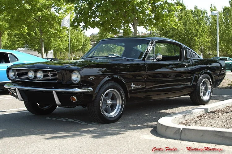

I made my own. I relocated the horns slightly to the outside, mounted a piece of angle iron and put the lights behind the grill.
I can't remember the brand I used but I specifically measured the depth of the light so it will fit behind the grill
I love them
I love them
I'm not considering mounting driving lights, but I like the solution you came up with. Looks right:nice:
Dave
