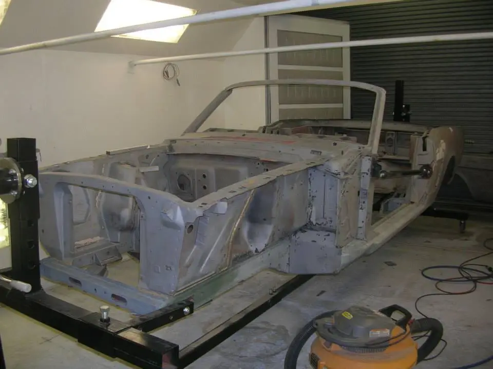

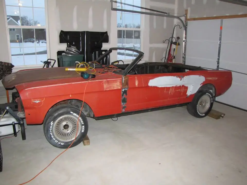

In the beginning!

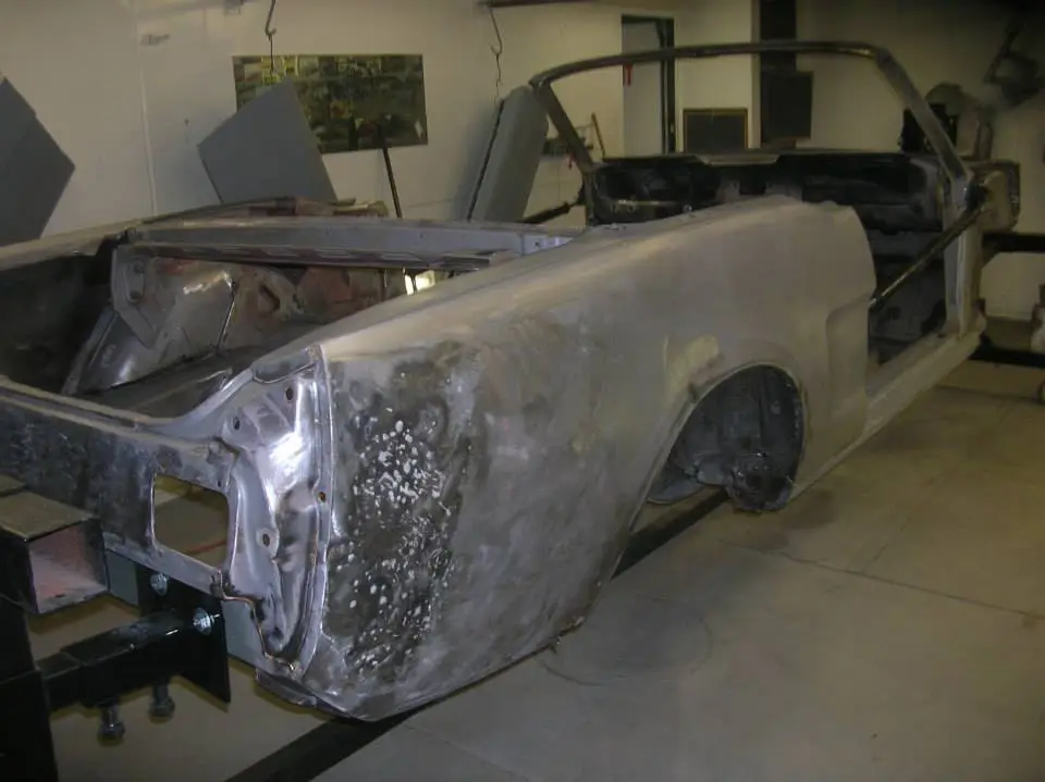

Off to see the stripper!
Buck A$$ Naked!
Ouch!

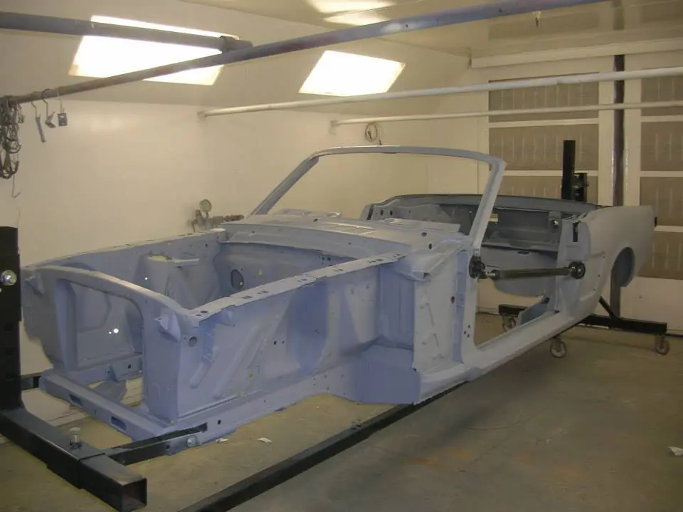

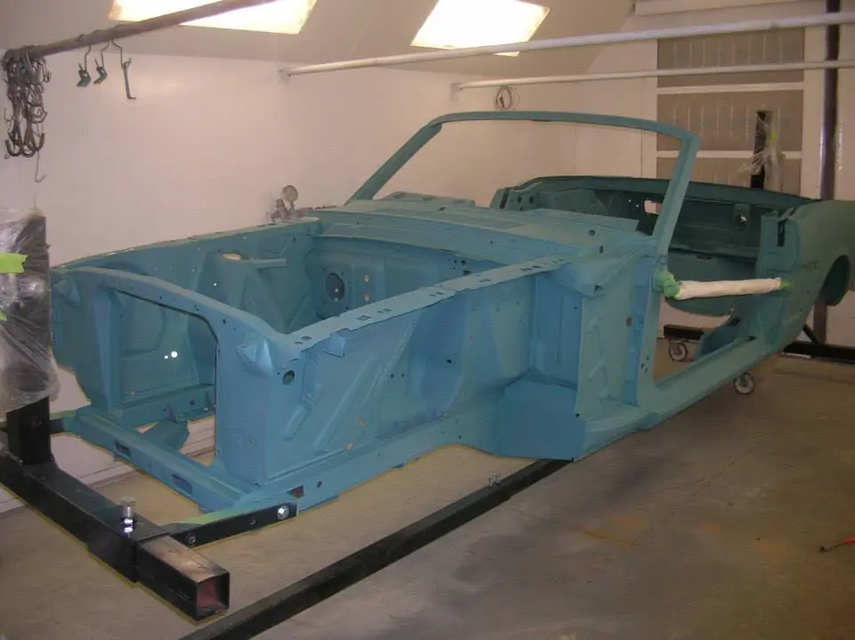

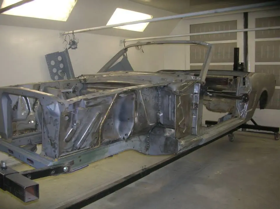

Undercoat.
Primed and ready?
Back Home.

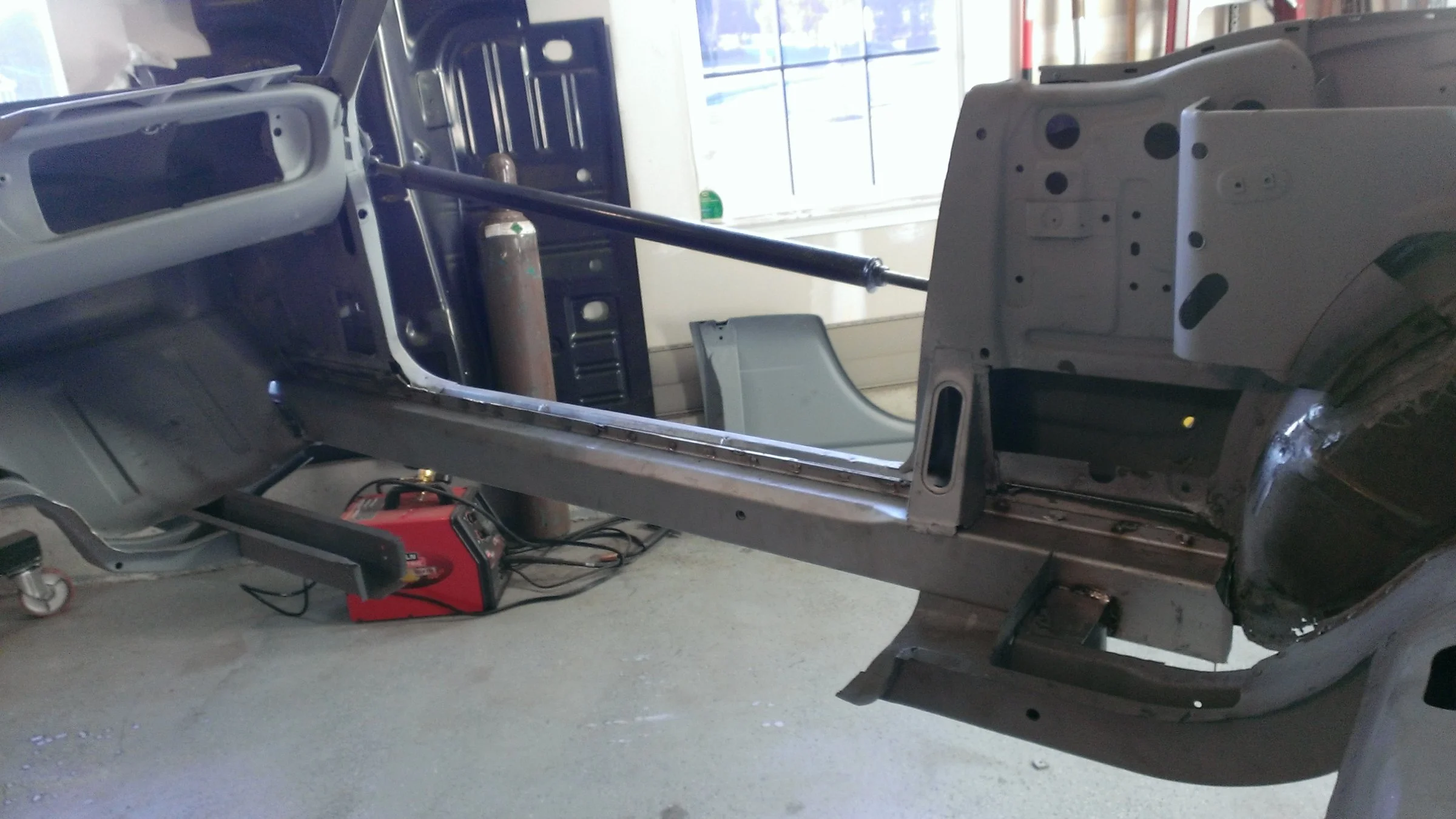

DS - Inner rocker replacement
New Rockers

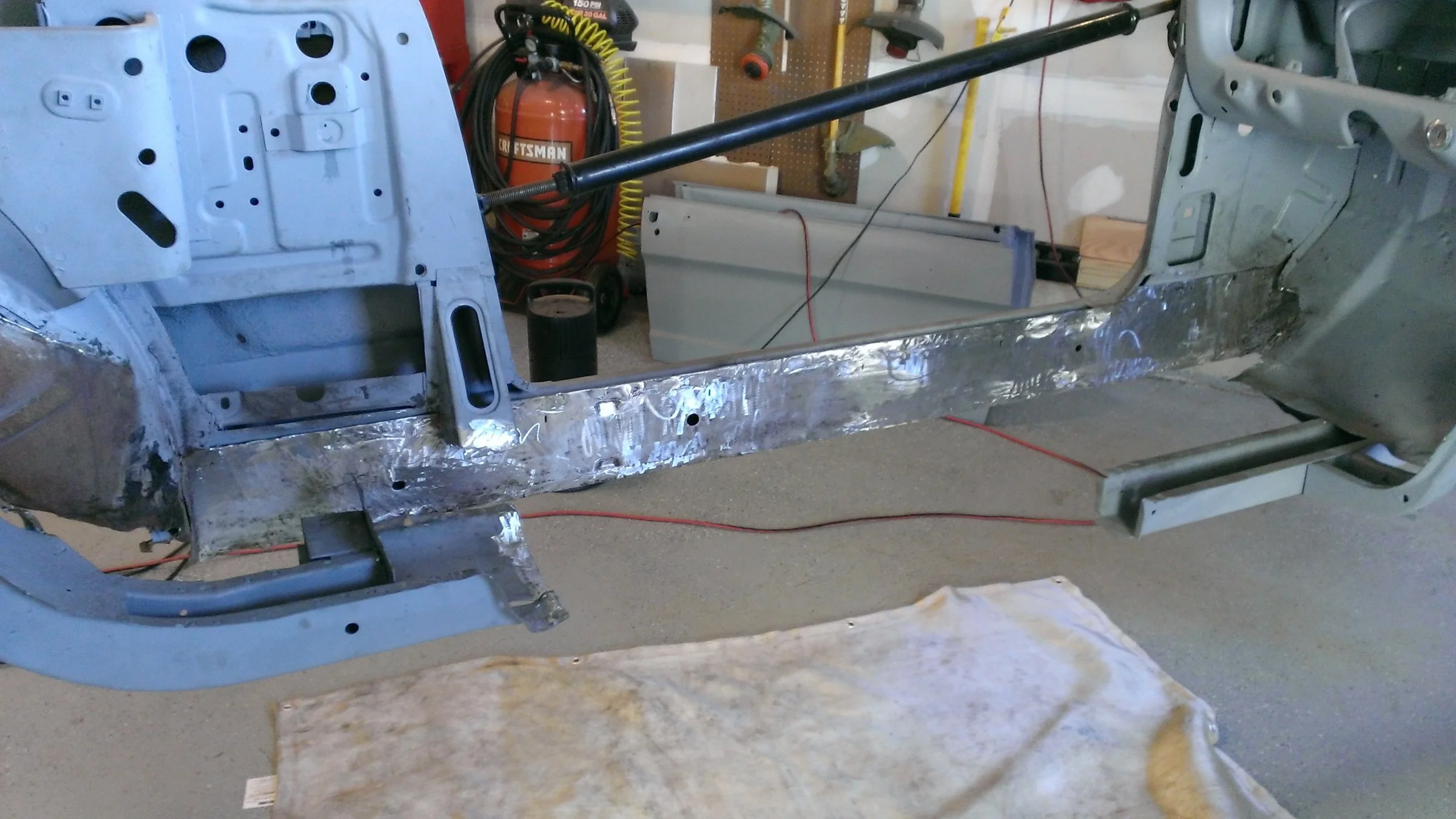

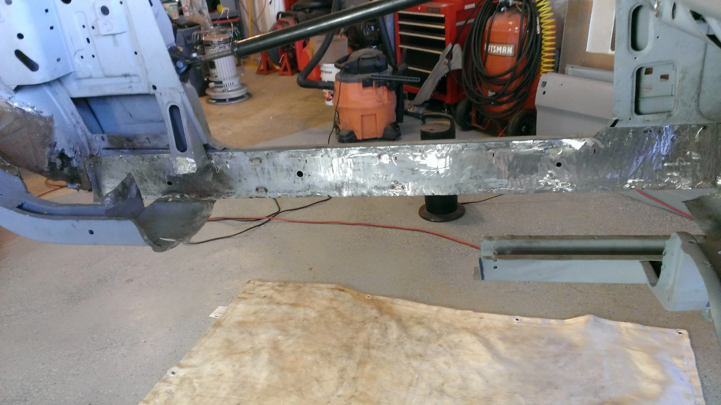

Rockers installed - Frame Rail Prep

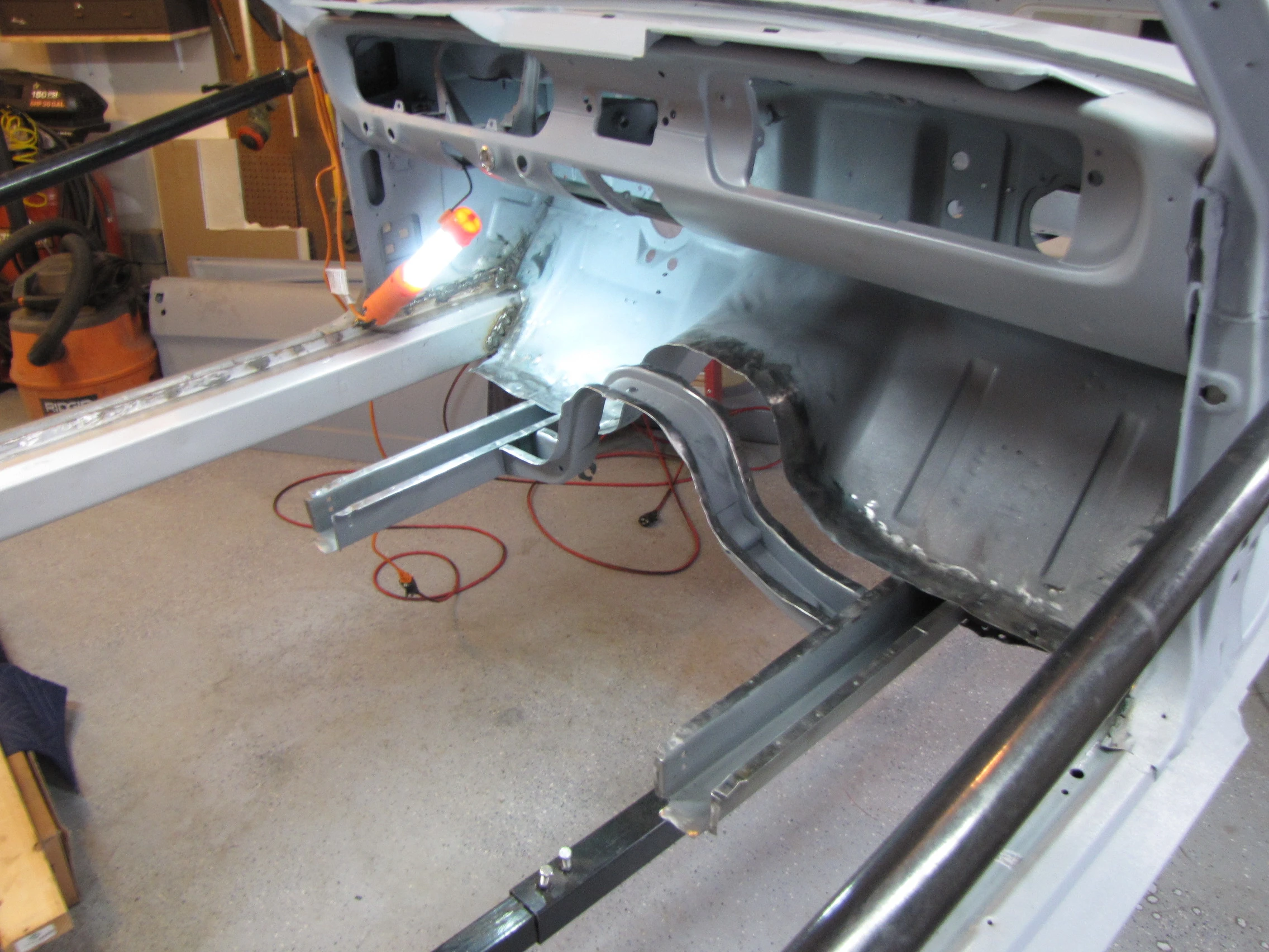

Transition pan outed - Torque box cover in.

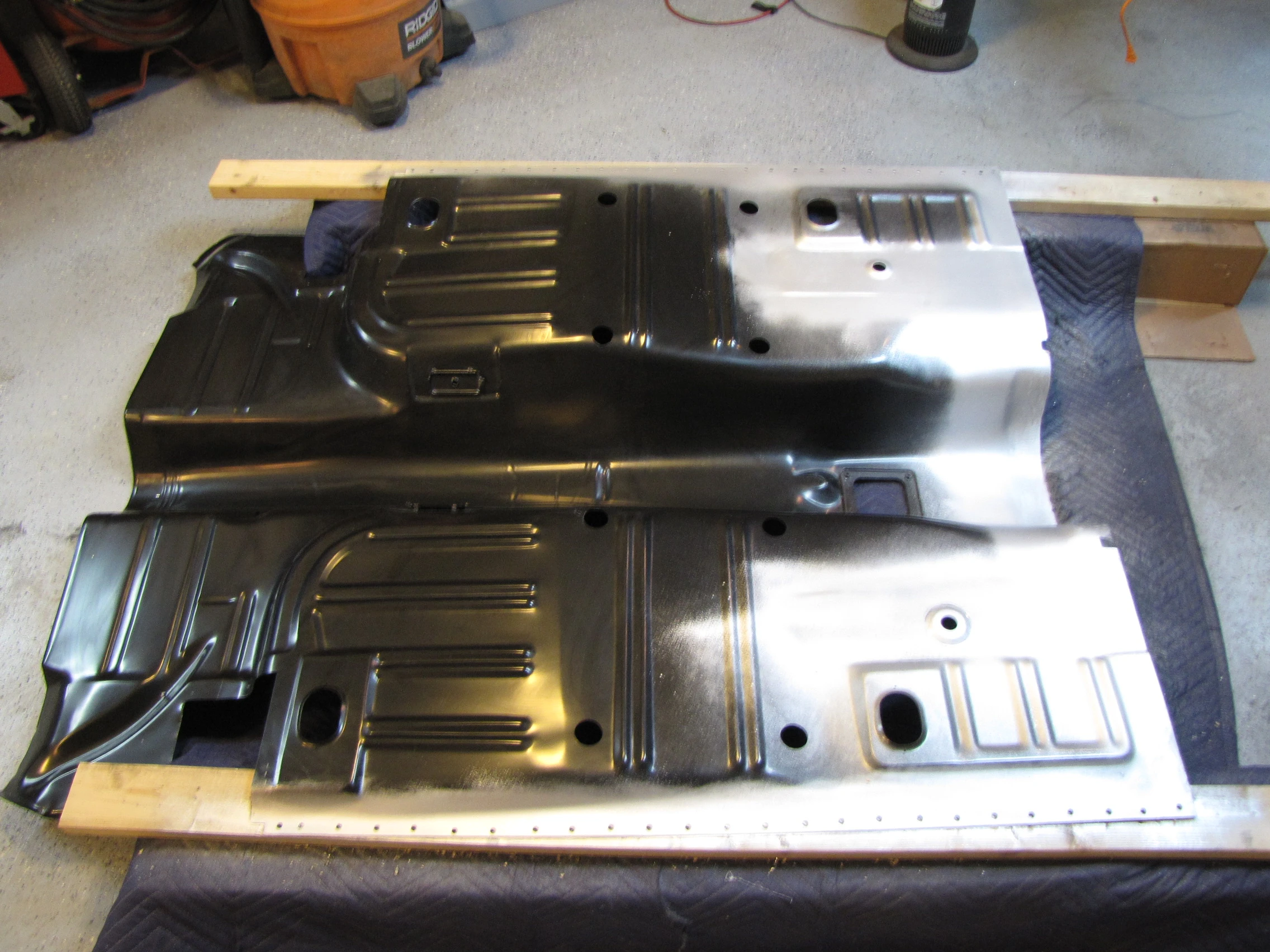

Full one piece floor pan prep.

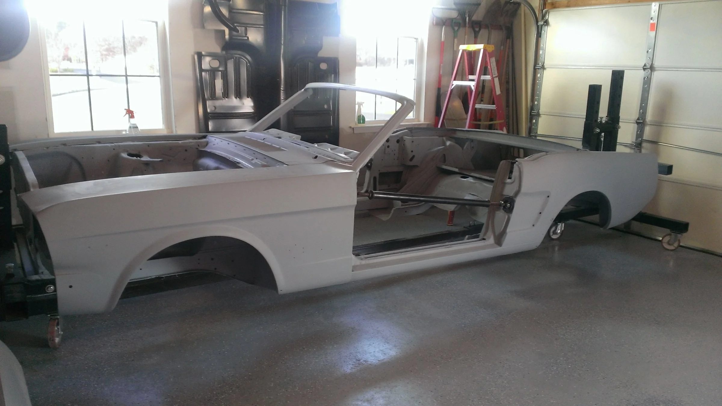

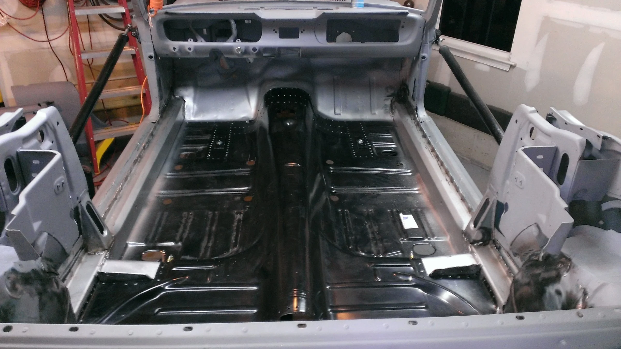

Floor pan Install

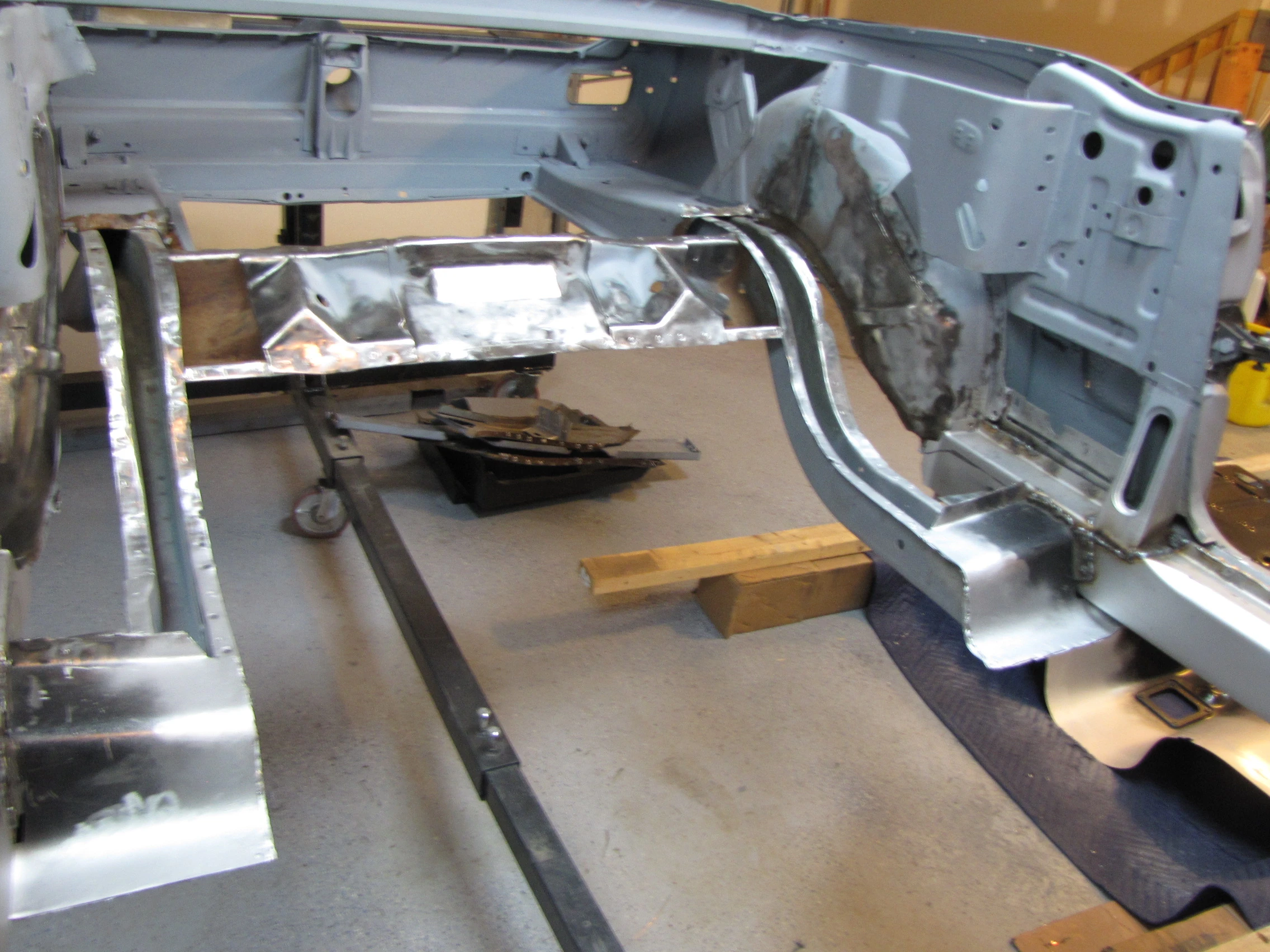

Passenger front fit-up

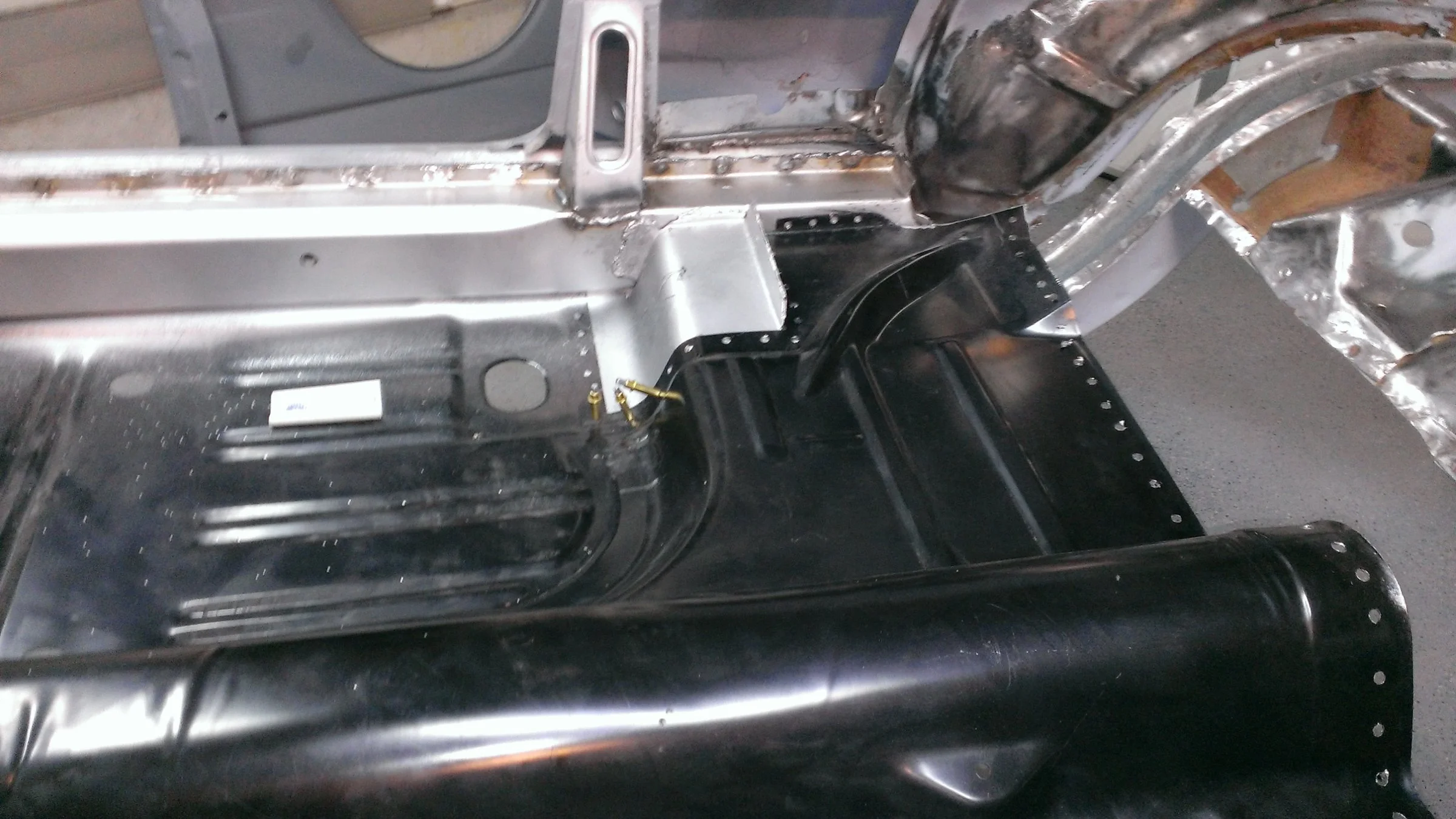

Passenger rear fit-up.

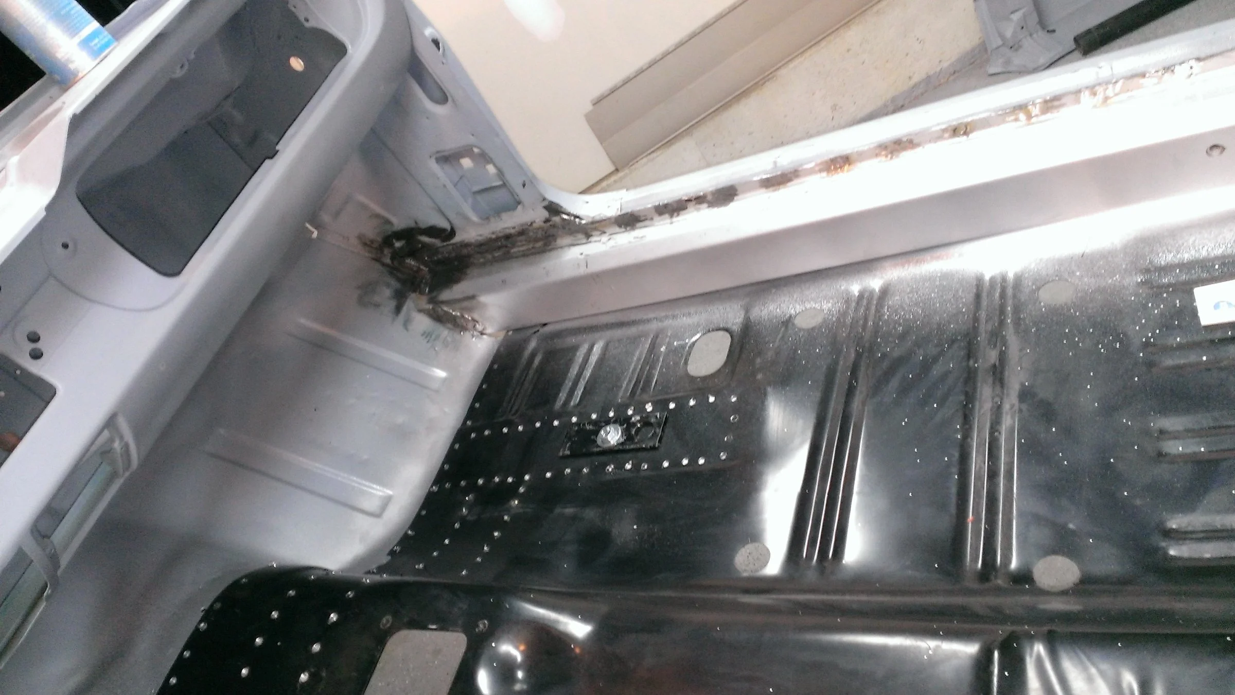

Car came from California - This was in the rocker panels. I think it spent some time on the beach in the 60's!
  • Wow

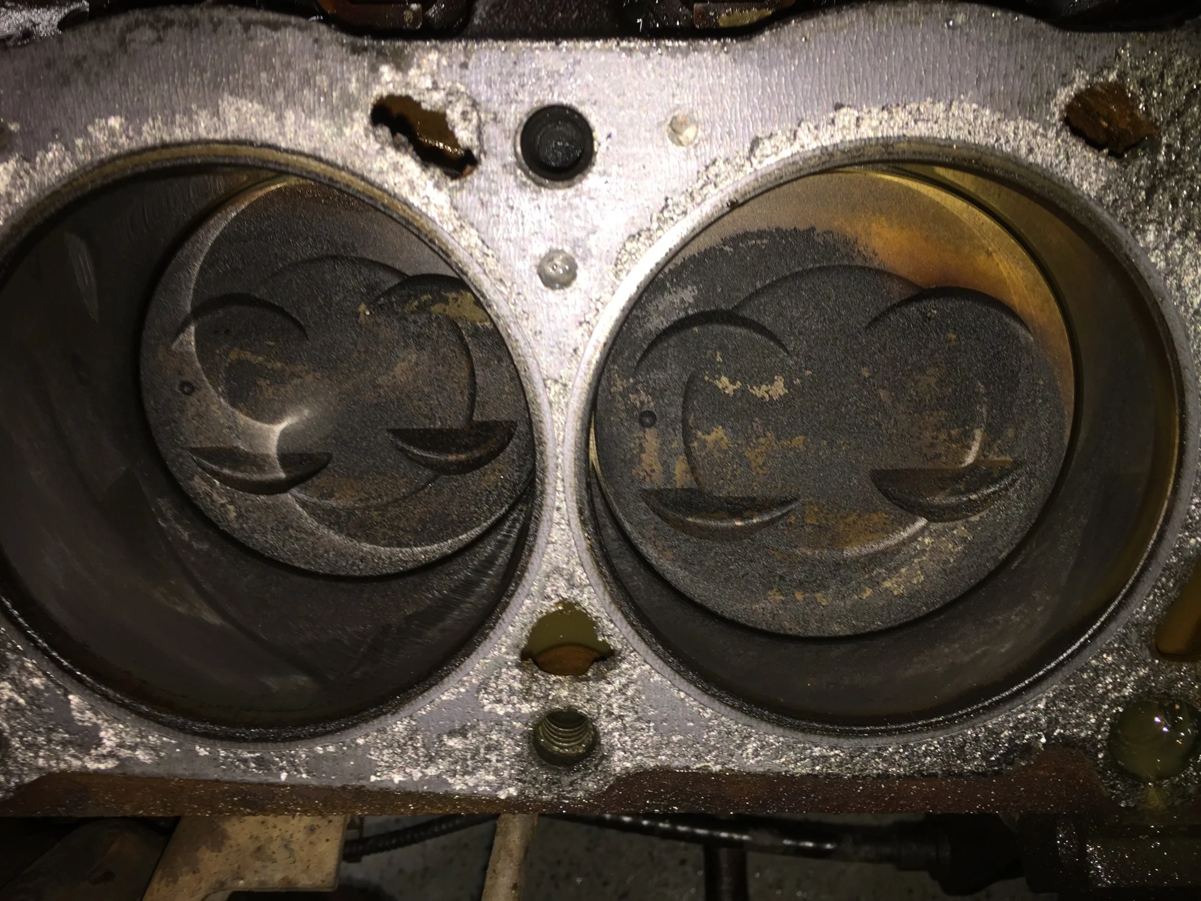

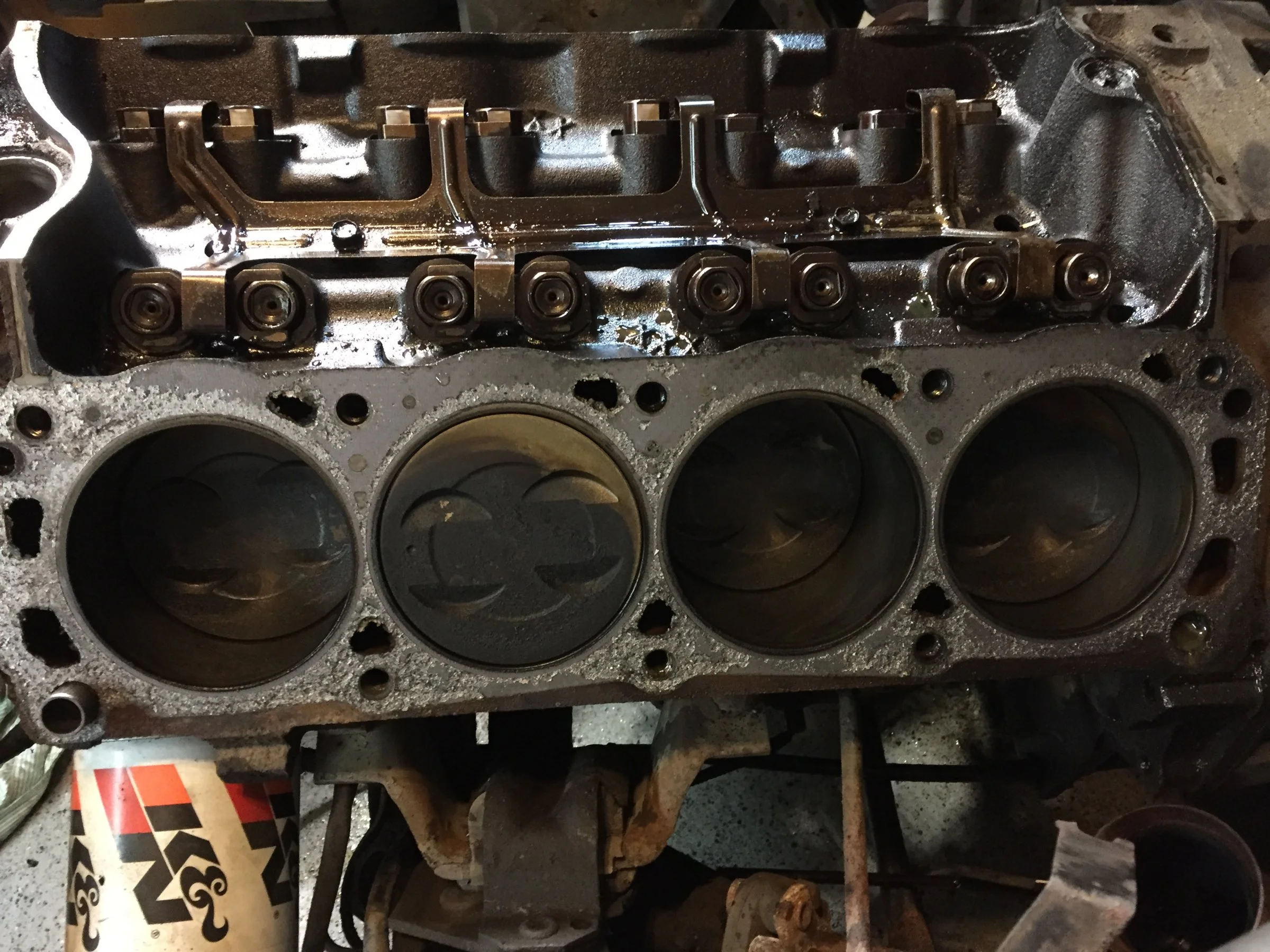

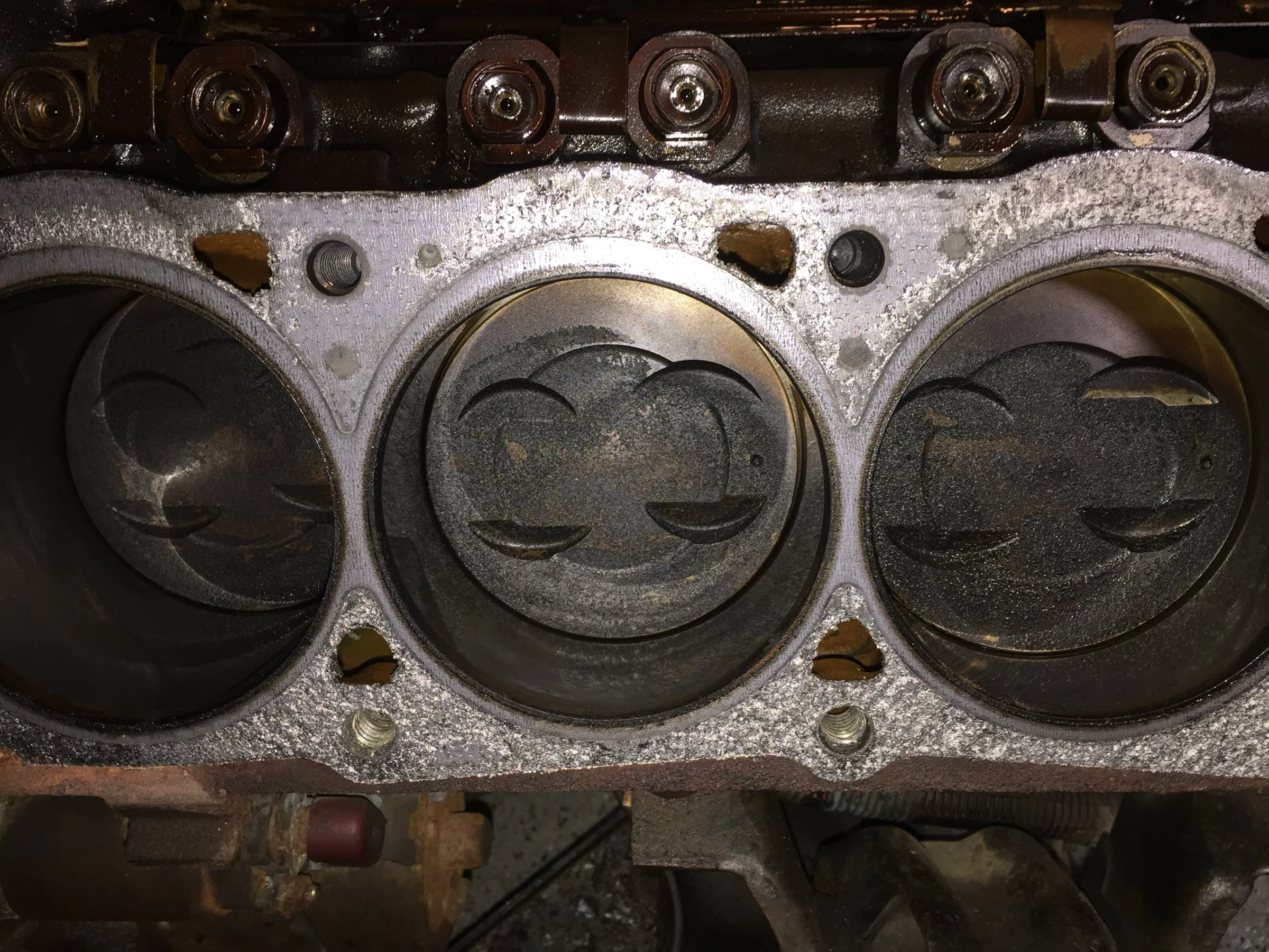

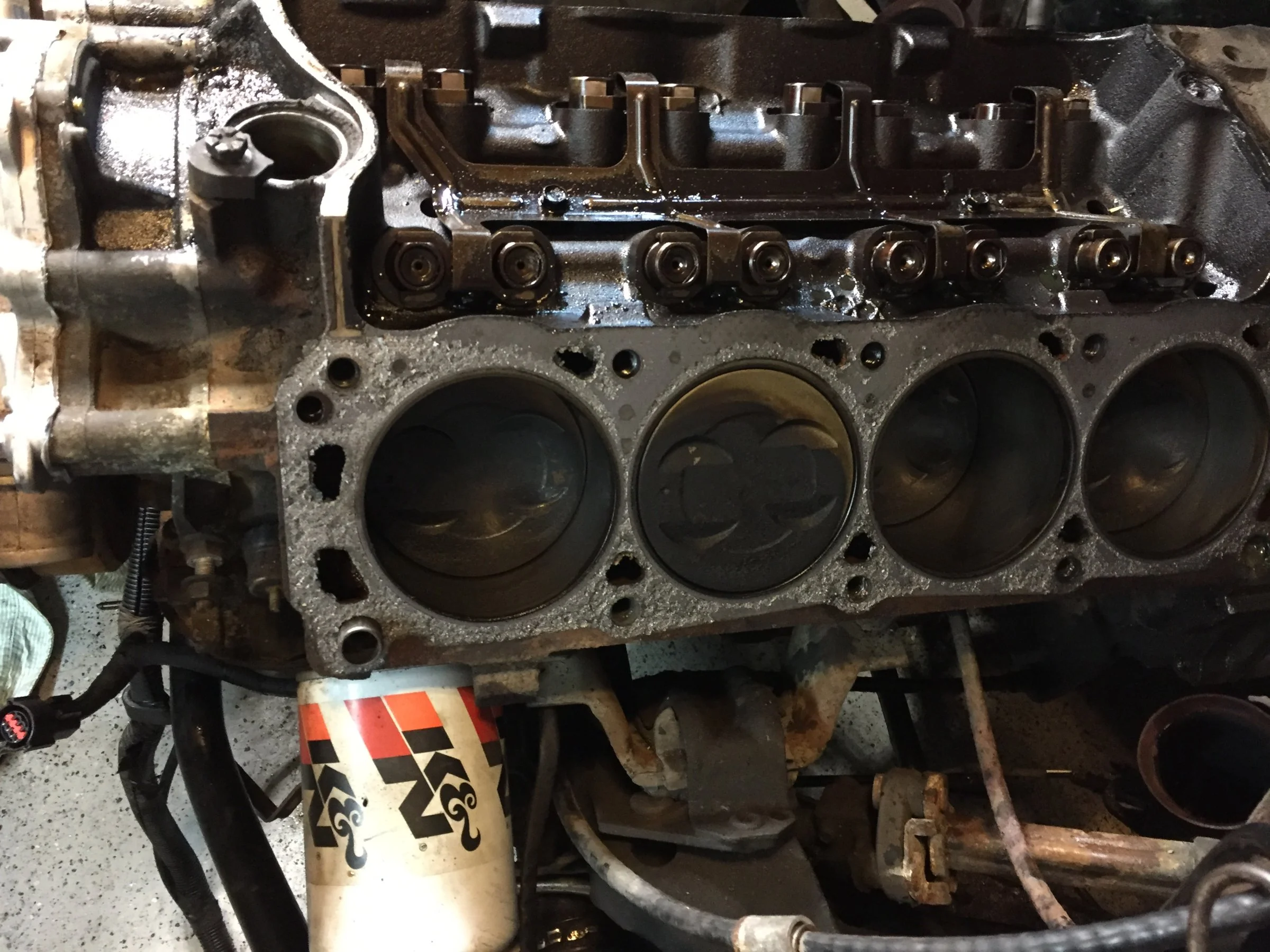

Donor motor is looking good! Still has the factory honing marks on all 8 cylinders. Heads looked good as well. I think the $1250 I spent on this donor is starting to look like it was well worth it.
