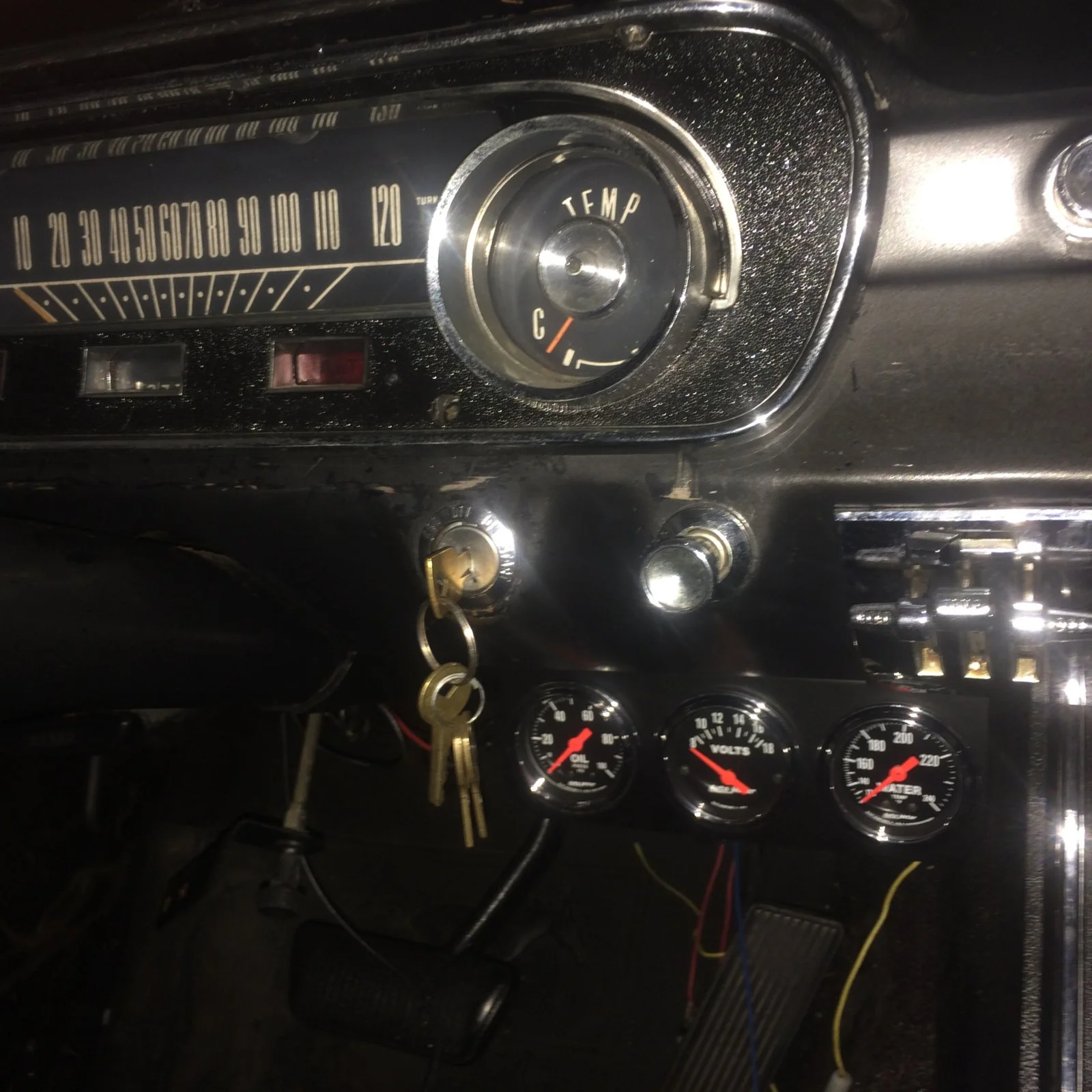

Update: We went with the Jegs 1-wire 100/105 amp (can't remember which) alternator. This sucker works! Even at idle with the Ford Taurus electric fan on, it still holds about 14 volts. Very important to have good grounds all around especially with an electric fan.
Probably could have done something else but since we did Autometer gauges, I pulled the instrument cluster and just removed the bulb from the ALT idiot light so it's not glaring any more. LOVE the Autometer Traditional gauges. Put in the green light covers and ran the dimmer circuit from the fuse box. Matches the factory instruments perfectly.
The hanging wires were temporary!!!! lol
