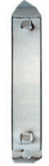

CHEAP T0OL FOR TRIM REMOVING
This is what I use for the removal of the gutter trim. Just apply self adhesive thin wheather strip rubber so that you won't scratch the trim and it works like a charm.Use the bottle side, not the can side.
