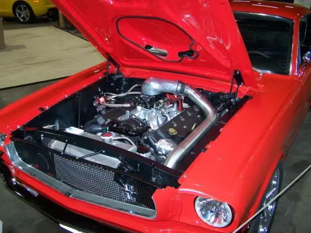

1500? only if its not well planned out in advance and you don't scrounge for deals, regardless though I wasn't really talking about converting from carb to EFI(which really doesn't mystify me, the carb setup is simpler and cheaper, no doubt) I was curious as to why you would take an engine that is EFI stock and convert it to a carb setup at greater cost and complication, not to say it isn't neat to see. I am actually a fan of carbs in a turbo setup, tuning boost with a carb in some ways is easier since you don't need to continually flash new tunes into the ECU or mess about on a laptop all the time, however, even the best carb can't adjust as well or as quickly to changing driving situations. If I was building a drag turbo car, a carb would actually be high on the list, but if its a daily driver and came with EFI to begin with...I don't think so, both power and fuel efficiency are higher with EFI(though not extremely so)
This setup was planned this way from the get go, so I never had any of the EFI stuff for it. I had the motor built and just bought it as a long block. I then added the carb stuff. I was definatly going for the look in the classic car. I am proficient with EFI also, so if I am not happy with this setup I will probaly go to a FAST or MS option down the road so I can retain this look (would use a 4bbl TB). However this was by far the cheapest was to get it going down the road, and I am confident that the drivability will be near EFI quality. The turbo/carb technology has come a long way in the last 5 years.
cars looking awesome!! Makes me wish I had the time/tools or even the$$$ to do a similiar setup. Except I would like to wedge an eng/trans out of the new Shelby Super Snake into mine if given the oportunity.
MSD makes a stand alone unit that runs the timing. It uses the stock cam and crank sensor aolng with a MAP sensor to activate stock COPs. Very nice setup and completely programable.
So you hook up a coil on plug harness, connect the cam, map and crank sensor to the msd box, put on a sullivan intake and carb, and fire it up?? Any other odd end things needed??
Actually the MSD box comes with a complete harness, which connect to the stock COP's, crank sensor, and cam sensor. A GM MAP sensor also comes with the kit. Other than that you just bolt on an intake and carb and fire it up. It comes with the software to tune your timing curves with a laptop. It also has a built in two step and rev limiter.

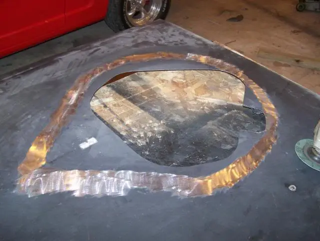

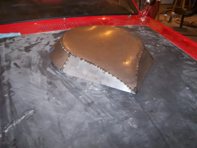

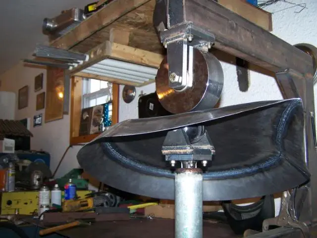

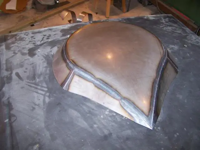

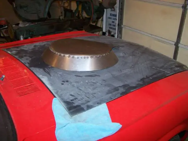

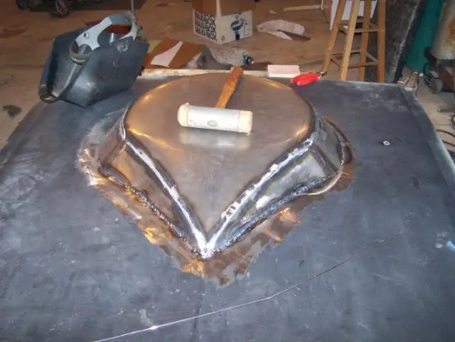

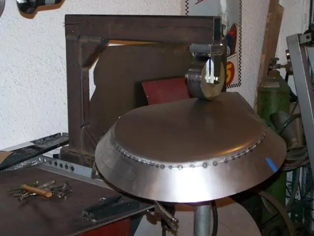

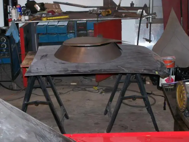

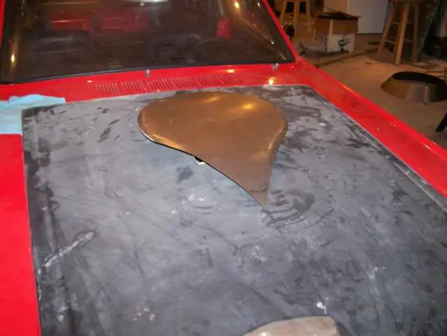

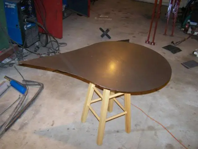

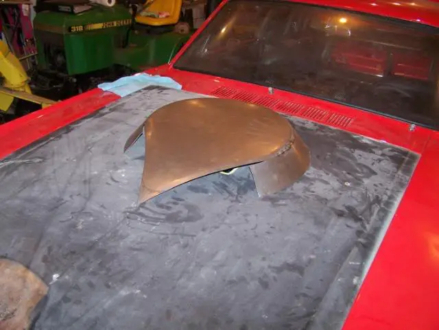

Have not been on here for a while so I figured I would update!! I decided to build an all steel teardrop style hood. I built an english wheel first then proceded to start hammering and wheeling away any some metal...I am pretty pleased with how it came out for my first english wheel project.

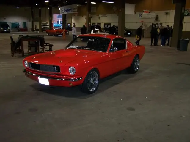

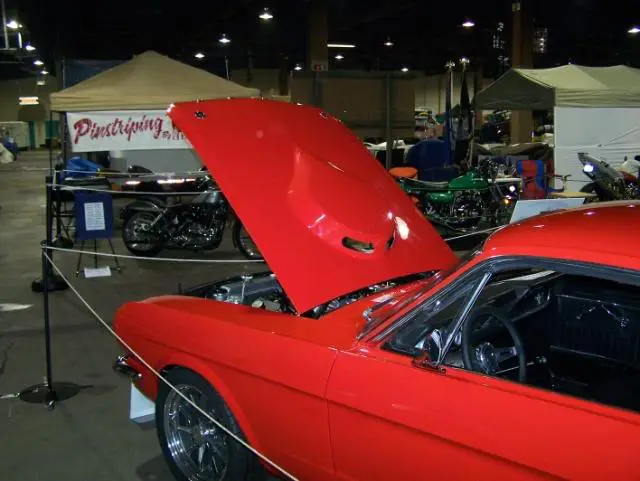

Here are a few more of the car all finished up
I have been driving the wee out of this car and must say that I am blown away with the way it came out!! The drivability is outstanding. The engine behaves awsome with the carb..actually I would say it is better than any modified fuel injected car I have been in. It took a lot of fine tuning to get there but it was worth it. The power of the turbo is much smoother than I expected. Can't wait for Power Tour!!!!
I am not a fan of the Tear Drop hoods but yours came out amazing! as did the whole car! very impressive! I am interested in your home built english wheel, could you email me some pictures and info on how you made that and what you used? i have a feeling i may need one one day and am not a fan of buyin tools you can make yourself! thanks for any info and again amazing car!
