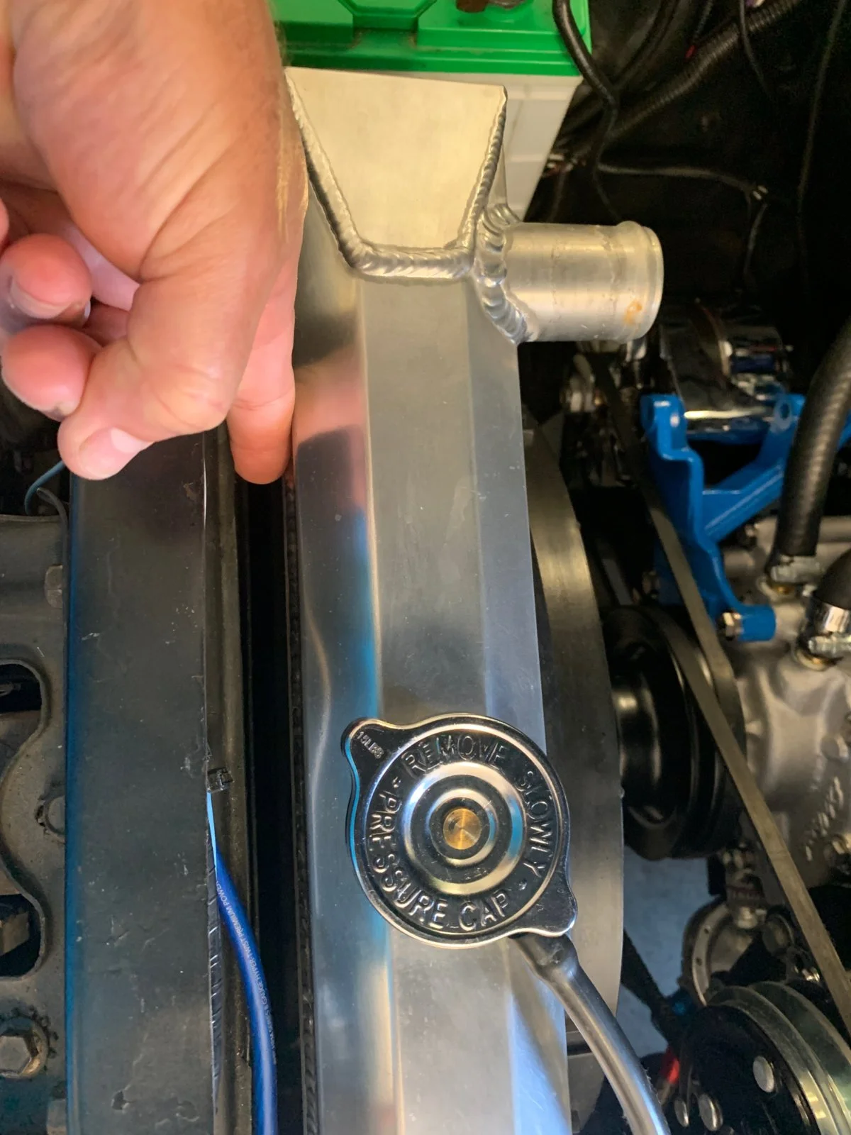

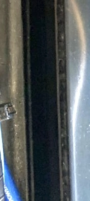

Could this gap cause overheating at higher rpms . Overheating at high speeds vs idling . New Engine and all parts are new. Any feedback is appreciated .

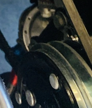

Noticed an A/C compressor in the pic’s posted. If there, It’s operable I’m assuming. . What is the condition of the vanes on the Condenser in front of the Radiator?(Pic’s)..
In retrospect, I’d wanted to mention a new mill was certainly your best choice. Also narrows troubleshooting.
If not newer & defect free, there’s a possibility the Condenser may be contributing to the restricted airflow when driving at speed, just wonderin’...
Run the same Condenser previously, last motor?

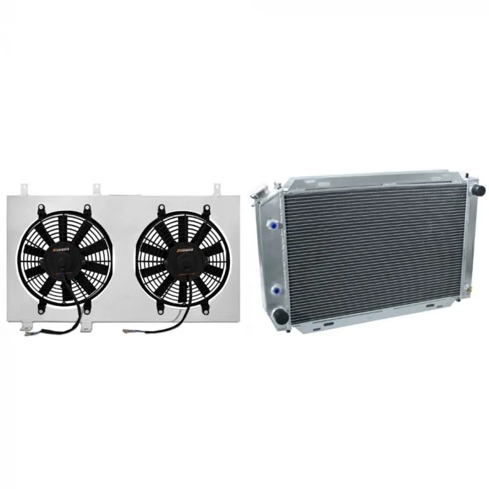

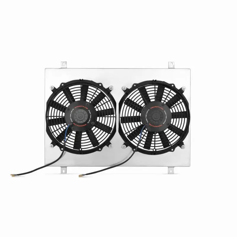

The high CFM Fans I was speaking of with shrouding to direct airflow are relatively inexpensive, (Mishimoto). Runs (2) smaller 2,300 CFM fans (each) focusing cooling efforts on the entire surface area of the Radiator, driving or sitting, also helping equivalent flow at speed.
Your full spark timing advance timing ‘all in’ by 3,000RPM, set more conservative
by pulling timing helps narrow down things.
They make the below for near all year Pony’s, and reasonably priced, high quality
Mishimoto fan/shroud, pic’s below...
Cam Timing was set did to dot? If you have a vacuum gauge, Dwell meter, checking plug electrodes for mixture/coolant being burned, etc, all the nostalgic methods works as always did- perfectly.
Mishimoto pictured below with the Radiator and shroud. Bolt up is dead on, can use the OE threaded clips on it.

This issue sounds as if it is caused by a lack of airflow.
Yes, the gap can make a difference. The lack of a shroud and the lack of having a good negative pressure area behind the radiator can also make a huge difference.
After you have closed that gap and installed a shroud, try putting a small spoiler at the base of the radiator. It only needs to be a couple of inches tall and maybe 2/3s to 3/4 of the width (although wider is better and can be the width of the nose of the car if you like).
This will increase airflow at speed and have the added side effect of making the nose less squirrely at high speed.
If you look at factory Fox cars, you will see a spoiler like the one I describe on cars from 89 to 93 and even later, from the factory.
This is one of those things that is overlooked a lot.
Reactions: rbohm
think noobz hit the target here. i also think you have an issue with airflow through the rad at higher speeds. in addition to what noobz wrote, you can also open up the area where the license plate sits on the valance panel they way shelby did with his early R model GT350s, that way you get more air to the bottom part of the radiator. i plan on using the R model valance panel on my 66 coupe when i get that far.
