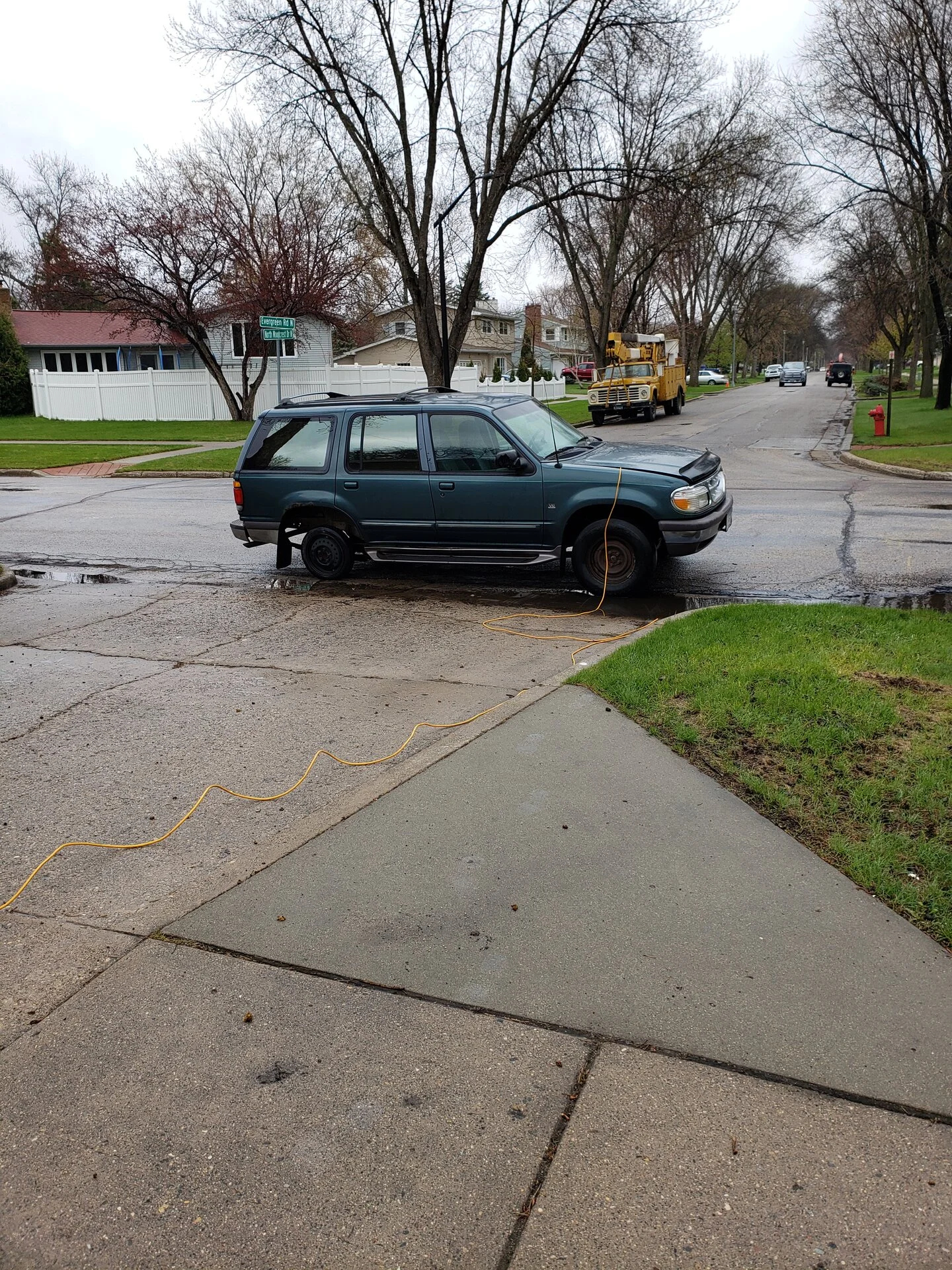

Got the explorer, the guy wanted to keep the tires as they were newer so we swapped some donuts on.
Runs great!
Reactions: 2Blue2
So I pretty much have the explorer engine ready to pull atleast from what i can tell. Just cant get it to separate from the trans/bell housing.
Removed upper and lower intake to access upper BH bolts
Removed headers to access engine mount bolts and side bolts for BH
Removed starter and lower BH bolts
Removed nuts from the flexplate (4 i think)
Did you push the torque converter back towards the trans to unseat it from the crank?
you also have to support the trans so the engine can slip forward off the dowel pins.
I will give these a try as I did not. Ready to get this thing out and to the machine shop, was hoping to be able to get it on the road this summer but that is going quickly.

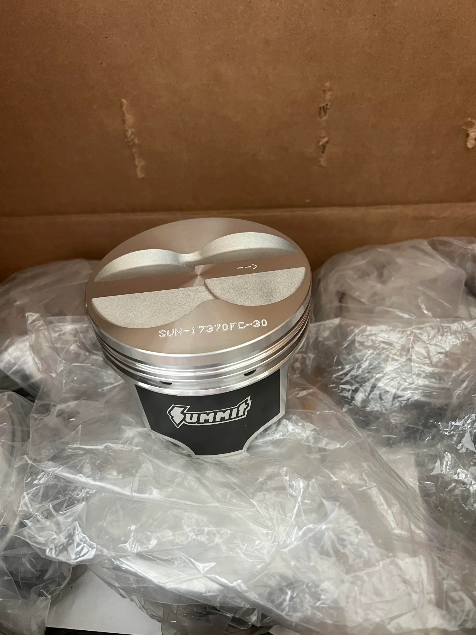

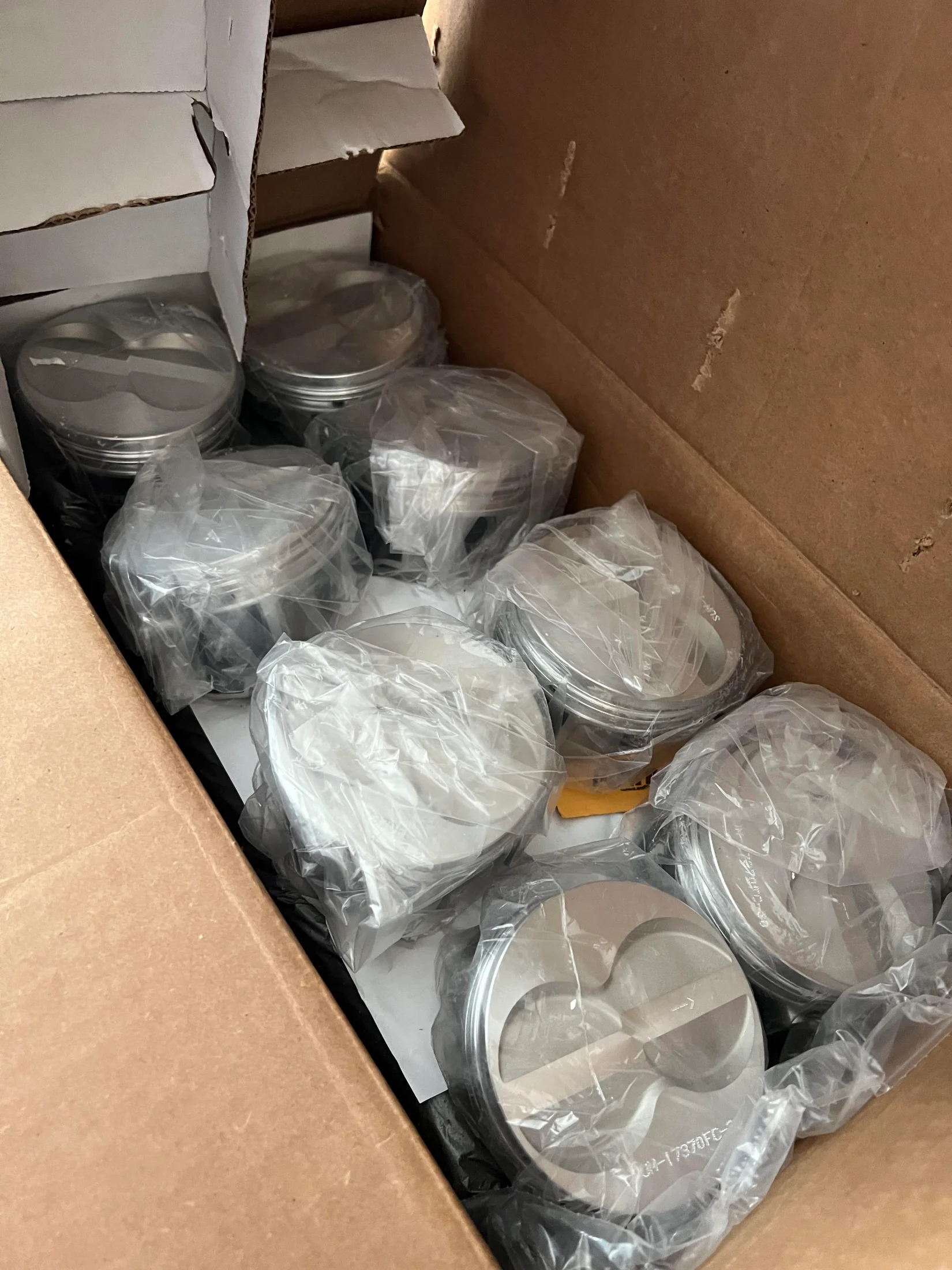

- Forged Pistons

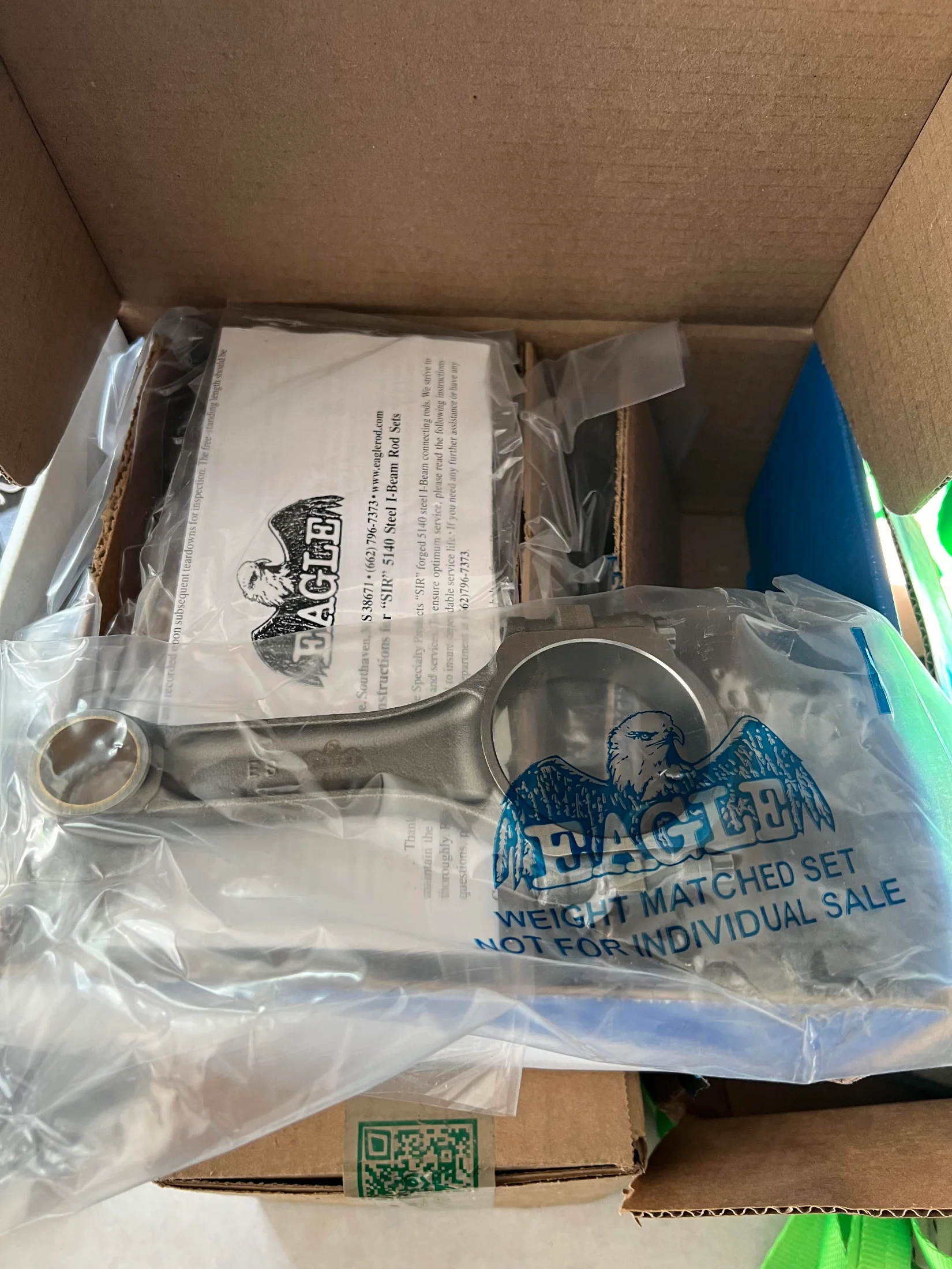

- SIR Rods

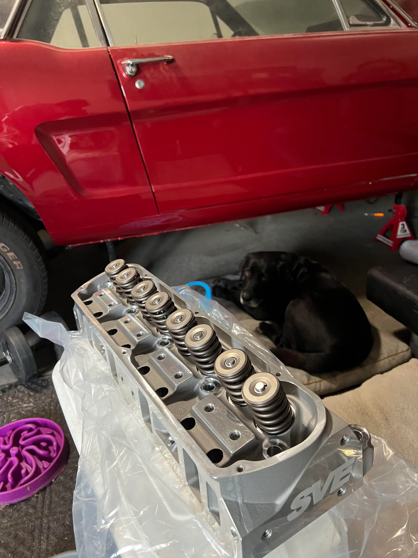

- SVE 170 Alum heads

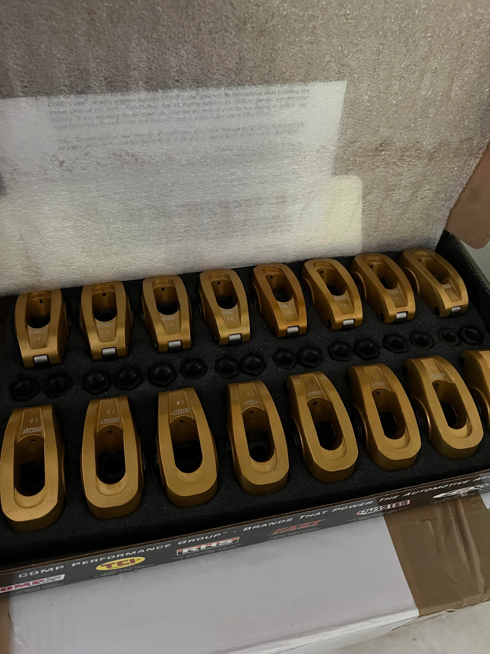

- 1.6 rockers (think the die-cast comp cams, or a used set of Scorpians that are local)
