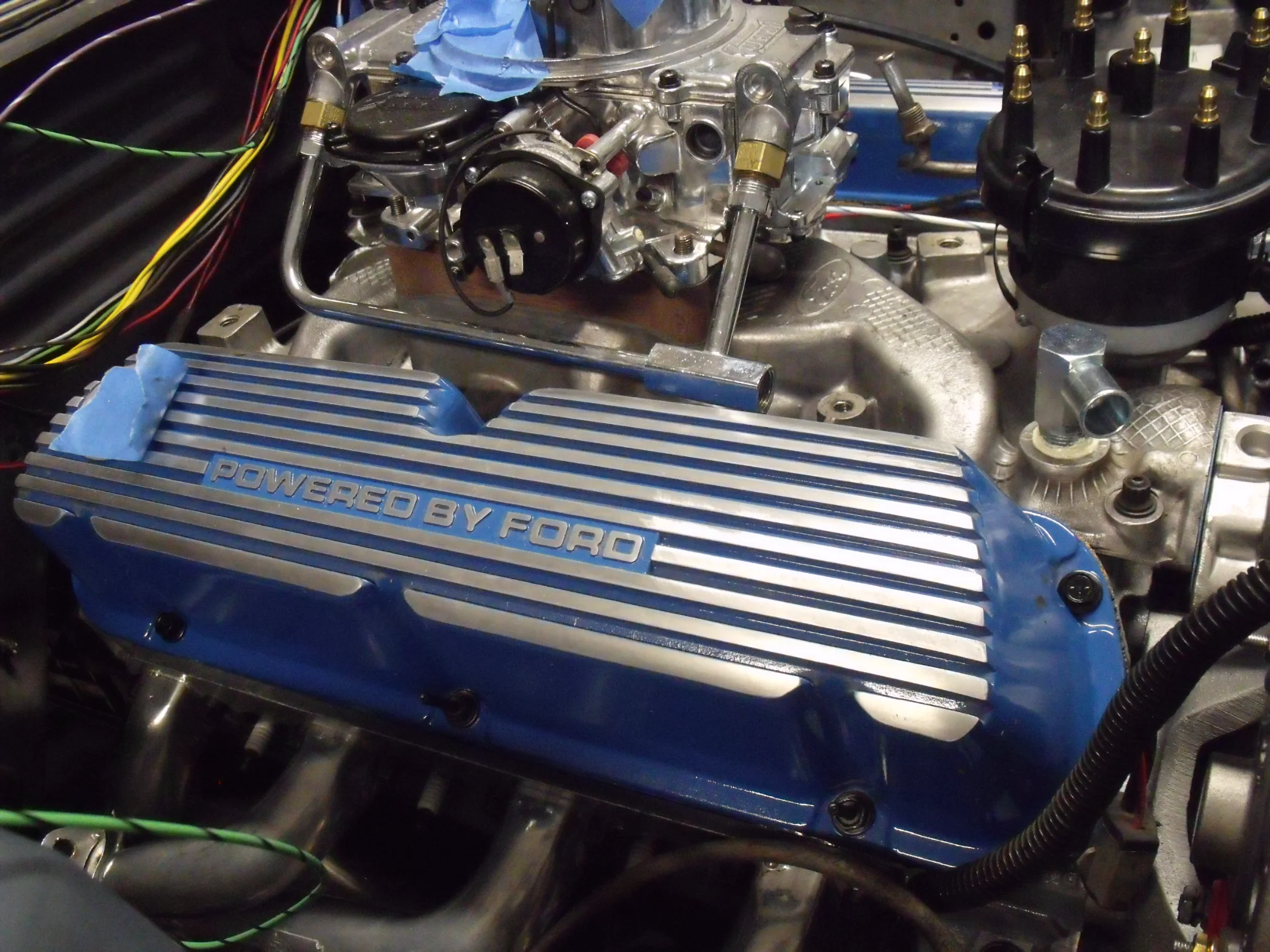

Starting to finalize getting the remaining parts. Valve covers came in yesterday

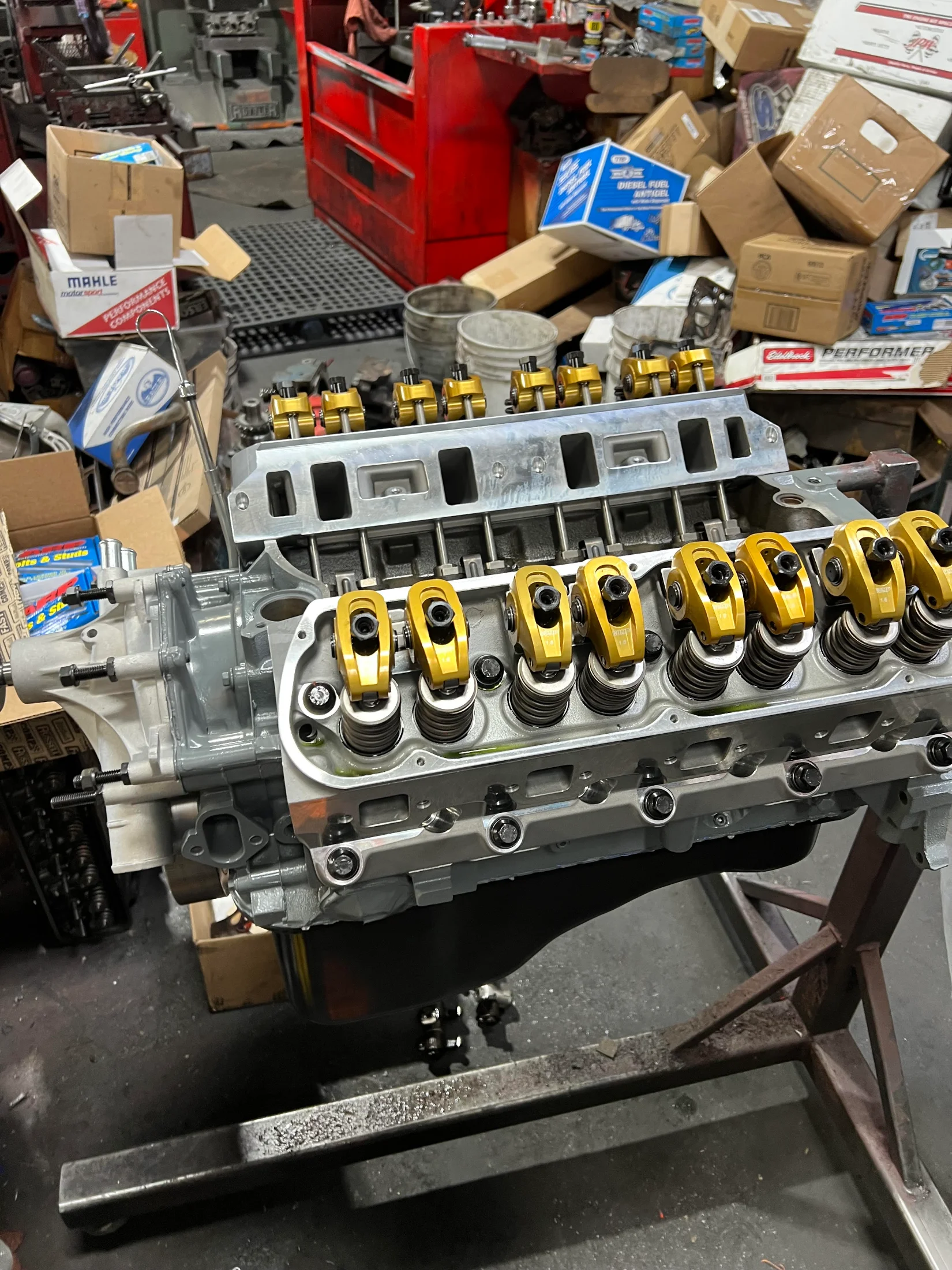

Getting beat up by the machine shop. 2nd block turned out to be worse shape so they sleeved the first one, they are getting ready to assembly the shortblock now. Based on the price for everything I should have just bought a crate motor! I am also considering just having them assemble the longblock and be done with it.
If you have an engine stand this is the fun part.. All of the parts are clean or new.... ..... AND its how you learn
I do have a stand but time is my biggest issue, between family and work I am finding less and less time to work on the car. The shop quoted me $500 to complete the long block so I will likely take them up on that so I am ready for spring! Still have to finish brake lines, Hyrdo clutch, and fuel lines.
