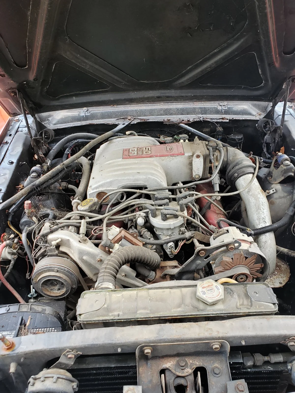

I sold a fox body and ended up buying this 66 coupe with an 86 5.0 that ran before it sat for 4 years. All fluids were drained before they left it parked. I cleaned gas tank changed fuel pump as it was dead. I changed fuel pressure regulator and fuel filter as well as all hoses with new clamps and blew out fuel lines. Car will crank but not start on its own. I spray just a small squirt of starting fluid and it fires up and runs with ease. I changed out tfi module as I was told could be it but it did not help. I can not find the plug that you are supposed to be able to use to get the codes off of computer.
I am looking for any and all suggestions and I have a page that has a list of stuff to try that I am gonna start on also.

It has a new fuel pump, new filter, and new regulator. I blew out all lines and the rails. I replaced all rubber house parts with new. I cleaned tank and cleaned filter on pick up and blew out pick up tube as well. I have not tested the injectors yet.
I have bought new plugs, wires and coil today so I will see if that changes anything. After that it is back to chasing wires looking for weak grounds and breaks.

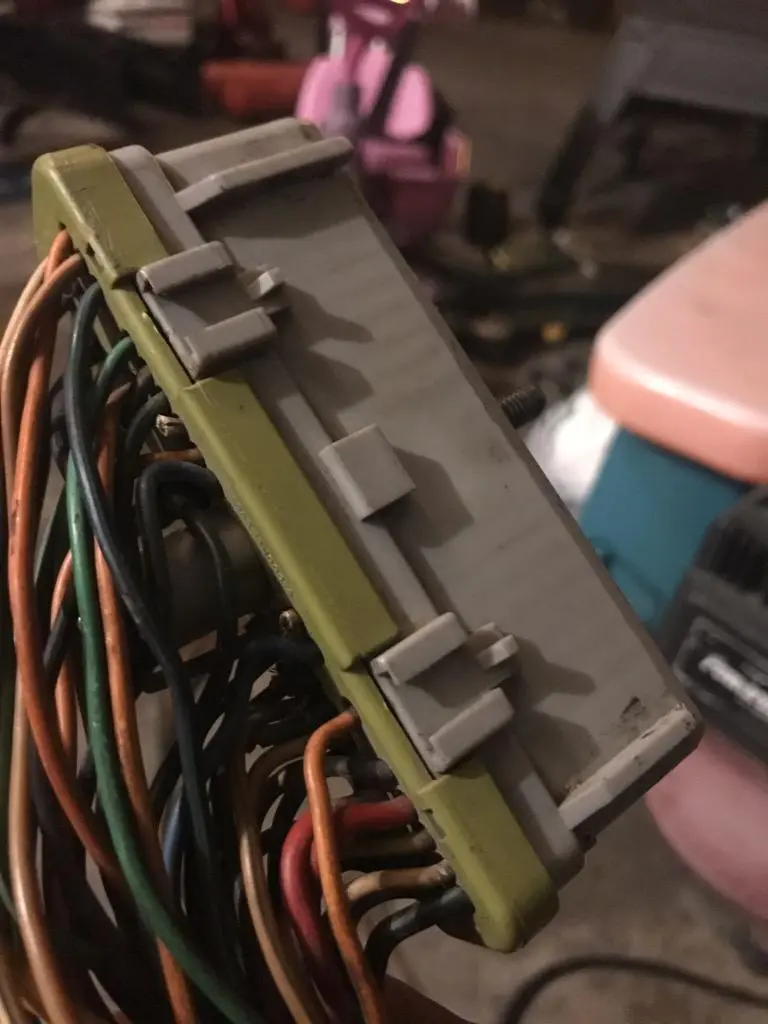

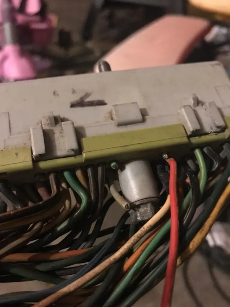

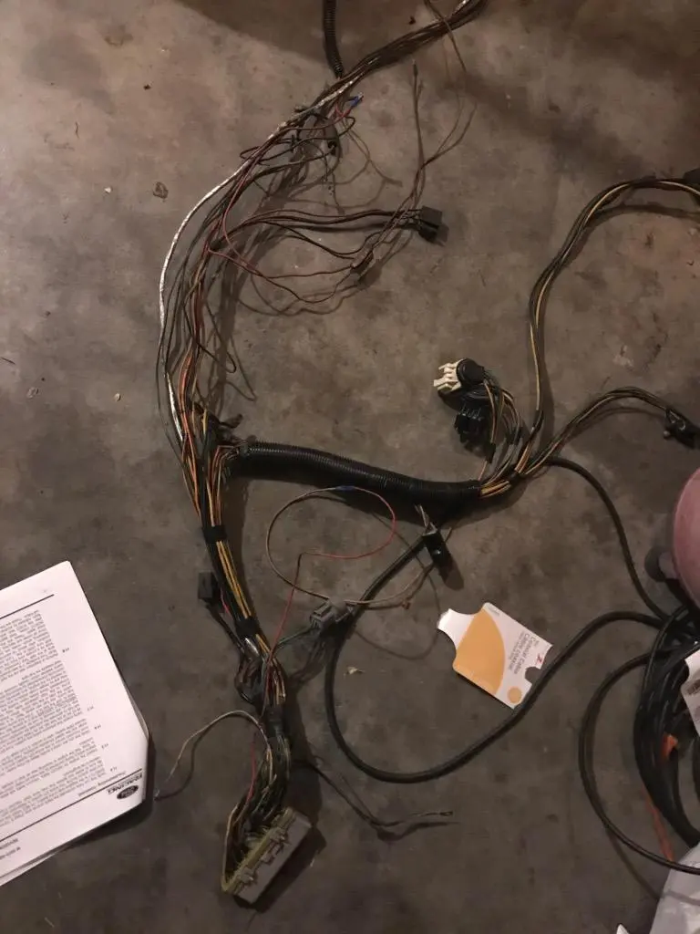

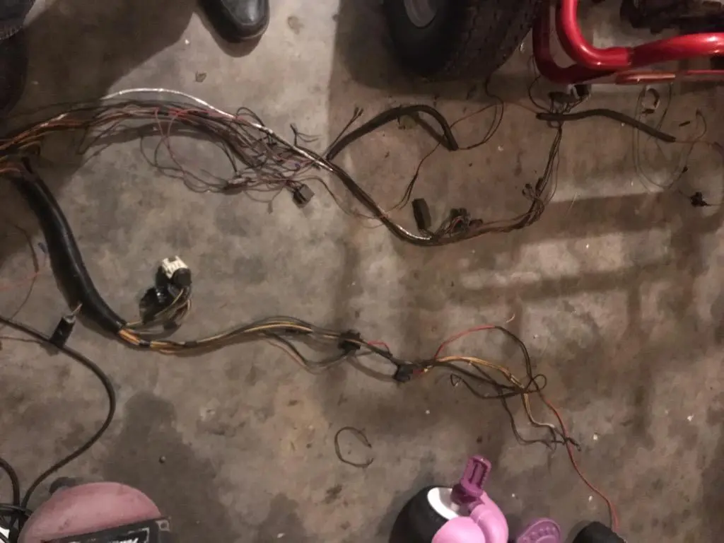

Ok found lots of issues in the wiring harness when checking different voltages. I removed the harness and they have spots just taped together where they spliced and they have spots where they used 2 or 3 different size of wires to extend things and cut up a trailer wiring harness and used the wires from it in spots.
So since I have an 86 speed density 5.0 what harness should I get to replace this one or should I just make the necessary repairs? Will everything hook up the same if I got a 87 or 88 mustang wire harness and a da1 speed density computer? I just want it running again so wife can drive it while I plan out the mods I wanna make to it.
