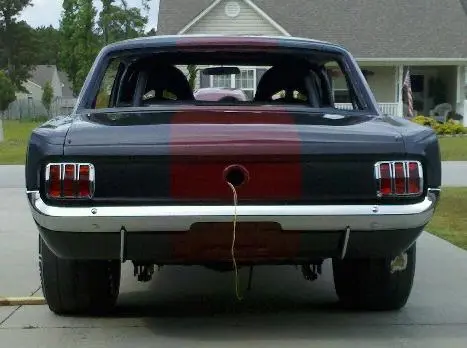

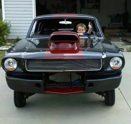

The car is getting close. I used 67 outer wheel wells, and moved the inner wheel well to the frame. There is a another post by me on here with more details. Ignore the short front tires, I'll be getting some other ones. And hopefully someday my I'll get my engine.

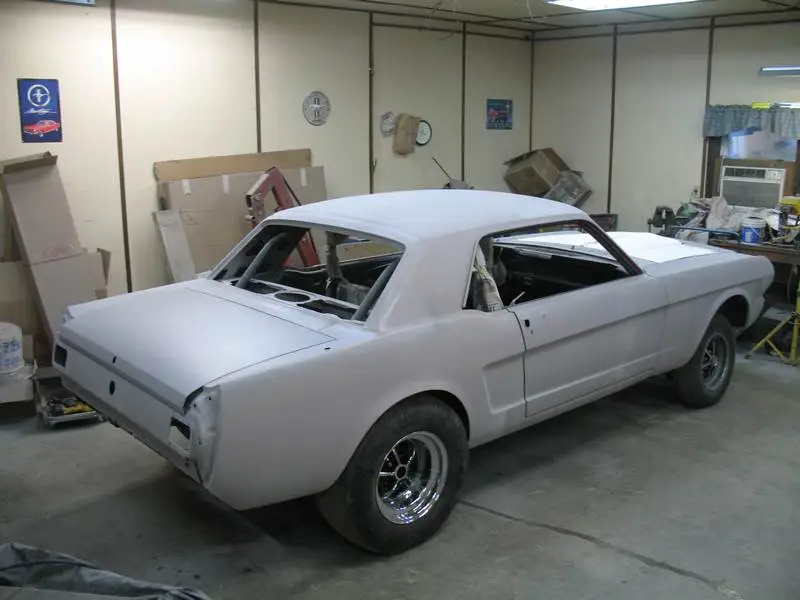

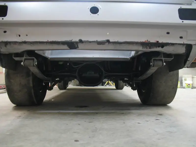

I got mine done too. I ended up sending Alex back his kit and going with the Heidt's stuff instead. The 28x10.5x15 drag slicks fit great after narrowing the rear:

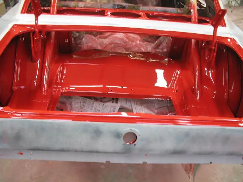

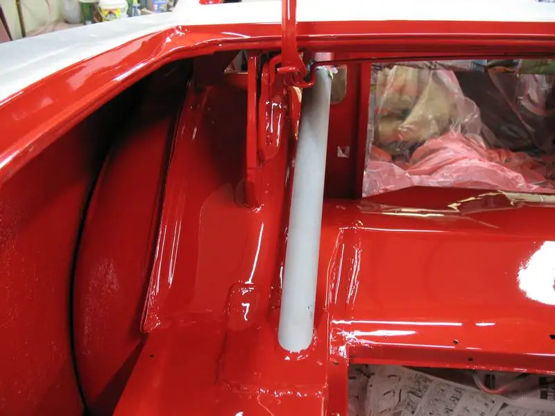

I finished off the trunk to make it look like it came from the factory this way:

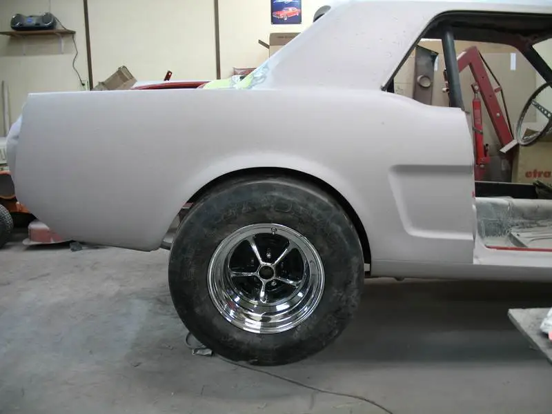

Dennis, did you have to trim the front of the fender lip to fit the 28's. I know where mine sits with 28" tall slicks on the top end they hit pretty good right there when you get off the gas. Any side pictures maybe? I would love to run 275/60/15's on mine instead of the 50's.

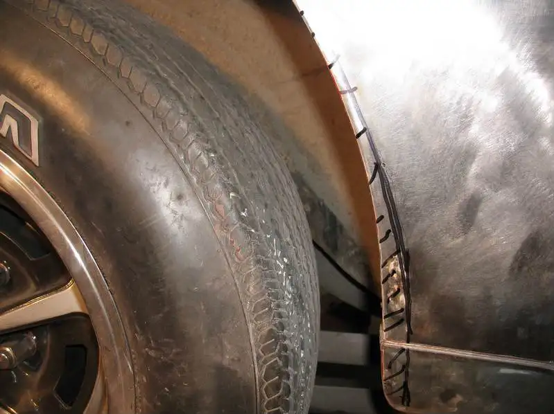

Yes, I did do the trimming at the front lips and it was planned from the beginning of the project as I was aware of the lack of clearance.

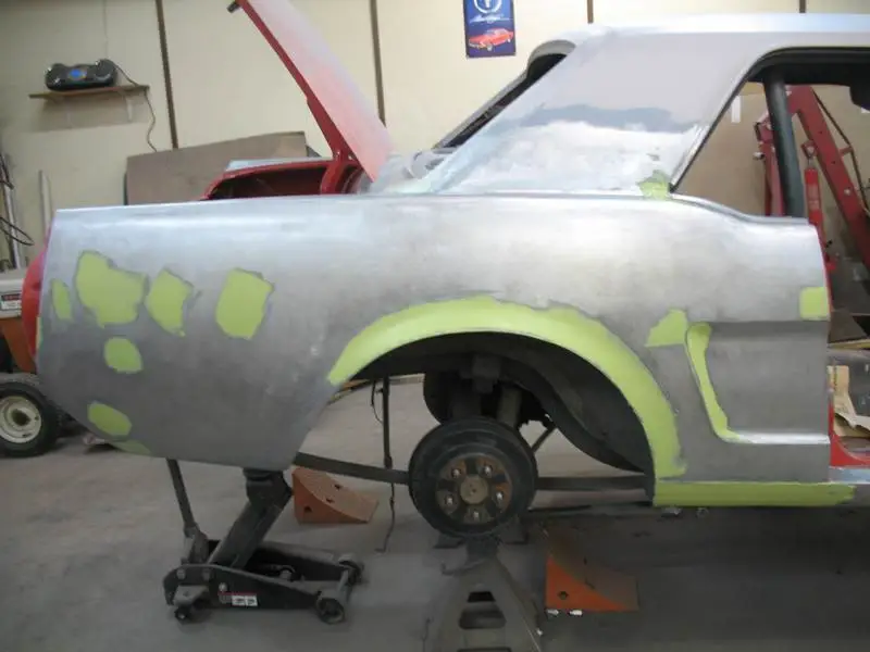

First I free handed some markings about 3/4" in on the quarter, using the center of the old wheel as a reference:

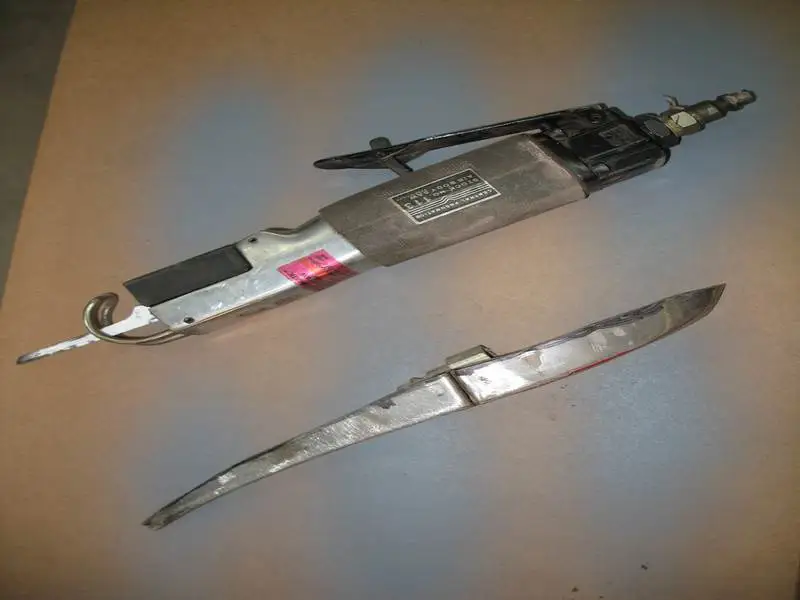

Then I cut it out with a cheapy saw from Harbor Freight:

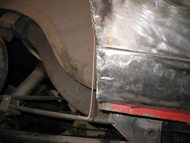

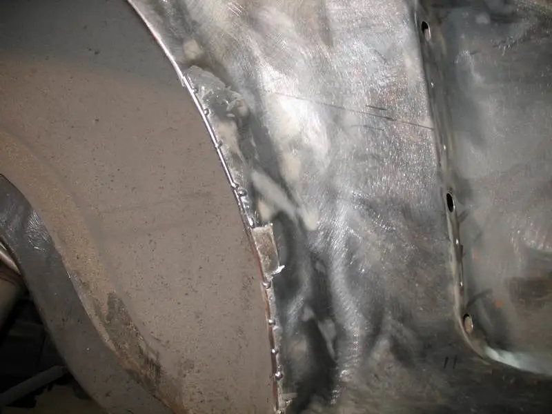

Used 3/16" welding rod to join the wheel well to the quarter:
Instead of installing the 67' outer wheel wells, I simply used a bottle jack pushing again short lengths of 2x4's around the circumference of the inner wheel wheel. Subtle but good for 3/4" without overly extending the factory flairs. Looks better than the old original flat quarter.
A little body filler applied in the affected areas (plus a few dings):

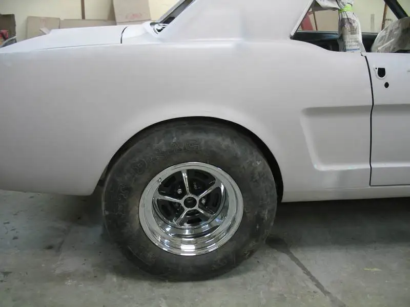

28x10.5 on car with rearend on jackstands:
On the ground:
I have a full 1" clearance at the front and rear of the wheel wells.
