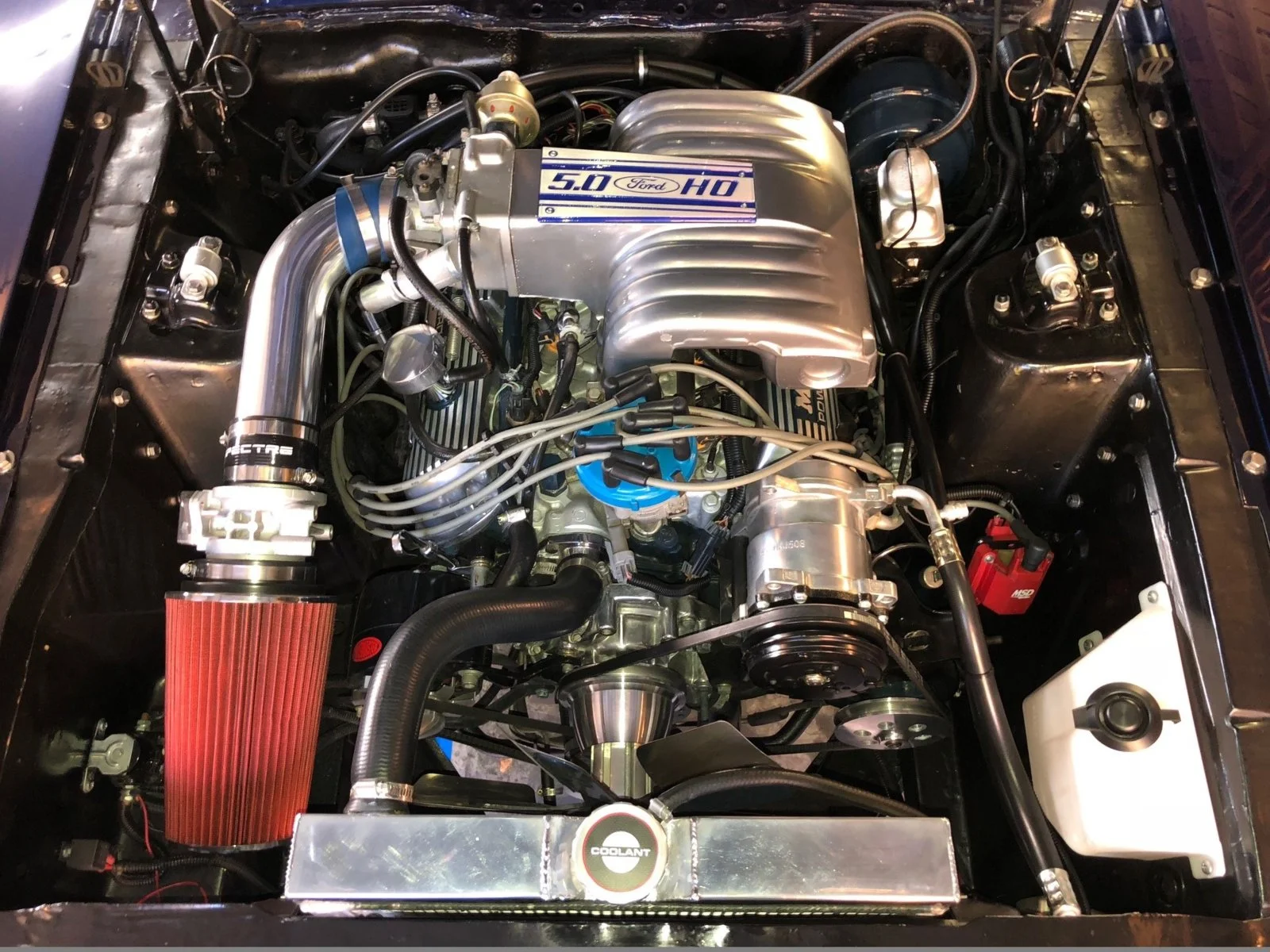

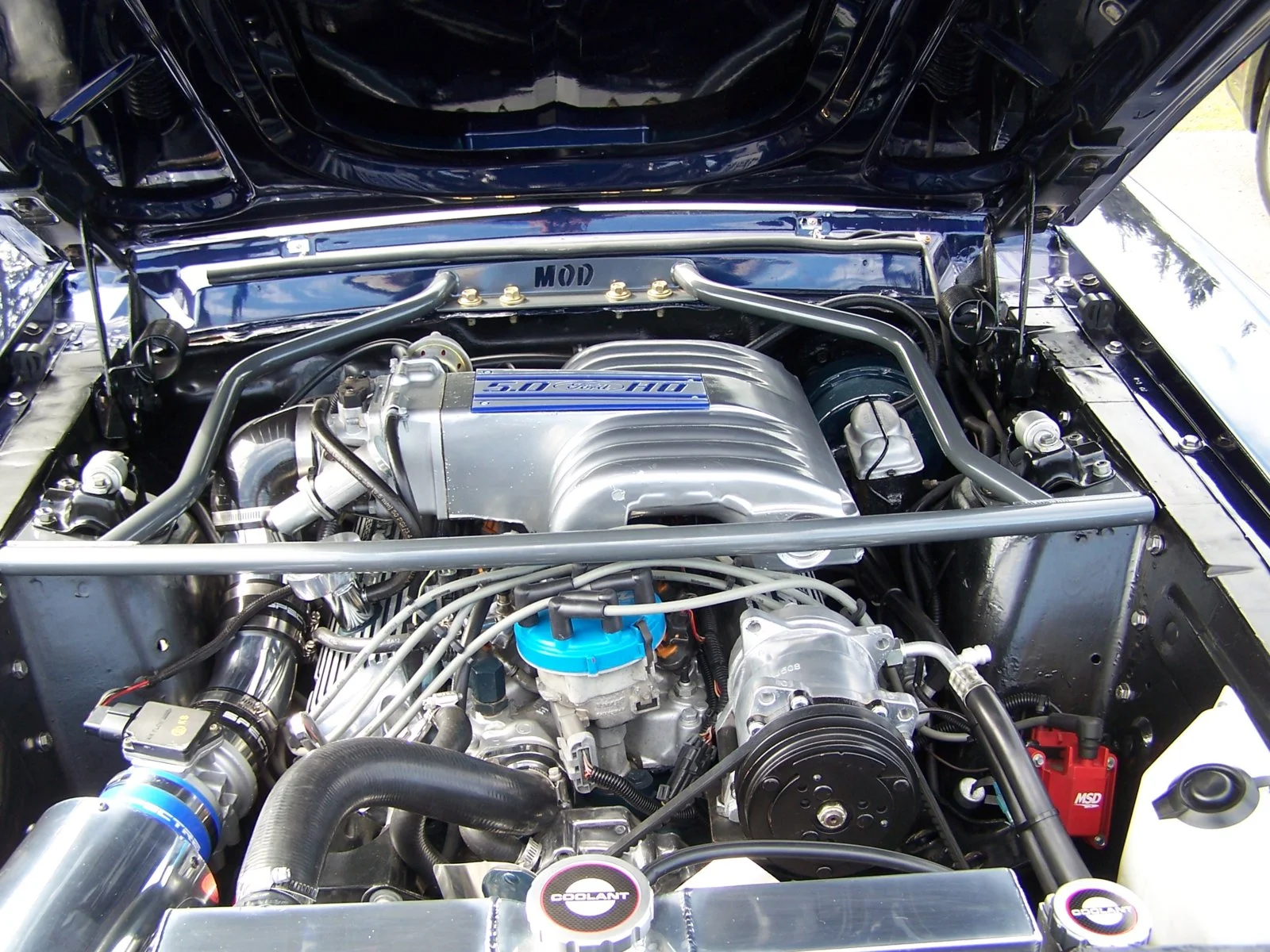

Howdy, 1st post here. Just bought a '67 Coupe with EFI this past week. A whole new learning experience. It's got a really nice body and paint but needs to be sorted out mechanically. I've seen posts here about export braces that will fit around the EFI, but most are older and I'm wondering if there's anything new out there. Looking at the Mike Maier one-piece brace for one.
TIA..........ed
My passenger side one still fits but the upper plenum is in the way of the driver side one. I was going to make a shock tower brace but got sidetracked. The alignment shop recommended a tower brace, says my towers are moving inwards messing up the alignment.

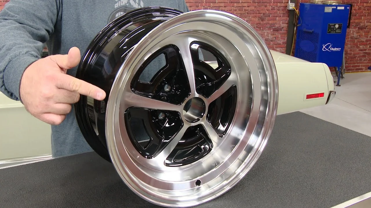

Well, it's feeling a lot like Christmas! Got the Magnum 500 wheels a couple of days ago, they look even better in person. Just waiting for a good sale on tires.

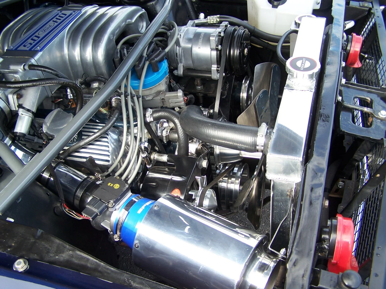

I'm going to modify my CAI to clear the brace. Picked-up a Spectre close-90 elbow that'll come off the throttle body and get the intake tube away from the brace. Then it's just a matter of adjusting tubing length and re-hanging everything. Piece of cake!
I was thinking of getting something in a silver color (instead of black), to match everything else under the hood. Well, just so happens the one brace that's powdercoated, in the box and ready to ship is a grey color and should look great. Got it ordered and he's going to ship it out today.
They do have other EFI braces already made up and awaiting powercoating, so you'd have a choice of black or silver as you prefer.
I'll post pics when it arrives and then I've got some work to do. Cheers..........ed
Long time no post, time for an update! Got a set of 235/55R16 Bridgestone Turanzas on sale from Costco; they ride smooth, are very quiet, and have good traction. Very happy with them after almost 1000 miles. I installed a new 9" diff, the old one howled like mad and was 2.48:1 ratio out of a Lincoln Versailles. The new 3.00:1 is better for acceleration and doesn't rev too high going down the freeway. I'd like to install an AOD but steering will be the next priority.
The MMI brace dropped on like Buttah! I was very happy with that and it seems to have helped. Looks great. I got a performance alignment and it does drive better. Still over-boosted and slightly wonky steering, but a Borgeson steering box conversion (planned for next Spring) should fix that.
The CAI turned-out OK with a few stock angles and an enclosed air filter box. No more surging idle!
