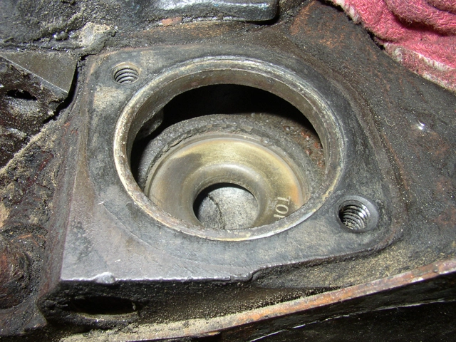

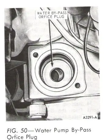

This picture make it appear that the bypass ring is FLAT.....I have a brass dish looking ring in there but I am wondering if there should be a flat ring that lays on top of that???? I have wondered if i have all the componants to that bypass in place, but I cannot find a good picture or parts break down to show me??????
No, it's not flat.
The 351C thermostat has this cup in the center, to seal the hole in the brass plate.
