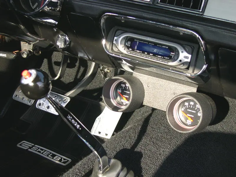

The radio you buy should be what they call a "DIN" mount. In the box there will most likely be a paper template you can use for laying out the opening on the bezel. I bought a new (repro) bezel for mine when I installed the radio. As others have said, a Dremel works great.
Here's a shot of mine installed:
I used the kick-panels already set up for speakers in the front. For the rear, I just got some gray carpeted 6x9 speaker boxes and sit them in the fold down area.

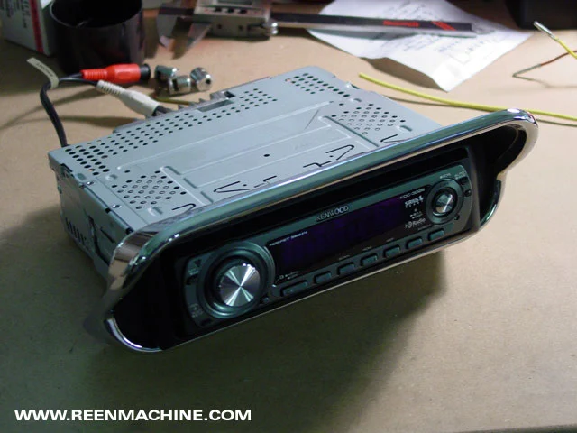

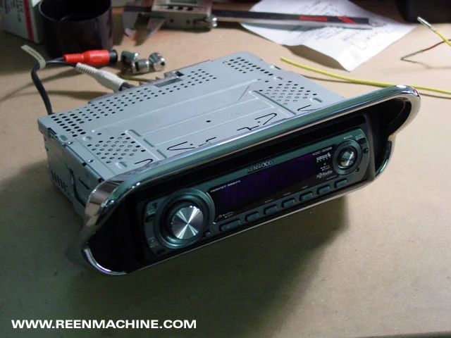

Just to add to the reference file, here's one I did for a '67 w/o console. It's a cut out reproduction radio bezel. I made a bracket that supports the back by bolting between the back face of the head unit and the dash structure.

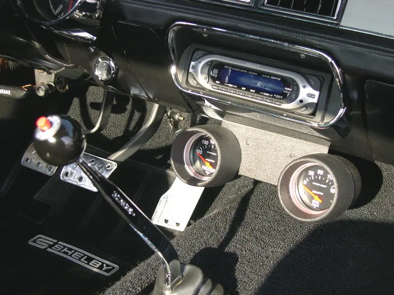

Here's a pic of my install of a modern CD player in my '67 FB. The console had already been cut so I didnt worry about cutting a original console. Took some modifying but I'm happy with the final result. Mine has a deluxe interior so went for the silver faced stereo:)
