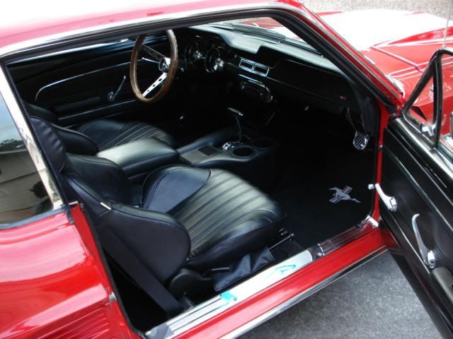

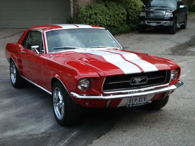

wow, iv'e read some goods things about them, it sucks not having experience because i'm so young and didn't grow up in a family with auto mechanics or any kind of shop at that. But i've always been interested in working on something vehicle related and always dreamed of owning a classic car and i finally came across a good deal and took up the oppurtunity. I've had the car for about a month now and have been happy with everything for the most part. These are the first pics iv'e posted online so far.
http://i903.photobucket.com/albums/ac239/IronLion123/mustang1.jpg
http://i903.photobucket.com/albums/ac239/IronLion123/mustang3.jpg
http://i903.photobucket.com/albums/ac239/IronLion123/mustang2.jpg
http://i903.photobucket.com/albums/ac239/IronLion123/engine.jpg

sweet car man! looks awesome! I have always liked the older stangs. I hope to pick up a 65 coupe someday.
