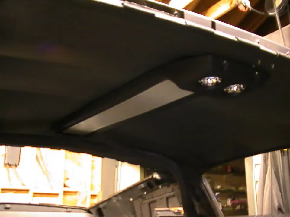

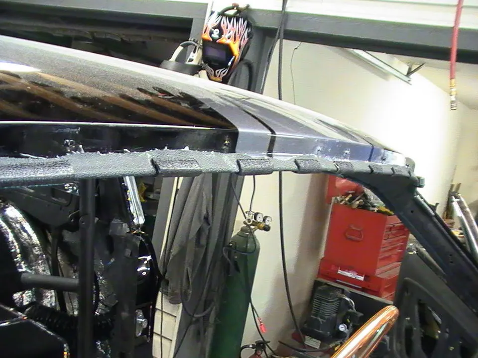

I installed the headliner. A good suggestion is to use the old windlace, cut it in to small 2-3" pieces and use them as a clamp while you glue it in place. Then use the new windlace around the doors when you glue. Do the doors first, then use all the small pieces around the front & back glass area when you glue the headliner there. Leave them on until you install the glass.

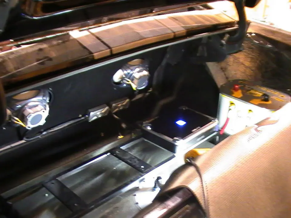

I installed the Alpine PDX 4.100 Amp and cleaned up the wiring.

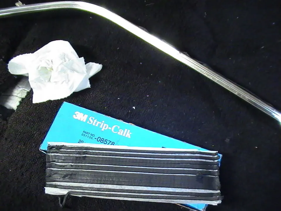

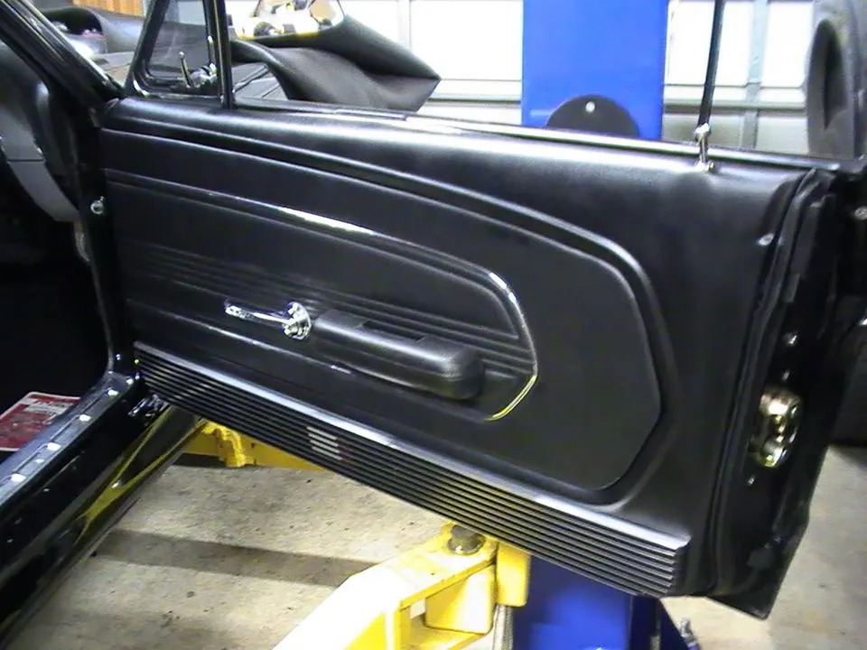

Door Weatherstrip Chrome Installed
I installed the chrome pieces around the door today. You can spend HOURS on this stuff to get it right. After that I installed the chrome piece that holds the weatherstrip. I used some 3M strip calk on the backside where the old cork gasket used to be. Just added two small runners to the chrome piece and then screwed it in place.

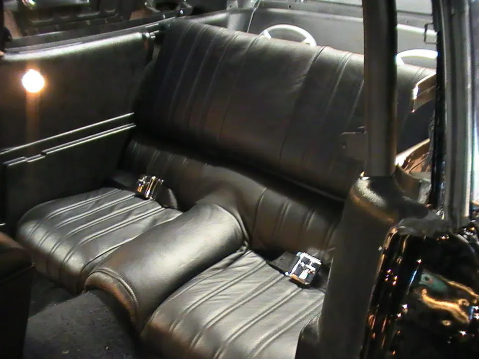

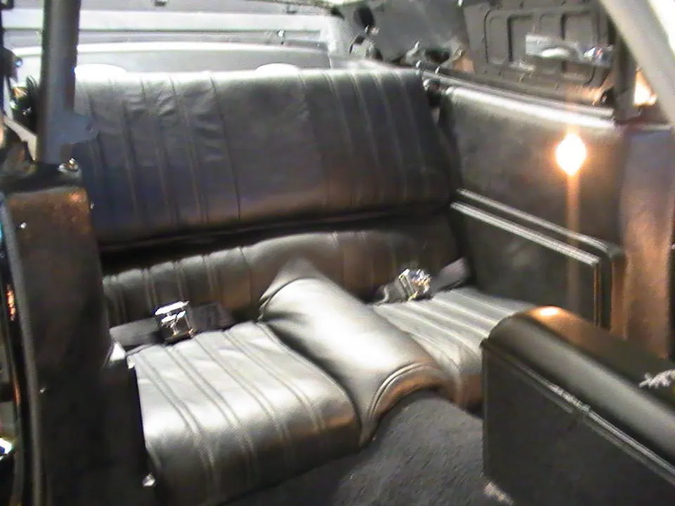

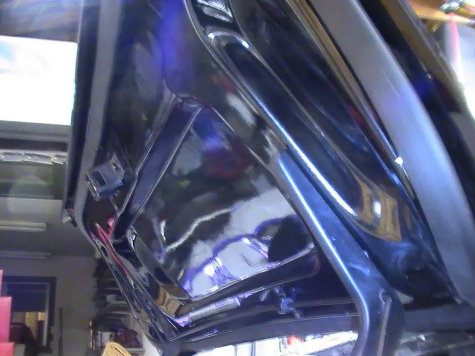

But the big story is I installed the rear inside quarter panels (3 times each to get them right with the roll bar cut out), the rear seats, seat belts, carpet, and console. Carpet is not all the way finished, but is about 80% done (mostly cut, in place, etc. )
I'm not worried about the rear seat wrinkle right now. After it gets out in the heat, if that doesn't do it I might spray a little water on in and rub it in!
Like my Mustang rear seat belts? Also, look at the trim moulding where the roll bar meets the rear inside quarter panels.

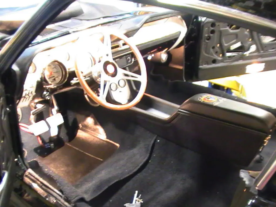

Carpet Finished, Overhead Console Installed

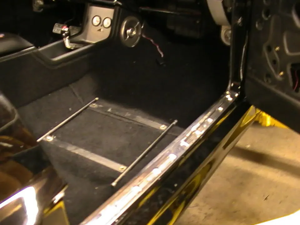

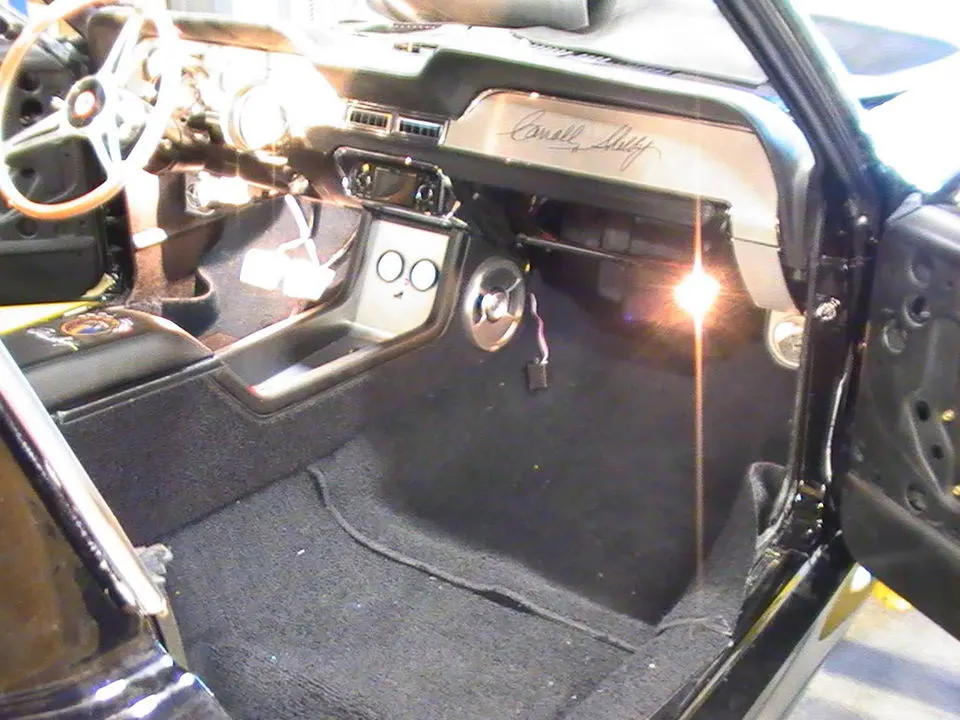

I finished the carpet. I have never been so glad that all the back breaking work is about done. I installed the center console for good. Installed the shifter. I had to bolt the bottom shifter bolt from underneath the console (when it was loose). The extra insulation and new carpet makes the installation process a PITA! Kick panels and door sill plates (stainless steel) are done. Well, I have one to go. Seat floor brackets are bolted down. Seat belt bolts were put in before the carpet. It sure makes it easier to find those holes.
I even installed the overhead console w/map lights! Installing those screws before the headliner made the process a little easier to find.
Doors are DONE, complete with molding, electric windows, handles, etc, etc. Many hours here. But they sound like a new car when they close:

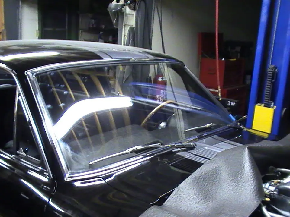

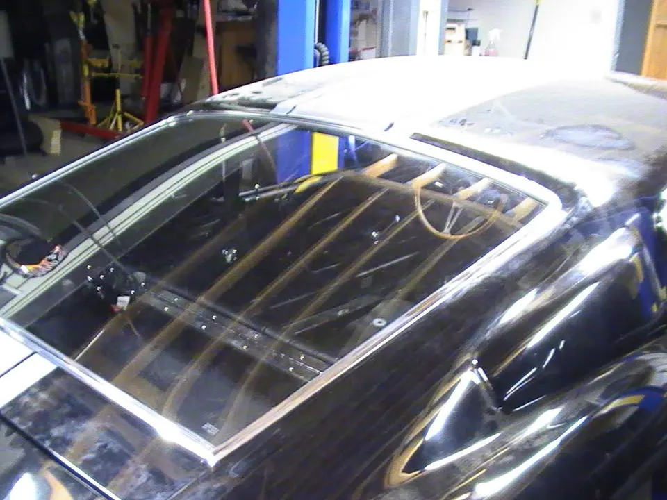

And the front & rear glass and chrome were installed today!

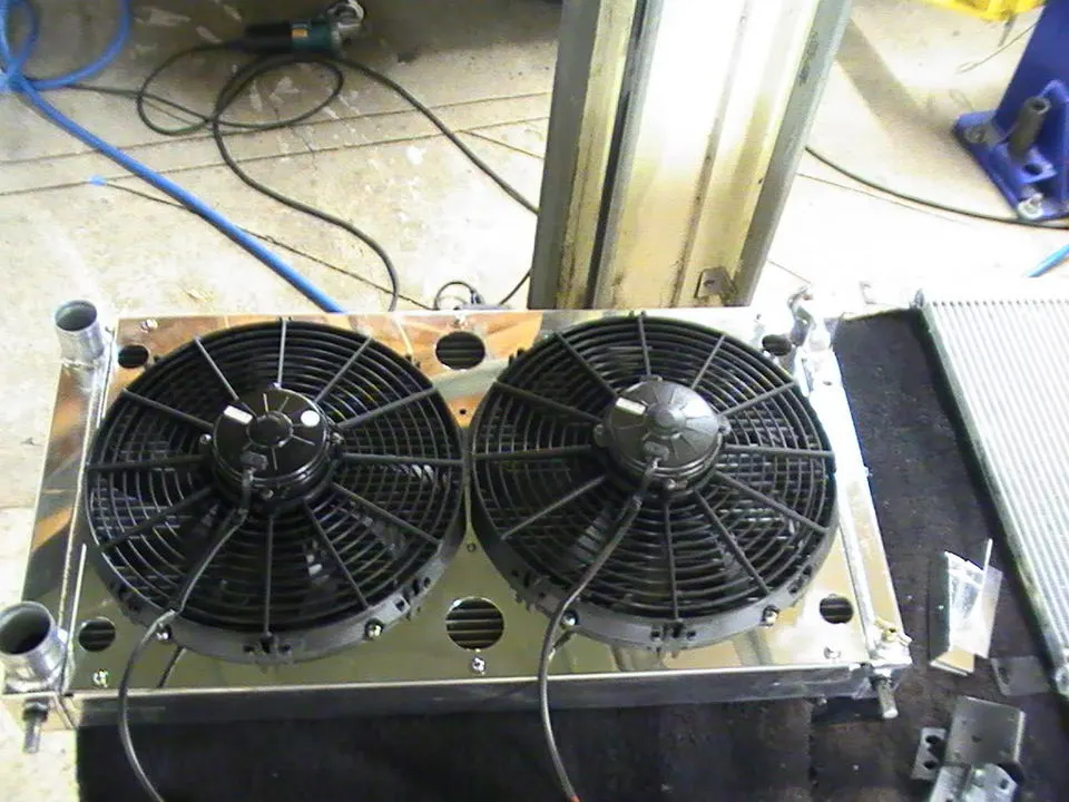

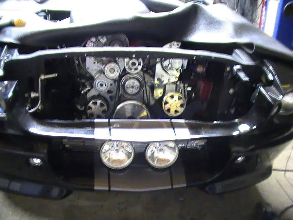

Radiator is 31" x 16", dual pass, inlet and outlet on the drivers side, filler neck on the passenger side, dual 13" 1720 CFM fans and shroud:

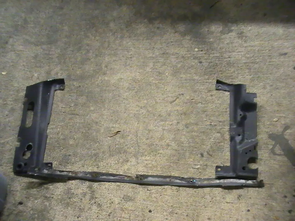

Anybody recognize these?

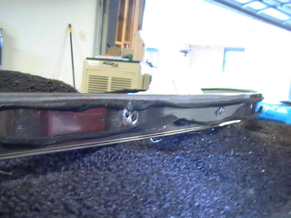

A big hole here, I will reinforce it with a piece of angle. I had to remove the A/C condenser and the brackets, cut them, move them to the back of the condenser, bend the lines a little, but it all lines up now. More pictures when I get the upper bracket to the radiator welded on. The lower radiator mounts are just 2 pins ( 1/2" ) with a rubber insulator:
I can almost smell the rubber burning down the road!
