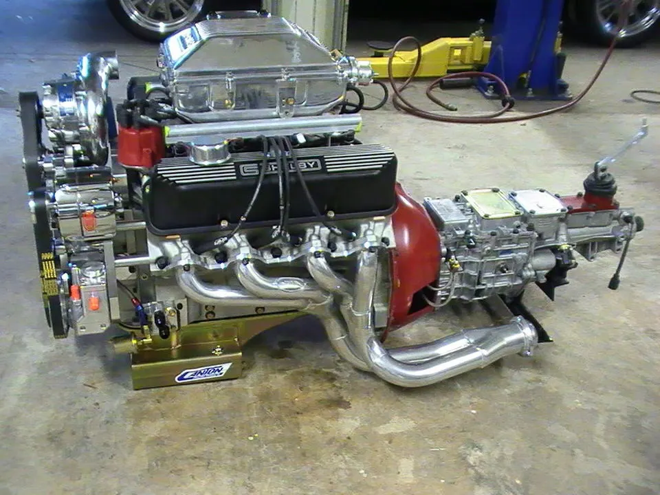

Bell Housing

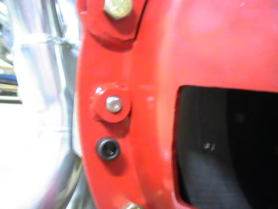

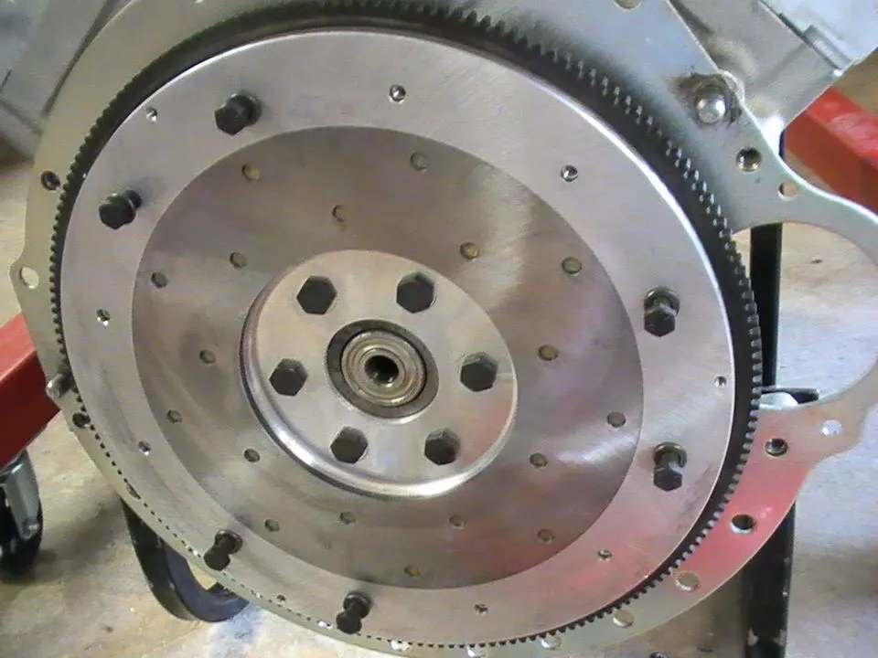

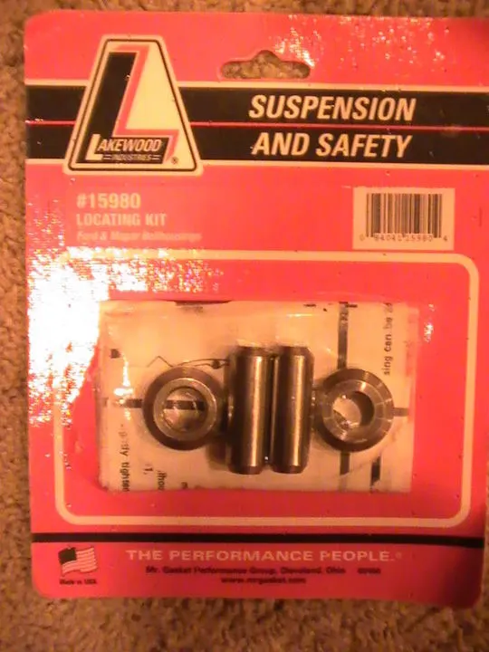

The bell housing is a big problem. The dowel pins in the block are very tight. I called Keith Craft and he told me that he had a kit and I did not need to remove those dowels. Got the kit, it includes longer dowel pins and a larger washer that welds to the outside of the bell housing. Just drill out the original holes to a larger size, move the bell housing in to place, and weld on the washers. Will call Keith again tomorrow and verify that I DO need to pull those pins.

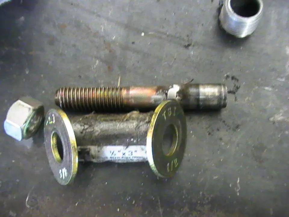

I was stewing about how I was going to get those dowel pins out without hurting that aluminum block. So I designed a dowel pin puller out of a piece of pipe, a grade 8 bolt, nut and two washers. With a little welding it worked great. Anybody that has a Shelby/Aluminum block take note. They were in there tight.
Centered the bell housing and welded the washers in place. Looks factory after I painted them, huh.

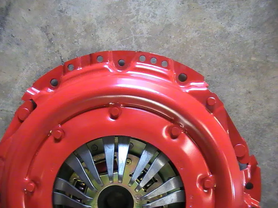

Ready to go. No. Wait. My pressure plate is a diaphragm, and the flywheel is designed to the long finger (or Ram) pressure plate. Well, after a long discussion with Keith Craft and Rob in Plano, we are making a change. Dual disc clutch setup. Clutch, pressure plate and flywheel all with be changed. So I just assembled what I could.

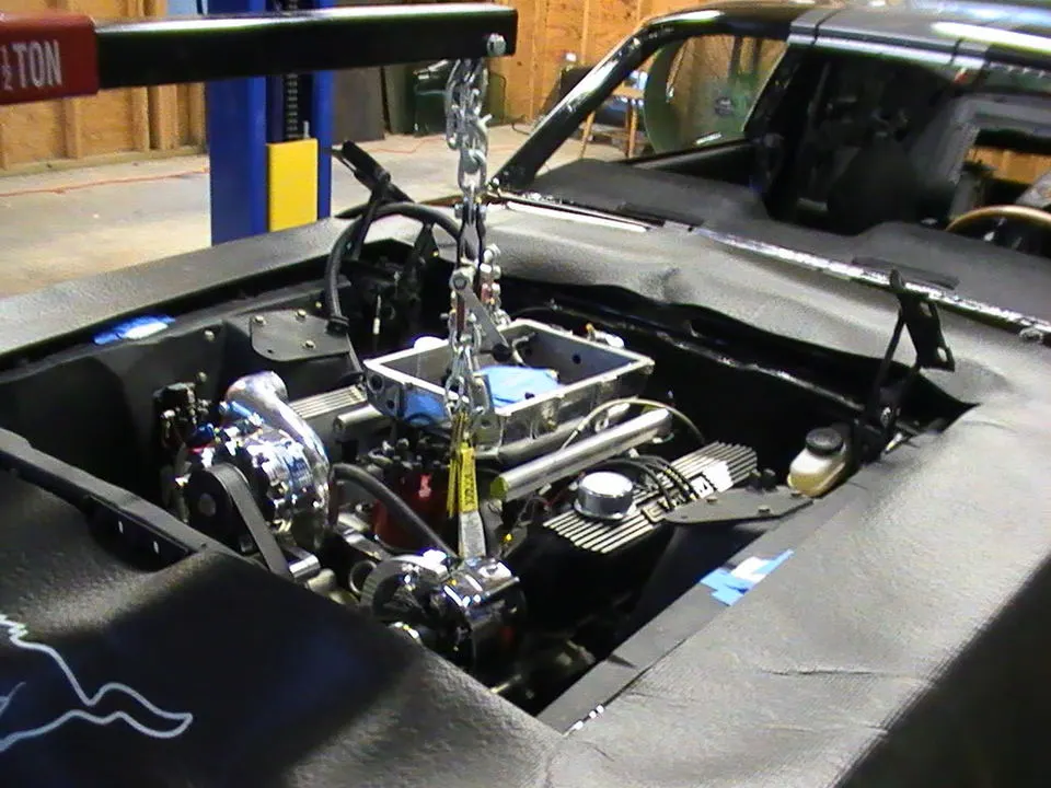

Engine Installed

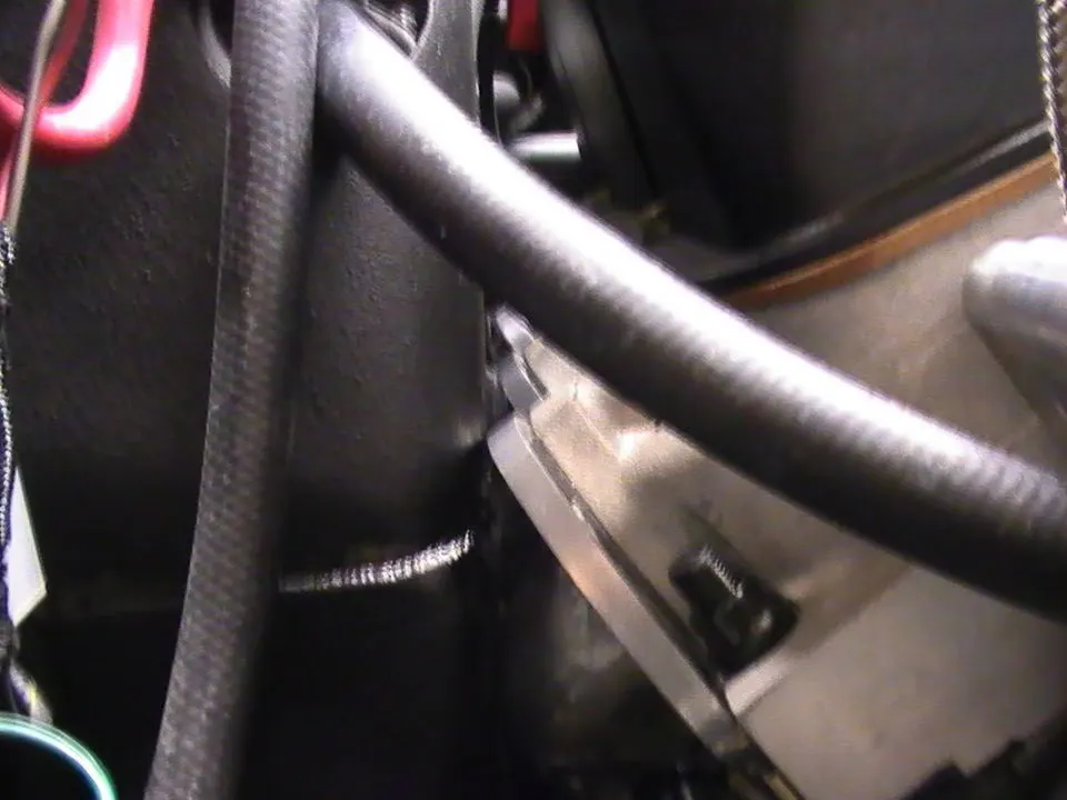

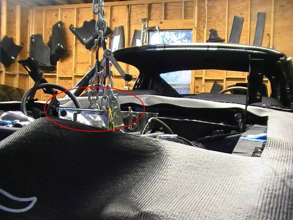

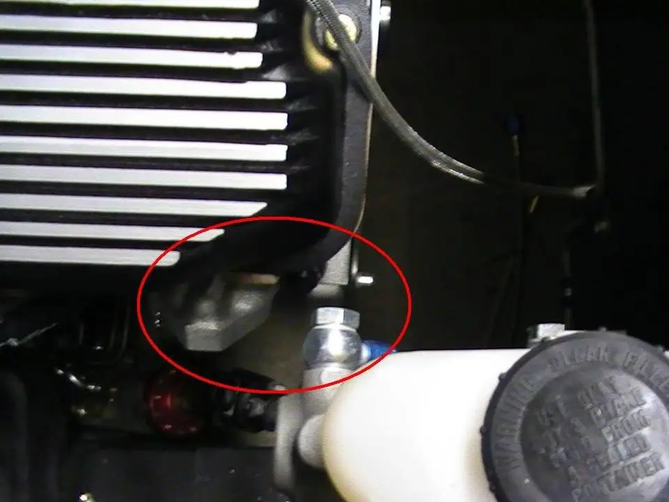

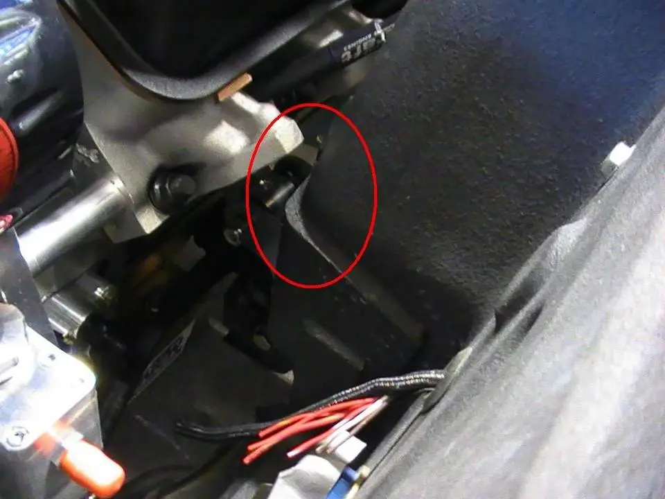

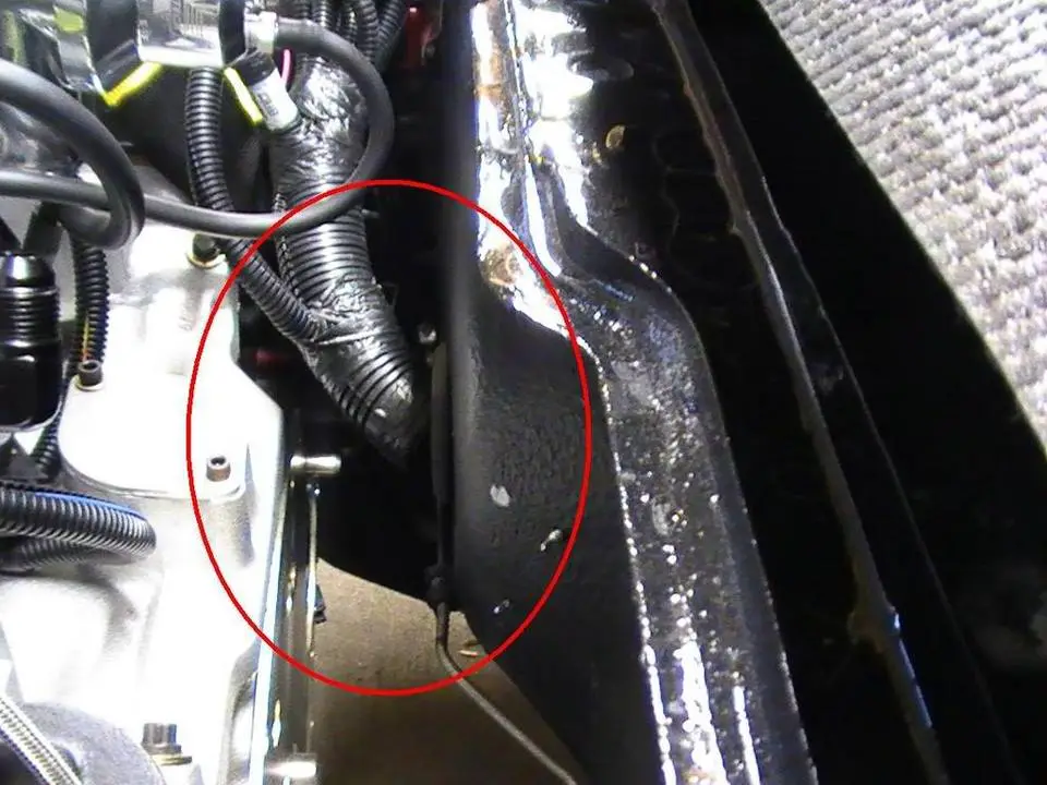

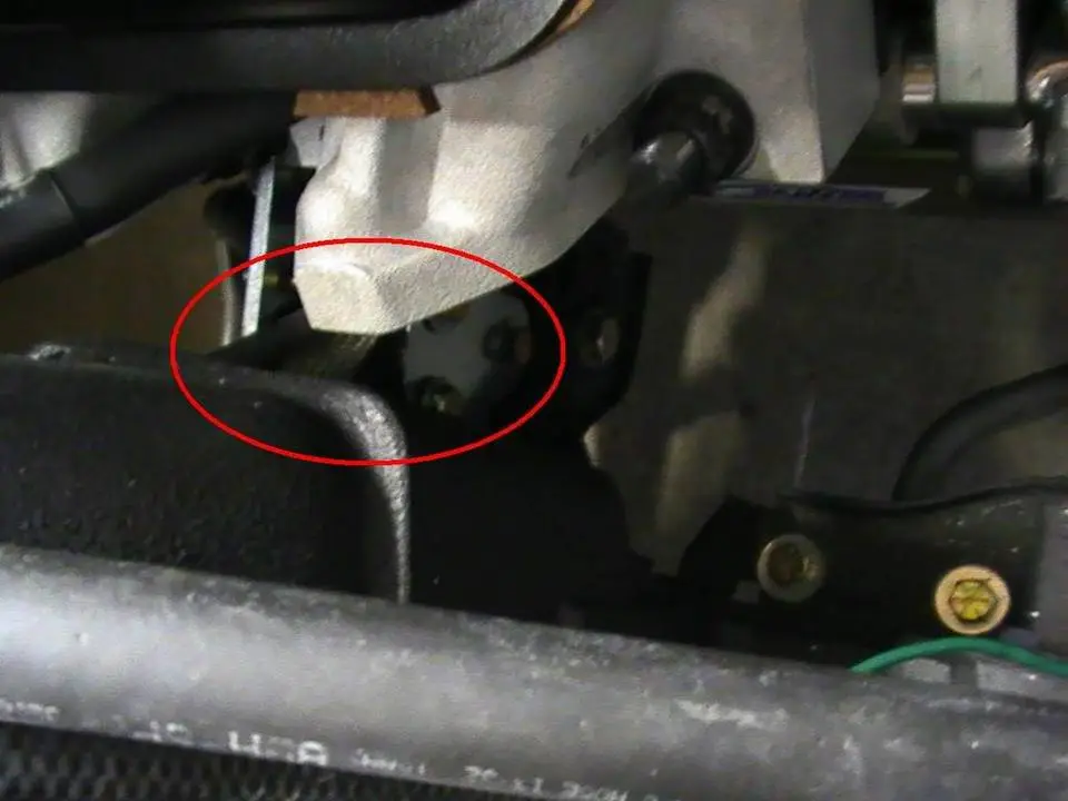

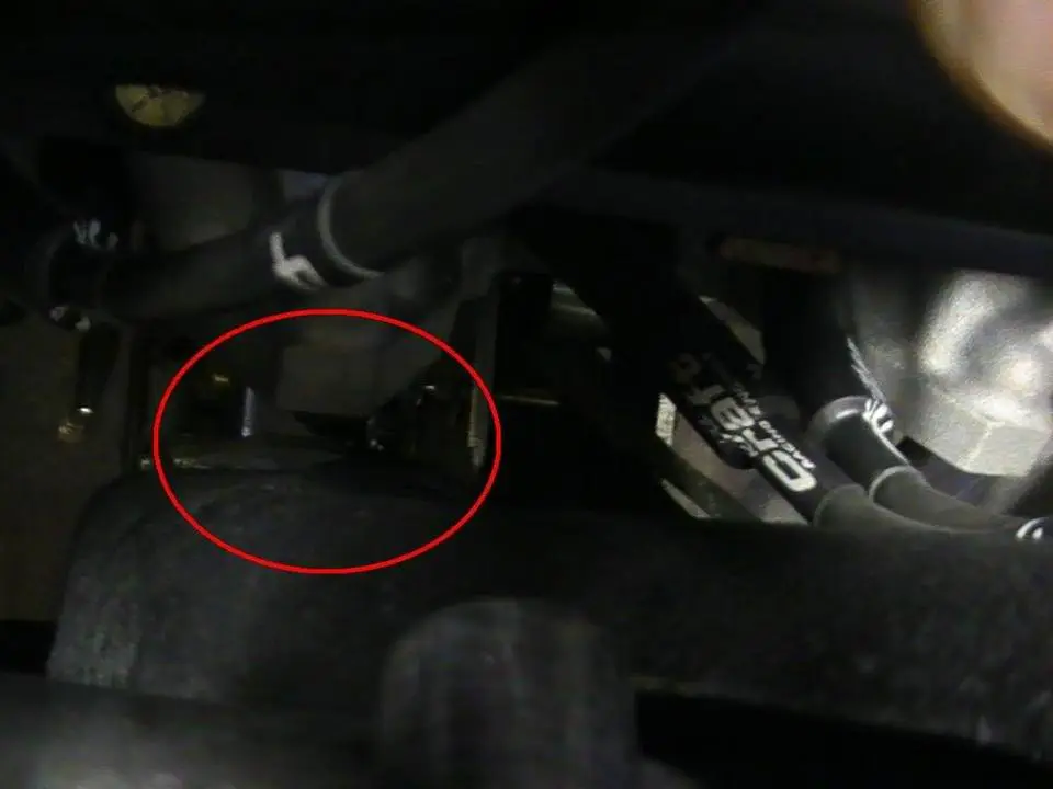

Engine has been set in the engine bay. Headers have not been installed yet. I just wanted to see the fit. You can see by some of the red circles in the photos that I have some clearance issues. Anybody installing the shock tower bracing and a FE engine will have to do what I am going to do. I need to grind down the upper areas to clear the header bolts. VERY TIGHT!
Pasenger side rear:
Passenger side front:
Driver side front:
Good clearance here:
And I was wondering if where I have cut through the firewall was going to work. It will work just fine:

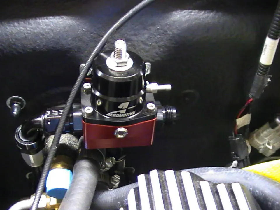

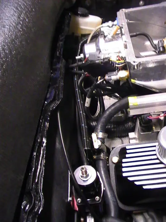

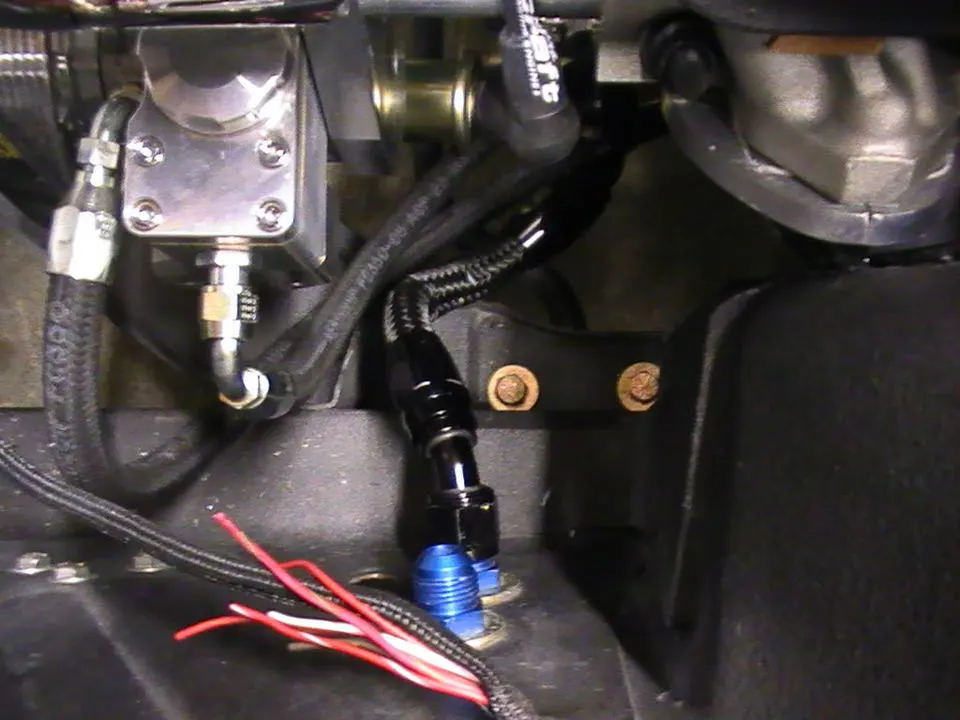

I mounted the fuel pressure regulator first:

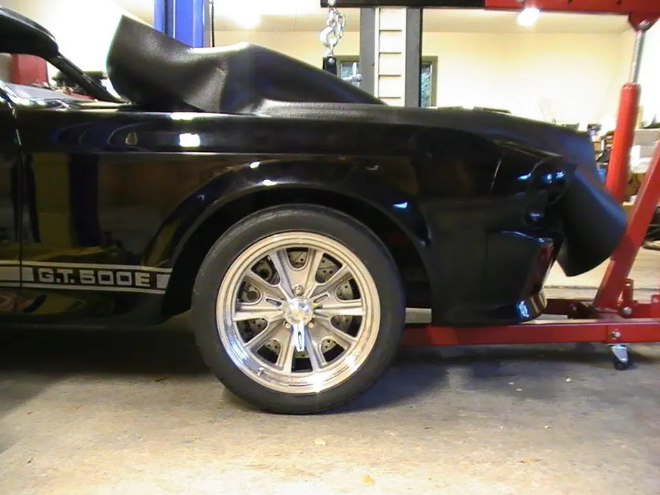

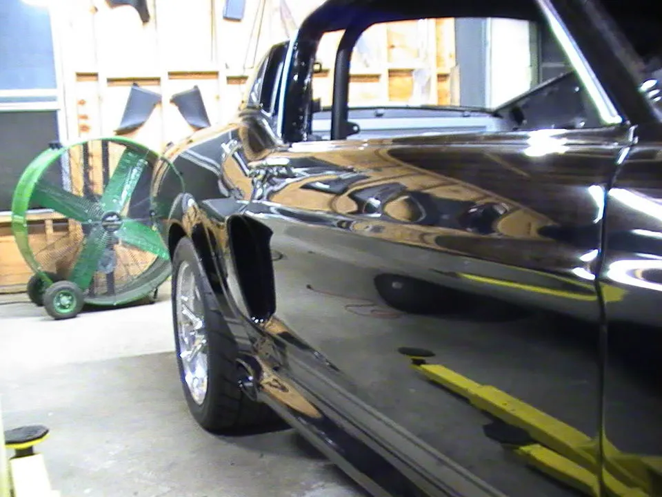

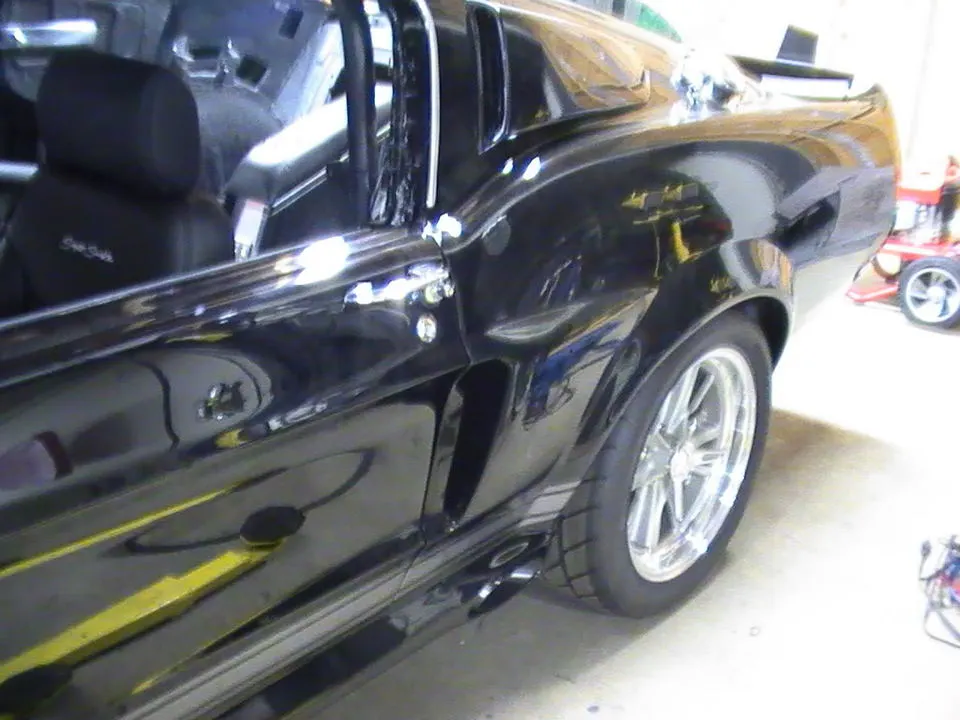

Good thing I have a high hood:

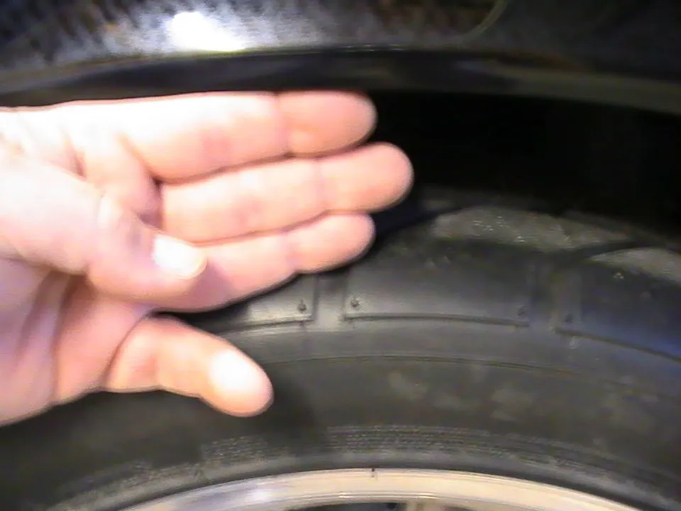

But the engine weight only lowered the car a little bit and didn't change thew stance very much:

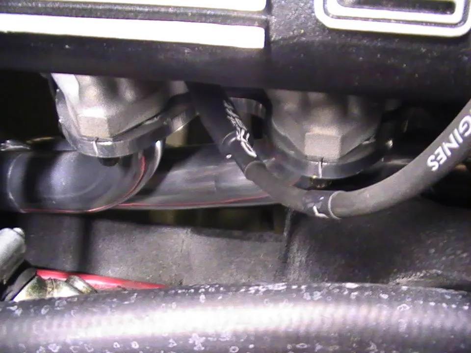

I installed the headers. A shoe horn and a little grease was needed.
They are touching the shock towers. I may need to loosen the motor mounts and lift the engine.
I started hooking up the oil and PS lines.
I hooked up all the EFI wiring, some water hoses, vacuum/boost lines and other little things.
