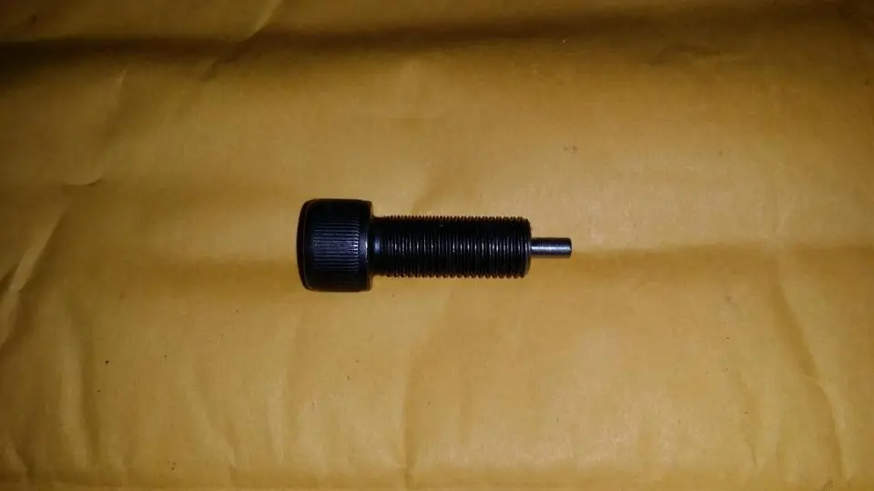

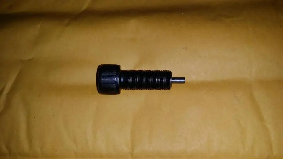

It would also be a good idea to spend the extra $10.00 bucks for the valve lock tool to keep the pressure differential valve from shifting, when you begin to bleed the brakes out.
https://www.musclecarresearch.com/brake-valve-tool

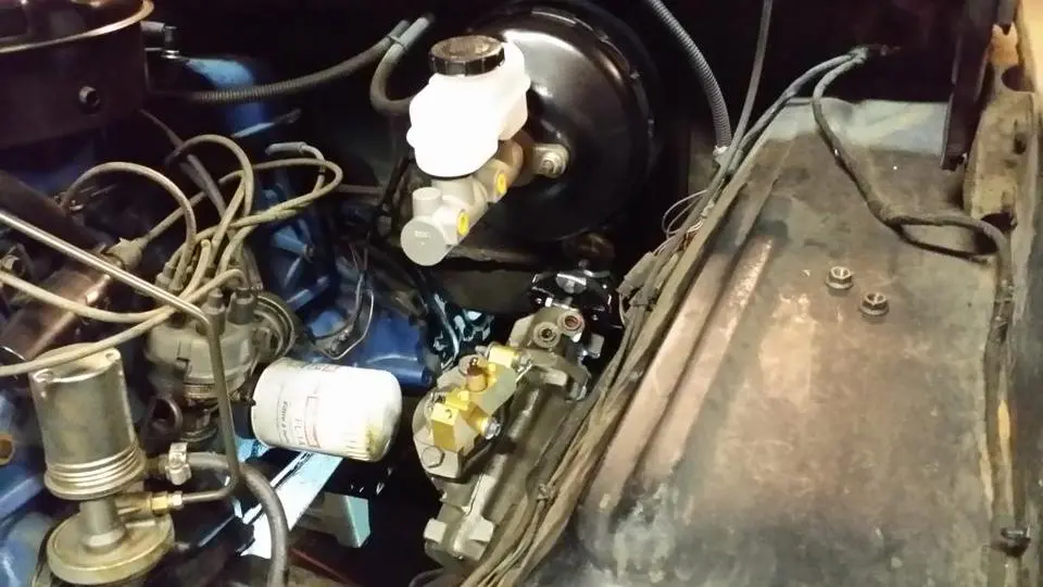

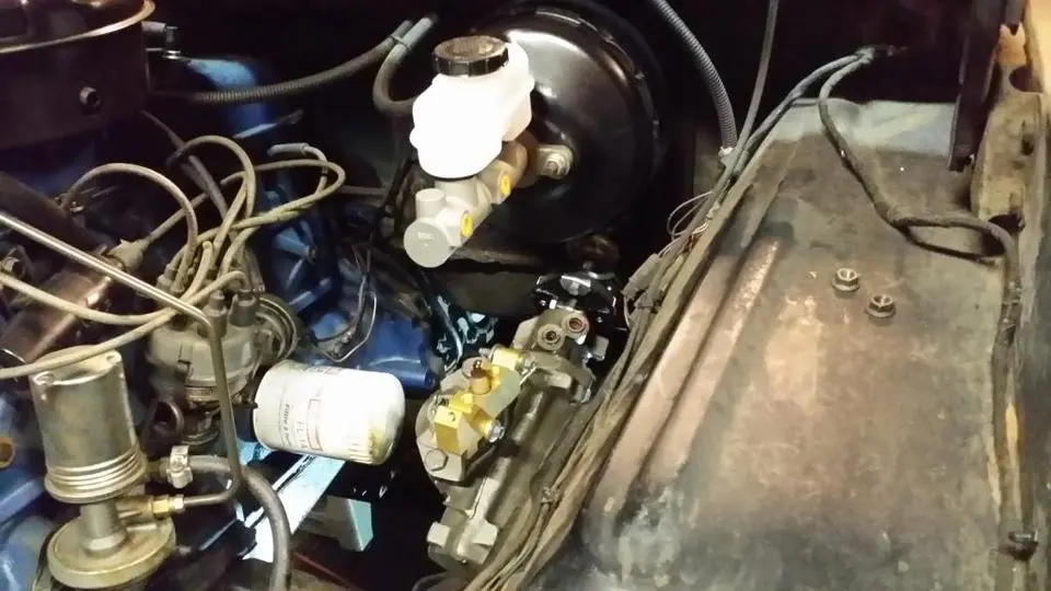

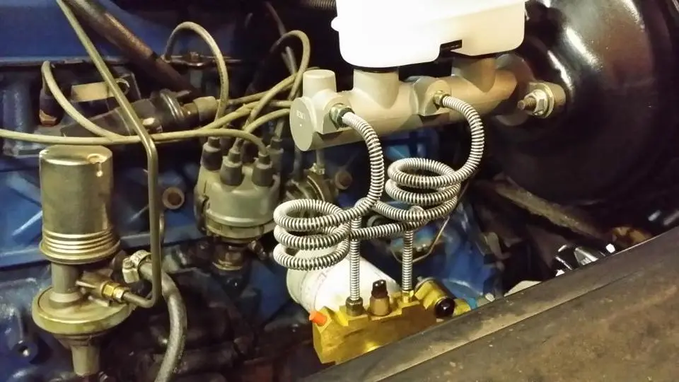

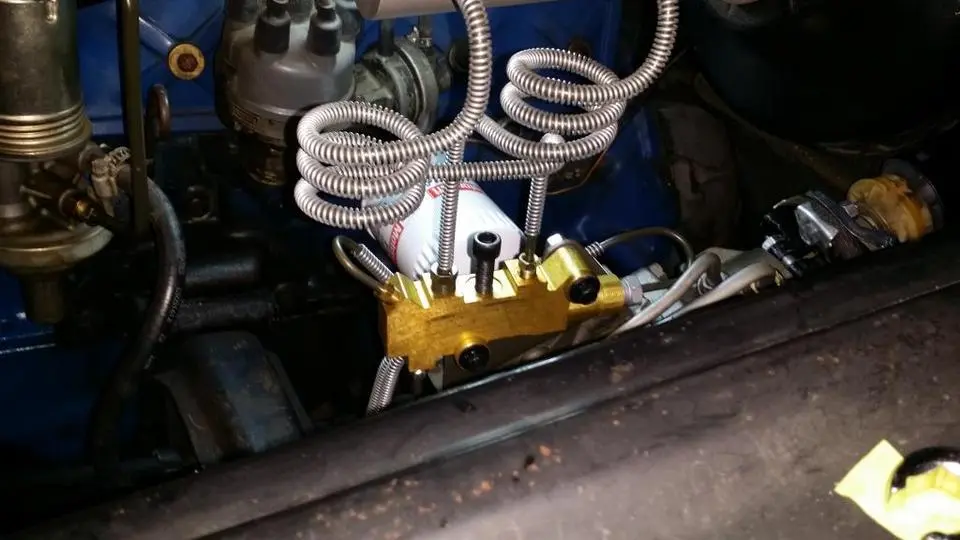

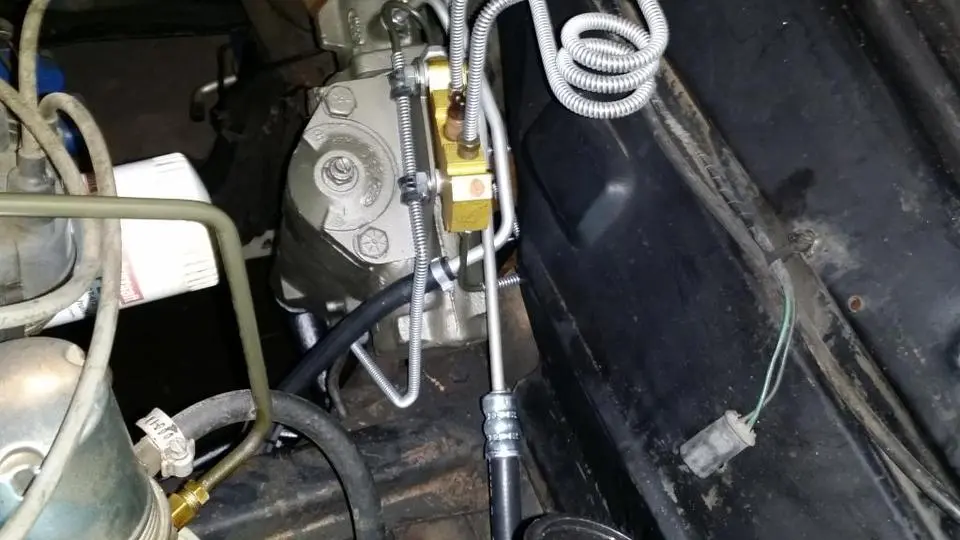

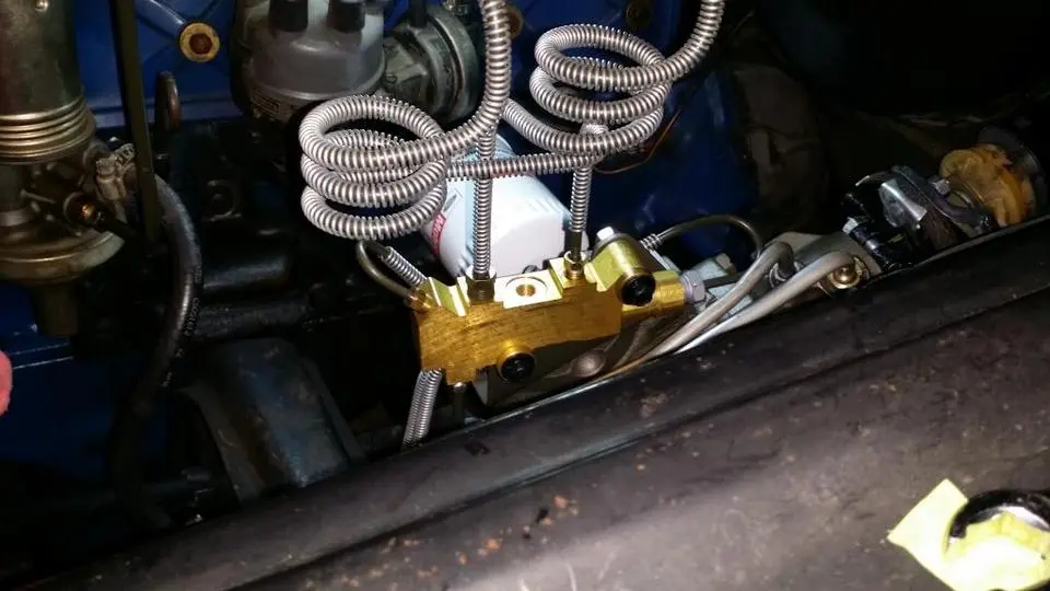

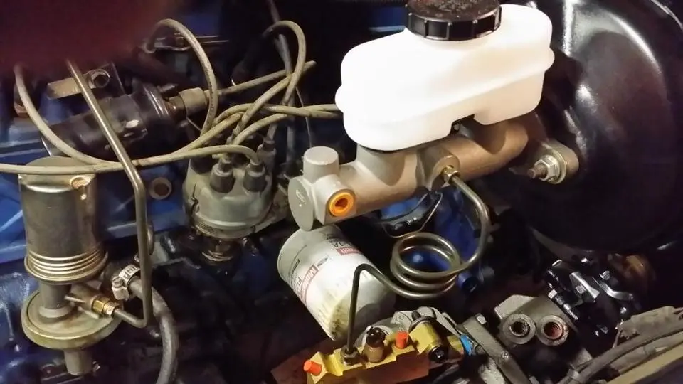

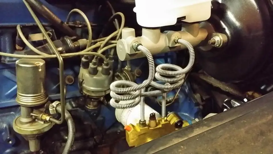

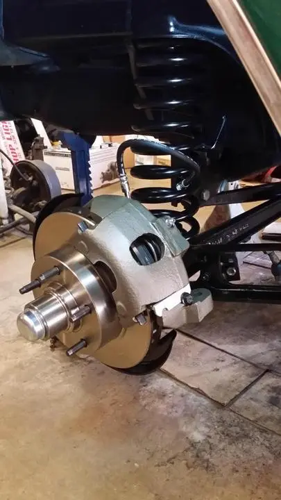

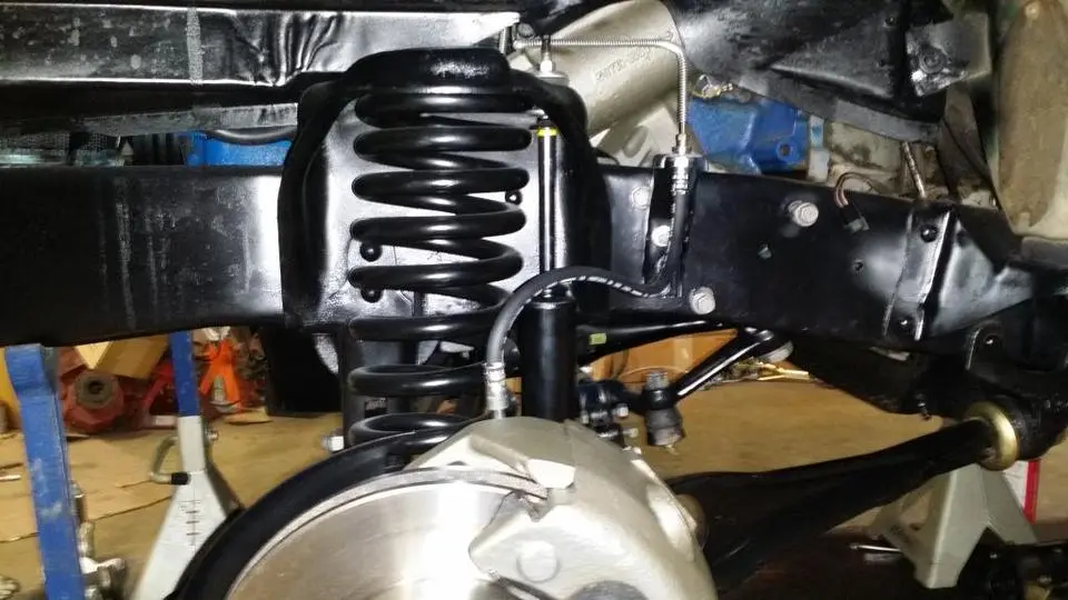

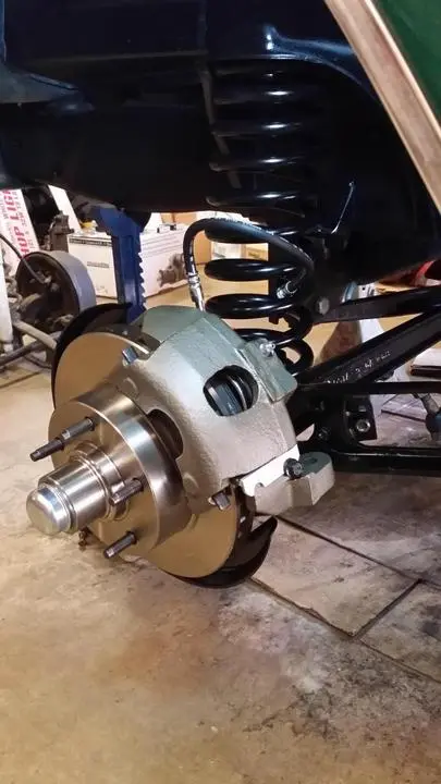

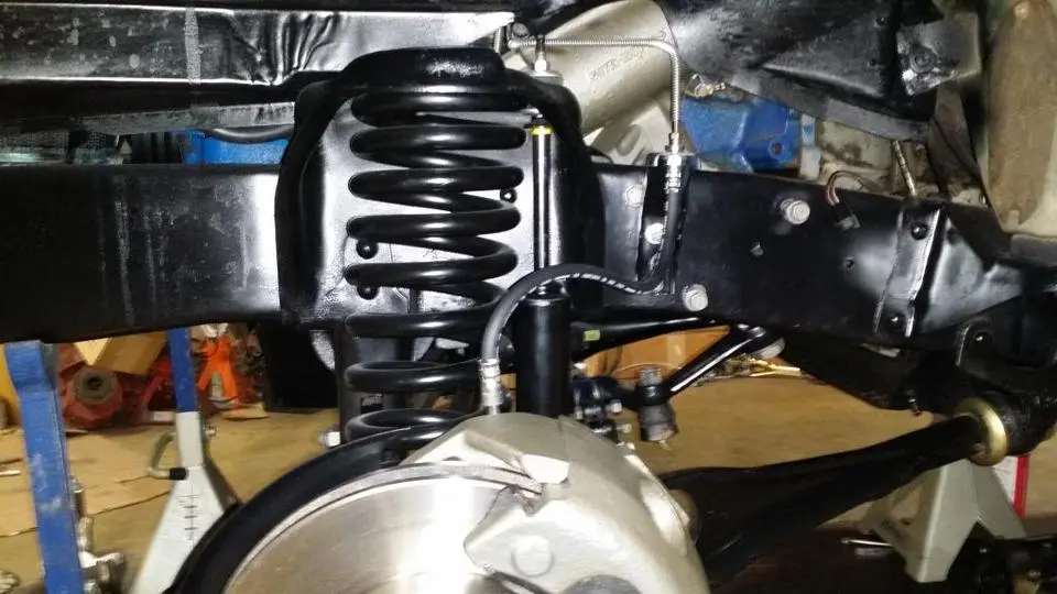

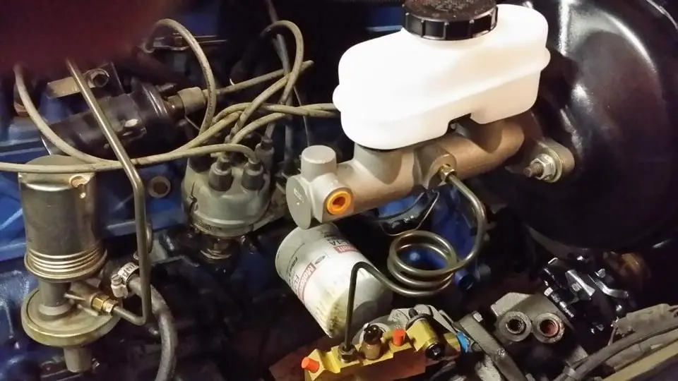

I have one of these pressure differential valve lock tools ...in fact, I just used it recently when I converted my '69 F-100 short bed Ranger from front drums to front discs from a '77 F-100. I also fabricated all the brake lines for this swap.

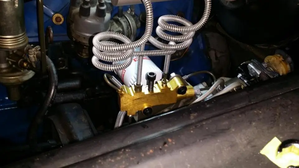

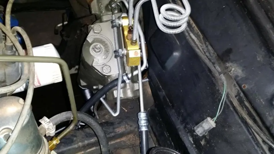

Brake warning switch removed from disc/drum combination valve body...

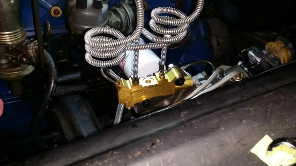

...pressure differential valve lock tool installed to begin the process of bleeding out the brakes.
The valve tool works like a charm and no annoying red brake warning light coming on while bleeding the brakes out.
