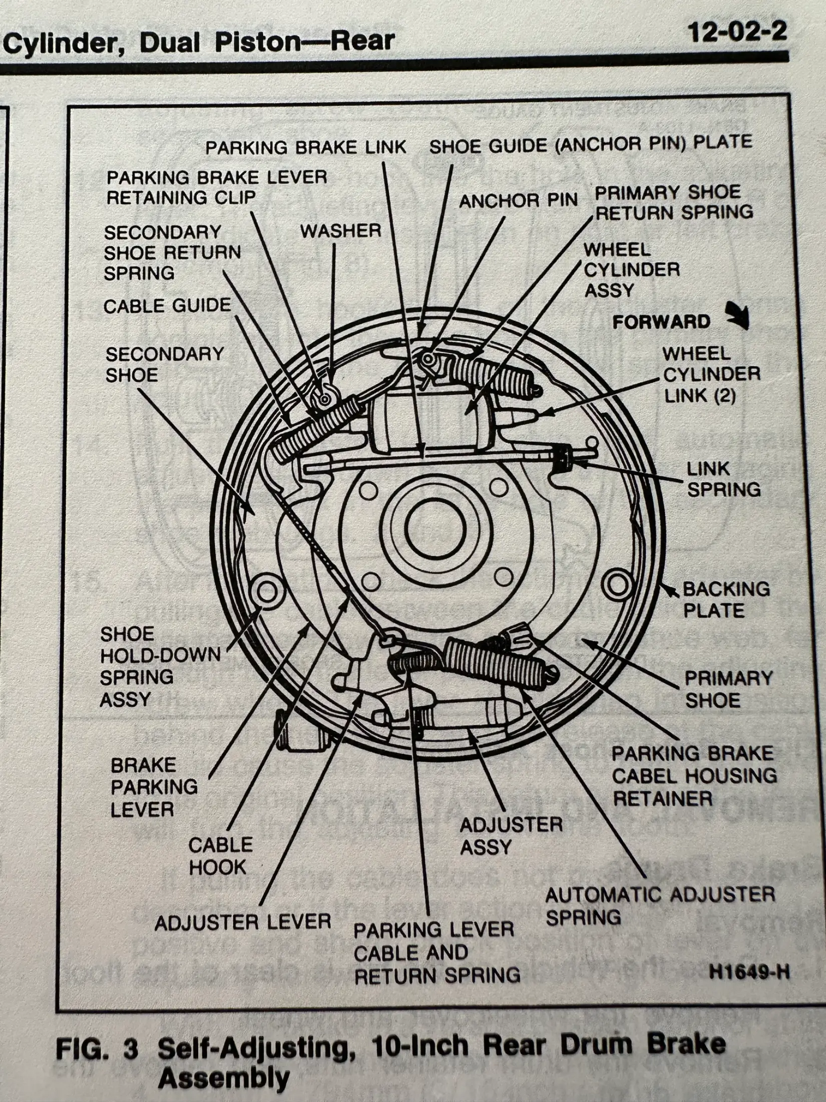

Gee…I got rid of my rear drums a long time ago and my memory isn’t that great anymore, but there should be two springs connecting the two shoes to the anchor pin just above the wheel cylinder. These springs should cause the wheel cylinder pistons to pull back into the housing when you release the brake pedal. Here’s the ‘86 drum brake from the ‘86 shop manual.

I suppose the master cylinder could be on the fritz. But I suspect the left wheel cylinder was junk out of the box as the right side works just fine. So I'll find out in about two weeks when my schedule permits me to get this done. I'd love to go to rear discs but that's a little cost prohibitive now and I like originality. Drums work but can be a pain. Shall keep at it. Would love to find original brake cylinders.
