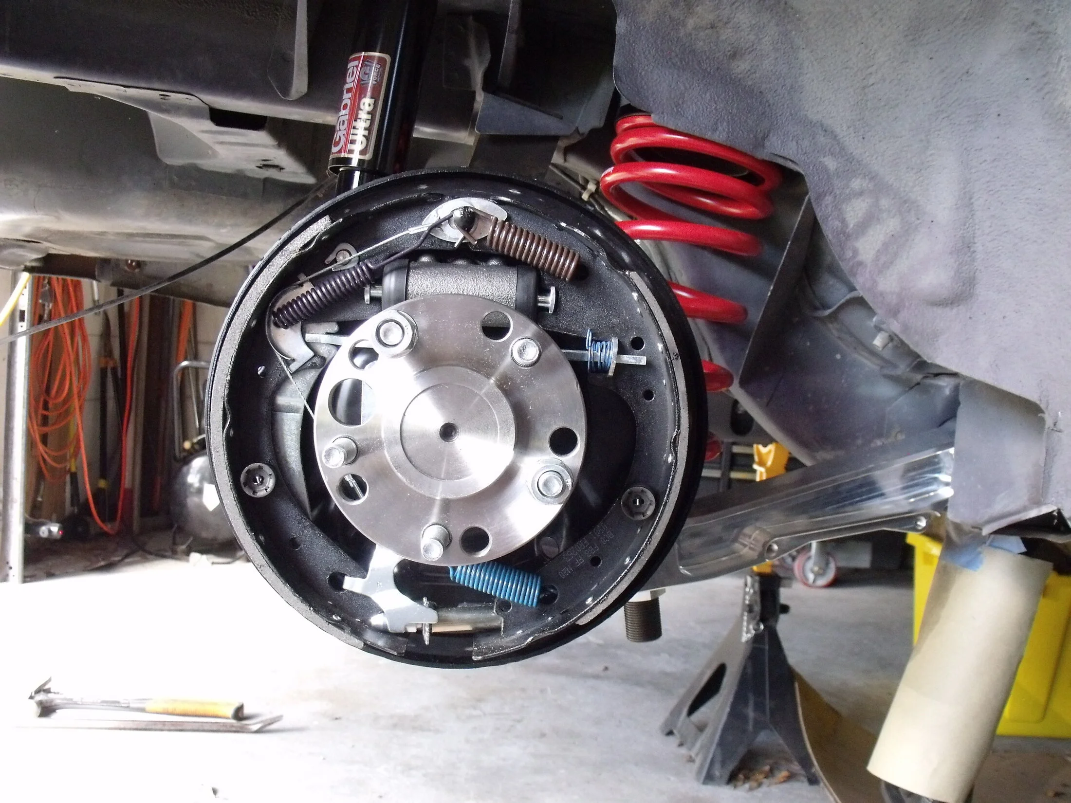

I had to rebuild my drum brakes too.
Have a look at the photo and see if yours is assembled like this one.

Like Limp said do one side and look at the other. I did mine last month for the first time and they are difficult. As usual the first side was pure misery and the other side went right together. If your car is killing you mentally get the most money you can. You have a lot against you.

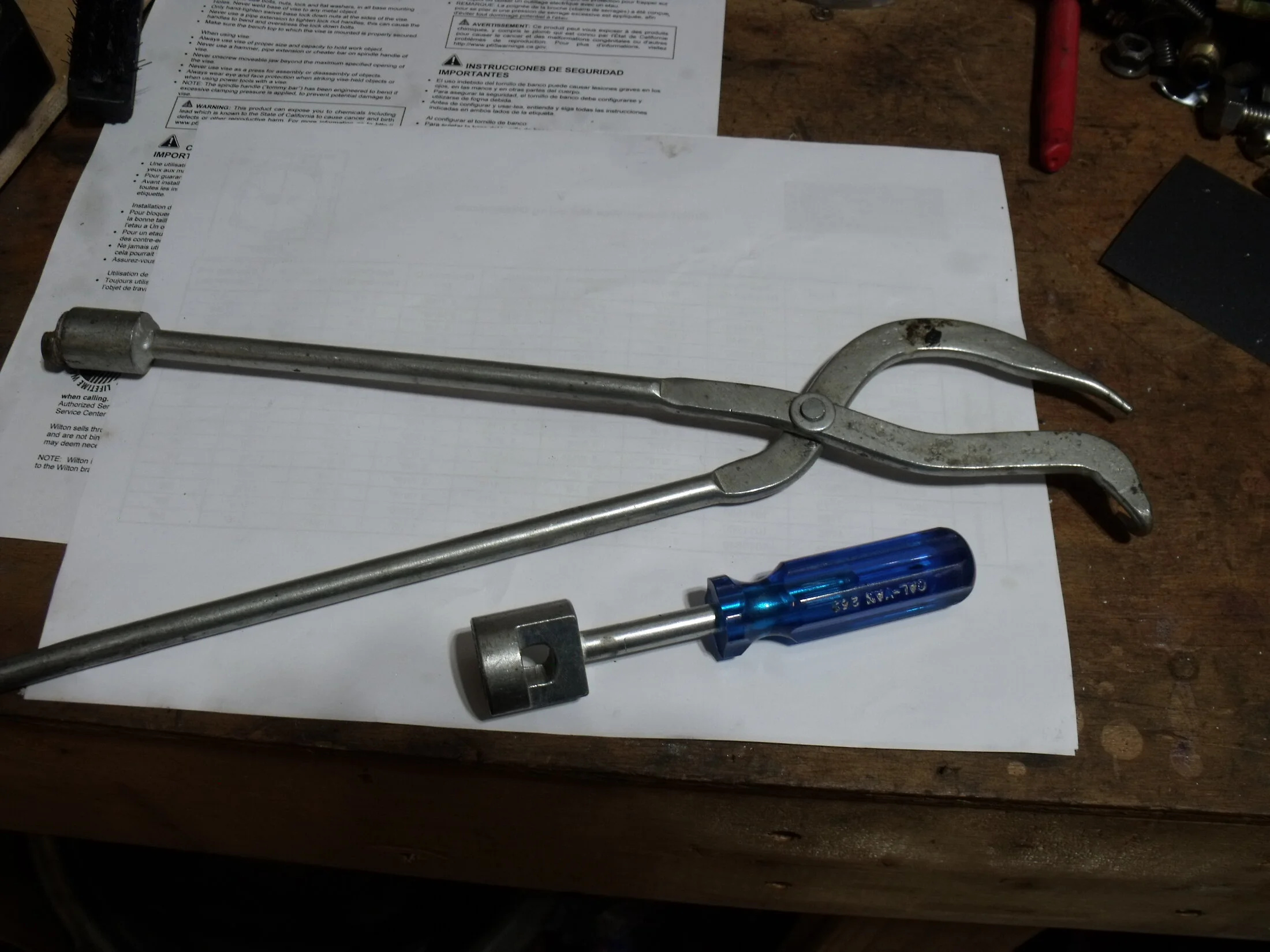

Two " must have" tools needed to work on Drum Brakes...
The blue handled tool installs the brake shoes.. The keeper washer fits inside the end and you just push it over the Pin, you hold with your other hand from the backside of the backing plate, twist and your shoes are on..
The larger tool is what you use to remove and install the longer springs you attach to the post at the top of the shoes.... The tool in my pic is a cheapy, if I was to buy another it would be the best I could buy.......

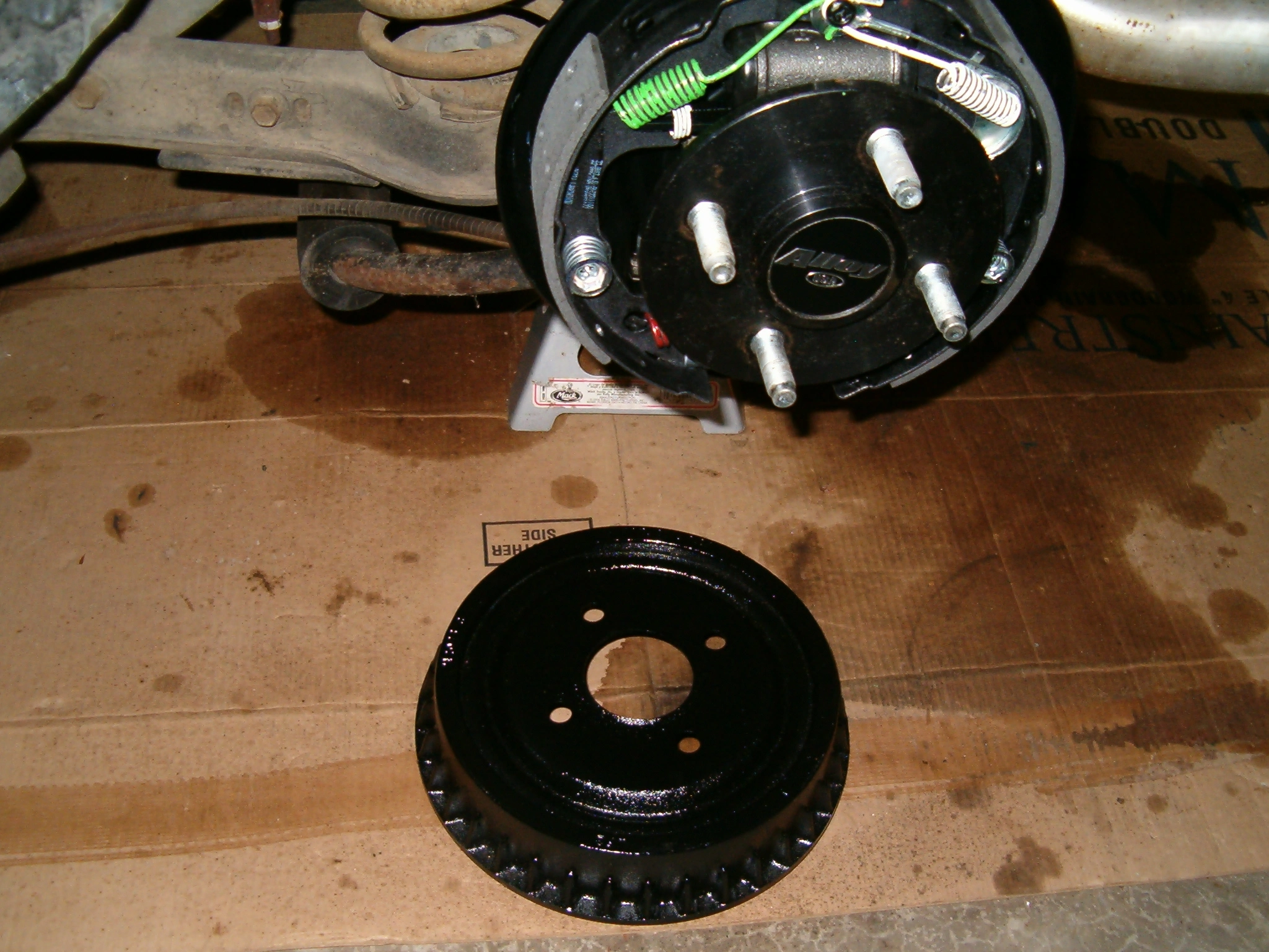

Installed shoes on my new rear.
Reactions: slow84lx
This is a good time to rough adjust the shoes to the drum...
Twist the bottom adjuster so it pushes the shoes outwards..
Install the drum looking for some slight drag.. Remove, adjust, install until you get the light drag.. Too tight? remove drum ( or if you can't get the drum on now) and turn the adjuster the other way a few clicks to loosen it...
Then do the final adjust with the drum on from the backing plate side... There is a rubber plug sometimes you need to remove...
I like to tighten it up as tight as I can, then loosen, counting your clicks till I get just a little bit of drag when spinning the drum by hand...
Try to adjust the other side to the same amount of " clicks ' when backing off... Sometimes you can't, and thats OK...
Tightening and then loosening it seems to work all of the shoes, cables and springs to allow a better adjustment then just tightening up to a slight drag. At least thats how I was taught and how I do it... If you have to start over, just tighten it up fully and do it again...
Remember to make sure you emergency brake is not on when doing this.....
Hope this helps
