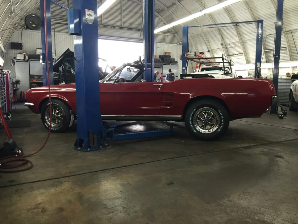

Thanks for the reply, if you have a minute can you please post side pics of the car to show the 1" drop?
Here's a pic I just got from the tire shop. I'll get a better one up here when I pick her up. Keep in mind that the rear springs are brand new, so that lifted the back just a bit as well.
