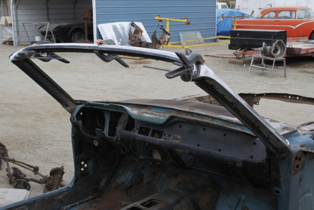

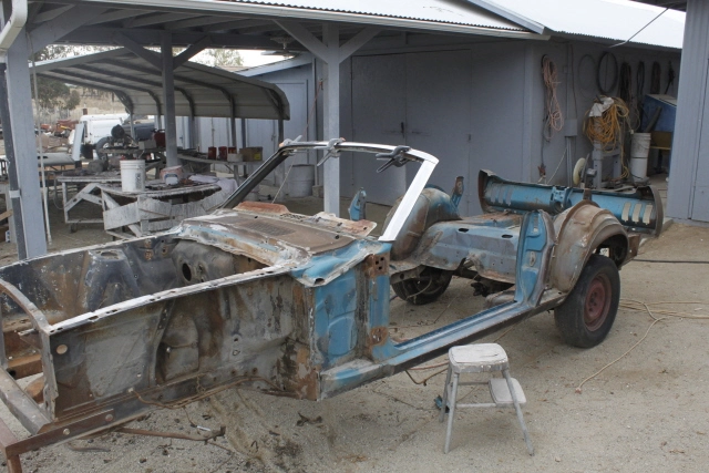

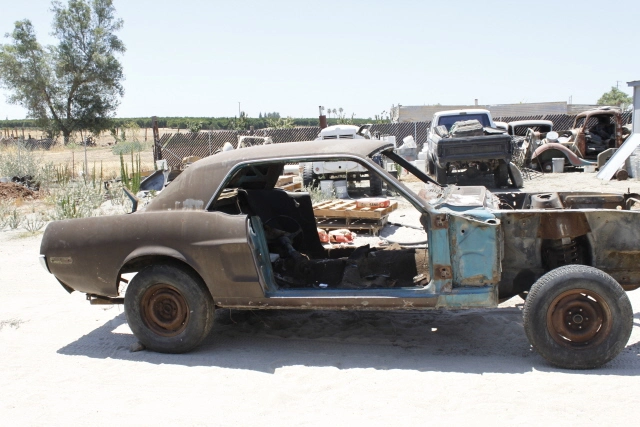

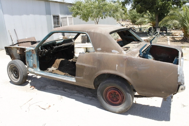

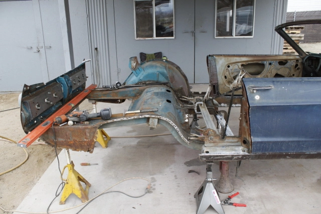

It's time to build a convertible . This is my freebee 68 coupe .i have already started cutting it apart .
it needs a toe board patch on the driver side and the top of the torque box needs a patch but other than that the frame work is very good. I have the convertible back seat area from another rotted out convert ,It still has to be trimmed out . I have new floors ,seat box and under boxes ,inner rockers and rear wheel tubs, brand new quarters and a few other pieces all for a convert, ordered . This one one will be finished as a 67 Shelby convert ,always wanted to build one . I have a few of the fiberglass pieces already but i still have to order the hood and nose section. I have already trimmed the window frame and test fit the window stainless and it fits perfectly.

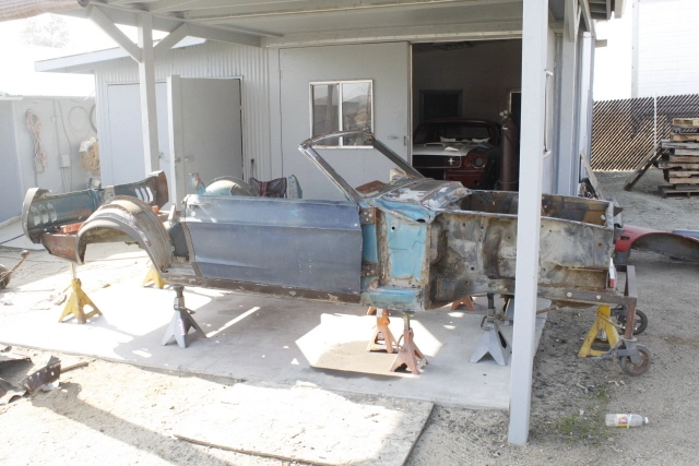

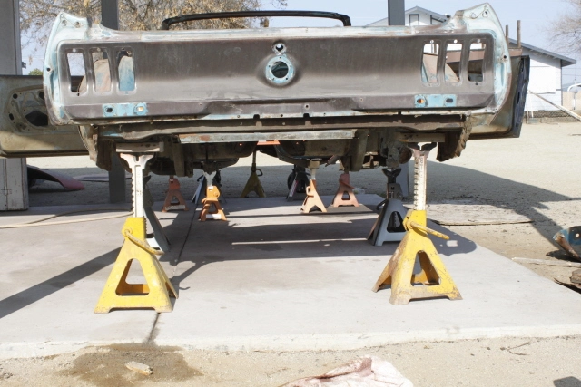

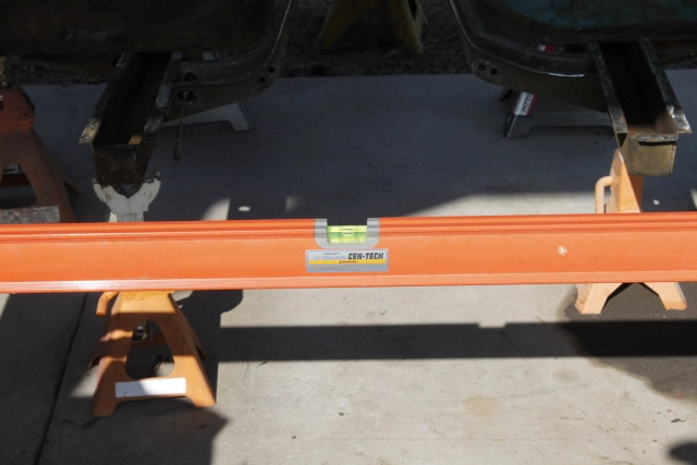

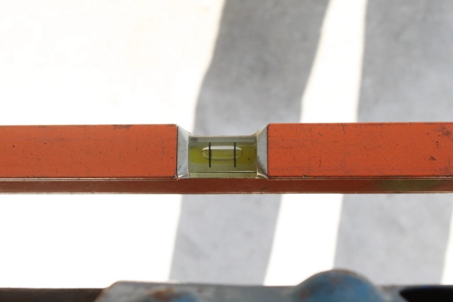

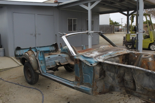

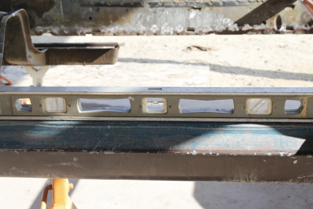

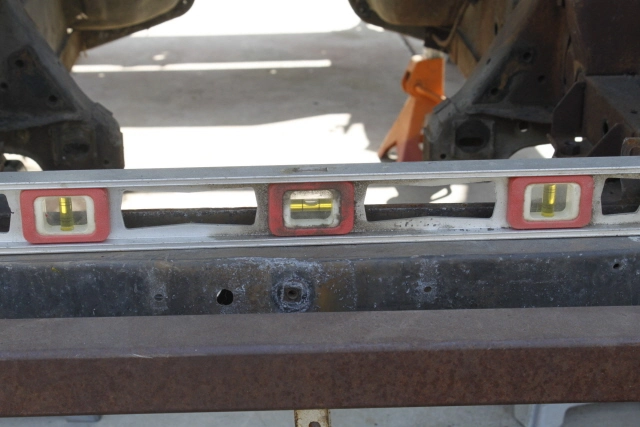

I got it leveled up . I used several jack stands to keep every thing level. The torque boxes have to be cut loose for the inner rockers to pass through, and i don't want anything to move. i will do one side at a time to help keep things straight. I have 4 levels on the car right now ,one at the door jamb front to back ,one through both doors ,one at the front brace below the radiator support and one at the end of the frame rails in the trunk.

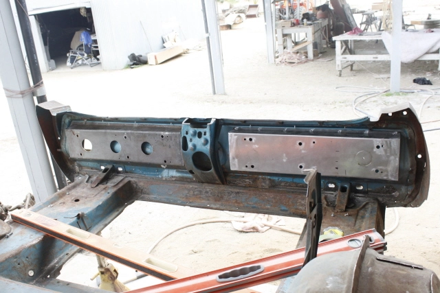

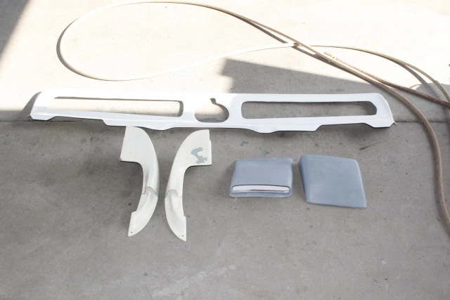

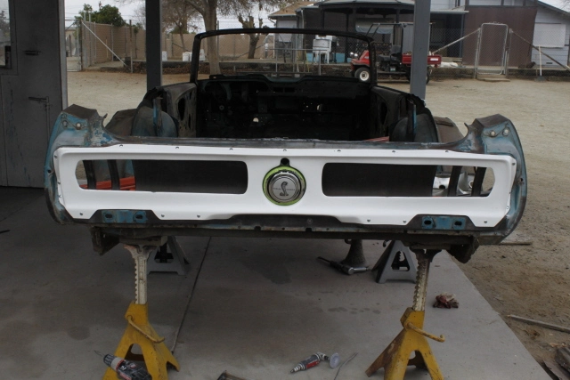

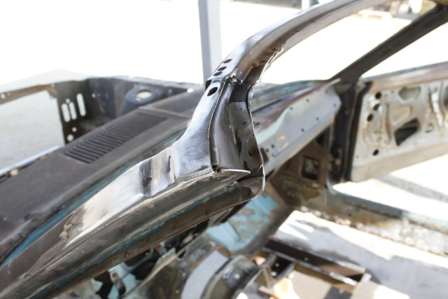

The windshield frame is trimmed and finished. I took the cap out of the old convertible window frame and inserted it in the coupe frame and welded it in place after i trimmed the coupe frame. I have the side scoops ,tail panel, i am going to use Cougar tail lights just like Shelby did, and an original set of end caps. I will order the rest of the fiberglass after the body is complete. The tail panel is in very good shape and will be trimmed out for the cougar tail lights so i will leave it in place .

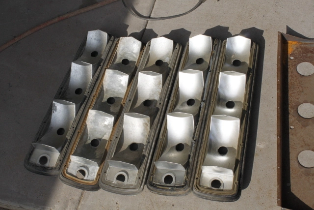

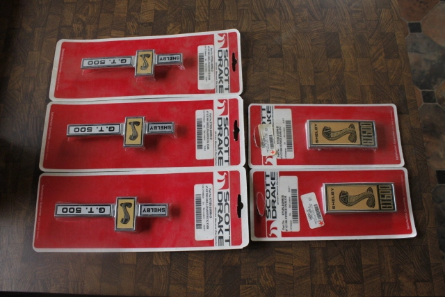

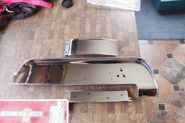

I went digging for gold and found some .I wanted to see just what parts i already have .I came up with 1 or two or three sets of Cougar tail lights, the Shelby tail light cans ,the nose section support ,the dash bezels except the instrument piece,the Shelby 500 emblems ,and that works perfectly with a 390. I am sure i have more pieces that can save me a little cash i just need to find them. The emblems i bought a few years back when Shelby was first tightening his grip on Shelby parts . The brushed aluminum for the dash bezels i can make so there is another small saving .

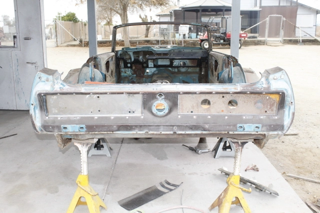

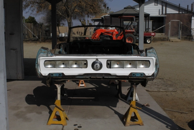

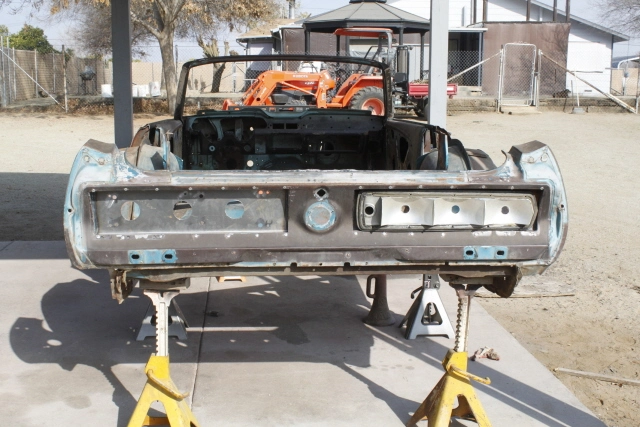

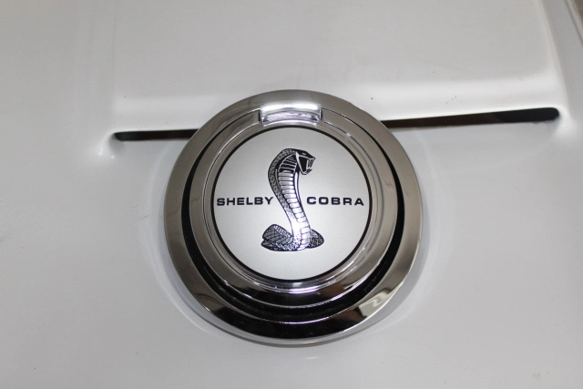

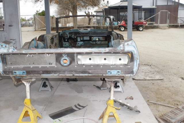

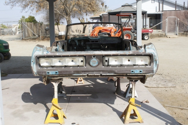

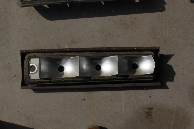

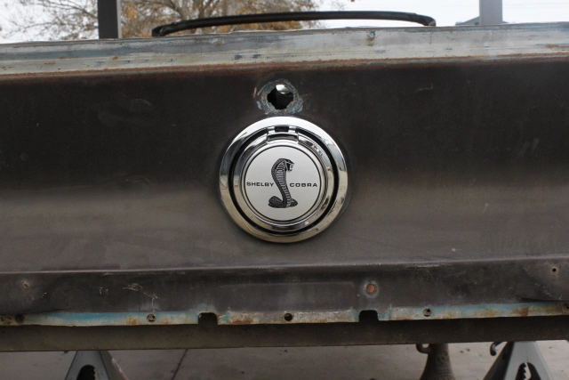

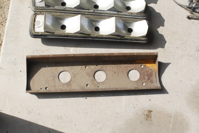

I am still waiting on sheet metal , so i figured i would chop up the tail light panel. I started with a brand new pop open gas cap, this one is a 68 for my 68 Shelby replica convert. .I screwed it in place and wrapped some masking tape around it so i wouldn't scratch it. I centered the fiberglass panel over the gas cap and screwed it down, then i took it apart again so i could cut out the light can holes . the next step was to position the cans in the panel and screw them in place ,they will be pop riveted in when i am done but now i can take them out to cut the holes . I used my air saw to cut out the panel ,best saw i have ever bought cut right through it . After i cut the holes i screwed the cans back in place and checked the fit with one of the Cougar tail lights and it fit perfectly. Ah you noticed one can is different from the other one . It seems i had two pass. side cans and had to make the other side .It still isn't finished ,my hole saw was to dull and wouldn't cut ,i will have to buy a new one . I still need the light lenses and the trim rings but i wont actually need them until much later . I could have gone with a fiberglass panel with the lights made in but i kind of like the Shelby set up ,and i prefer the early flat fiber glass panel over the raised one .

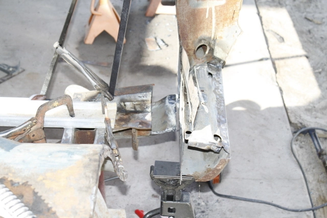

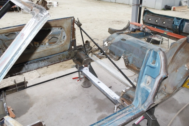

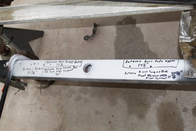

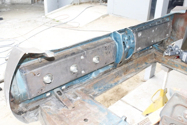

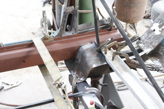

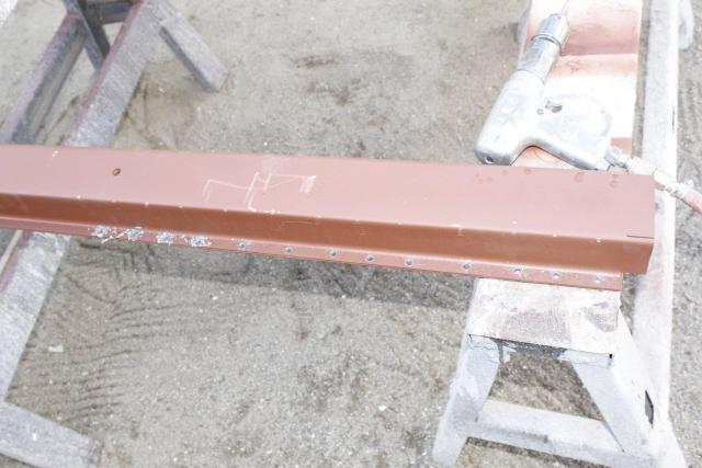

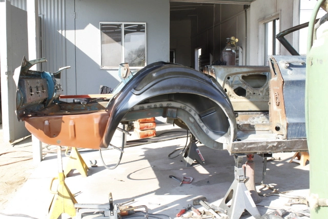

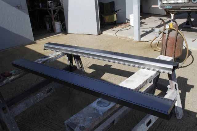

I did a little trimming today. I Removed the wheel tub and trimmed out the rear door jamb. I clamped a few supports in to keep every thing in line for when when i cut loose the rear torque box from the rocker. I took a lot of measurements and wrote them down for quick reference ,if you don't have another car to measure from you better do this or you will not know where every thing has to be. I will cut the front and rear torque box when i get the inner rockers Monday, probably with a saws all so i can get a clean tight fit. I will have to sand blast and epoxy prime the hidden areas before i weld in the inner rocker. The wheel tub and trunk drop off patch will be done after the inner rocker so i can slide the inner rocker in easily. I am going to do one side at a time starting with the pass. side.

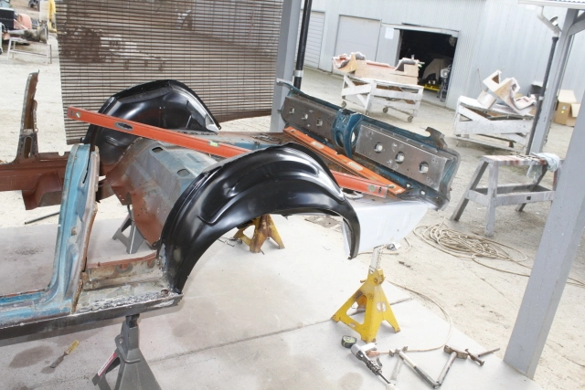

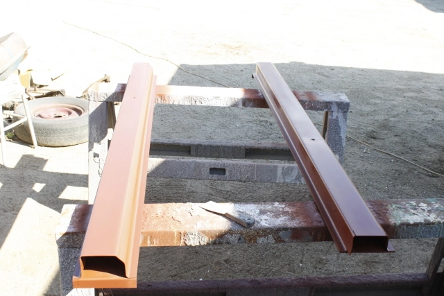

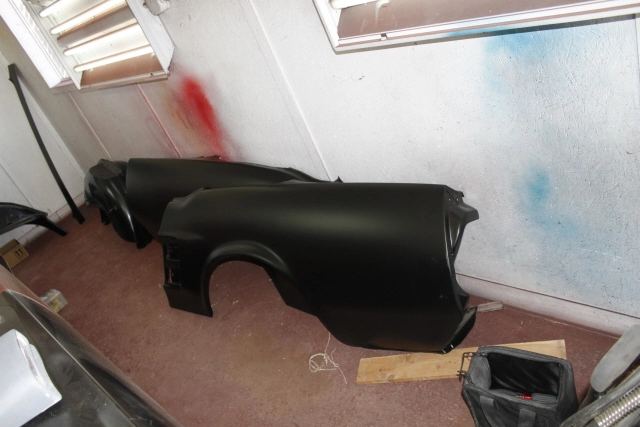

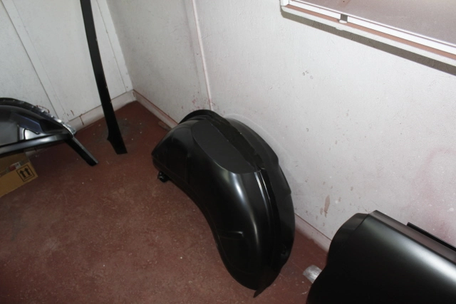

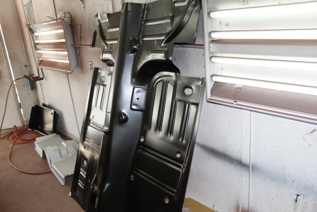

I picked up my parts today and they are nice .The convert wheel tubs already have the indent in the top for the top bows . the seat Platform is heavy. The floor kit came with the under boxes .The quarters are real nice and my side scoops are almost a perfect fit.

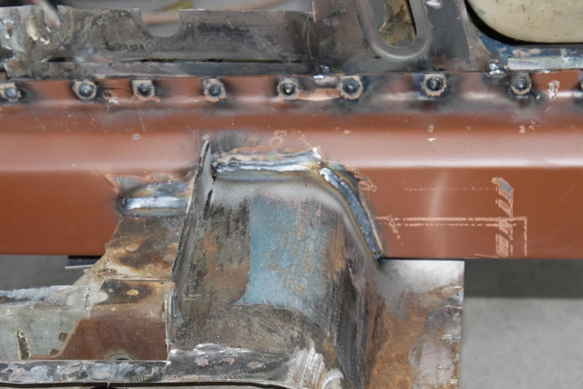

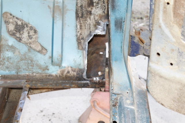

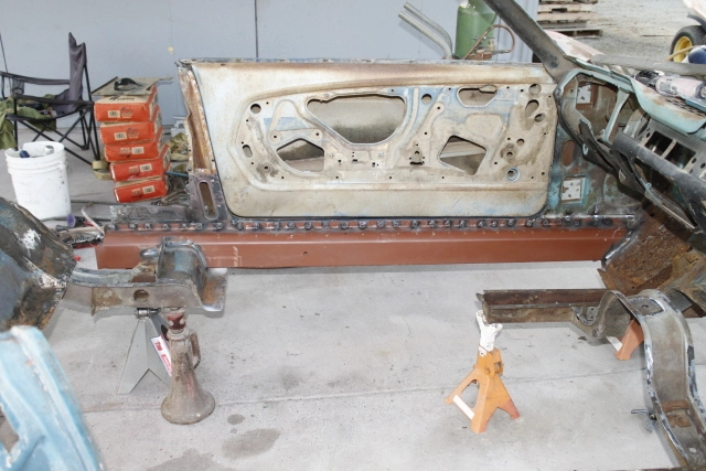

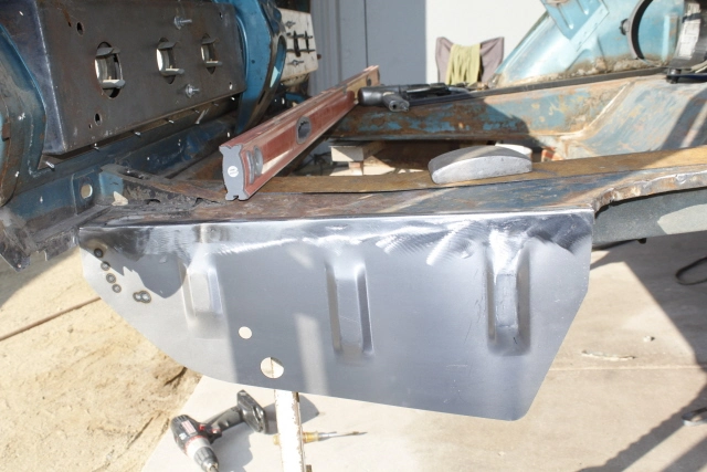

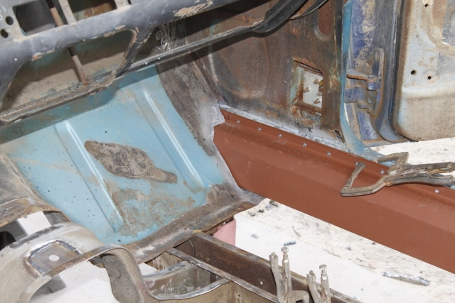

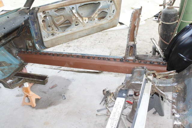

I primed the the rockers ,then i drilled all the holes for plug welding . I cut the rear and front torque boxes loose ,it didn't even move . The inner rocker slid right in .I couldn't believe it, my welder worked perfect,no pop and spatter like usual .
The driver rocker is done . Tomorrow i will do the trunk drop off and the wheel tub then on to the driver side .

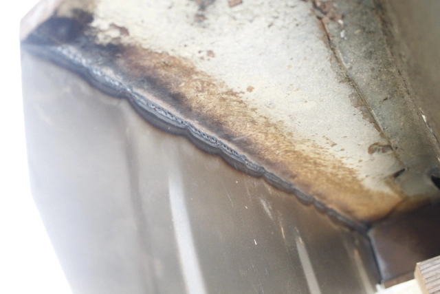

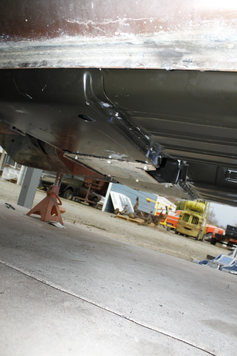

the trunk drop off is in ,it welded really good ,but welded .You can see the penetration from the weld on the back side .
I primed it because i will not be able to do it later . The wheel tub only took a few minutes with the spot welder. I set the quarter in place just to make sure every thing would line up .Going to have to do some work on the door jamb area ,the end of the quarter is a bit wobbly but easily fixable .
The driver side inner rocker is in .This one went in faster and easier than the pass side did. It is very solid now.

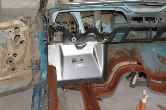

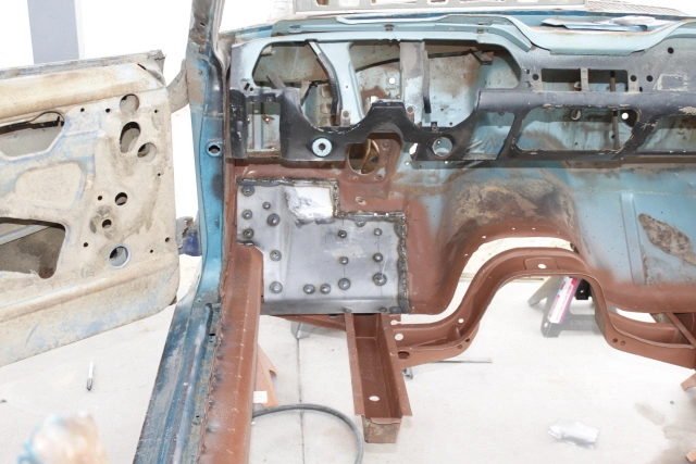

I still have to patch the toe board and the top of the torque box and put in the wheel tub and trunk drop off patch , and then i am ready for the floor.

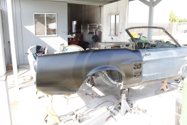

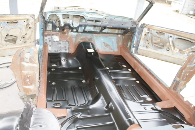

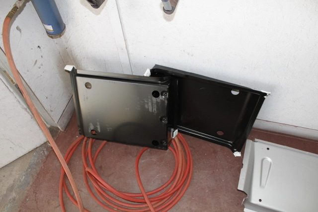

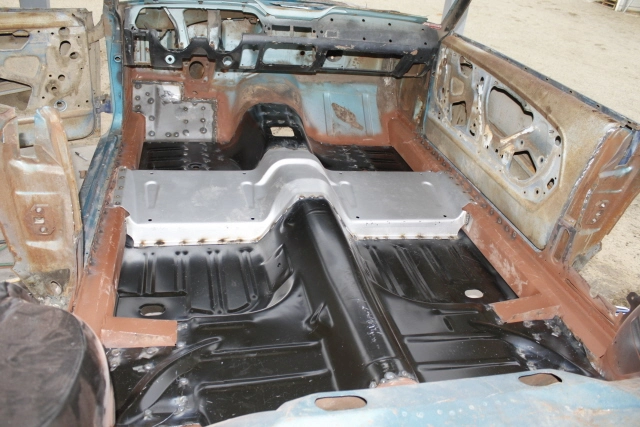

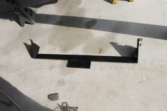

I sand blasted the inside frame rails and all the edges and primed them. Then i did the toe board . I test fit the floor and marked every spot where it would be welded ,removed it and drilled all the holes for plug welding. I put the floor back in place ...all by my self :drool:. Then i drilled the holes in the seat platform for plug welding and sat it in place .I drilled through the floor using the holes i drilled earlier in the seat platform ,and using a floor jack i then placed the under floor boxes where they would go, that way i could weld the seat platform ,the floor, and the under boxes at the same time. I also bolted in the brace between the two boxes ,before i welded ,to make sure every thing lined up. Using a few sheet metal screws i screwed the pieces together sandwitching all three tightly together and welded it up . i still have a little welding underside but i will wait until it is on the rotisserie . I put in the driver wheel tub and trunk drop off yesterday so no i am ready for the rear seat devider ,after i trim it out .
