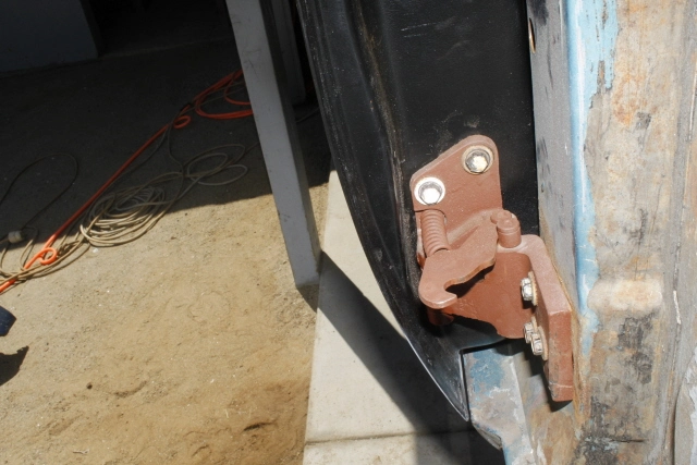

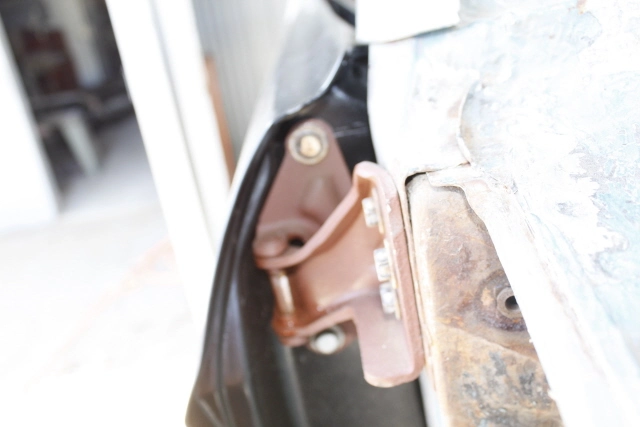

Yes your hinges are worn ,i have one that does the same .You may be able to adjust that hinge down just enough to take up the slack and make it set flat with the cowl ,i am assuming your car is a 65-66? There is a stop under the cowl seal ,looks like a small piece of angle iron.It is adjustable up and down so you can set the hood to stop where you want it.

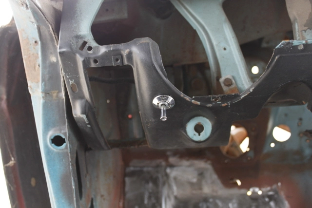

Going to slow things down a bit but i went ahead and drilled the dash and made sure the top switch fit ,it does.

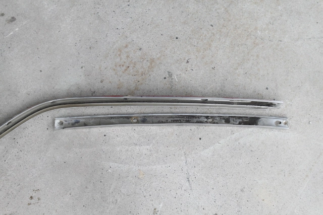

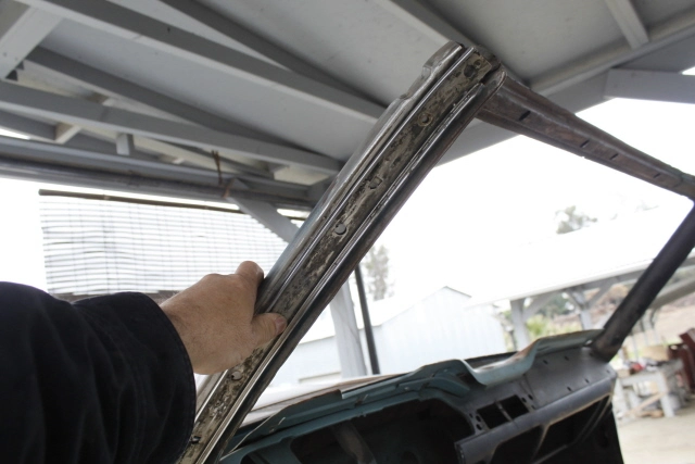

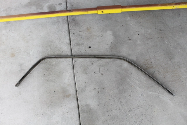

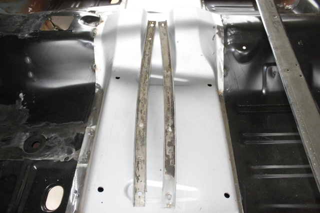

I don't have the weather strip channel for the front window frame to door window vent so i made them from the coupe channels. i used the channels from my 68 convert as a pattern,they are simple to make and are same as the original ,the holes even line up.
Now i just need to clean out all the old glue and take them to the buffer and make them shine again

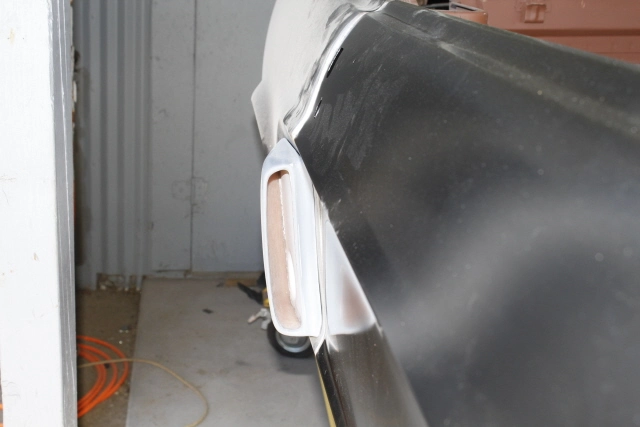

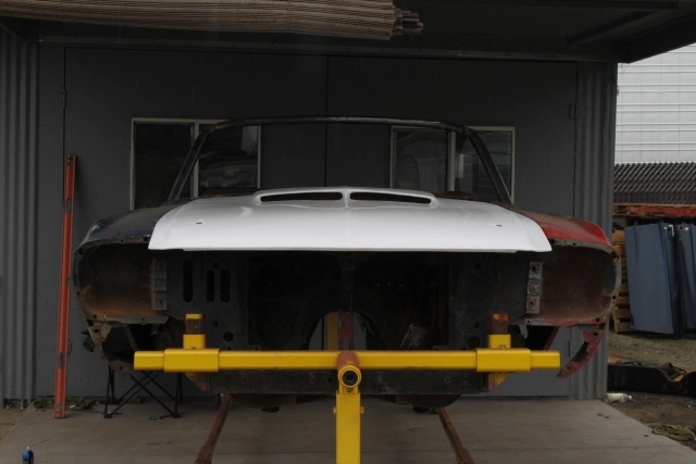

I bolted the pass. side fender on and it fits up to the hood better than the driver side .I hope a new set of Dynacorn fenders will fit as good these old beaters.

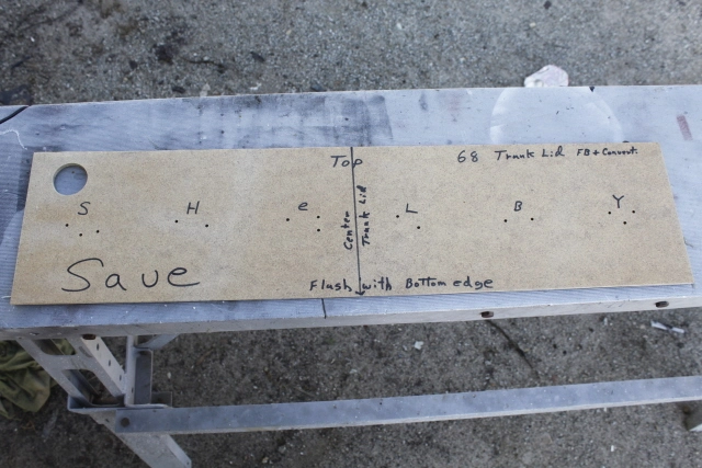

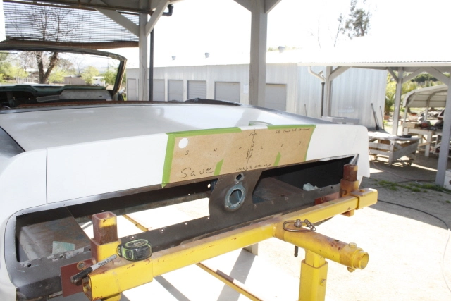

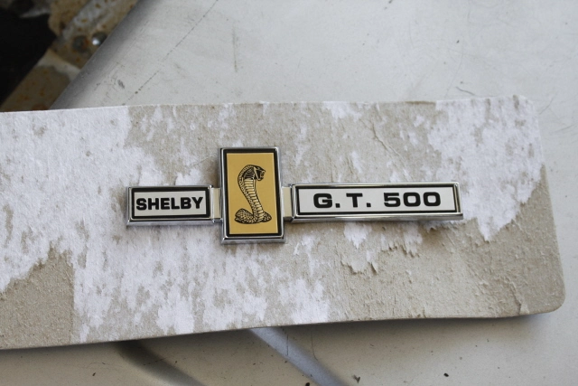

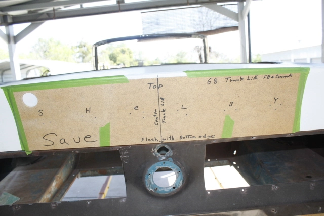

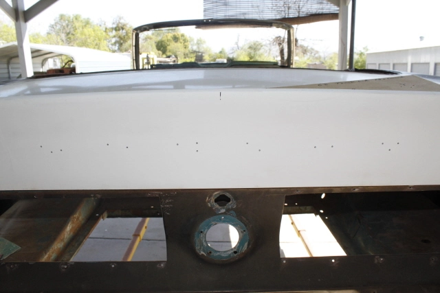

I decided to drill the trunk lid for the emblems . I have the 67 GT 500 emblem but i don't like the way it looks on a convert. trunk lid . I decided to go with the 68 SHELBY letters .I have a template i made some time ago ,if you ever tried to put these letters on you know how hard it is to get them straight.
All i have to do is find the center of the trunk lid and match my pattern to it and set the bottom of the template to the bottom of the lid. I just masking tape it in place .Then i use a 1/8 inch drill bit made for pop rivets,it only cuts on the end of the bit so it will not waller out my template.
Remove the template and i have a cleanly drilled and straight set of holes .Now i just need the letters.

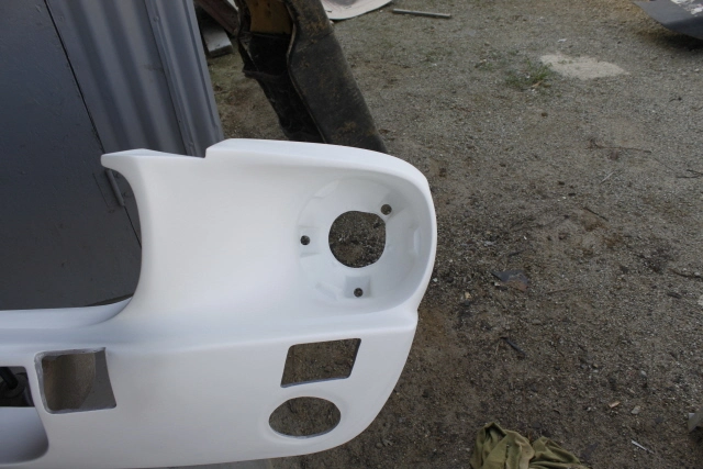

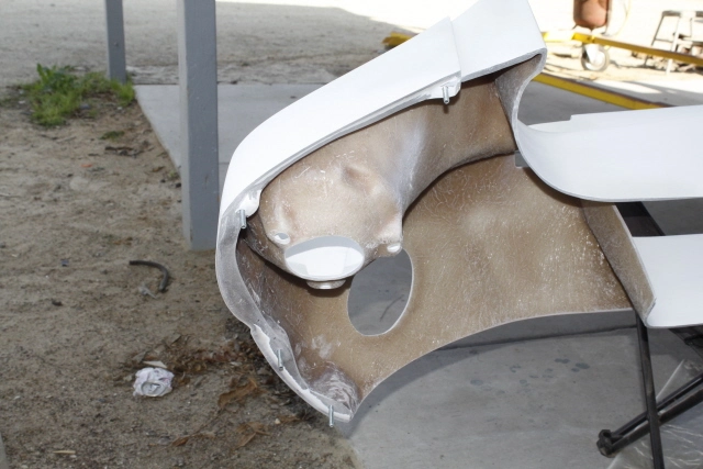

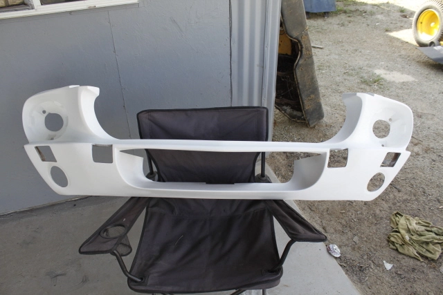

I went ahead and bought the nose section today .I should have it late tomorrow.
It was one that was returned ,i got it for a fraction of the going price .People just do not know how to fit them and for some reason they will not follow directions:shrug:.If you do not fit them right, they just will not fit .I will post the correct way to fit them ,when done correctly it is actually simple .
I got the nose section . Why someone would return it , i just can't understand :shrug: glad they did though .
Well i know why. like i said ,there is a right way and a wrong way to fit it. The only thing i had to do was clean off the greasy hand prints all over it:rlaugh:
I have another junker 67 here i will fit it to sometime in the next couple of days ,step by step . It is a nice piece ,with the headlight buckets made in . It takes about 30 minutes to install the headlight adjusters and the headlights .I think i have a set of lights here somewhere , it uses 69 outer light cans and bulbs .
The mounting studs are already in place and i held another fender up to it and it fit very well.

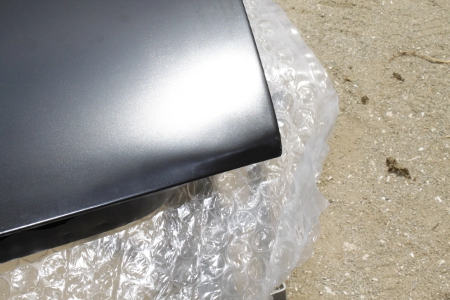

My doors made it in today,they are both dented. I haven't seen them yet but they want me to take them any way with a discount .I DID NOT ORDER DENTED DOORS! Oh sure it would help out the shipping company ,and i can do the body work but i do not want dented doors . These shipping companies have to learn to be more careful ,so i say no!

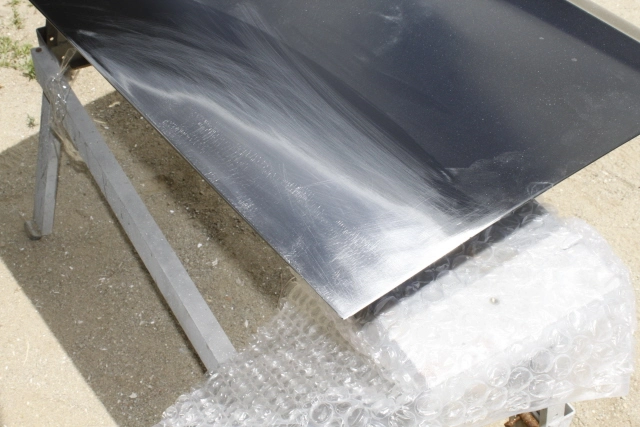

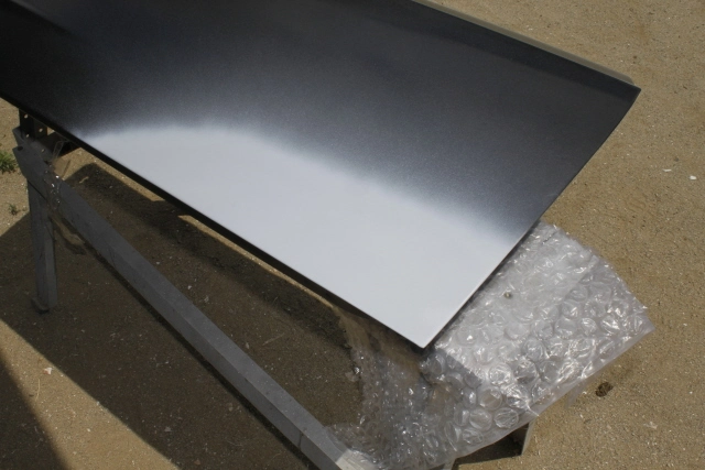

I went by and looked at the doors this morning ,the driver door was not repairable .The pass side only had a slight roll at the bottom front edge so i went ahead and took it ,at a discount of course .
A little hammer and dolly work and i had it looking good ,no bondo needed
I sprayed the spot with epoxy primer just to keep it from rusting

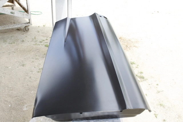

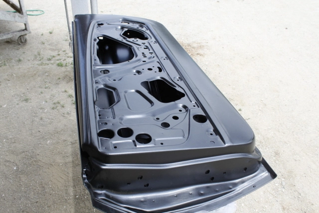

This is a Dynacorn door and it is very straight ,except for the shipping damage that is now repaired .
How it will fit up to the quarter and to the front fender ,i will have to wait and bolt it on the car to see.
I see two problems ,the grain finish on the inner part of the door is way to light ,it is almost smooth .It could be just heavy primer but i don't think so .I am going to blast it off gently .The way it is now if it were painted the grain would completely disappear .
The inside of the door has spots of bare metal showing so i will spray it with epoxy primer ,it will rust very quickly if it isn't primed .

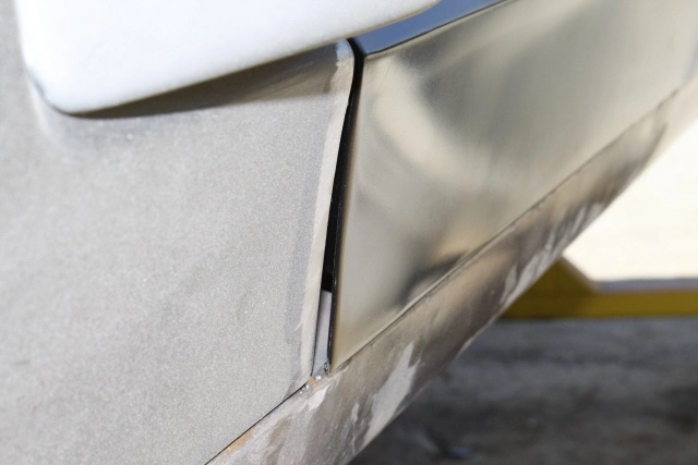

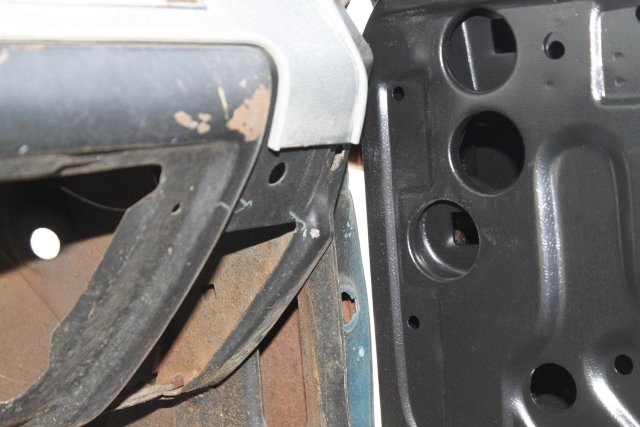

I just tried to fit that door on my convert .:nonono: First of all ,i found out it is not a Dynacorn door it is a Scott Drake door. the door has a 1/2 inch twist in it and it will not twist out ,my brother and i tried together and no way
the door is about 1/8 inch short so if i fit it up to the door jamb it is to short to reach the fender and leaves a good 1/4 inch gap. The door sticks out past the fender at the top and over hangs the rocker about 1/4 inch and the hinges are adjusted all the way in ,they actually hit the door so it will not go in any farther.
Now we get to the inside .The part of the inner door shell where the weather strip would go has a 1 1/4 inch gap between the door and the front pillar so with the weather strip on the door there would be about a 1/2 inch gap between the door rubber and the front pillar,water and wind would blow right through .
In all i would give these doors a big F .:fuss: CHEAPER IS NOT BETTER !!
This door is not salvageable . It is down right terrible .They were supposed to be a great fit ,this thing isn't even close . Dynacorn is out of stock with no date for availability so it looks like i have to wait ,AGAIN!
