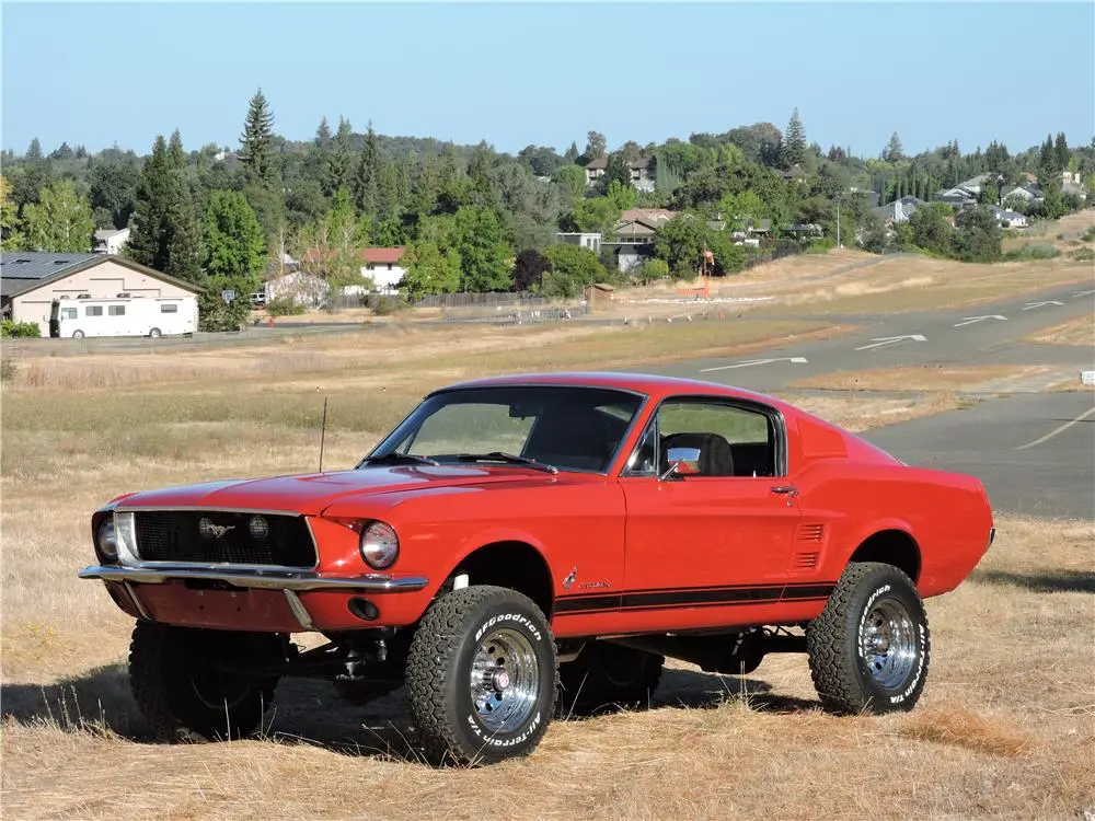

cool thread and nice build! I thought all the convertible parts were available...how rare is it to find a convertible shell? My coupe is basically mechanically rebuilt/refurbished with me power disk brakes in the front and I rebuilt the rear end and the interior was redone before I bought it. Ready to strip it down, make some patches other than the roof and paint and reinstall. If I could find a good (and cheapish) shell, then finish and install all my goodies in it? Or a fast back conversion on this car....or a 4x4 conversion :)
A 4x4 coupe might be pretty sweet!
The only pieces not available is the rain gutter at the bottom of the convertible top ,and the under support the trunk hinges attach to and the panel between the top and trunk lid bolts to . If you can find a rusty 67-8 ,or a wrecked one it is well worth it...everything is available for a fast back
Thanks for the advice! Keeping my eyes peeled for a donor car or either. Love your build of the fastback conversion. I love 4x4's...
I think I've found my inspiration!
