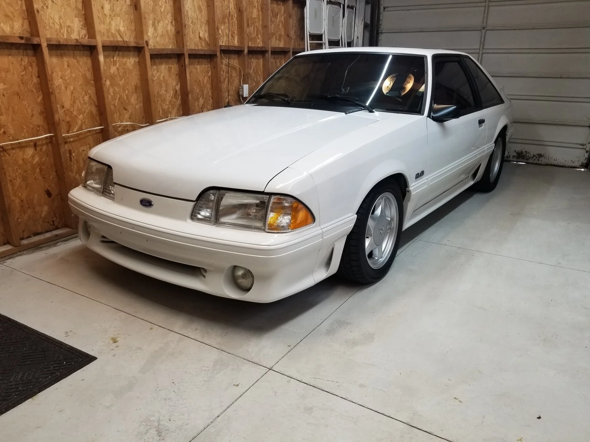

Been a lurker on the forums for a long time, but recently picked up my second fox and wanted thoughts/opinions on the purchase. It was an impulse buy for about $8k canadian.
Car is a two-owner 180,000 KM (112,000 MILES) from British Columbia
Engine is bone stock down to the air box
A little tired ~120psi across all cyl. but runs with no misfires, stutters, hesitation nothing.
Eibach springs
O/R H pipe with flowmasters & BBK equal length headers
Have the factory radio but the factory amp under the pass seat was yanked so just dropped in an aftermarket unit
Interior is an 8.5/10 but could use a re-paint on some faded panels
Floors and trunk are solid no holes/rot
Not cut-up, spliced up or beat up in any way
Hood is from a different year/different color white that I'm thinking it was in a front end fender bender at some point but car drives straight with no real issues.
Some hail damage small dents on the roof but no where else on the car?
Overall the car is in great shape from a few feet away, but digging into it it has some flaws.
Wondering thoughts on whether it would be worth bringing in for a repaint, or more work than its really worth. Just sell as is and pick another one in worse off shape since the work to towers and seams, has to be done anyways.

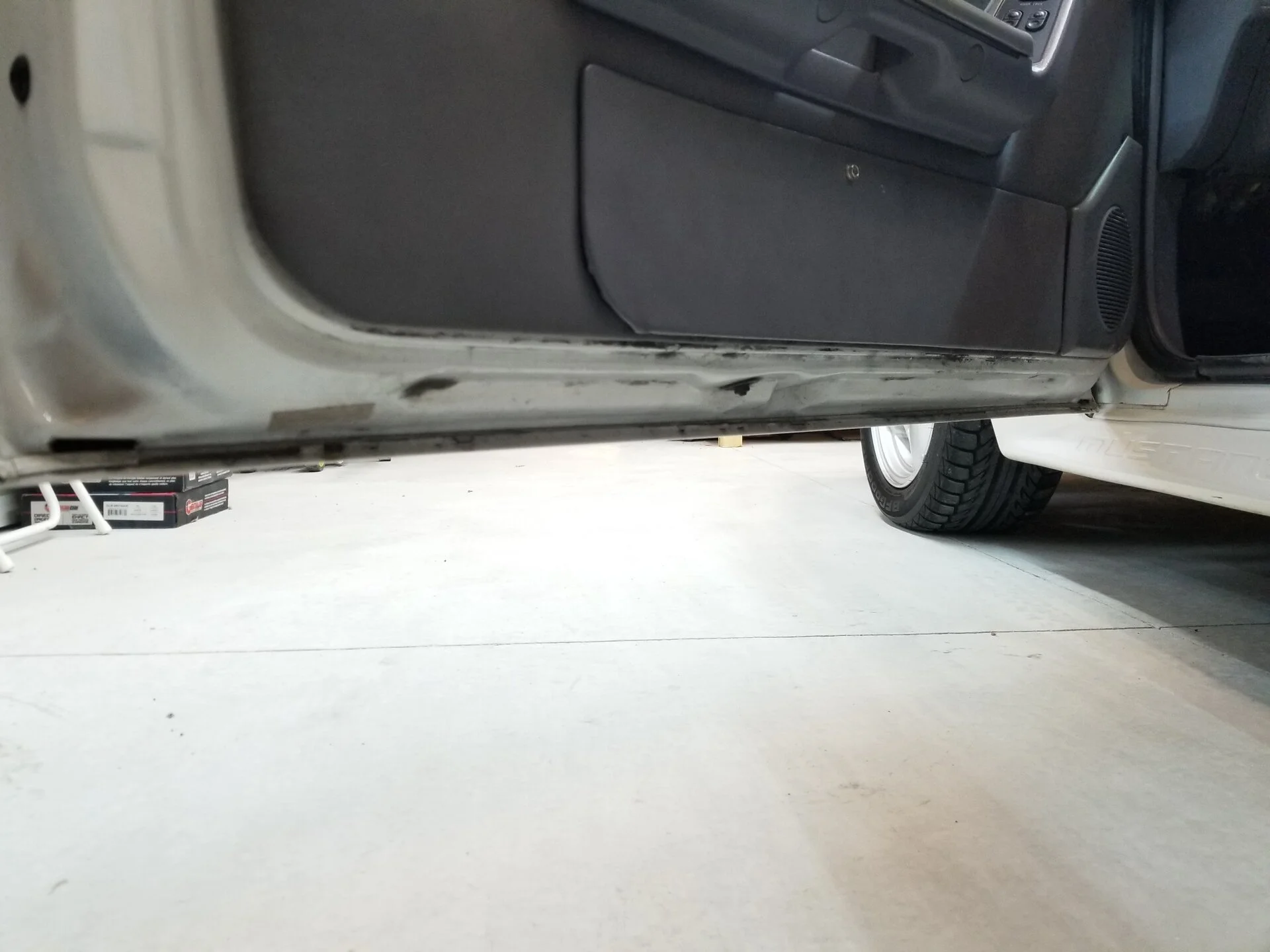

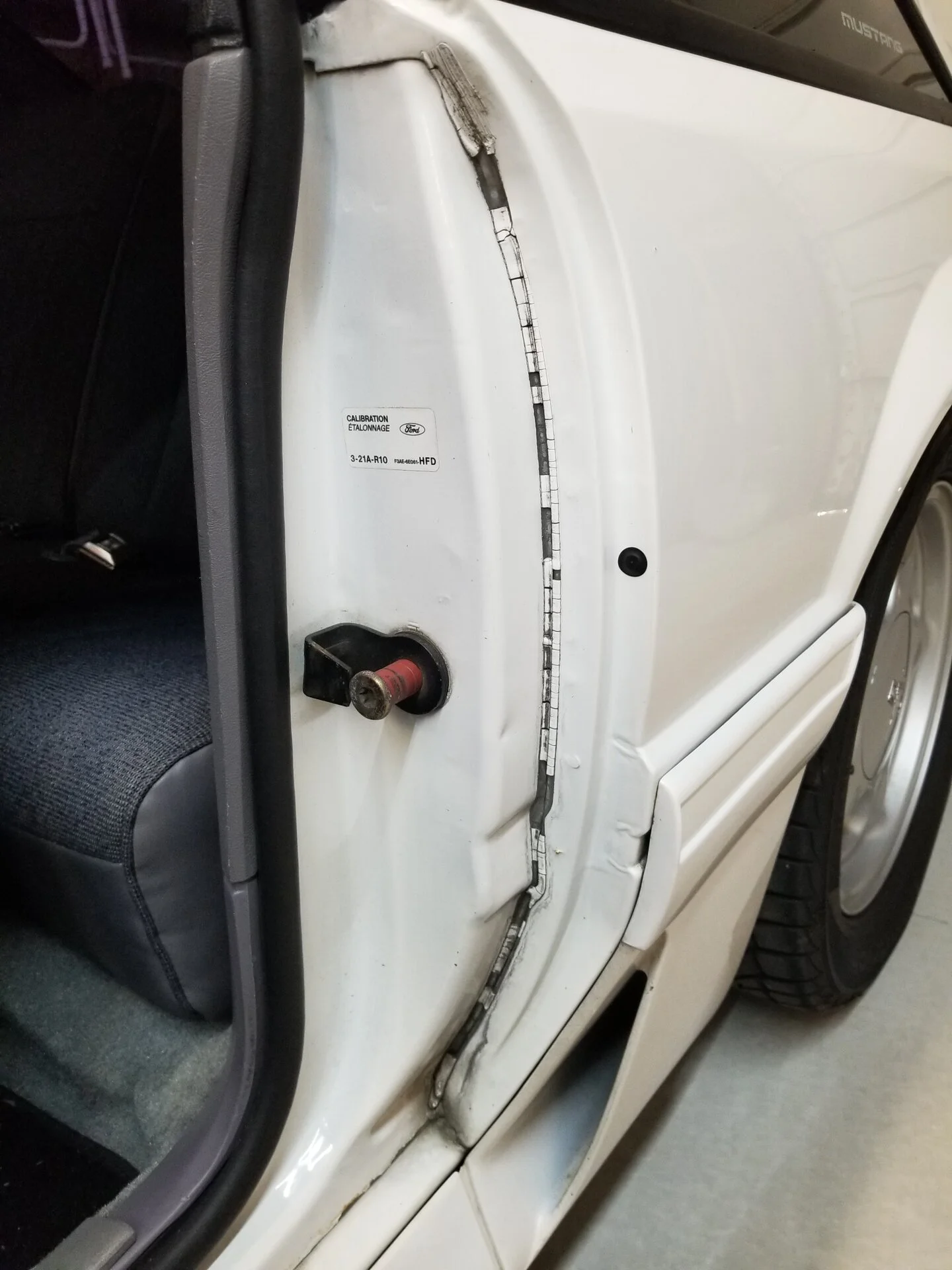

  1. Seam sealer is crumbling at pretty well all door seams, B-pillar, trunk etc. - If i pull all the old sealer off, would a simple new bead be sufficient or should it be painted first?

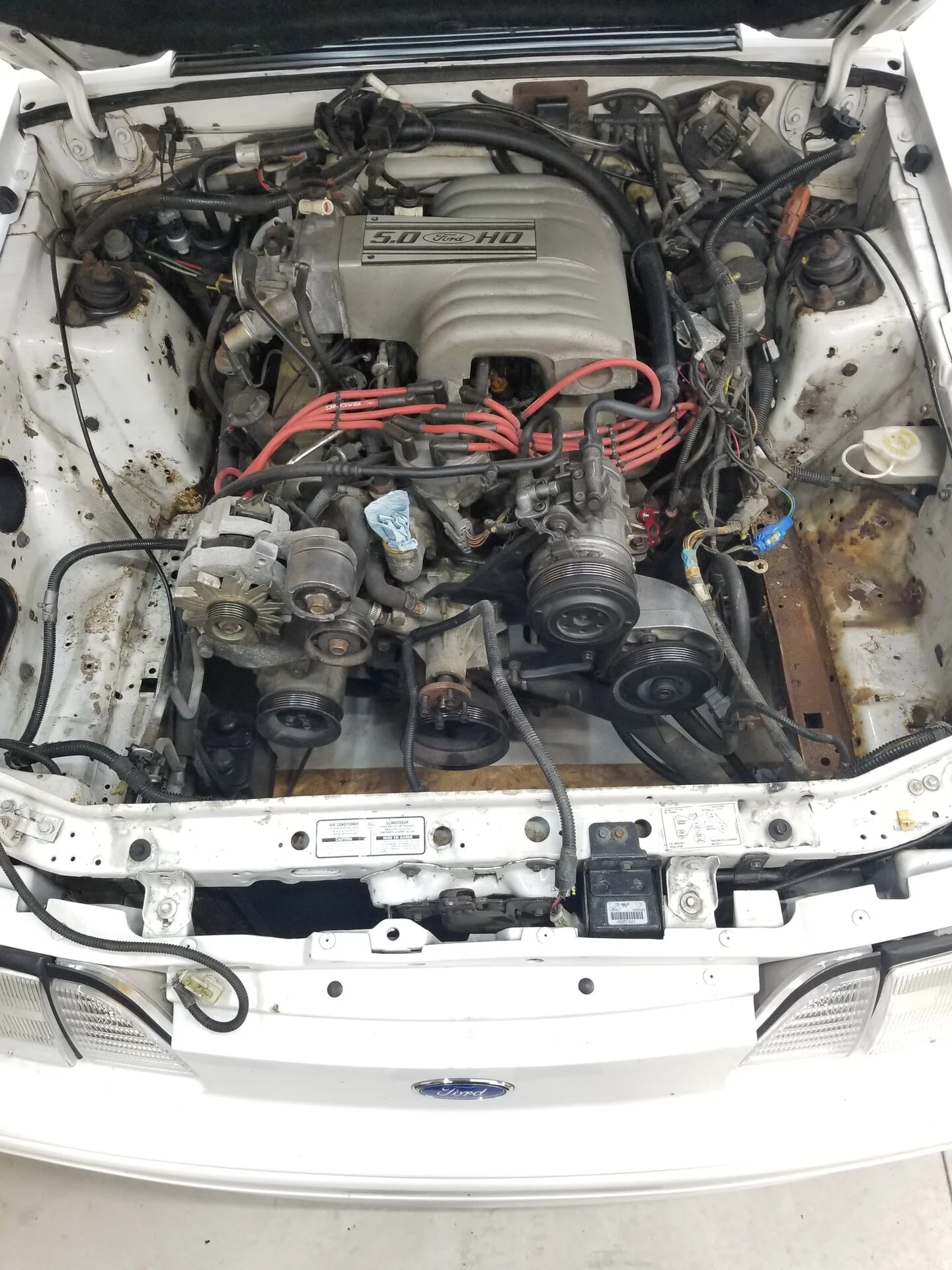

  2. Shock towers at first glance appeared to look better when i first bought than they really do -- the driver side seems solid, more surface rust than anything but the pass side appears to be worse. Is it worth fixing or should it hold up going forward considering its a second car never driven rain/winter anymore.

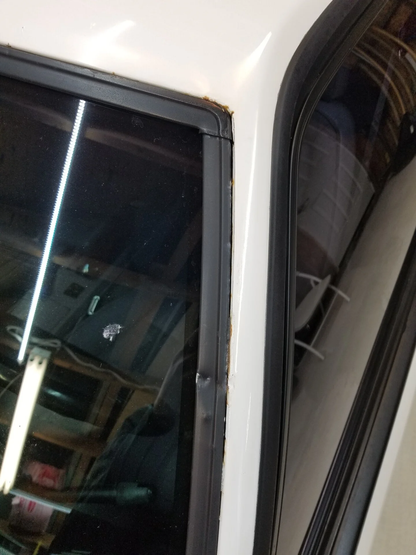

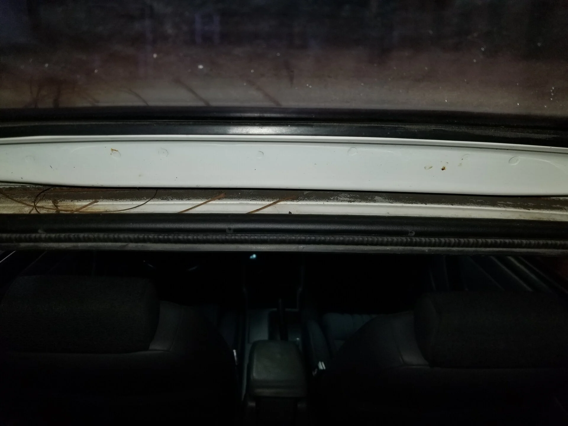

  3. Rusting around front & rear windshield trim

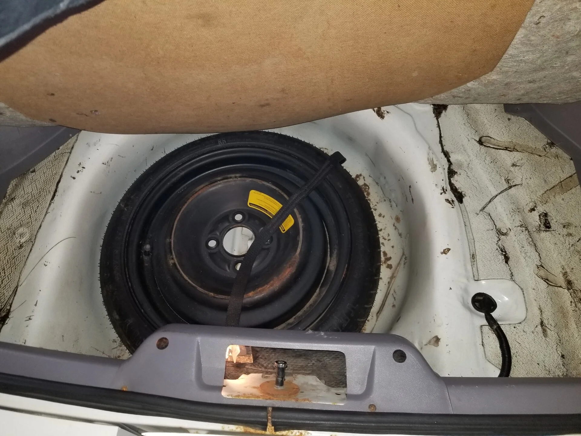

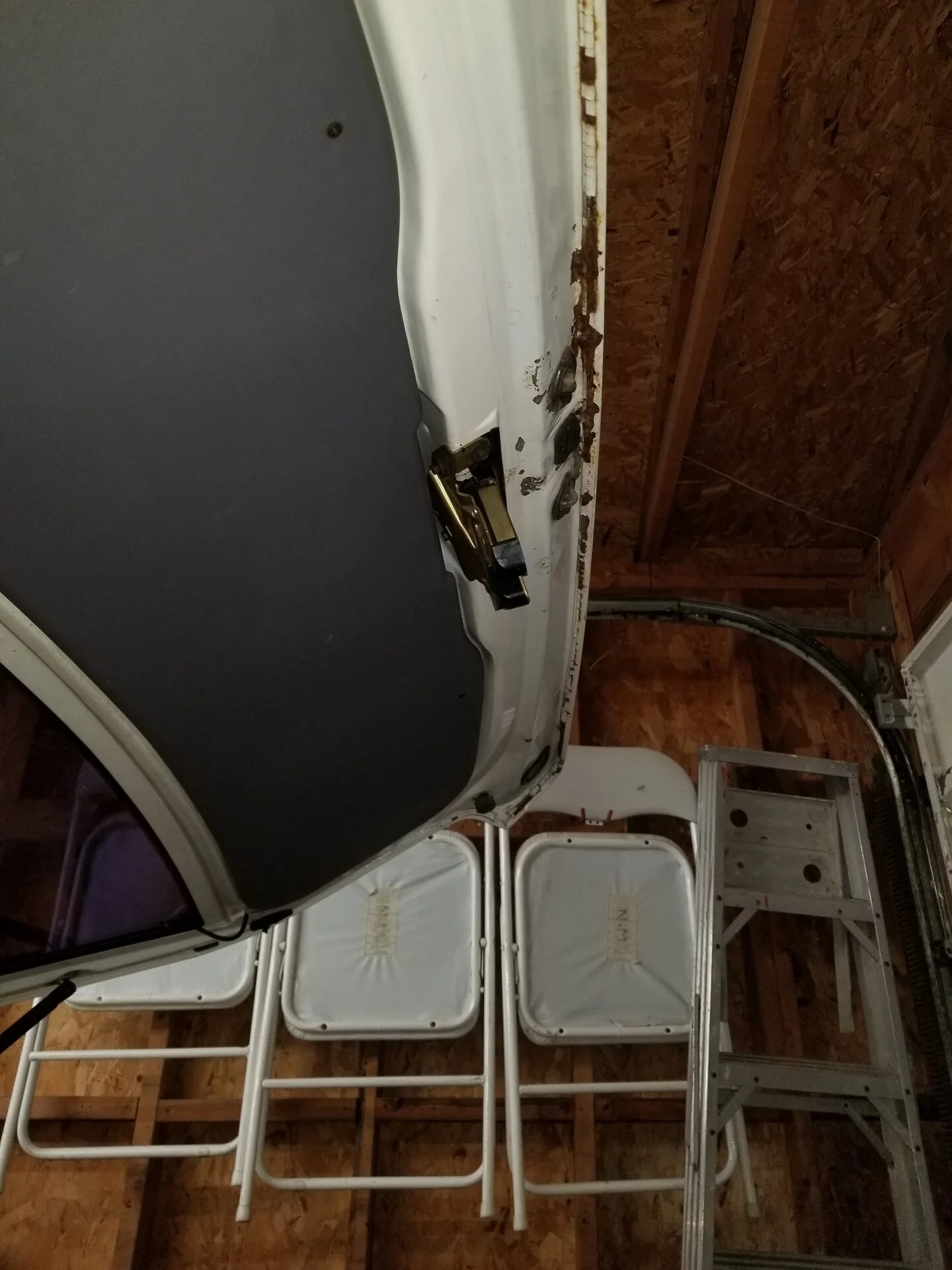

  4. Trunk lip has some good rust
  5. where roof and hatch meet, the paint has faded to bare metal? no rust, just bare metal

It looks pretty dang clean minus the rust spots. As far as price, they vary from area to area a bit. Id say its a fair deal. Not bad, not great.
Worth spending money on, investment wise? No. Never is, or very rarely. Lol. But it is good fun dumping money into. So, of course.

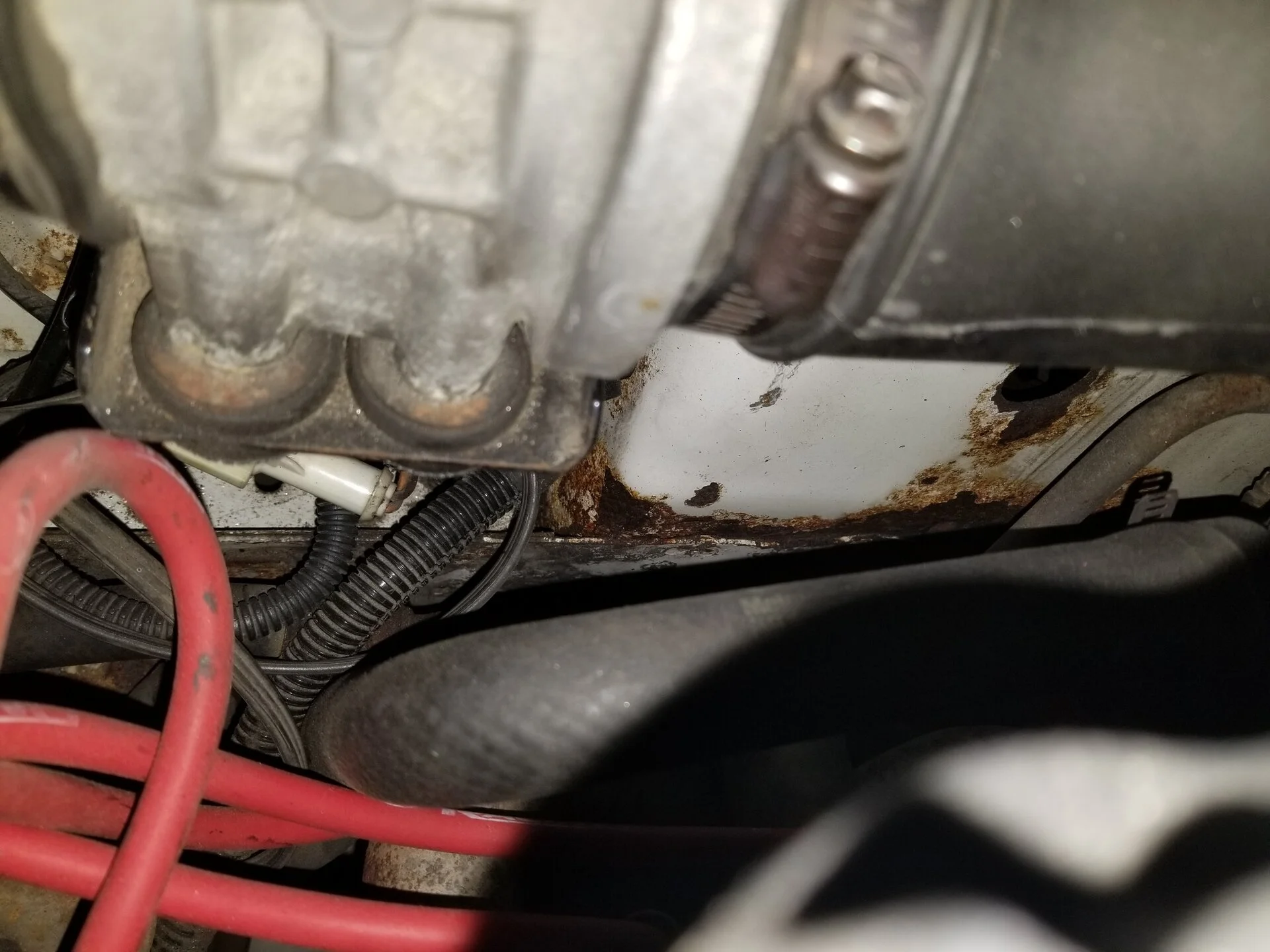

My experience with rust issues is to fix them first and ASAP. Rust is like cancer....you want it completely gone as quick as possible. You need to atleast get in there and find out how deep the rust goes in the strut towers and frame rails. With more and more people fixing these cars the info is at everyone's finger tips.
That frame rail is concerning. I bet if you were to open that up it would be toast in there. It is a nice car though, reminds me of mine! Its doable, I agree with 90sickfox, clean it up asap! You also need to pull the fenders off and see what the upper aprons look like at the bottom area of the windshield as well. If the windshield frame is rusting, I would bet those areas are rusting too.

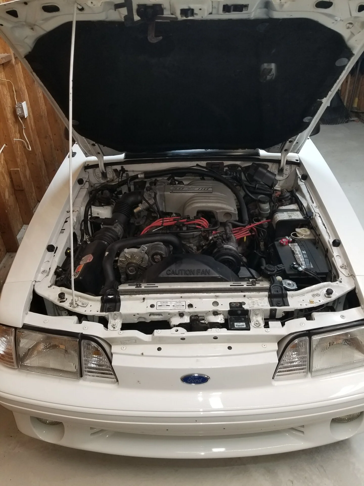

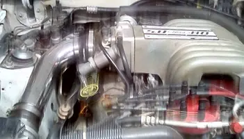

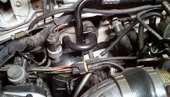

Check over the passenger side well.The engine bay pic has the fender position over the apron looking strange,may have took a light hit sometime in it's past.
Looks like a good starting point though.
Good catch...I definitely agree considering the hood is also a different color. Gap is horrible on that side and rad cross member also is bent down a touch.

That's where i am torn about it. I got a funny feeling i will start tearing it apart and it will be much much worse than what is showing on the surface.

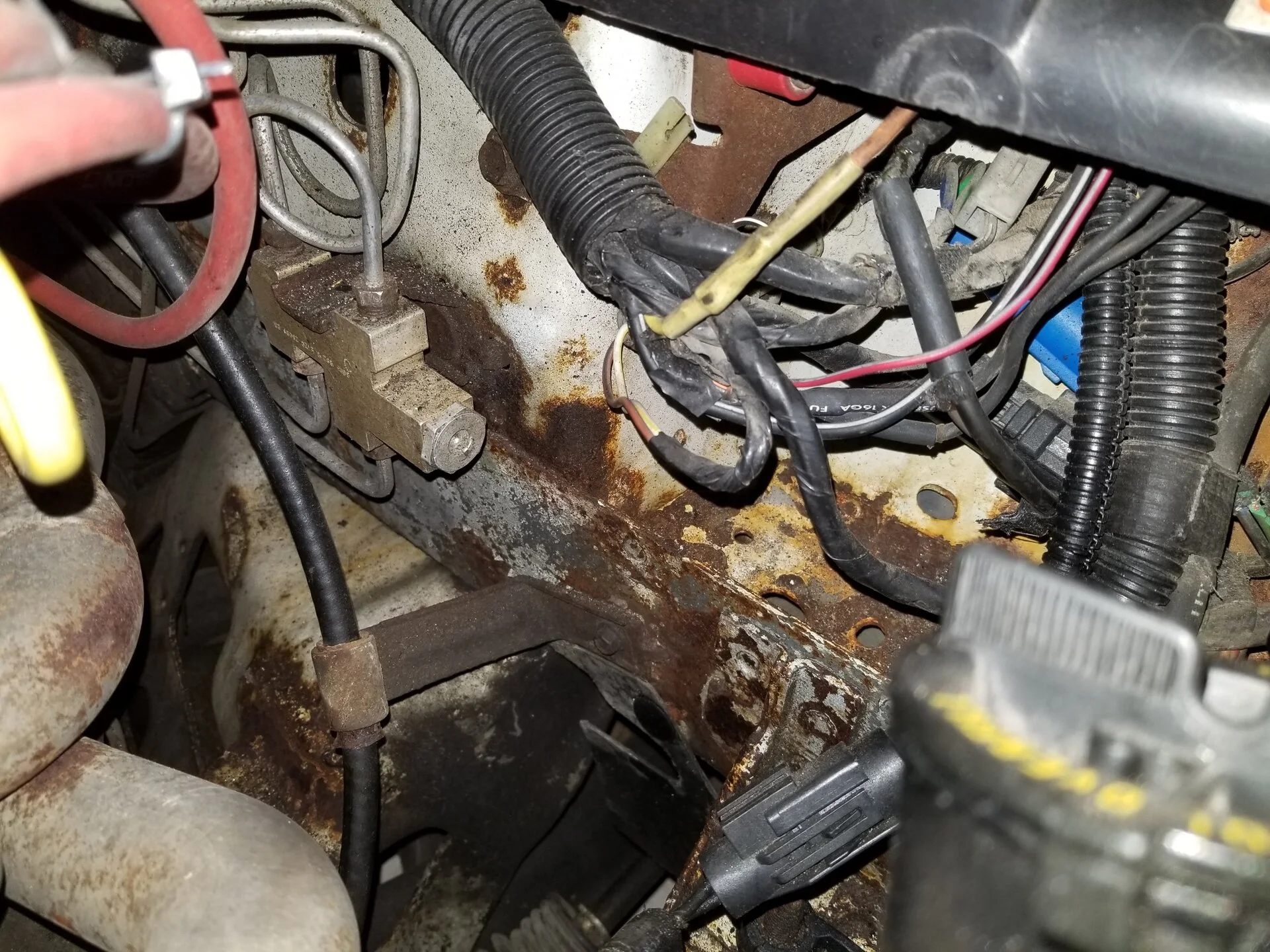

Well i started pulling some stuff apart and the rail is very rusty :(
Thankfully at least on the surface, it is all solid metal and just surface rust. From what i heard, the inside is usually much worse, but i decided i am not going to go down that road. Going to start taking some grinding and paddle wheels to anywhere i can get to, treat with some rust encapsulator and re-spray. Maybe a battery leak caused much more rust on the driver vs pass side? Strange it is not the same on passenger side to me.
This will not be a show car but it will improve the overall appearance drastically.
