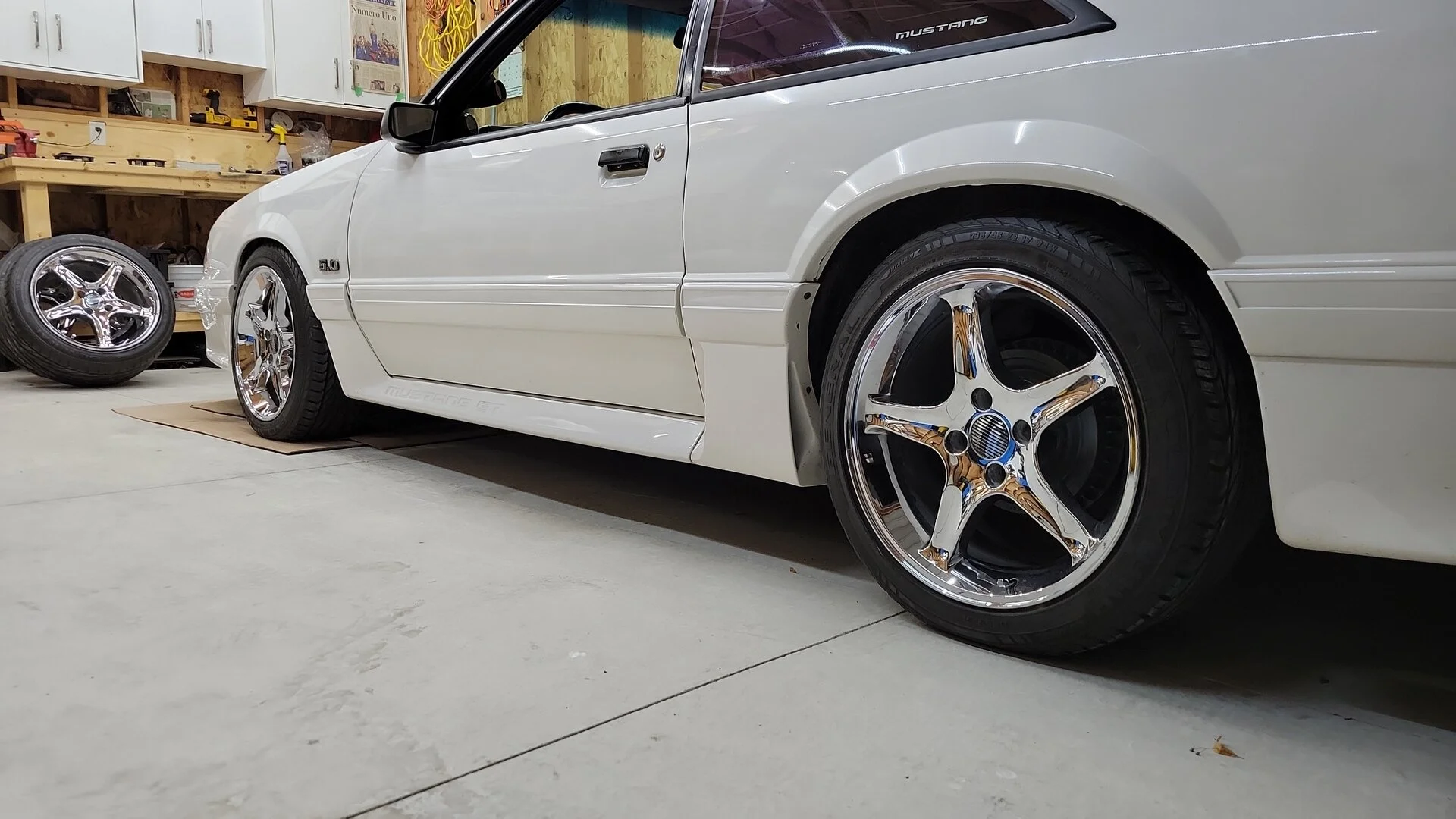

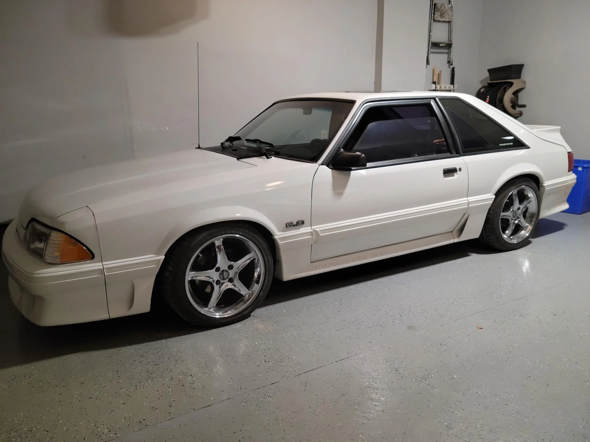

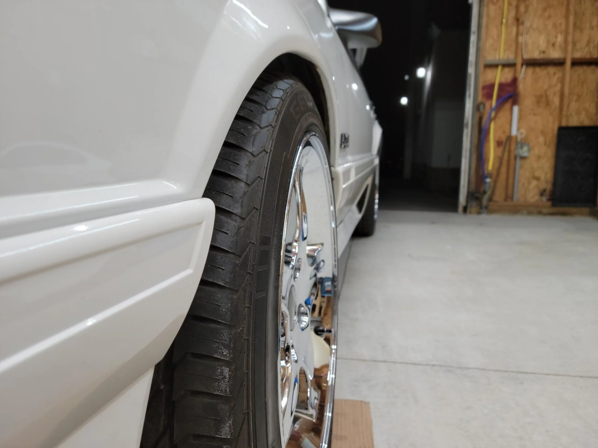

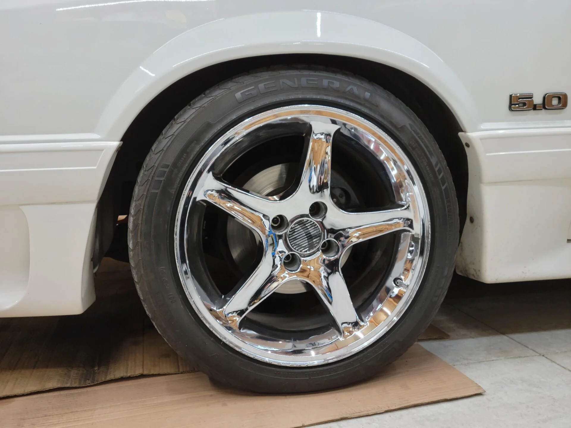

This winter I want to focus on cleaning up some more of the surface and interior flaws and give it some more appeal. I started by finding some chrome 17x9 cobra r rims on kijiji. Feeling very vanilla ice, but for $400 I couldn't pass it up. They have a 235 tire on them which looks and works perfect on the front, but definitely needs a sticky 255 or more on the rear.
And here are some pics. Wasn't letting me put them in my previous post for some reason.

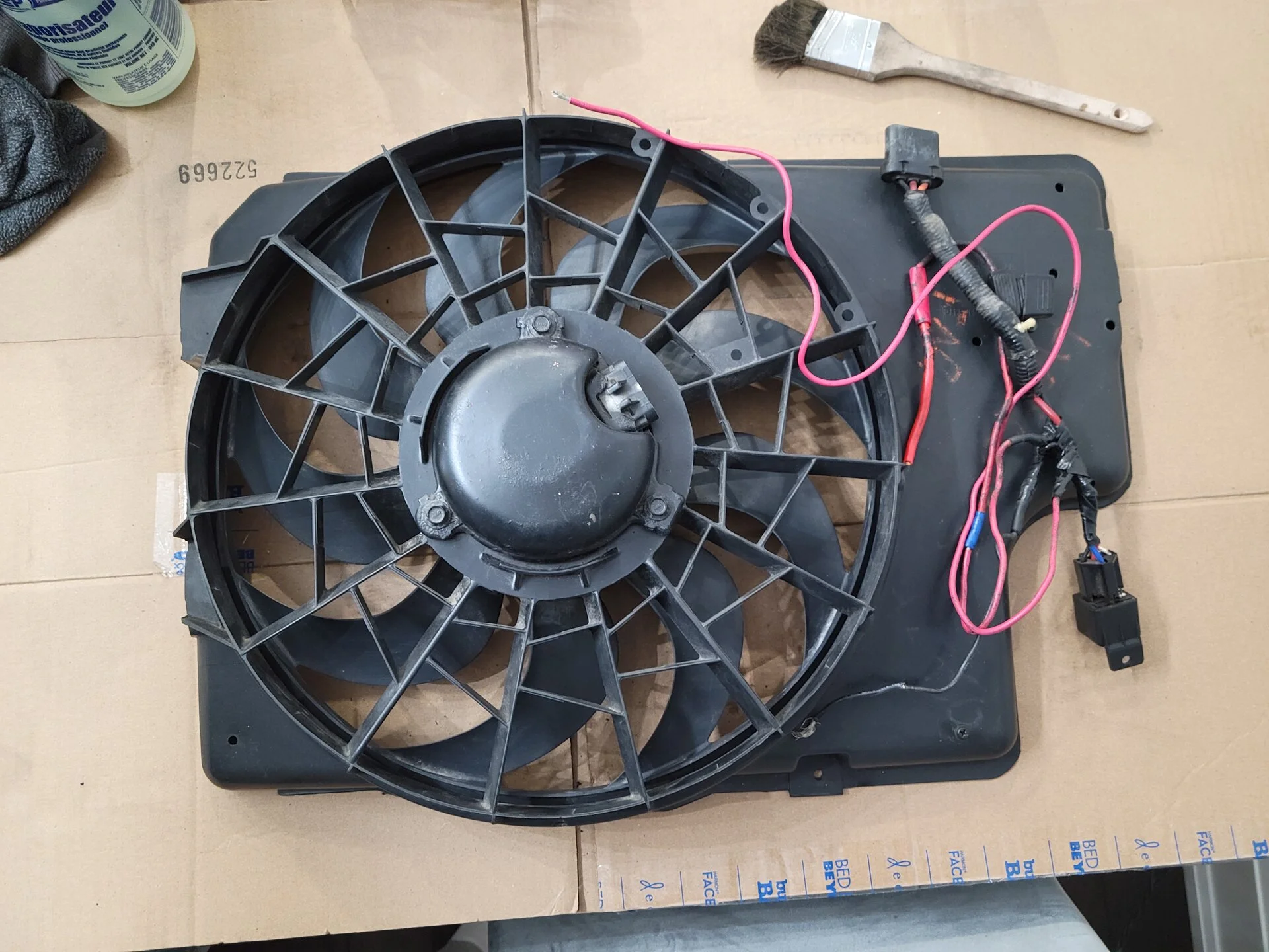

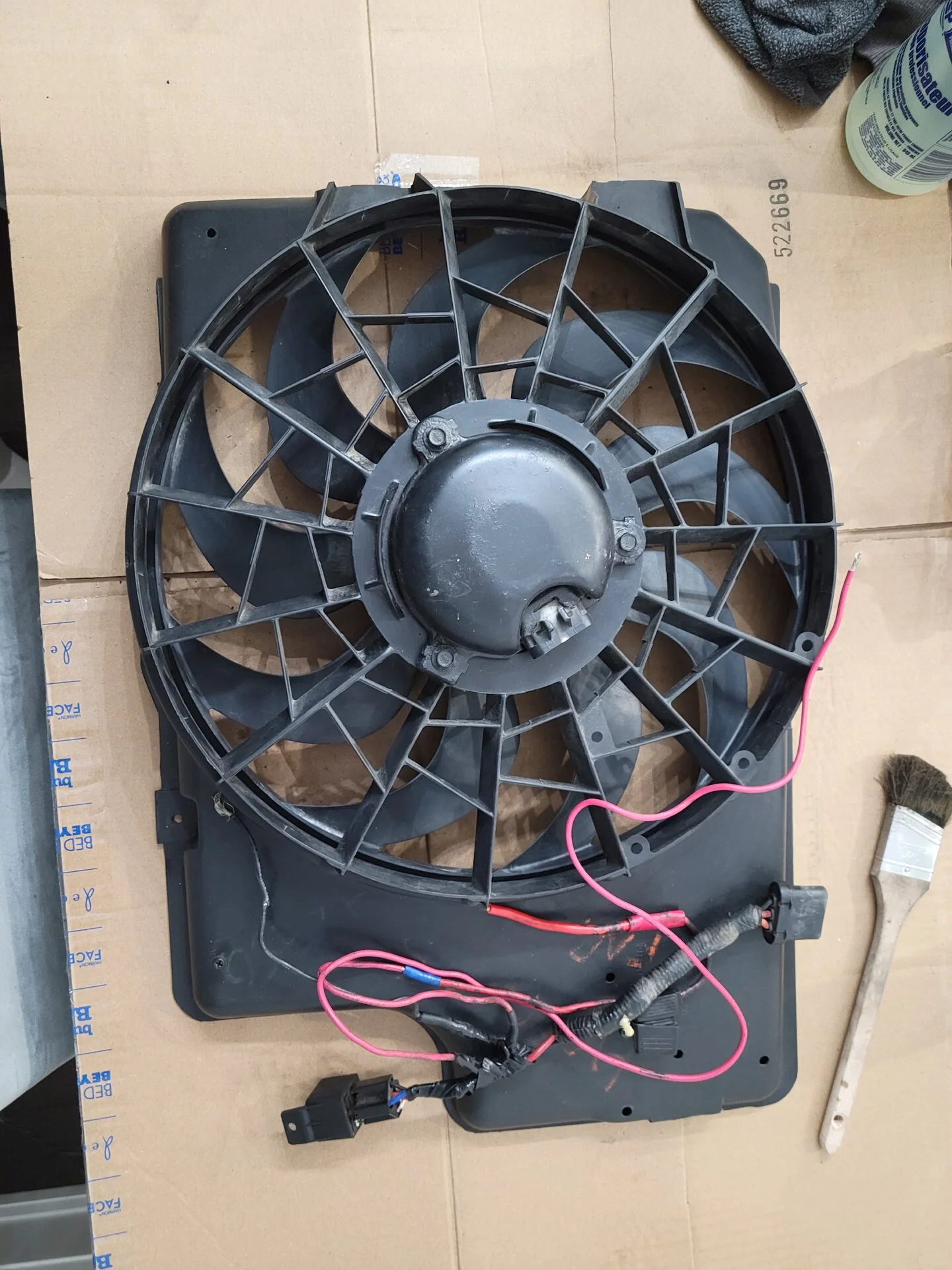

Hey guys, so I haven't been able to tackle anything from my winter laundry list so far. Had another addition to the family so with two kids under 1.5 yes old it's hard to justify getting out in the garage. Also my heater broke on me so -20C with no heat isn't the most pleasant to work in.

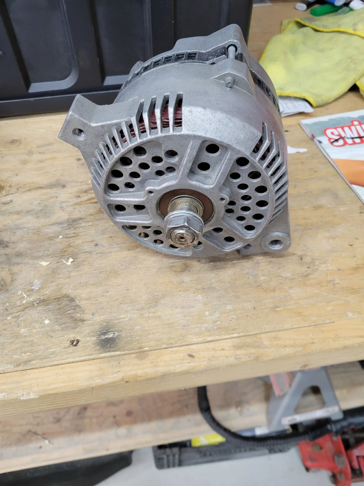

Aside from that I did scrounge up some stuff along the way.
3G alternator, 94? E-fan both for like $60 so hard to pass up, and some Sem trim paint for a refresh here and there.
My understanding is this is a two speed fan. Can the Pimp control both? Can it be done with a relay system above or would I need a standalone controller? Seen a few guys use OEM PWM controllers for varied duty cycle and soft start but I don't really care for it truly. This is a patch that will hopefully help my cooling issues when I'm stuck in traffic. If this doesn't help the rad would be next. Again I don't plan on going overboard with this car it won't see any more engine mods.

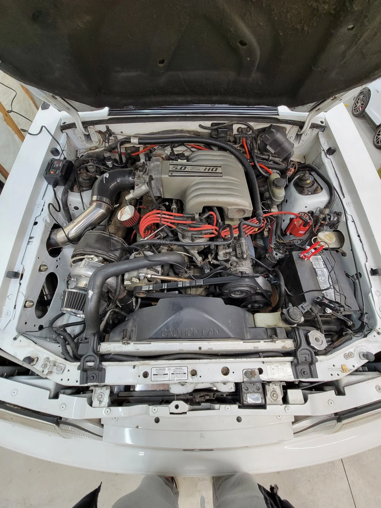

And a quick shot of the bay since it's been a while!
