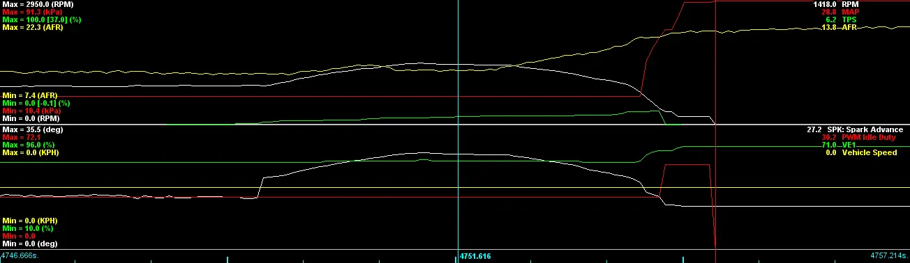

More importantly, i found out my idle & recovery still is not good enough as the car continued to die once i let off the throttle which began to happen more and more frequently not necessarily after a certain sequence. I am almost at my witts end trying to tinker and play around, Feel's like i'm chasing my own tail.
Anything stick out here why it would be dying off after blipping the throttle/after driving for about 10s? I get these massive AFR spikes as well out of nowhere.
Last thought throwing this out there. Is it possible my MAP is not functioning properly intermittently? It stays dead constant during different TPS positions shown below.

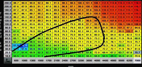

you idle at 28kpa; the max kpa at sea level is 100kpa your max kpa is 89 so I have to assume you are at a higher altitude. you could turn on the baro sensor in general settings and use %baro as the fuel load if this is the case.
as it sits now your lowest fuel row is likely 30kpa but you idle at 28kpa... this means that you are using 30kpa for cruise range at speed and for decel. You need to rescale the VE table
Im in toronto so it's not high. I noticed the same, which is leading me to believe malfunctioning MAP. Lower than normal Kpa at atmospheric and lower than normal at idle/decel. Gets to min of 14kpa under decel which I haven't seen usually.

Heres my current VE and i uploaded a tune and a quick log (with lots of sitting in traffic :( ...) for any suggestions that might stick out right now.
Rescale the ve table... 200, 175, 150, 125, 100 90 80 then smaller steps to fill the cruise range in better.
Now that lean spike is happening after you lift the throttle... That's not a lean spike that's normal.
But to verify I need to see the map signal as that is the load value the afr follows.
So i rescaled the table as you mentioned, but the lean spike is still happening. I feel that VEAL is always in a push/pull scenario. As i accelerate it adds, then on decel/cruise/1-5% throttle in the same cells it wants to pull fuel. This happens in several areas of the map that i consistently have to retouch manually.
