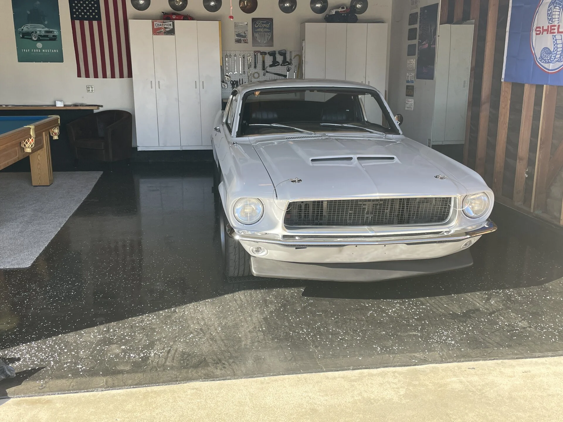

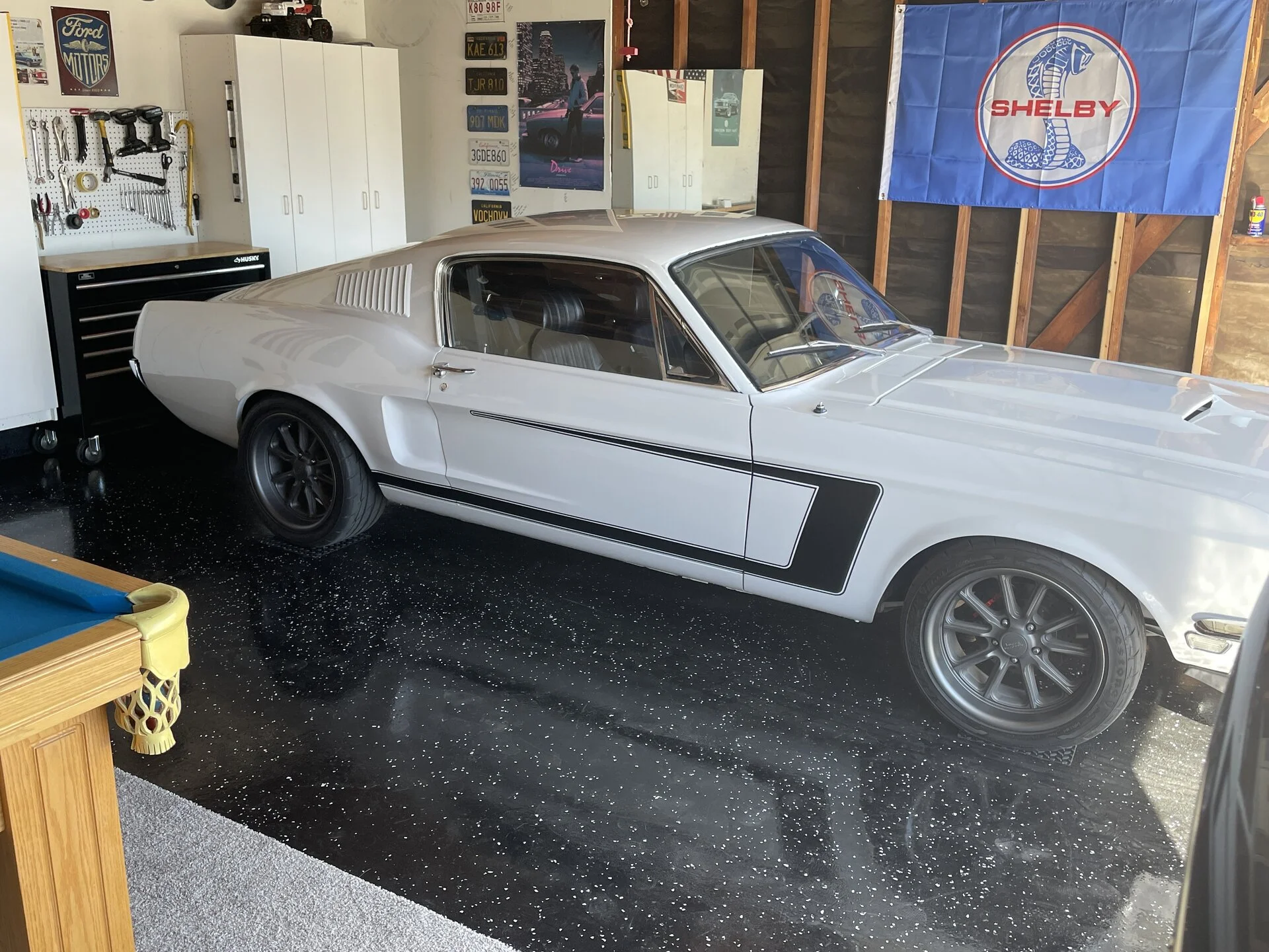

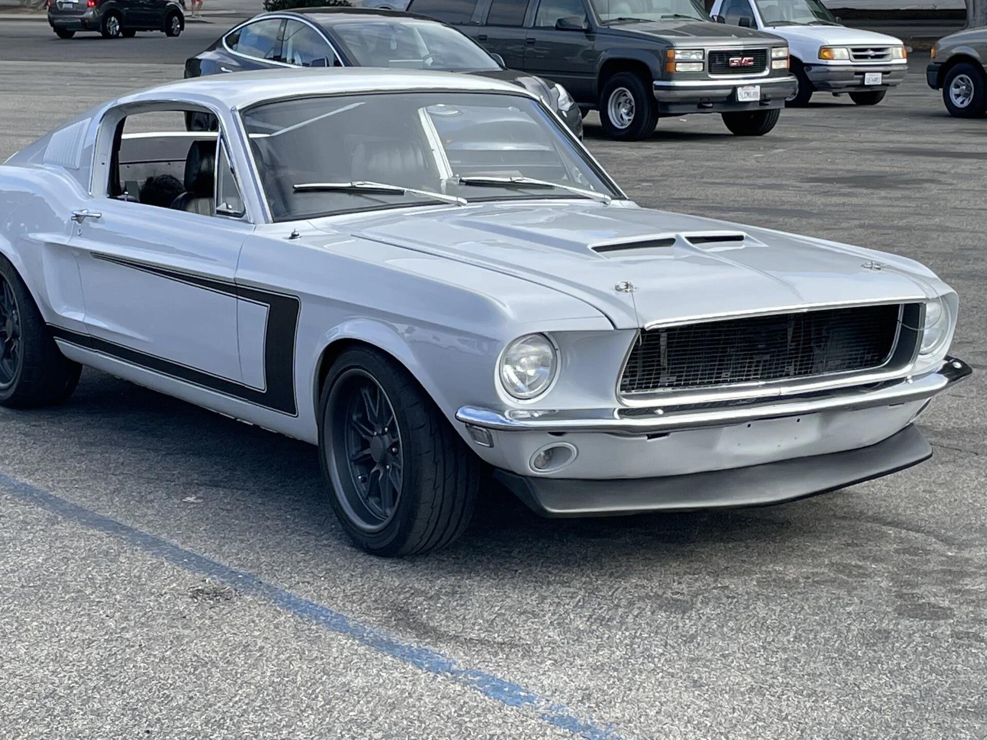

Plenty of thumbs ups!! And honks and picture takers today

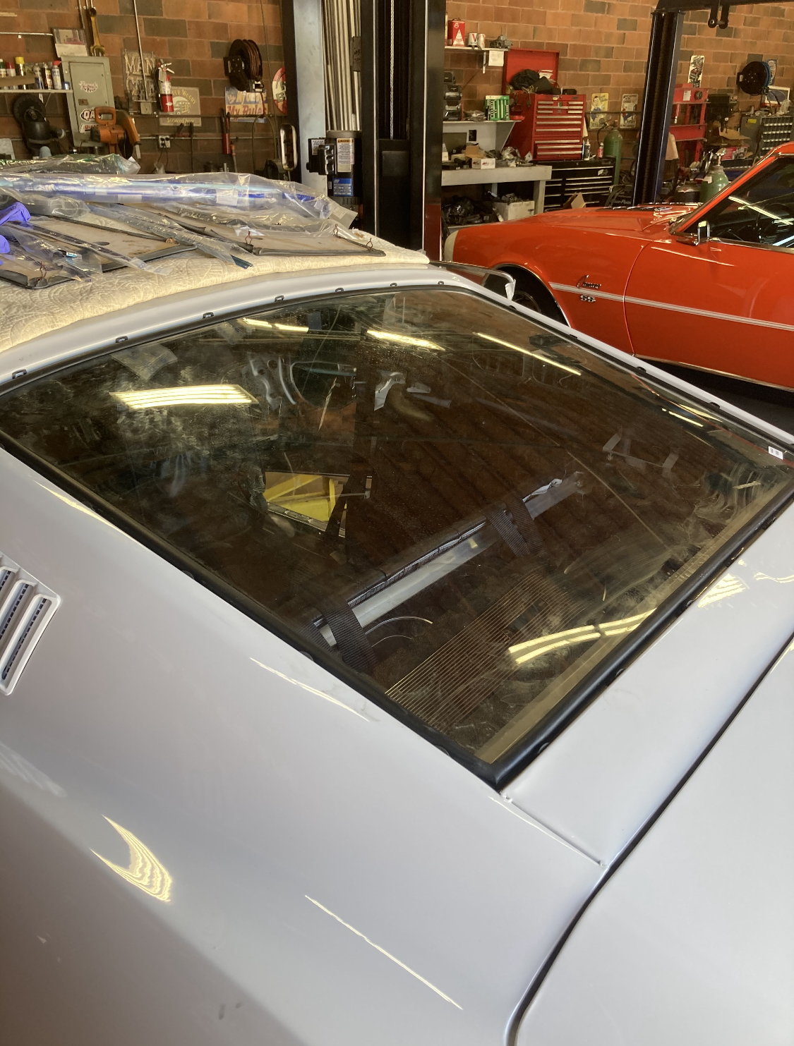

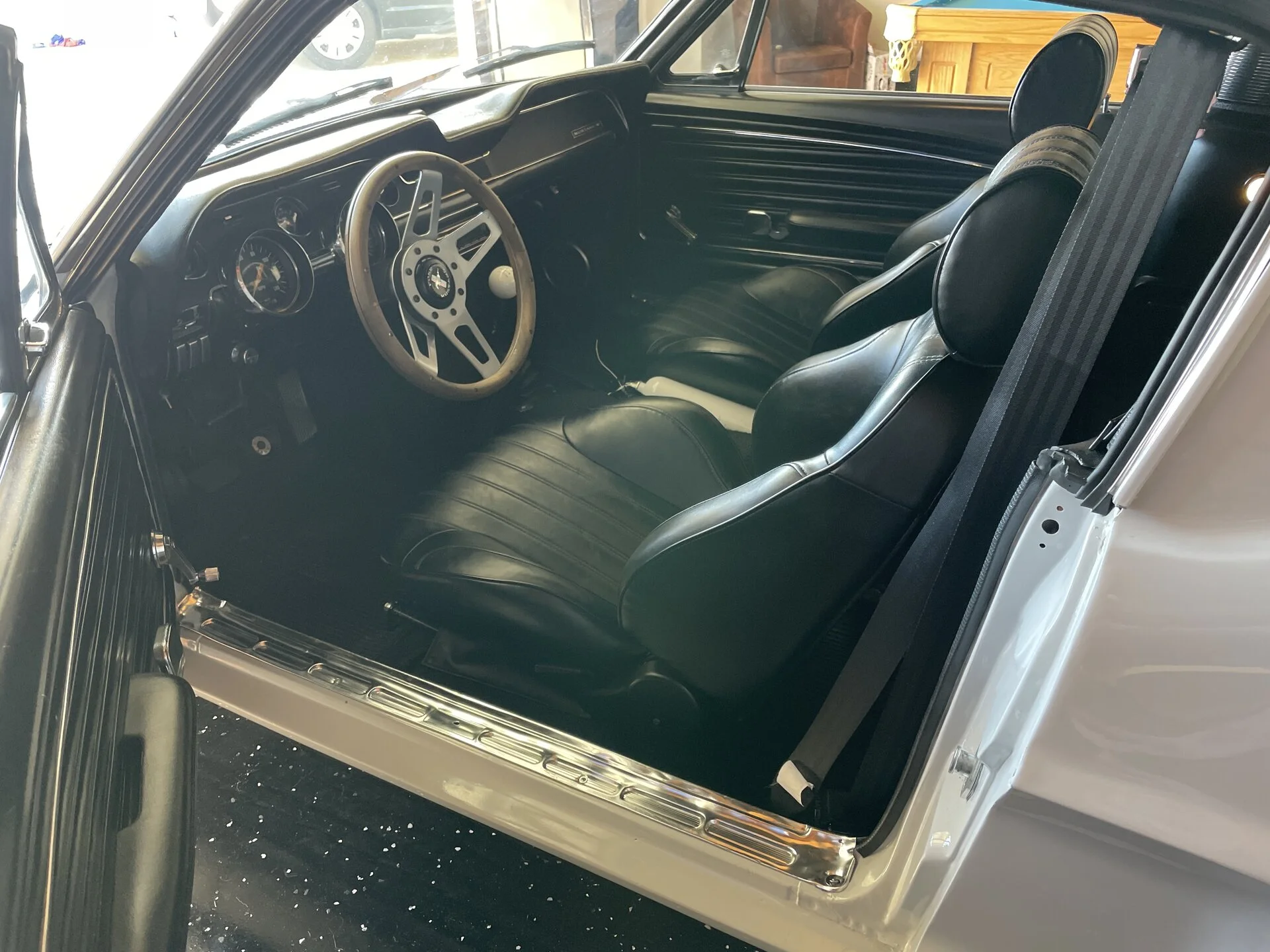

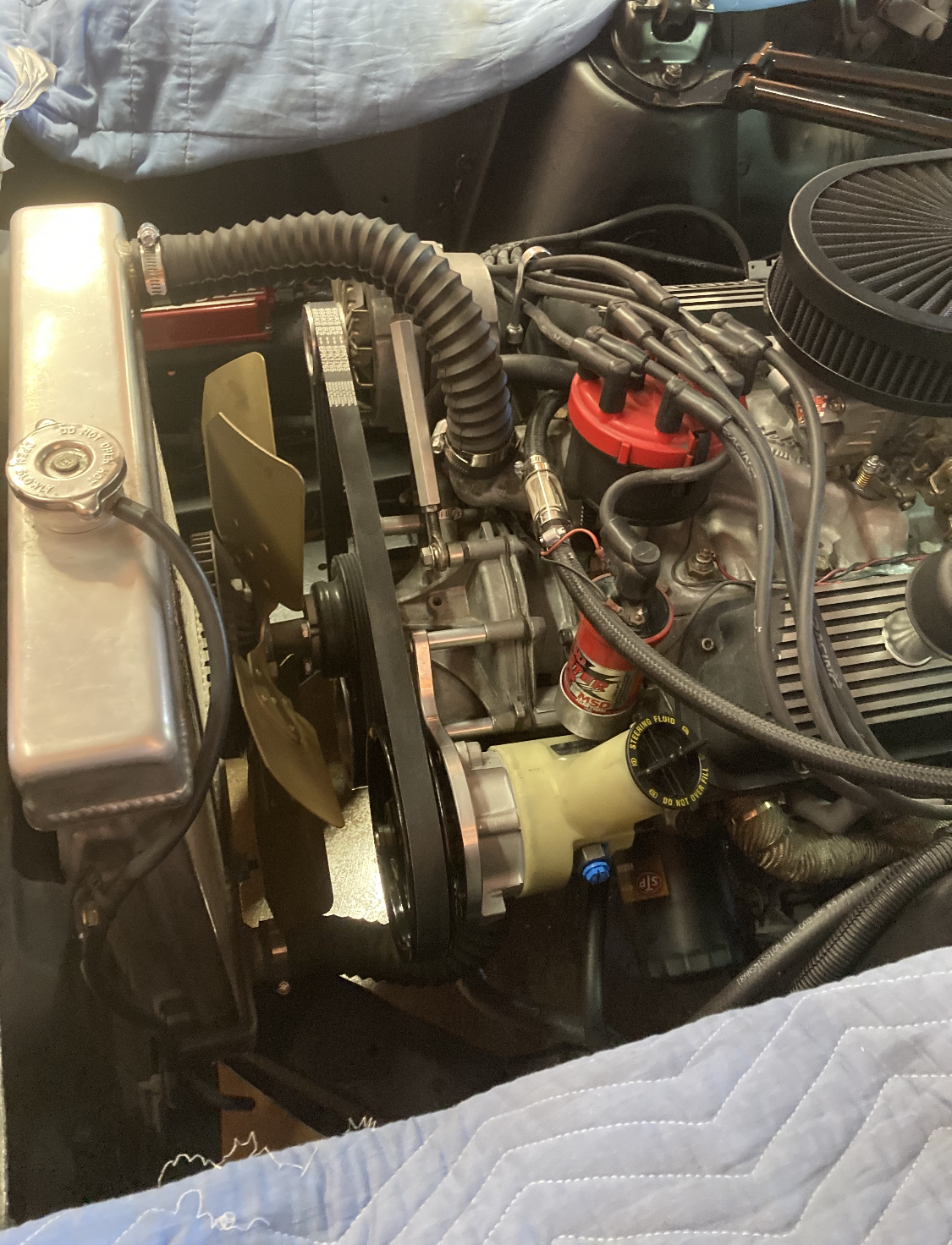

Well, I had a few questions about my car thanks to the amazing work Horse Sence has done.
It’s gone from a Coupe
-inline 6 cylinder
-Manual 3 Speed
-No power steering
-No power brakes
to a,
-331 ci Edelbrock RPM Heads/Performer intake, MSD ignition, E303 roller cam, 1.6 rockers, Holley 650, Hooker long tube headers, dual magnaflow exhaust with X pipe
- Manual T5 trans
-Baer Disc brakes all around.
- Scat interior.
after owning the car for a few years.... I search far and hard for a Fastback. It’s ridiculous how expensive they have gotten and I did not want to spend 40-60k for a solid starter car that was bone stock.
So.... I contacted Horse Sence and began to FB conversion process, which he has posted here on the forum.
He has done incredible work which has exceeded my expectations.
So now comes the rebuilding...
