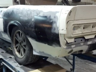

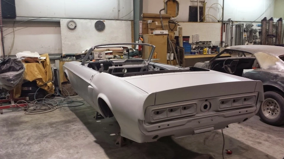

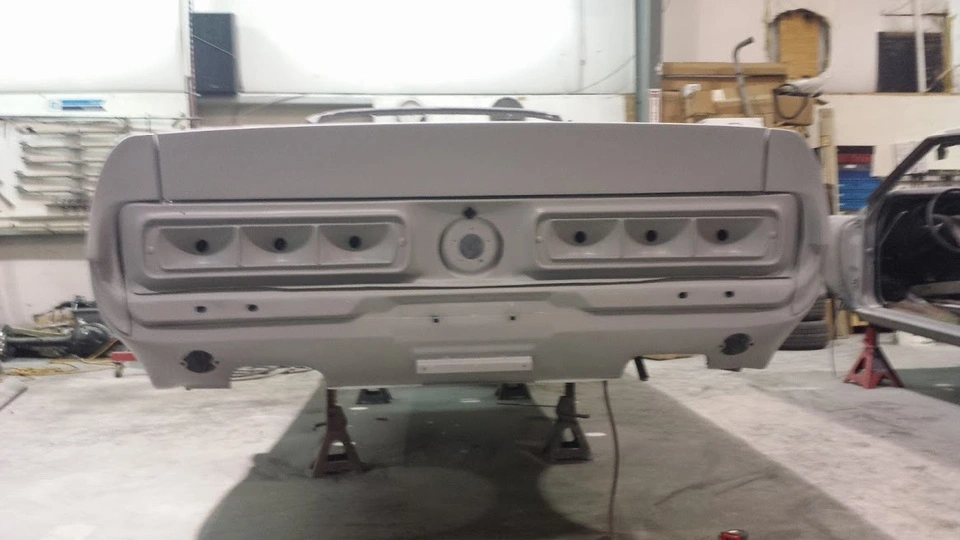

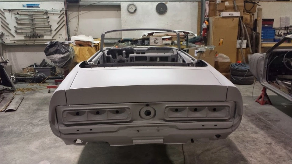

We were talking about the rear tail panel and trying to figure out how to keep the water out if it rained, I didn't know where to get the block off plates that came with the original Shelby - took a few hours of searching the internet and several times looking at the cobranda site to finally find them. So that's one more problem down - I noticed how many people just leave the holes back there or are now using the flat LED panels that don't requirement the holes.

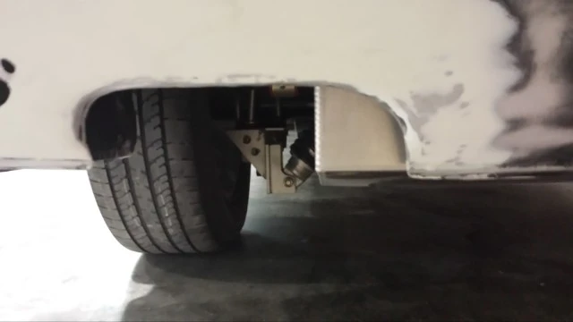

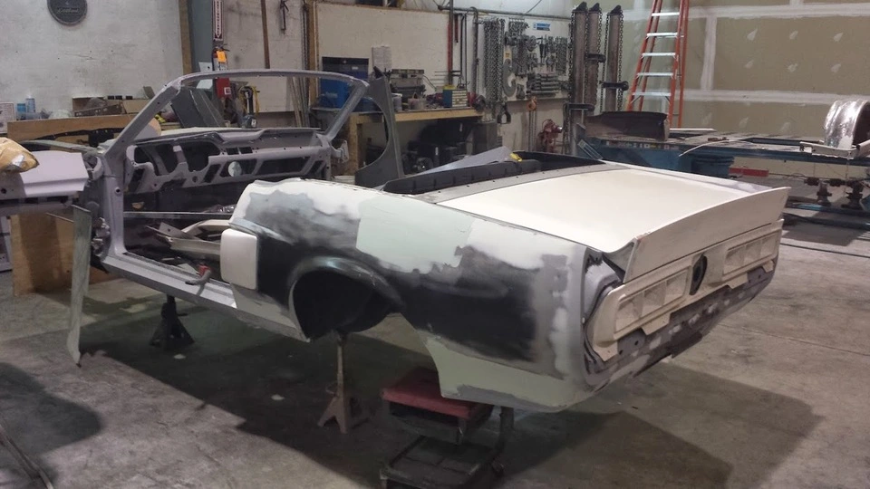

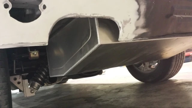

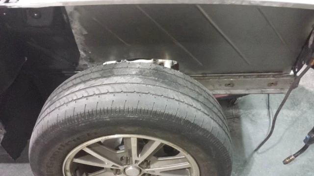

Driver rear side ground effects done - so we figured out I need to modify the left side FuelSafe cell now that I fit the dual 3" exhaust tips - never realized the fuel tank isn't centered. I need to cut out the left hand side a little to clear the tip and tig in a new piece of aluminum. I guess that's the price of custom body change.

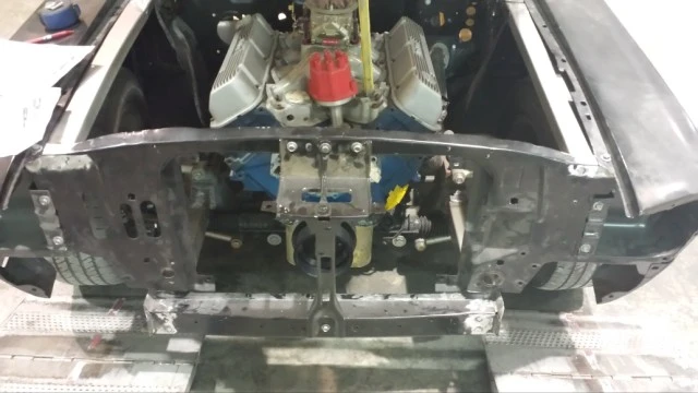

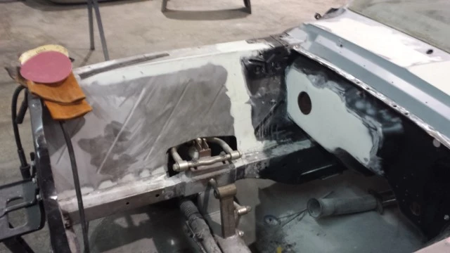

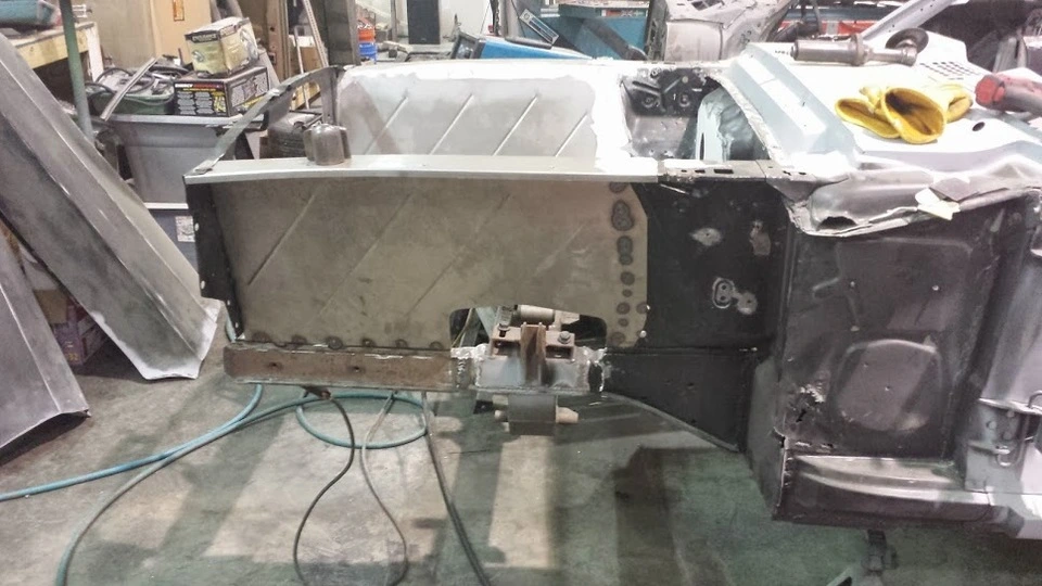

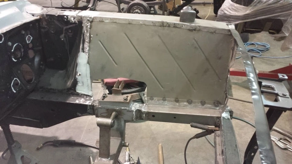

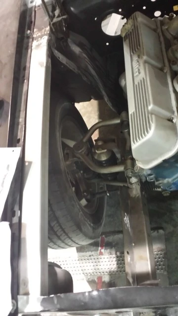

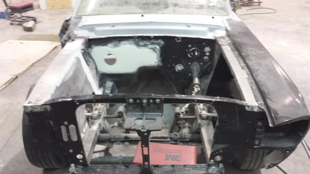

The front frame rails are gone! doing them over again, weren't done right the first time - They checked them - they were a 1/4 inch higher on one side than the other - I could tell just looking them them, they checked with a level - I have a weird eye for that.
The front frame rails have been replace from the suspension point forward, radiator support is in place and the upper fender support sheet metal is in place. The engine compartment panels need a little fitting and should be done soon. The Mustangs to Fear sheet metal was pretty good, few issues, but not bad.

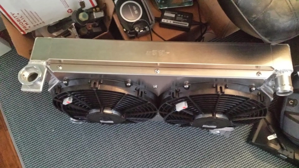

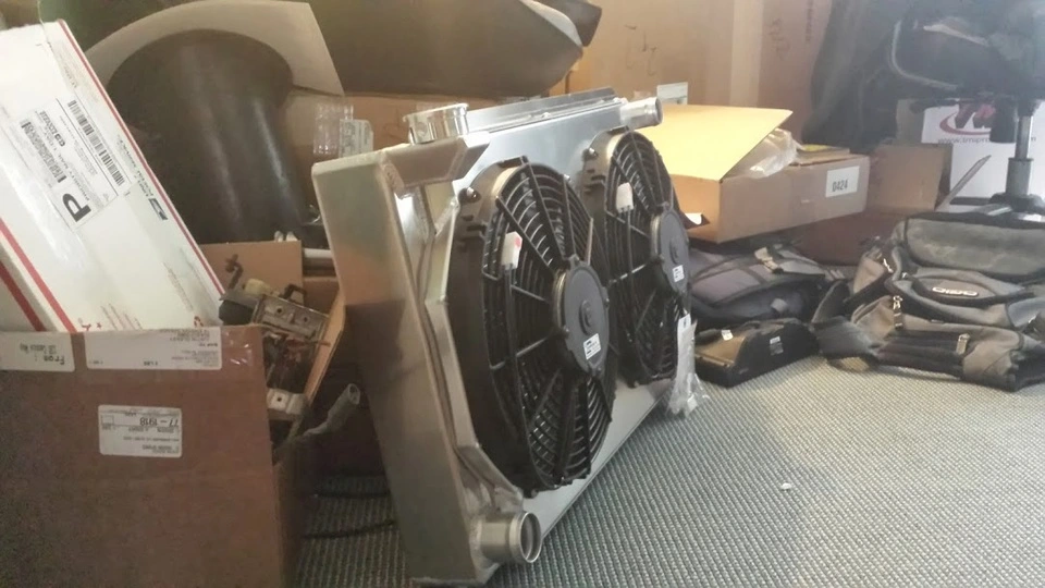

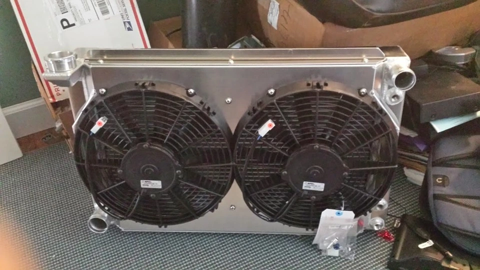

I measured out the new radiator and sent Ron Davis the drawings for a custom build, 4 weeks to build, should look sweet!

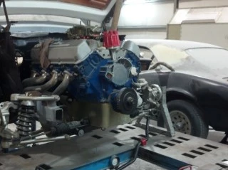

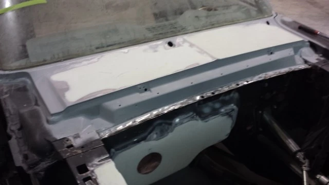

The engine is coming out next to finish up the firewall smoothing and fill in the cowl vents. Not long till it's in primer. Decided to paint the entire car red, even the engine compartment, it's easier on the painter to do one color - I didn't care.
Also need to modify the fuel cell, it's in the way of the exhaust tips, found a local guy to do some welding and fitting - need to quote still. I'm hoping it's not a issue to notch the cell - since it's just a plastic liner inside I hope it doesn't cause an issue to just allow the liner to be a little crushed when put back in the tank?

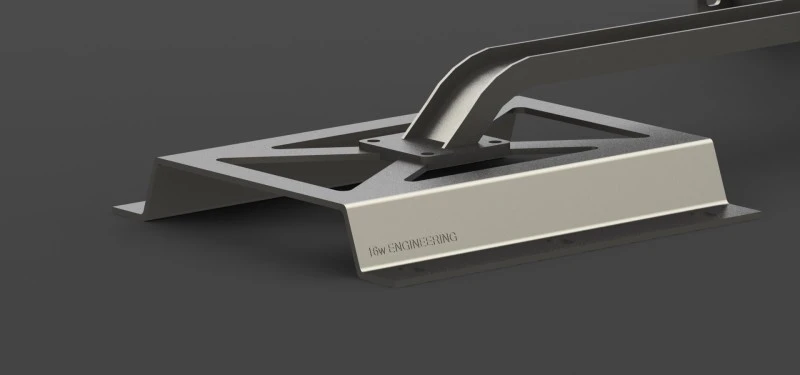

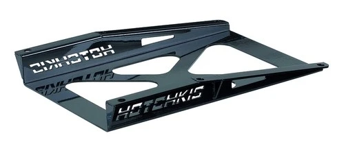

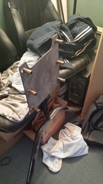

Also going to ask him to flowjet a different convertible plate - had to add spacers to it for the 3" exhaust to fit, I don't like it, asking him for a quote to make me one like the Hotchkis plate - maybe cut out GT500KR where Hotchkis is on the sample.

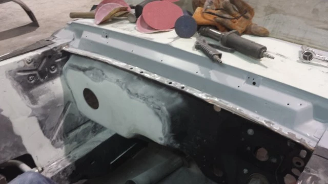

Mustangs To Fear sheet metal is almost done - cowl panels, heater box, inner fender replacements.
Smoothing the entire firewall - opening up the radiator support to fit the new radiator. Figuring out what holes stay and what ones go. Need to run the gas, brakes, engine wires, light wires, steering, and ignition wires. The rest get closed up.

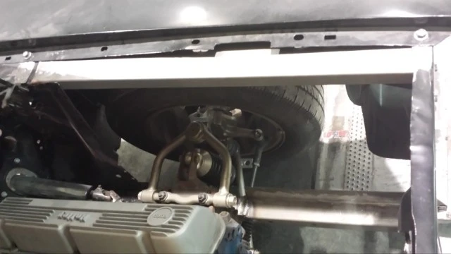

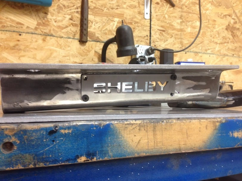

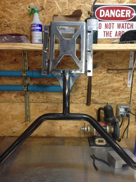

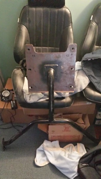

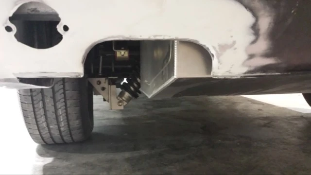

Having a Fab guy come by the house in a little while to talk about building a new convertible support plate - making it drop instead of being flat to clear the exhaust.

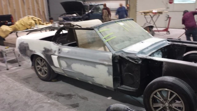

The car has been stripped and will be getting primed this week. Need to pickup all the suspension parts and engine parts to get coated.
The new Center Support Plate has been designed - will be built soon. He's also going to cut out "SHELBY" on the sides of the plate.
From this:
To This:

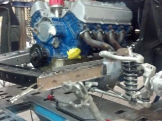

The car is back apart - final fitment and block sanding before primer. Parts are off for coatings. The custom support plate and Y subframe have been complete and fit. The guys is working on finishing up the welds and adding support brackets to strengthen it; it came out awesome!

* Finally got Ron Davis to design, build, and ship the Radiator - it's a month late - I ordered it in December, was told they'd have it to me by the 1st week of Feb because they were behind - it just shipped yesterday after many phone calls from them promising it was being built and shipped every day for the last two weeks. Will be here next Weds.

* Custom center plate and Y subframe component is done and delivered - the guy did a amazing job. He spent way more hours fine tuning and fitting it to the car then I expected.

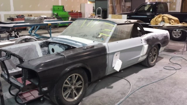

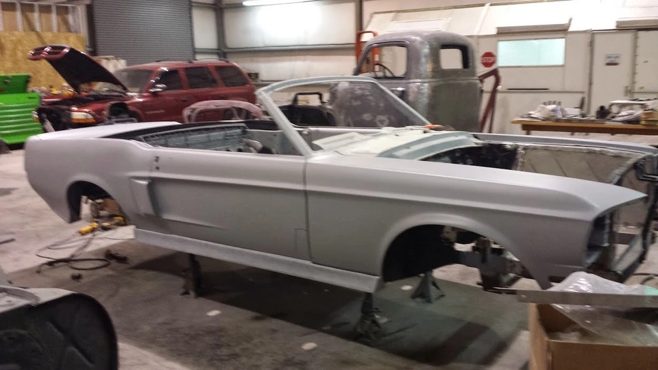

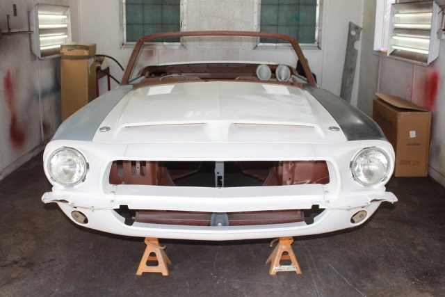

* The driver's side interior engine compartment panel is installed. Body guy just has a little more clean up on the front end then it goes into the booth for primer.

If anyone needs a convertible center plate that supports up to a 3" exhaust or would like something custom - my guy has the cad design and template done: https://www.facebook.com/16weng or http://www.16w.biz/
He does absolutely amazing custom work at a great price.
I would think there is a good market fort those center plates. I wanted to run a magnaflow stainless on my 66 vert but did not want to put spacers on and ended up going an oem type exhaust to fit. The dimensions are good for 65-70. I will definitely remember this on next build. Looks great.
That was my thought, I was looking for one, couldn't find it, so I had it built - he has the design now, not sure what he will charge now that the design is done.
Contact Anthony if you want anything, he does great work and is a great guy to work wth - https://www.facebook.com/16weng or http://www.16w.biz/

The car is mostly in one color now, few more tweaks - finishing raising the fuel cell up to clear the exhaust, few more holes on he firewall to close up, then block sanding by the end of the week, should have color by the end of next week. Viper Red with Pearl Shelby Lemans and side stripes.
