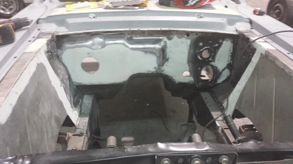

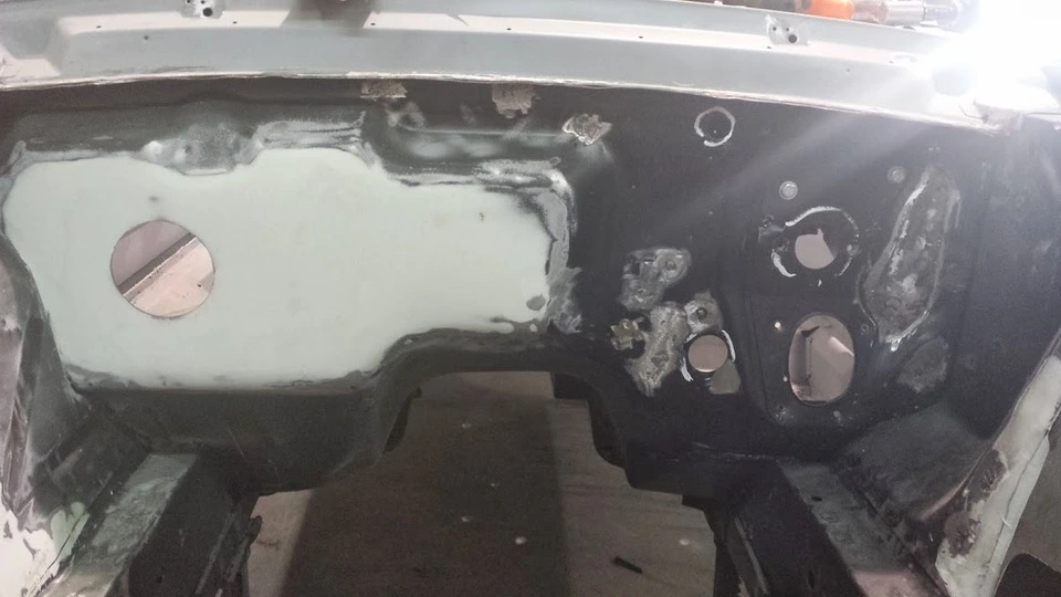

Firewall being smoothed:

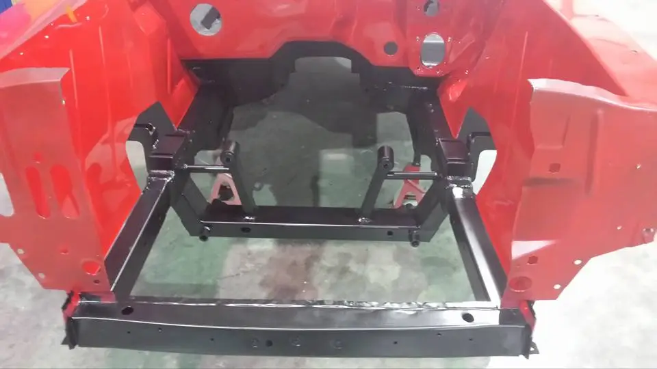

Got all the ceramic coated parts back yesterday, they look amazing.

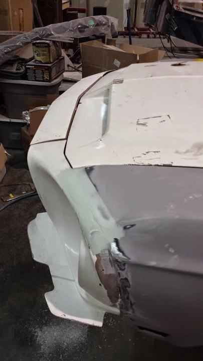

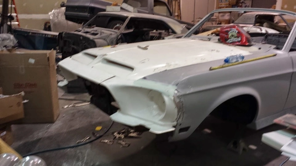

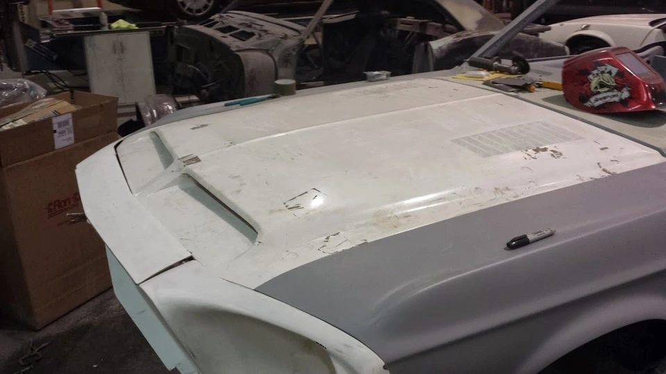

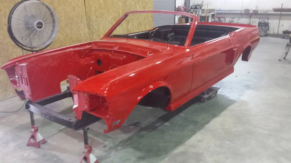

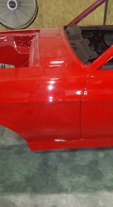

Ah, more fiberglass fitment issues - the front end is a problem.

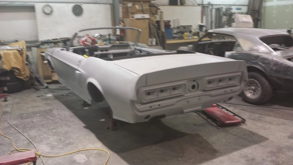

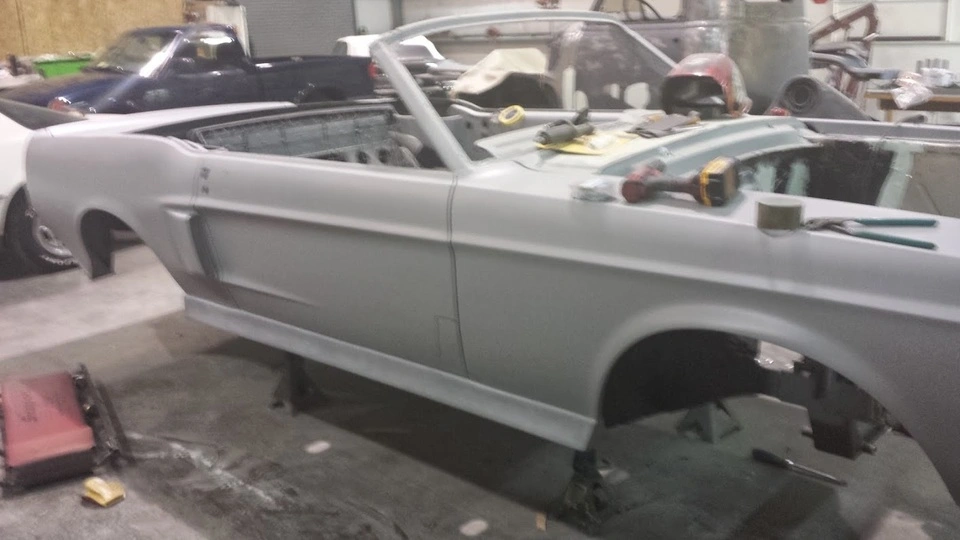

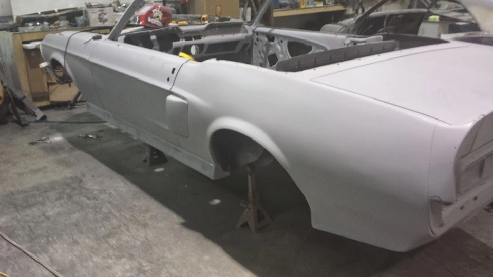

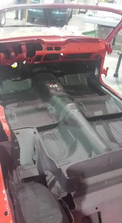

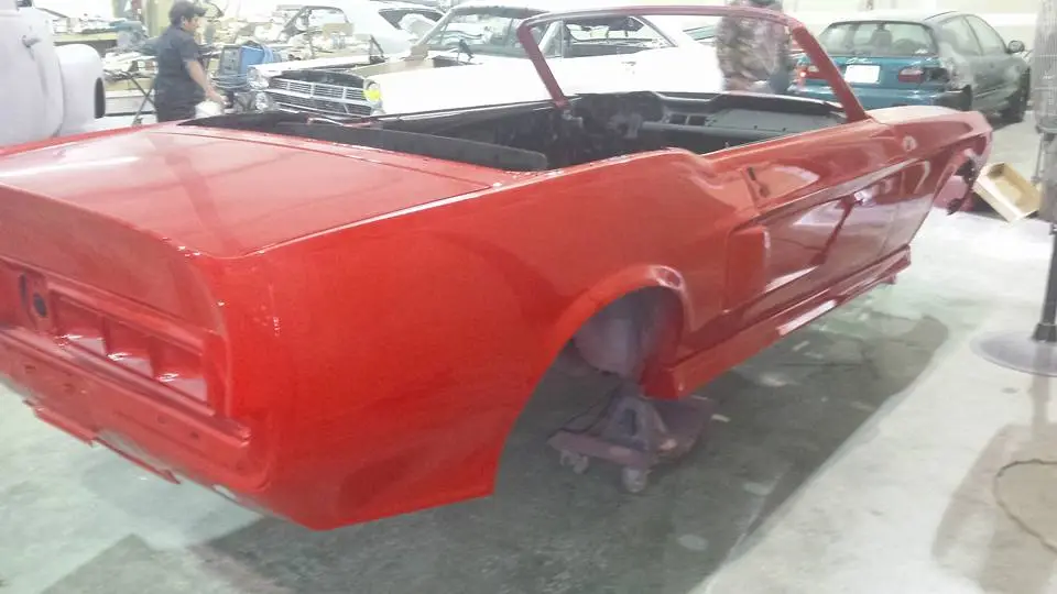

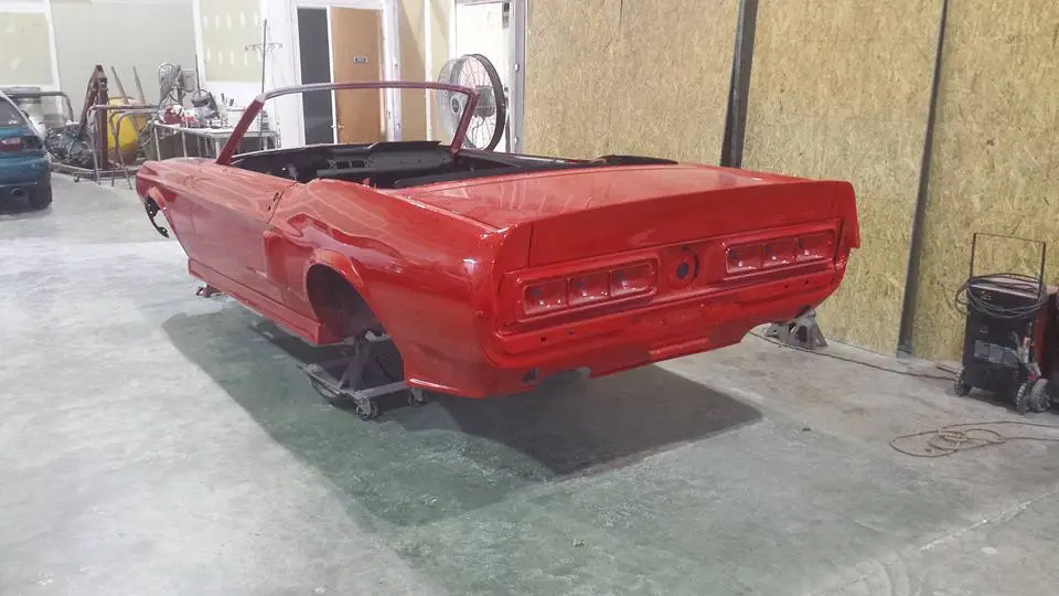

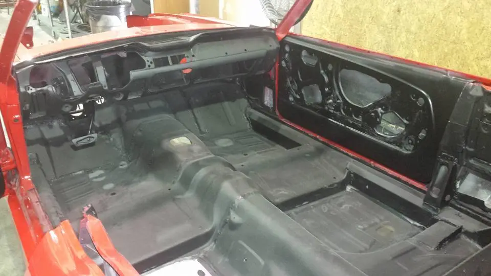

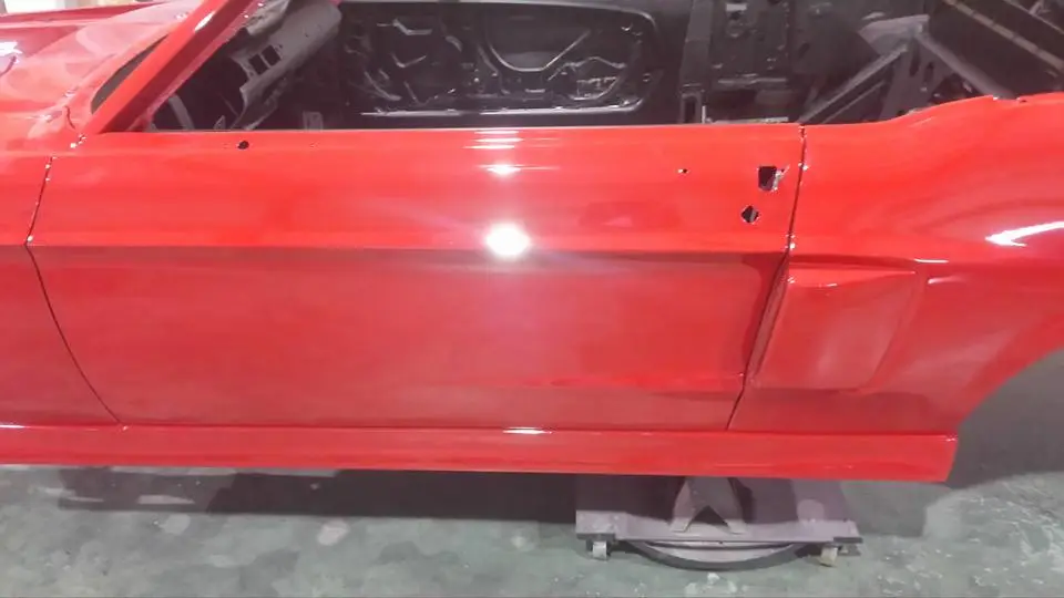

The firewall is done, got told the under belly of the car is a mess and needs cleanup, ahh, more money, the side skirts have been fitted and mounted - they look good. I was hoping to have the car in May, not it looks like end of summer at this rate. Gotta say I'm disappointed today.

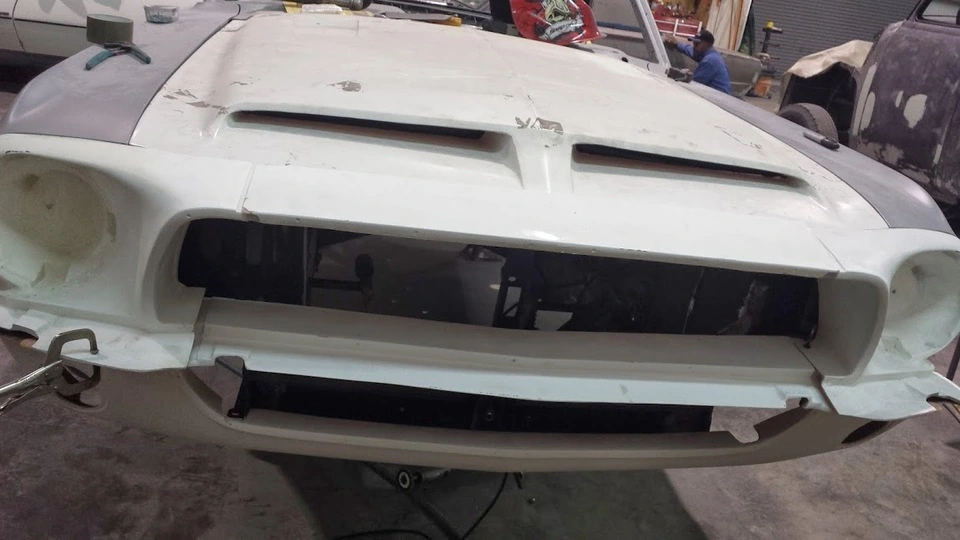

So my body guy is going to work through the fitment issues and do what he has to do to make the fiberglass fit. He also think it will fit and hold up better if we bond the front-end together as one solid piece. This will also allow him to fill-in the gaps and smooth the fiberglass.

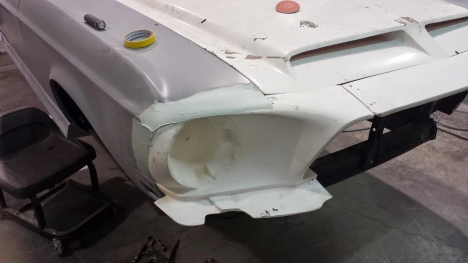

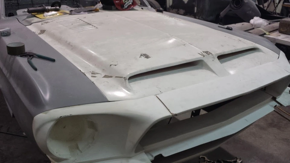

I haven't been able to get mine down off the lift ,got real busy all of a sudden .I will try to get it down in the next day or two. Looking better. The lower valance needs to be pulled forward to match the headlight buckets ,try that first then bolt the joint . swinging the bottom of the fender left or right will lower or raise the the headlight bucket at the hood.
Finally got the head light buckets mounted, we tried a few different ways, I finally just told him to bond them on. They were thin in areas and it just seemed like the smarted move. He's cutting up the lower nose to make it fit better. Stang-aholics never offered any help or bothered or bothered to call me back.
