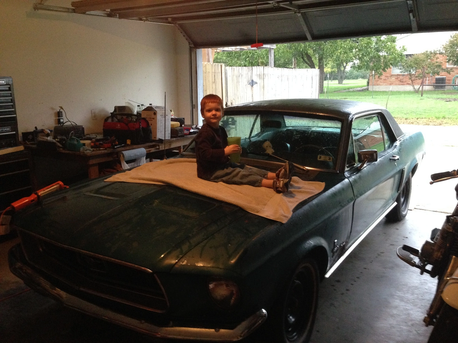

Checked out the cowel with a little help, no leaks inside the firewall! Looking into the cowel there is surprisingly very little rust...hope to find more good news! Here's my helper =) I'm not sure if I'm in the right forum but I'd like to get a thread going that shows my rebuild process. If there is a better place to post it let me know and I'll start a new one. I've got a lot of up close pictures of the condition I'd like to put in.
