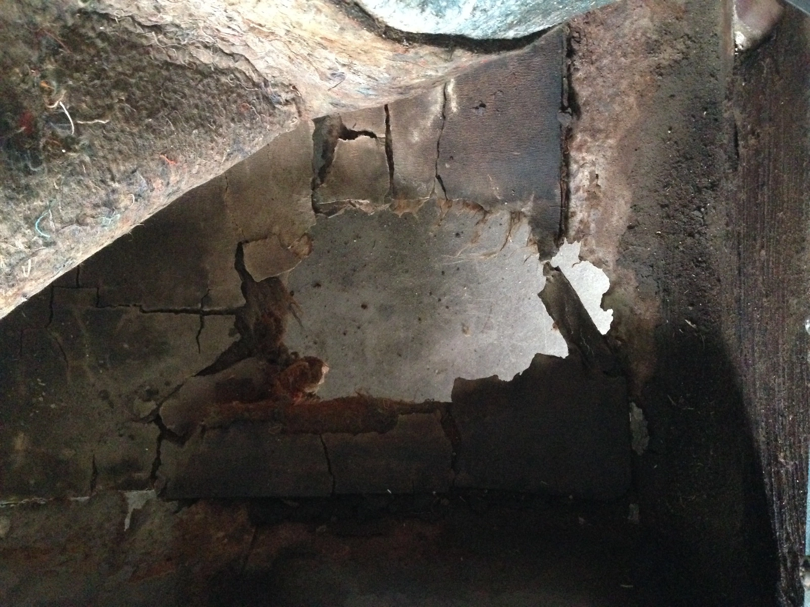

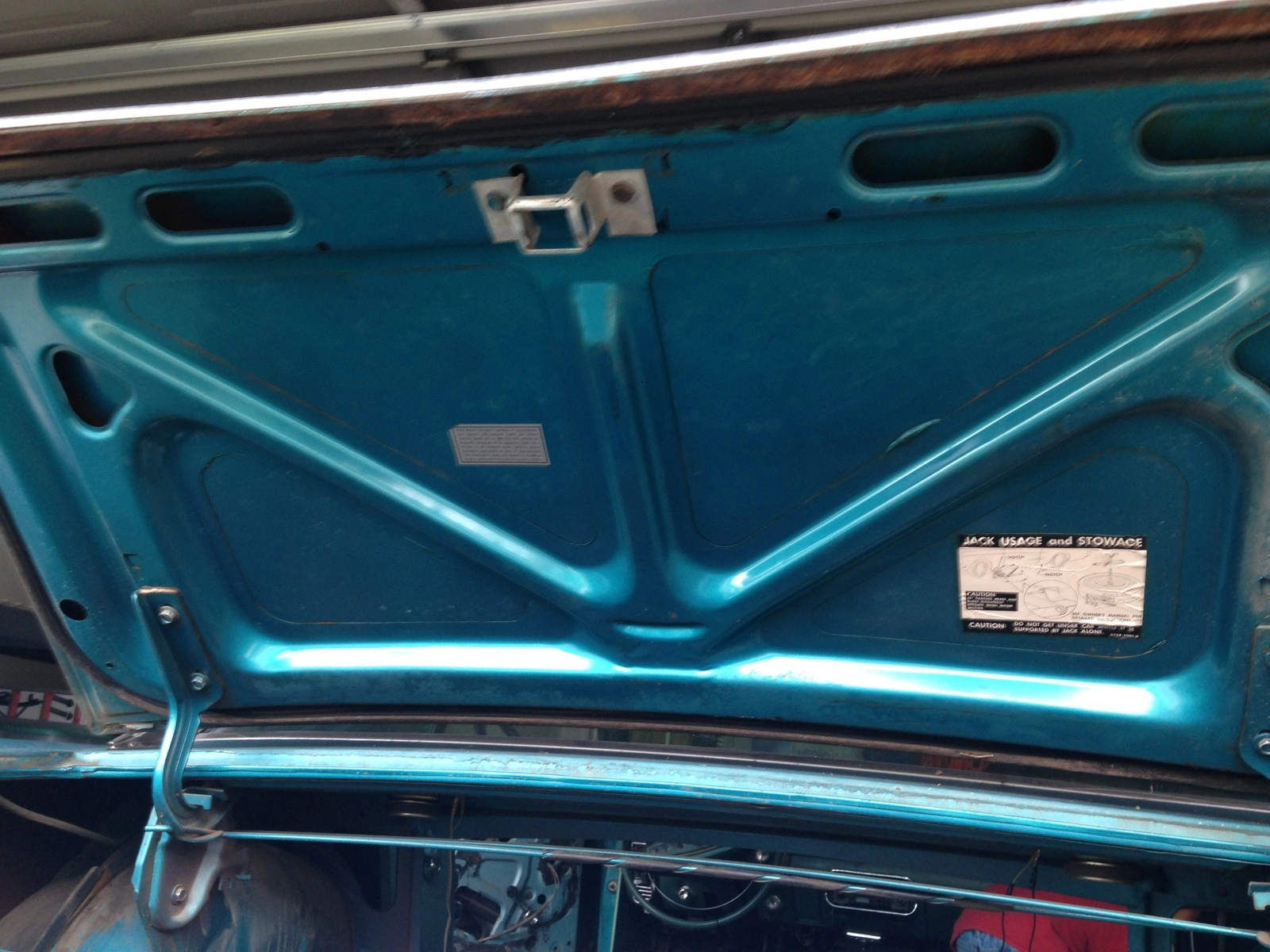

I finally got a little time to get into this project. This weekend we started pulling out the ineterior. Driver side door wouldn't open from the outside so I took the panel off and greased it up real good...opens just fine now. The mustang didn't come with a trunk key but I was told that the inside of it was amazing, mint condition, like it had never been opened before...ha not necessarily the case but the trunk lid does look spectacular! Ended up driling out the lock and purchased a new cylinder for it. We haven't pulled up all of the carpet yet but I did pull it back enough to see that the rear passenger side floorboard is rotted out completely. There goes my "rose colored glasses" =( I did check with Dallas Mustang and I am happy to see that floor pans are very cheap! Time to get a mig welder lol. New pictures being uploaded into my album but here are a few of the better ones. @Falcon79, whats your evening looking like today? I'll probably have an opportunity to get that carpet out if your interested in coming by to give your opinion?

Looks like a Mustang! It is great to see your kids "helping"! Patch panels are great but keep in mind that they stamp them for a range of years. You will need to do some trimming and some gentle persuading with a hammer.

Sound advice Jackson, thanks! I guess theres a reason patch panels are so inexpensive lol. I do have a question though regarding floor pans. The price of an entire floor pan is insane, something like 2k but a left side long pan and right side long pan is only around $50 each but it looks like the long pan is the entire pan front to back. What is the difference aside from not having the transmission hump?
Mustangs Unlimited has full floor pans listed for around $500 .i would rater go this rout .there will not be any long seams when done .it will look a whole lot better .and will be a lot safer .just the time and trouble saved going with the full floor is worth the cost .
I got lucky with mine and the rust was only on the drivers side floor and toe board and a small part of the passenger side. If suspect any rust on the tunnel save you money, do it right and repave the entire floor. If you do not get it all you will be pulling it back apart and redoing it. This is a long and expensive road. It will take longer than you think and cost 3 times what you are planning. In the end it will be great and you will have done it all yourself.
Oh and I think I have bought at least 3 toe boards and 4 pans. I screwed them up a couple of times and once I got a set in I did not like the way it looked and cut them back out :) I would have saved money just buying the dang full floor!

Ok, got the carpet out of the back half. It looks like floor pans will be a must! The passenger side back seat has rotted through. The Driver side back seat has had a crappy patch plate installed in the past. Thats gotta go. The transmission tunnel looks to be in good shape though. Does anyone see anything else that should be of concern? That carpet padding was a mess! I sure hope that wasn't asbestos insulation because that stuff went flying EVERYWHERE. I couldn't get the set screw out of the shifter so that I could remove the front carpet. I could only get the set screw to turn a few turns and then it feels like its stripped out when I go farther. I'll figure something out though.

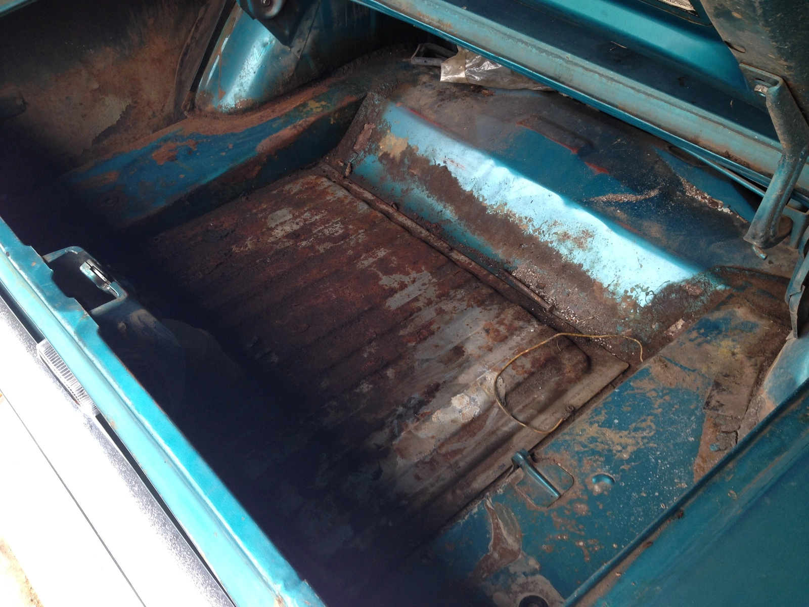

Thanks @afast93stang, that is pretty much my plan of attack at the moment. I'm waiting until tomorrow to order the floor pans when black friday sales start =) I'm leaning toward CJ becuase of the disount for buying both pans, free shipping, and the tax free break! I need to figure out what part that is I need to order for the trunk. I know the wheel house is rusted but I haven't figured out for sure what that drop down part in the trunk is called. Its visible in my pictures I think but you can see straight down into my wheel well. For all of you veteran restorers...what is your opinion on fiberglass body work repair? I intend to buy sheet metal but the guy at O'reileys (not the best place for advice) brought up a good point that you can mold and repair just about any body work with fiberglass and resin so long as you cut out the rust and prime/treat the surrounding areas. I know its a cheap fix but is this idea uncommon and downright crazy? Bah...I need money...and a mig...and more time off work lol.

dont do the repairs with fiberglass ,it will not last and it is a total mess to fix later .do it with metal . the side of the trunk floor that goes down into the rear quarter is called the trunk drop off it is part of the trunk floor.
