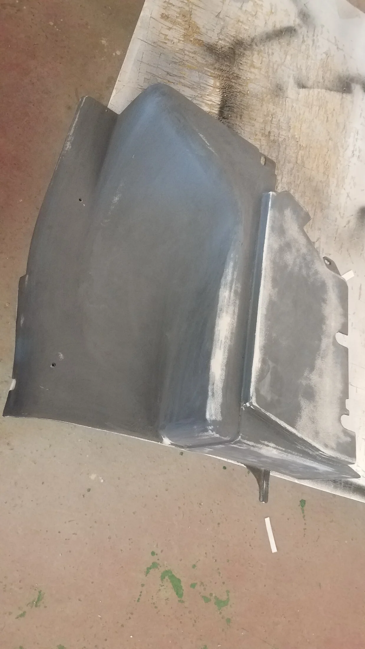

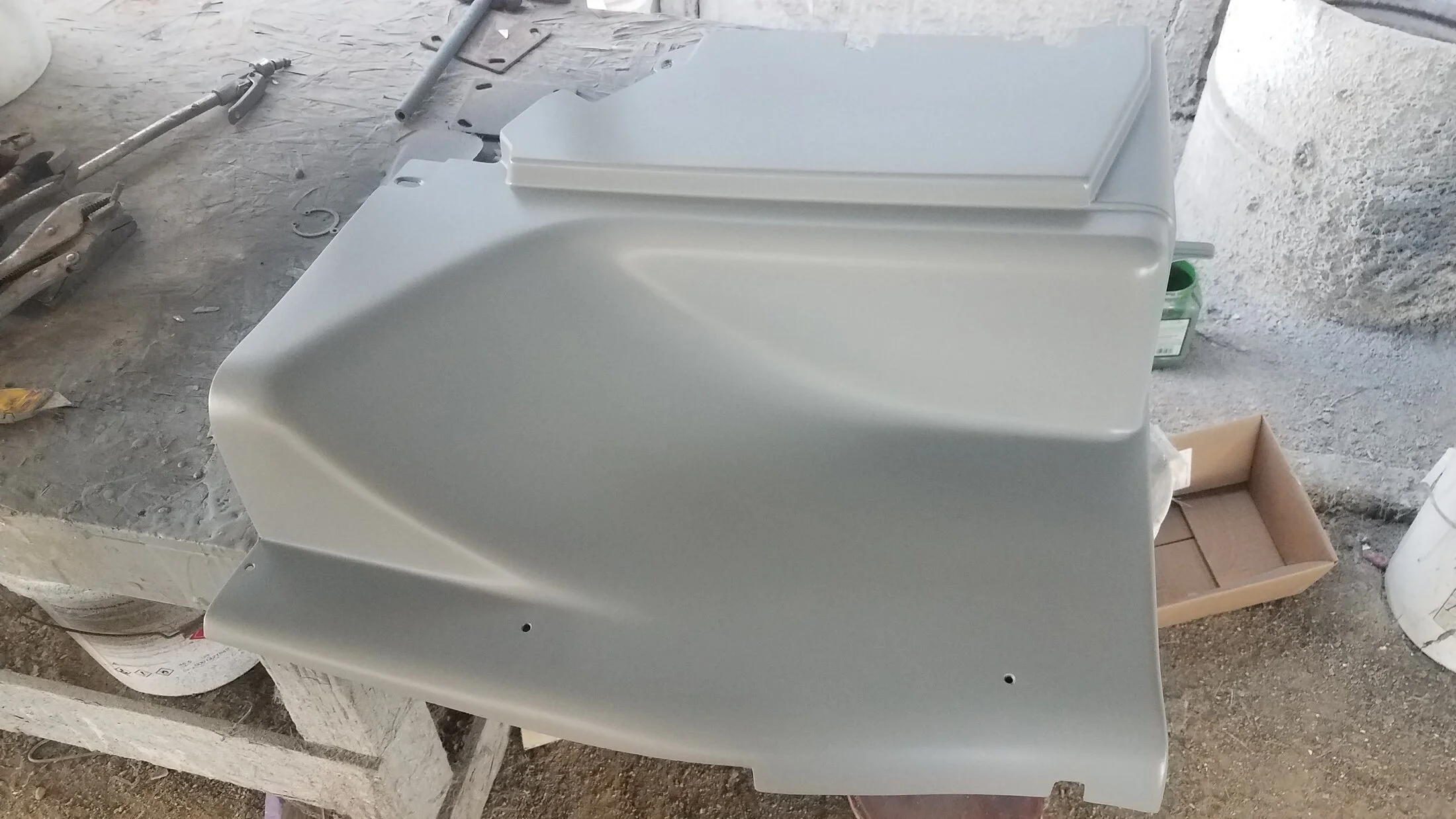

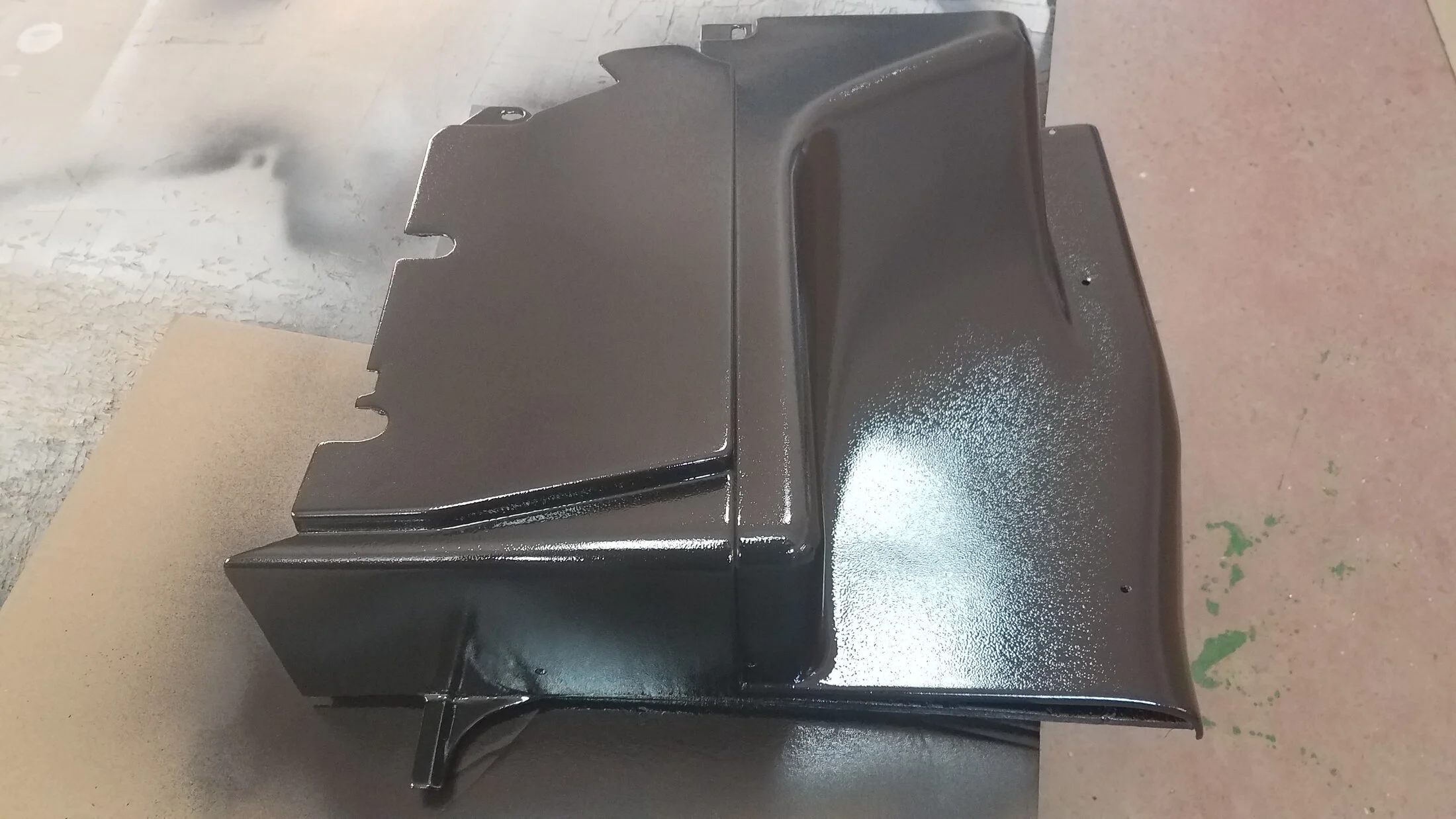

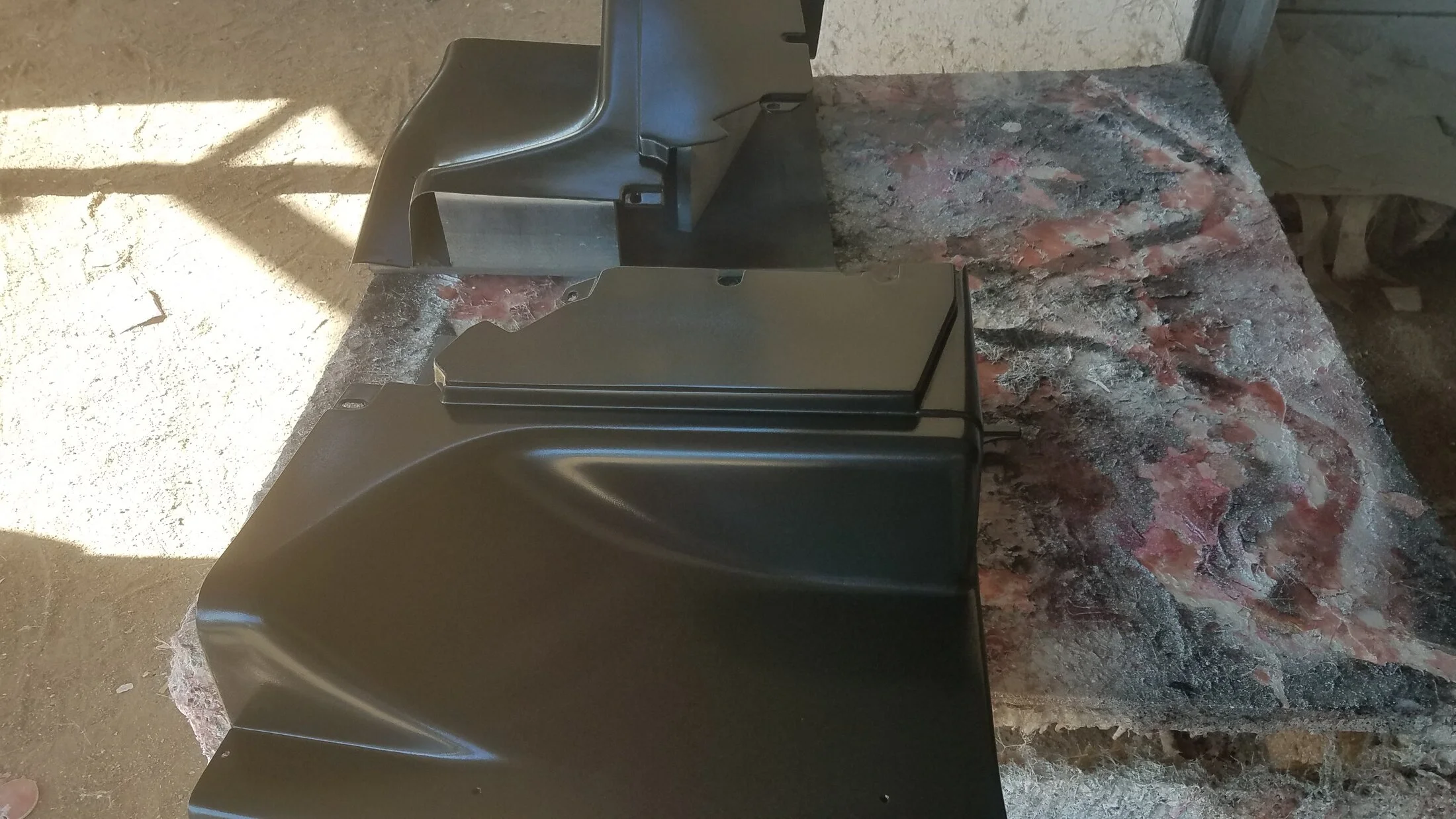

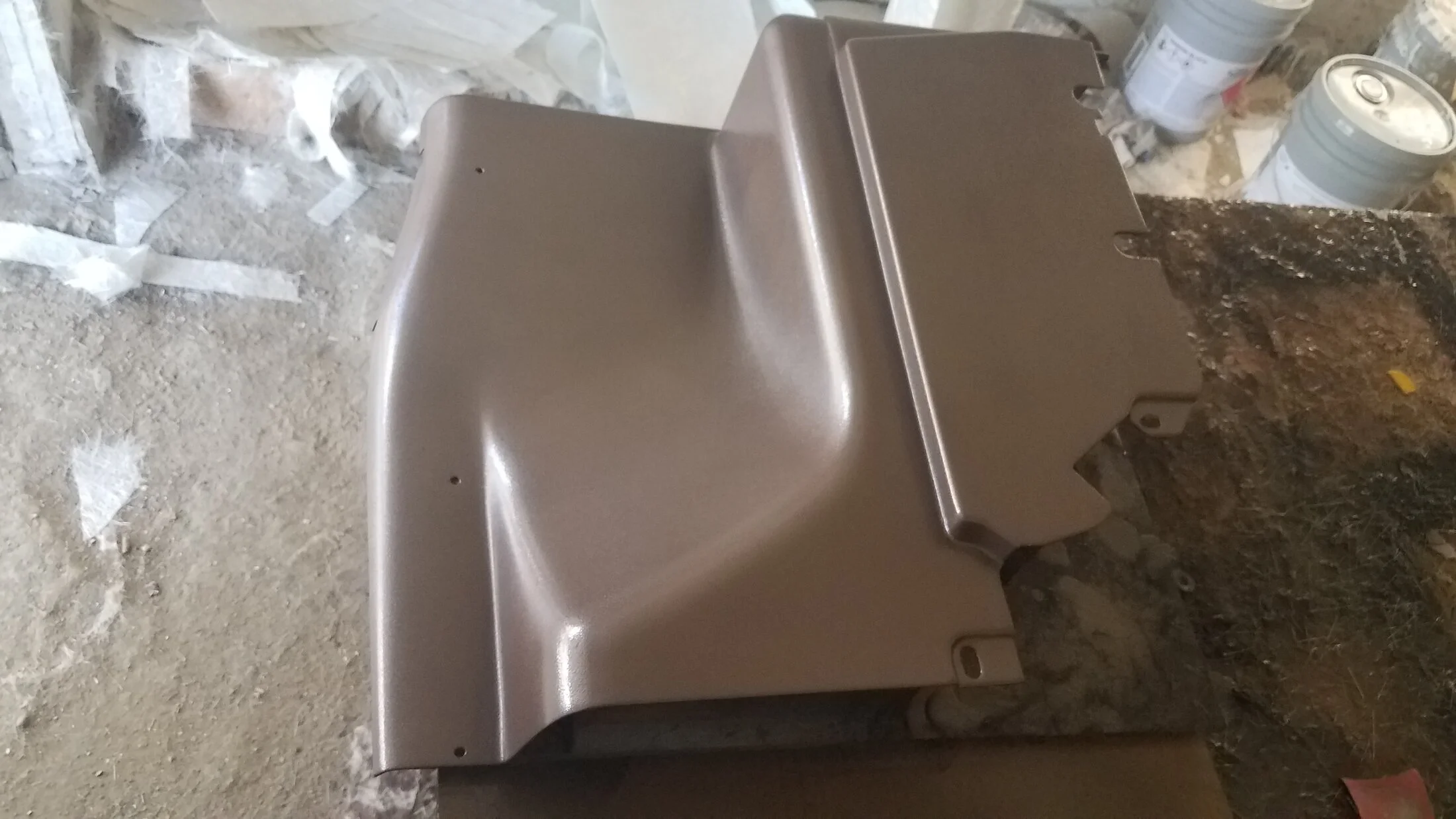

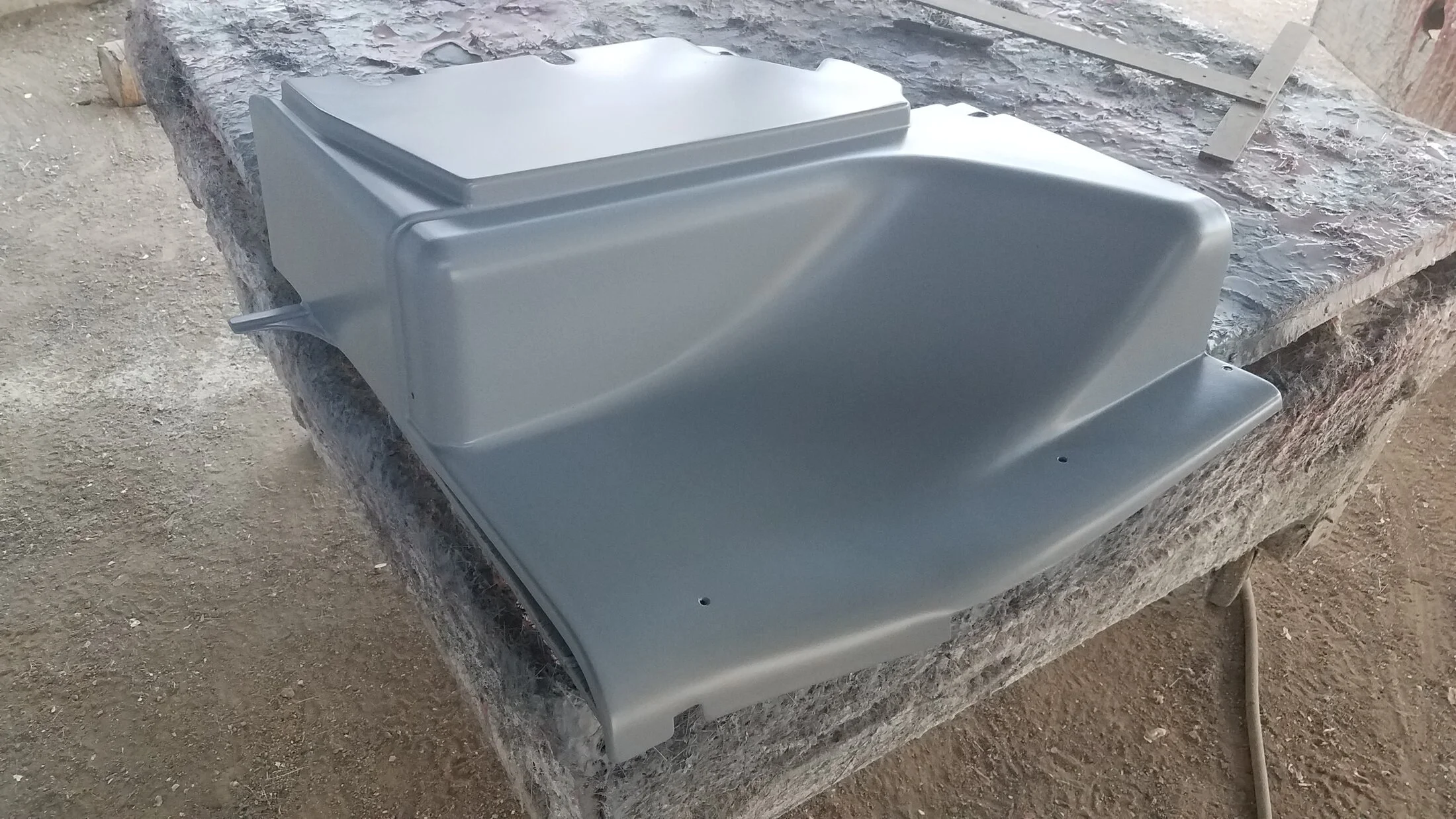

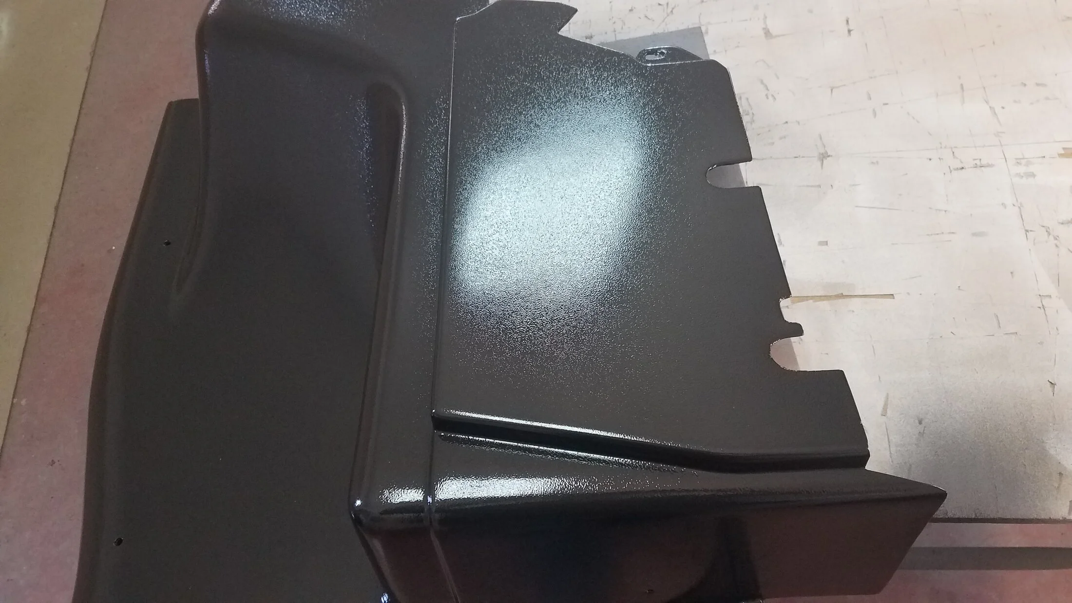

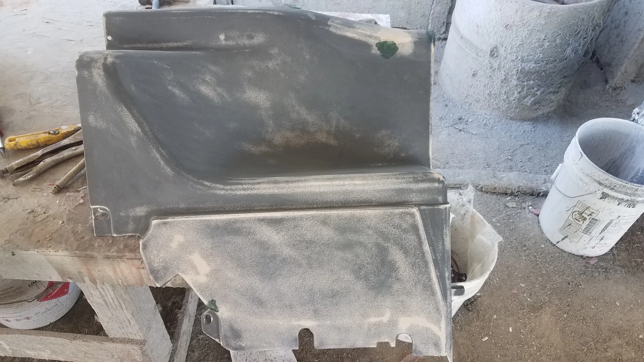

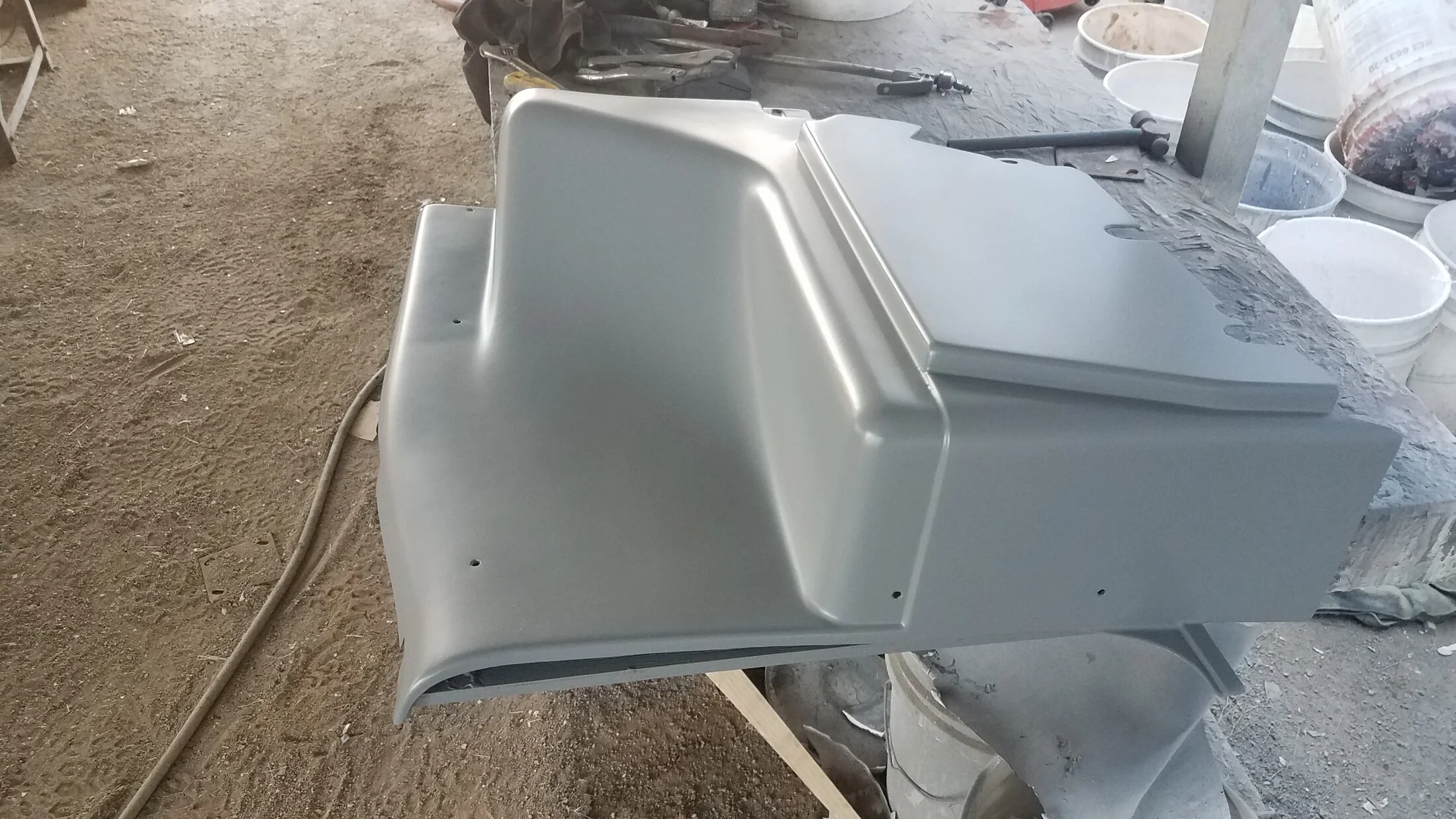

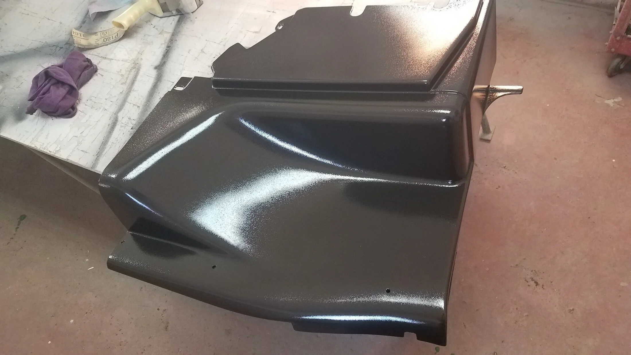

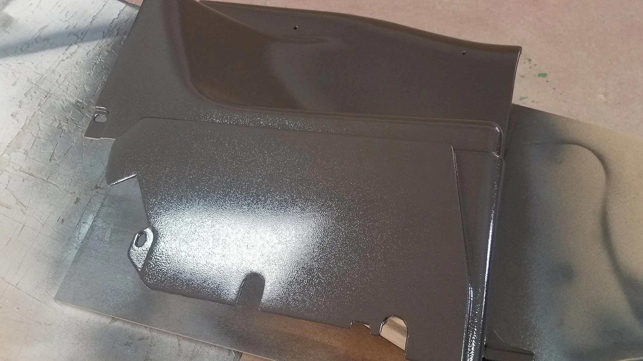

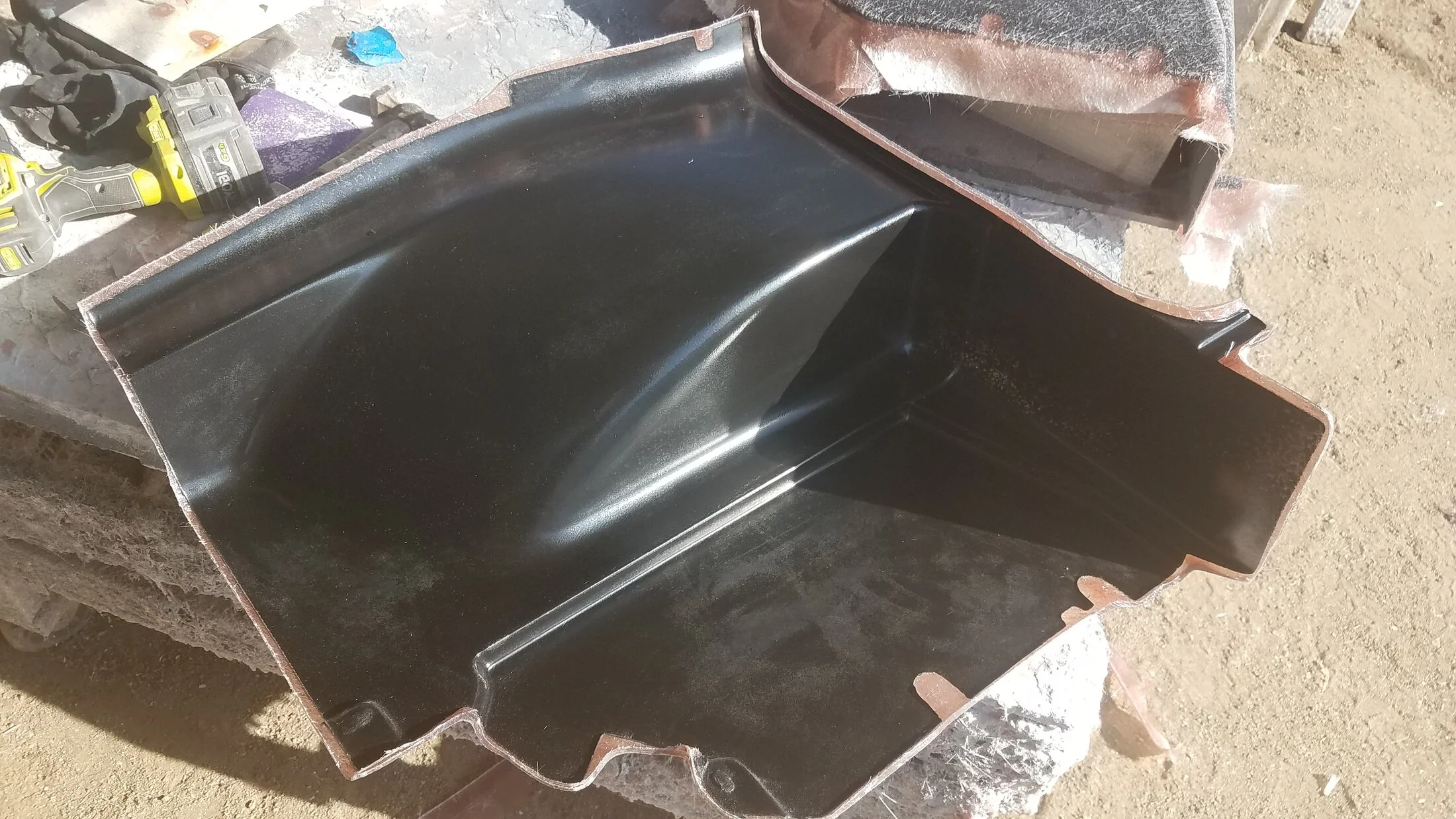

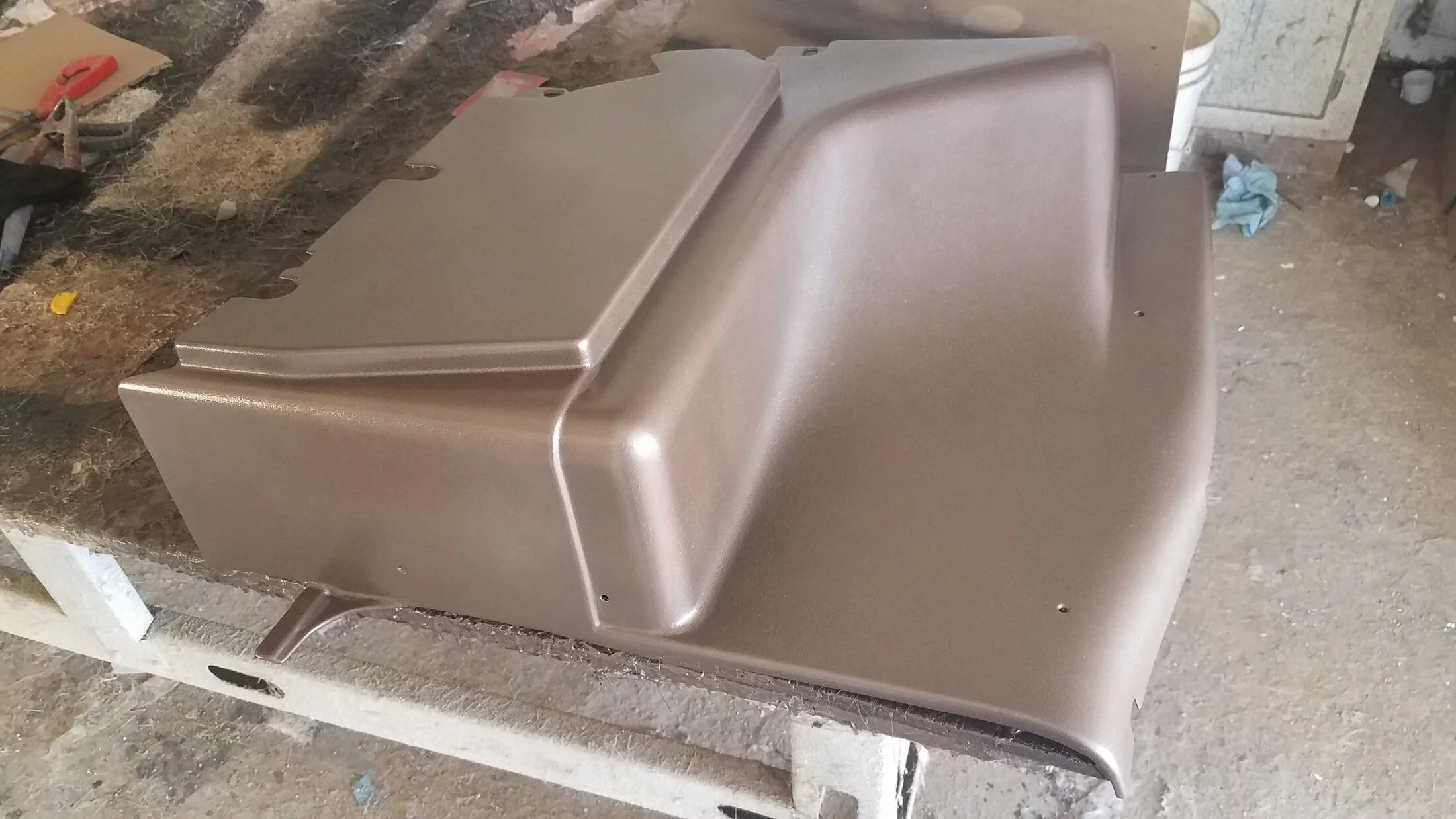

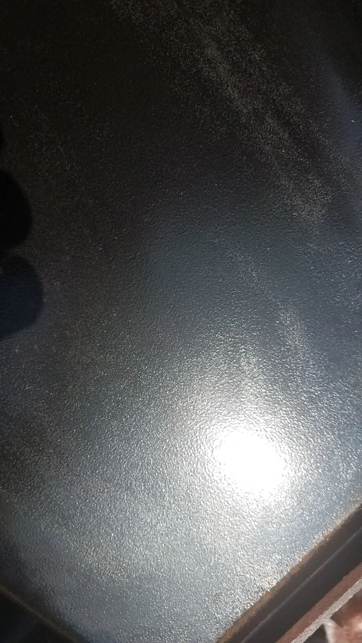

I have a fairly decent set of 69 panels ,a few scratches and some flaking paint . I am sanding them down smooth ,fixing any problem areas and spraying with high build primer so i can block them out smooth . Once smooth i will retexture and pull a mold

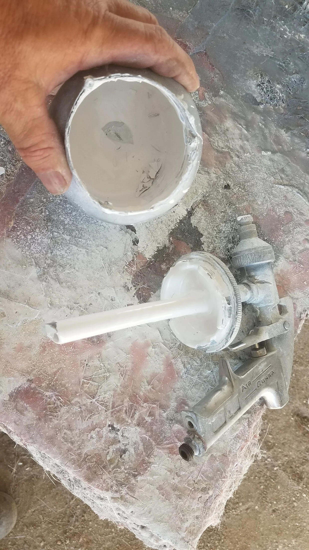

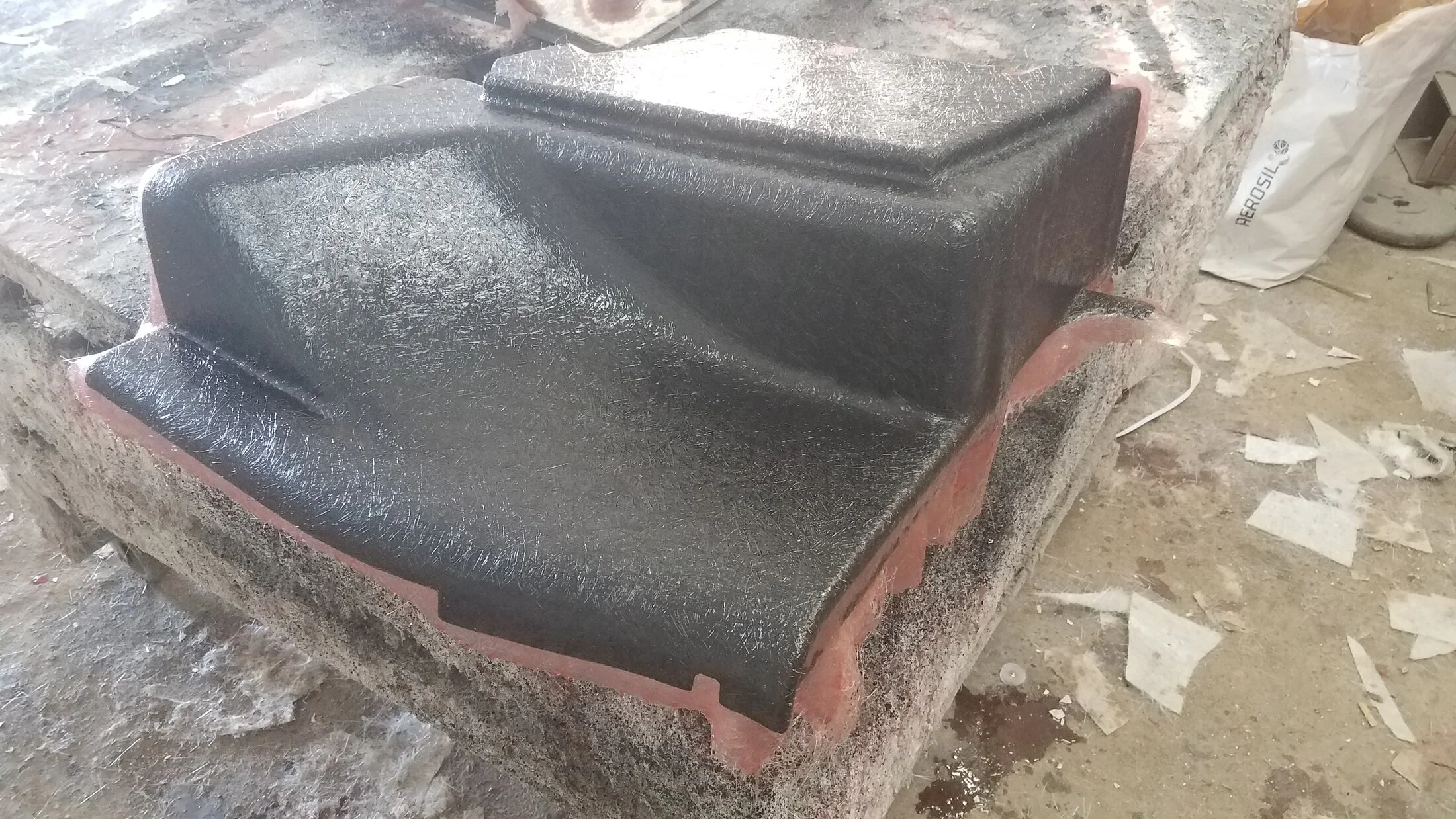

Waxed the parts and sprayed 3 coats of mold release . Damn! I forgot to clean out my gelcoat gun the other day now it is junk ! Looks like a new one in the near future .

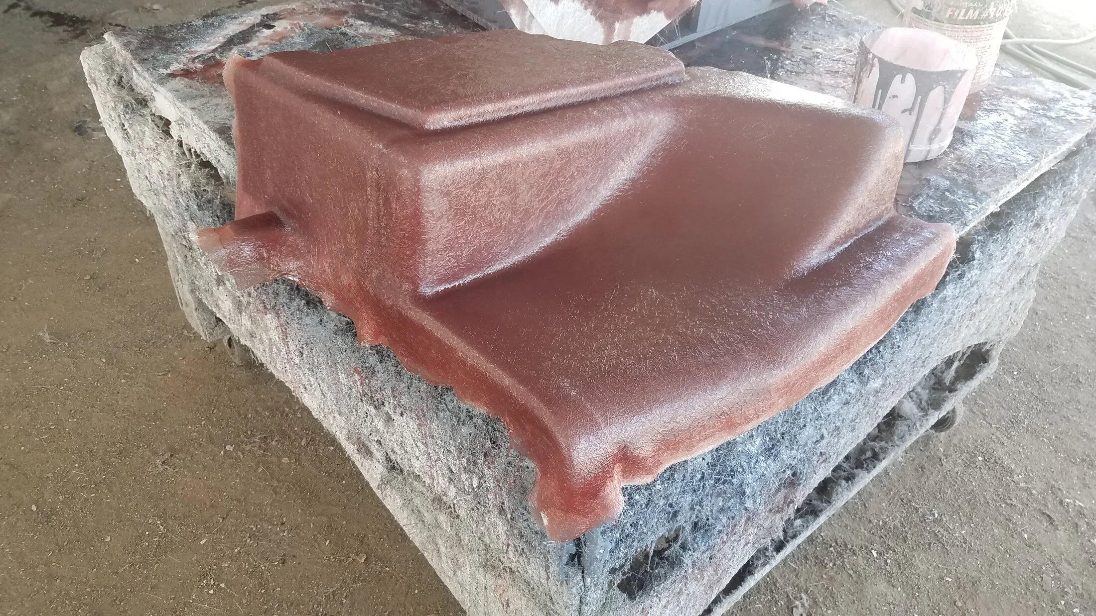

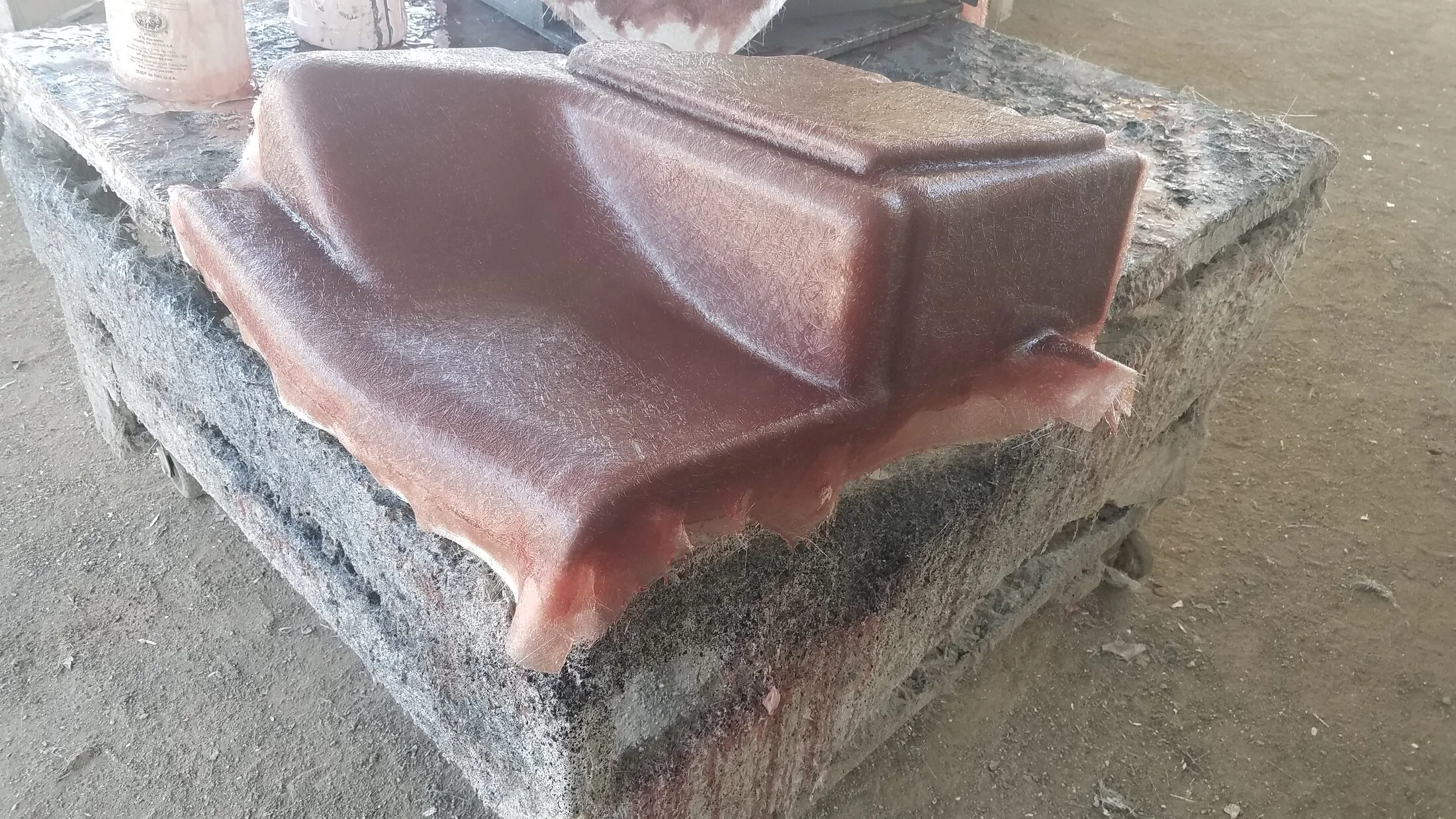

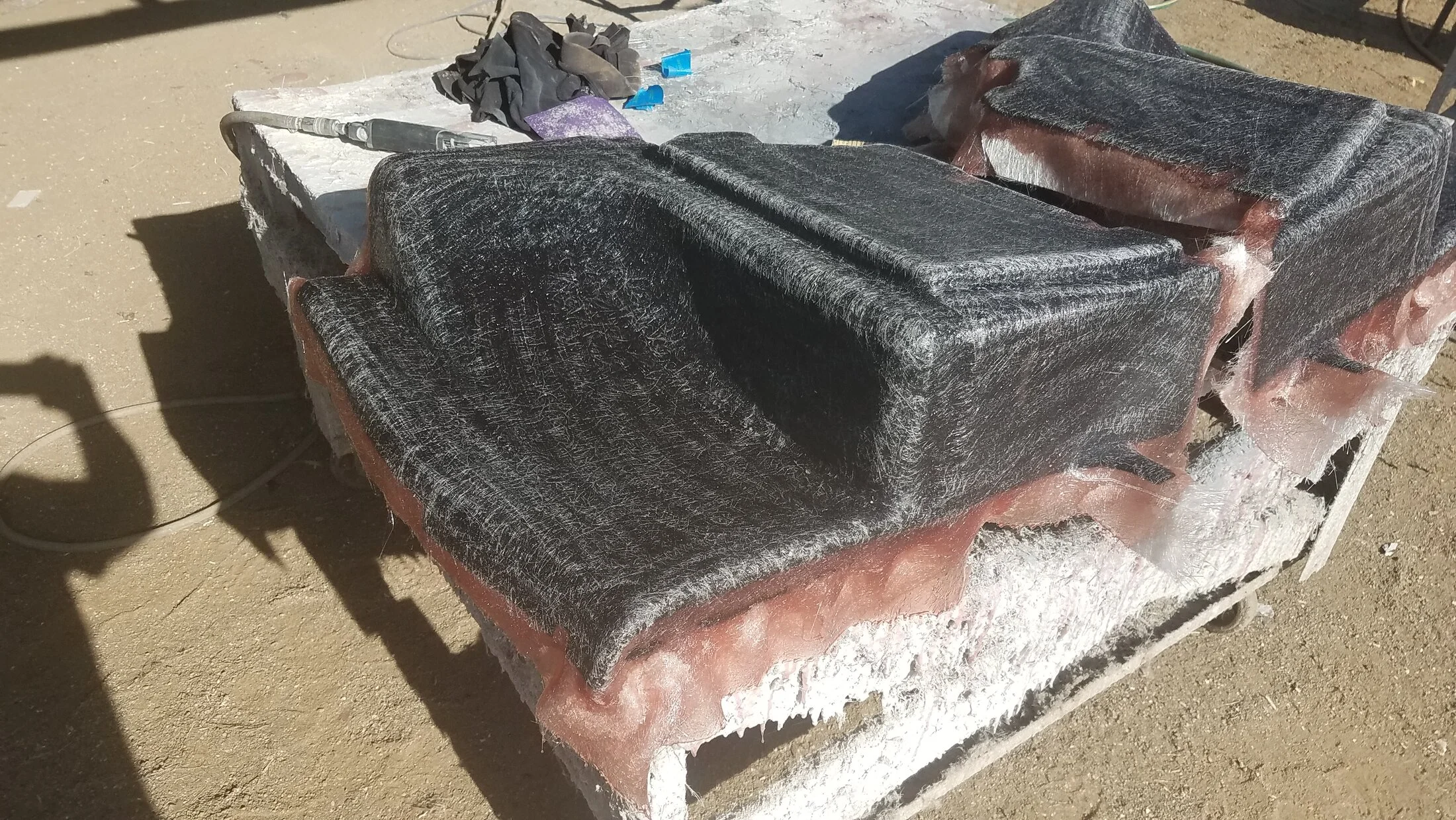

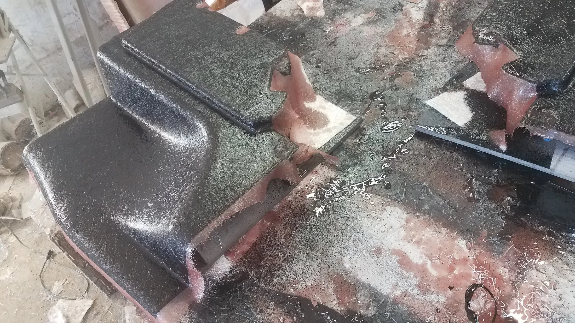

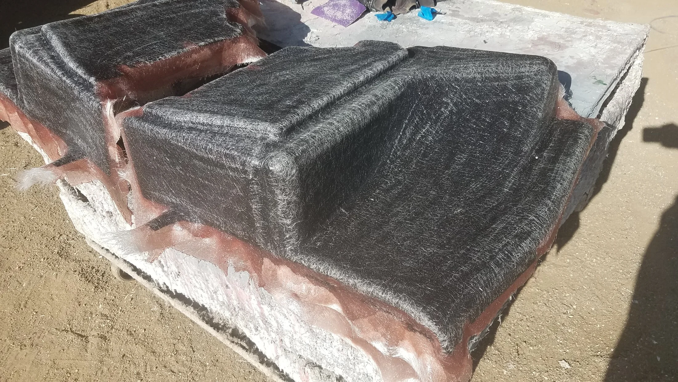

One layer of matt today and probably finish up tomorrow ,and if no more problems i will have new molds next week!
  • Dislike
Reactions: 2Blue2

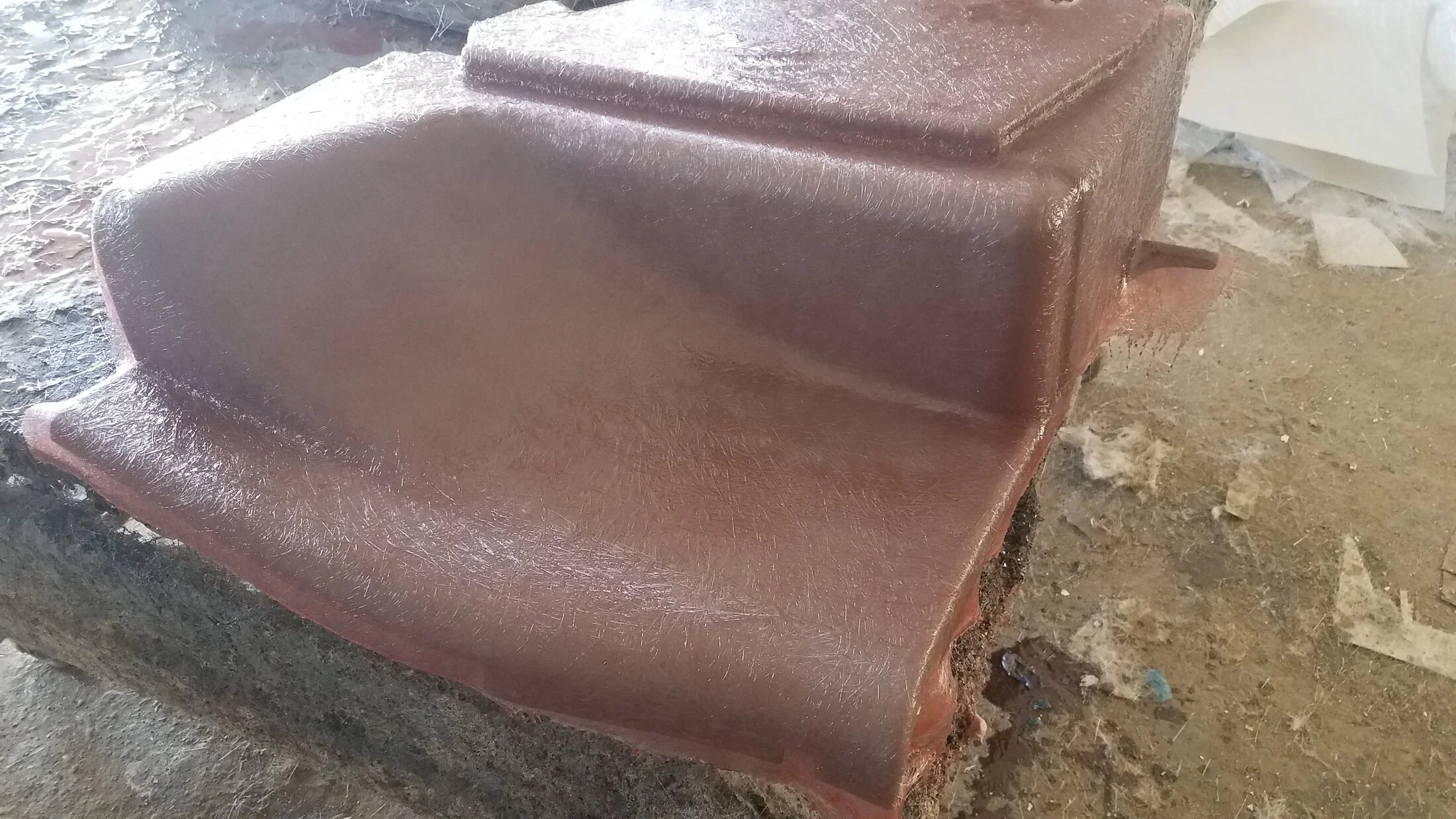

The panels are glued to a plywood and pine board backing so they do not distort as i lay up the fiberglass mold . The mold will be 4 layers of 2 ounce mat ,should be close to 1/4 inch thick
Will you be building more support for these molds?
How many can you pull before major repair is needed?
