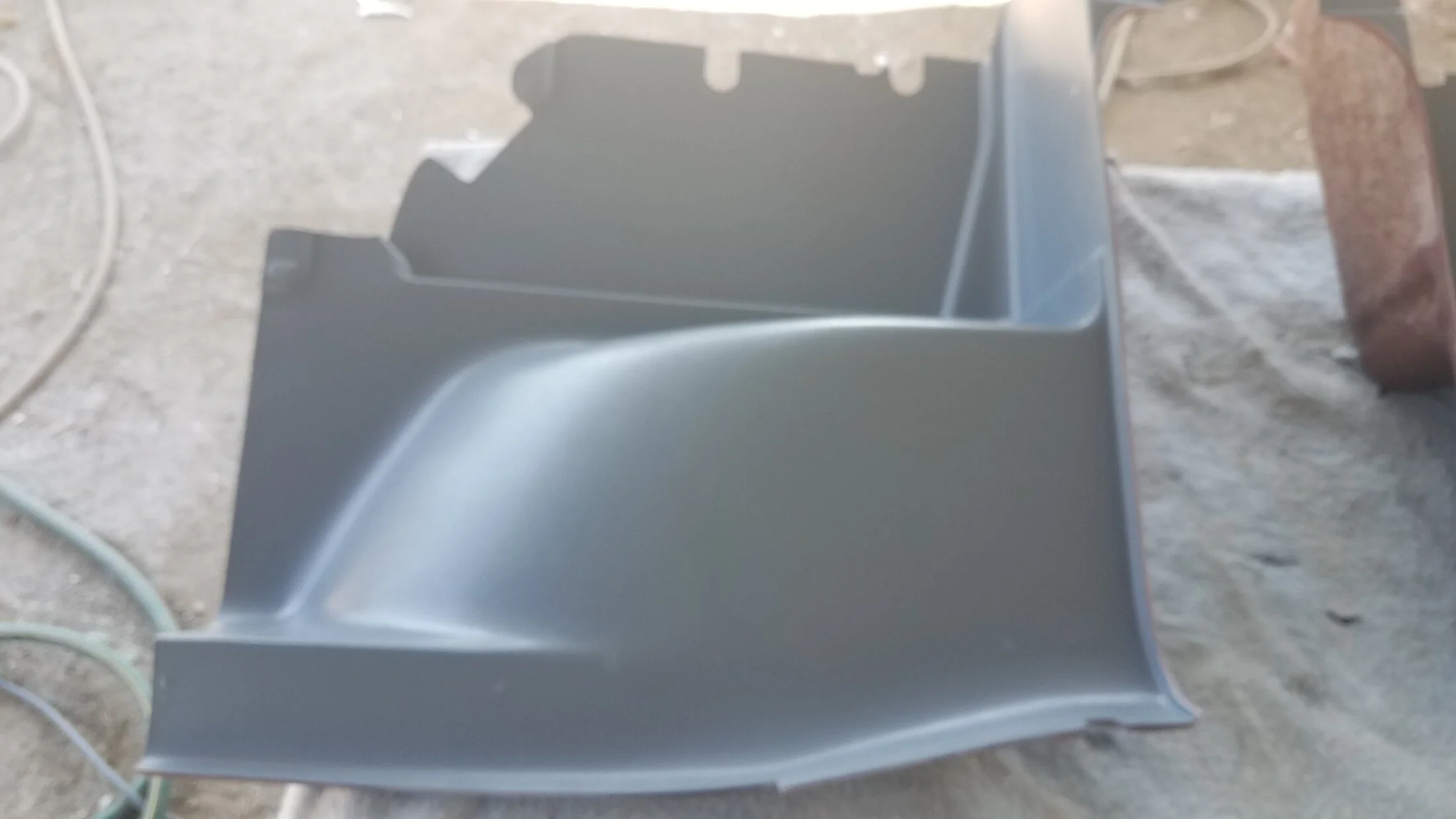

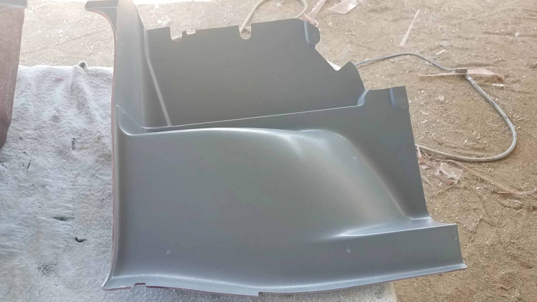

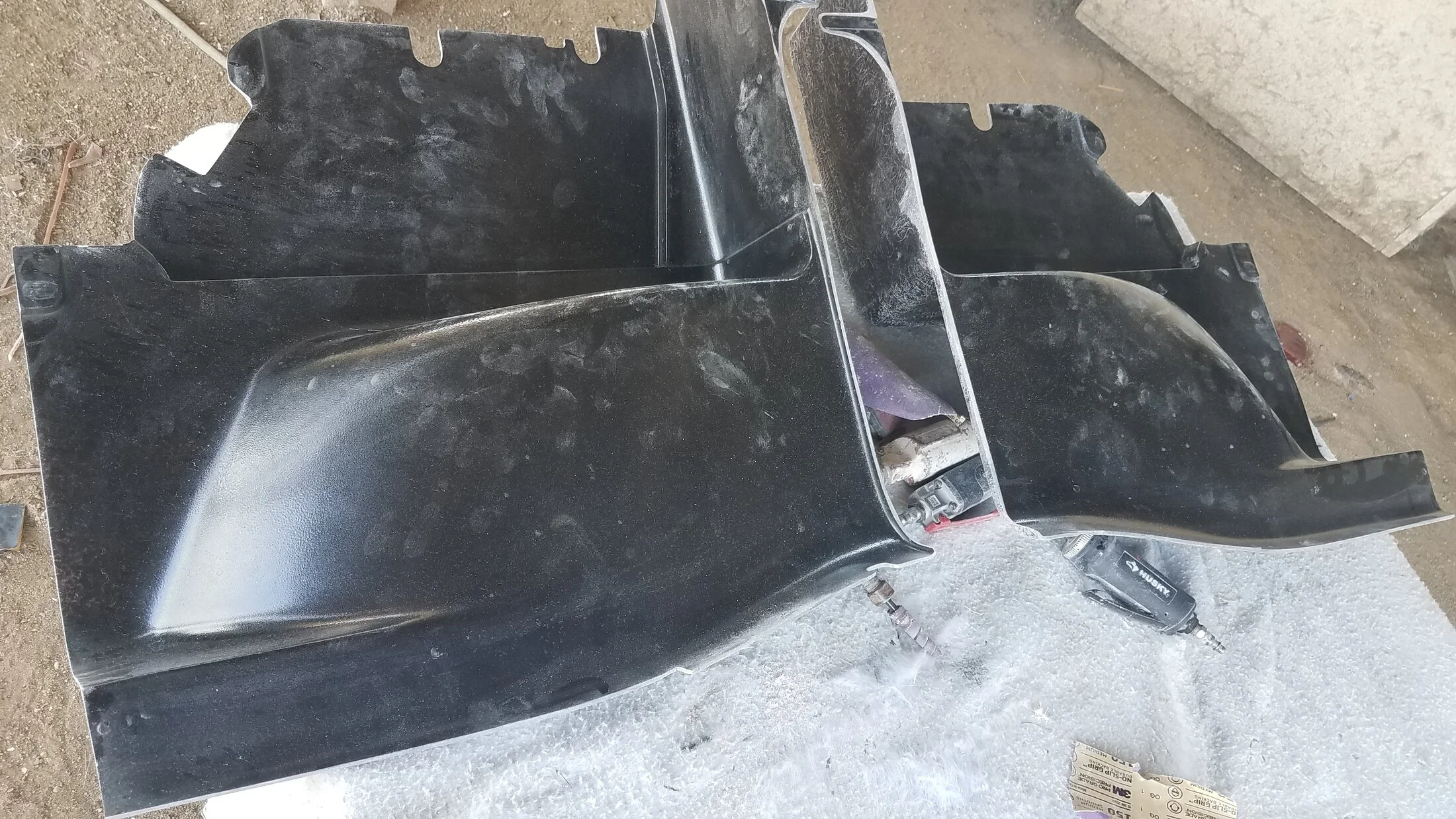

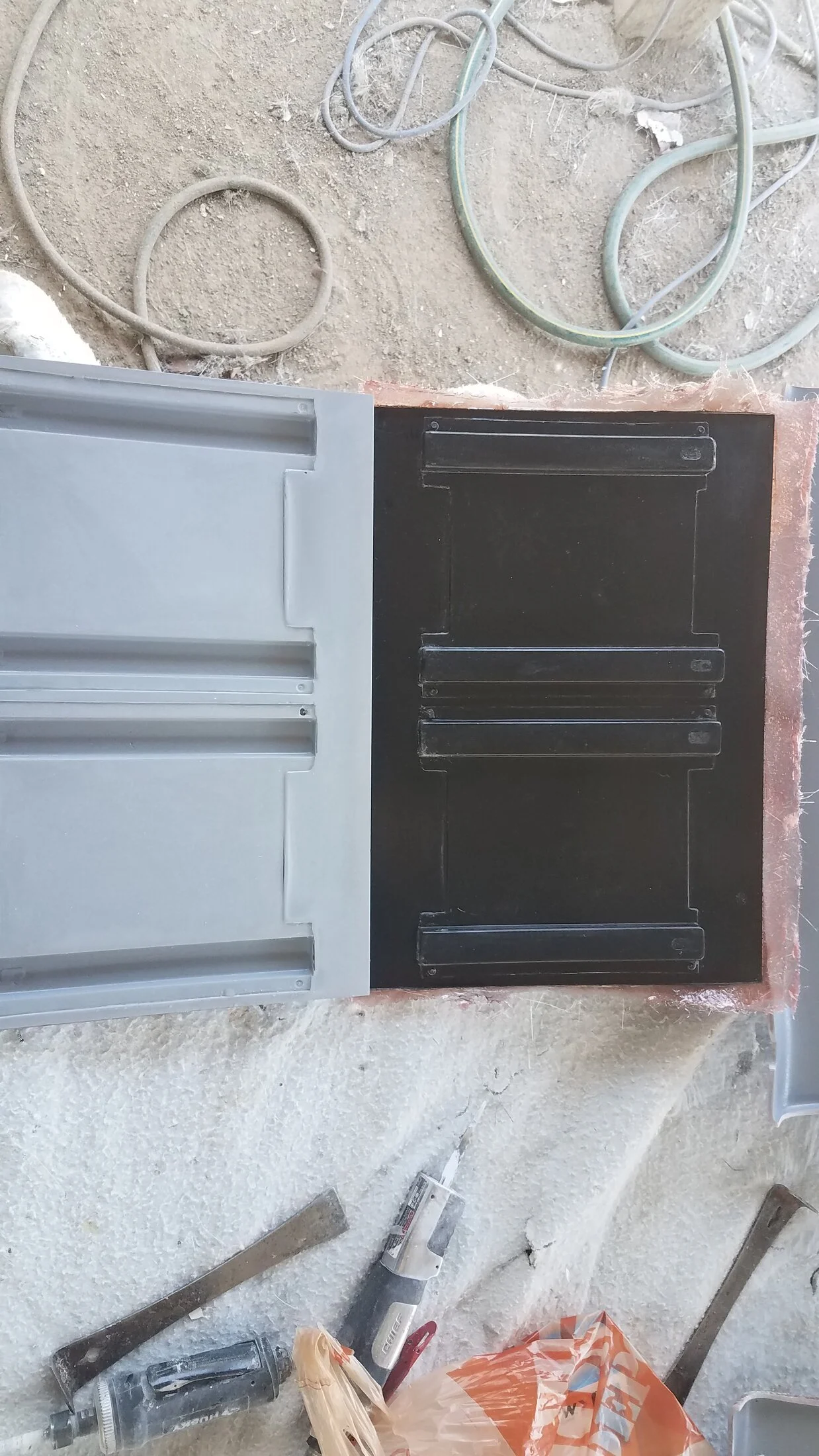

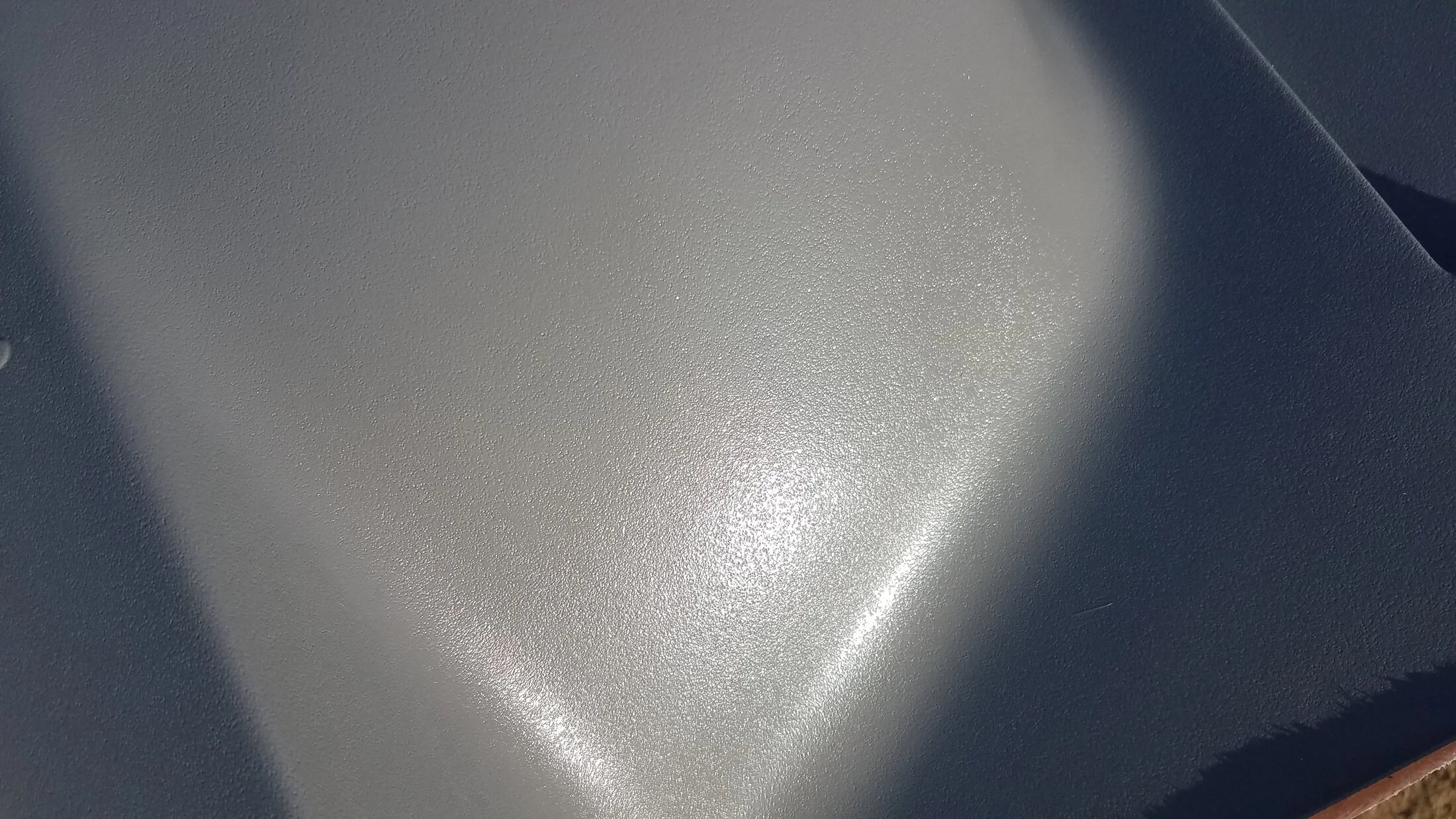

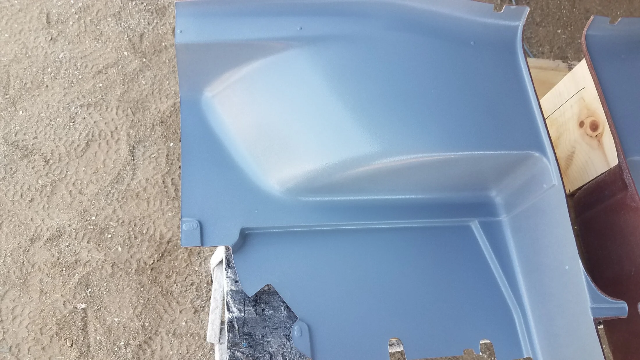

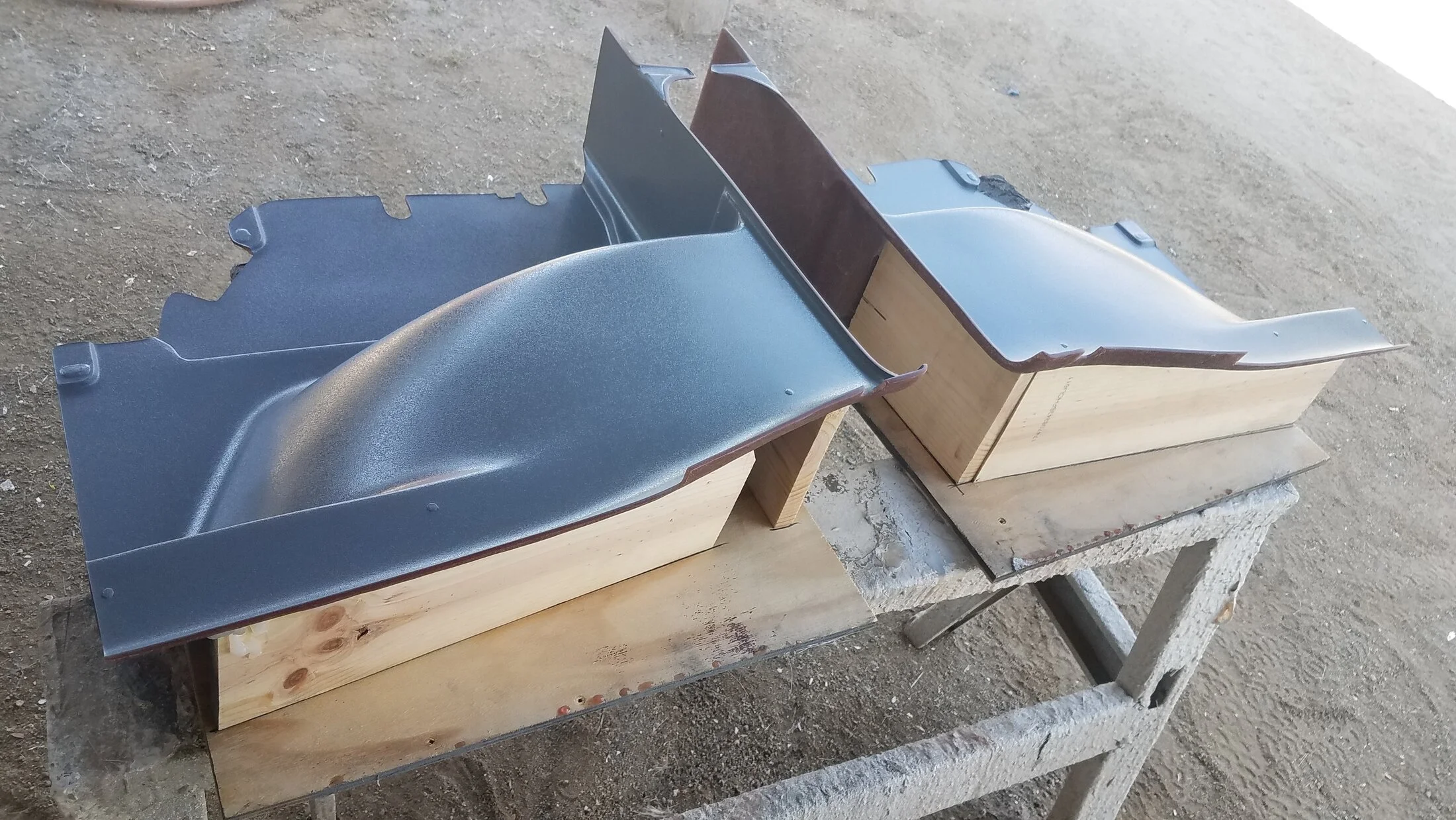

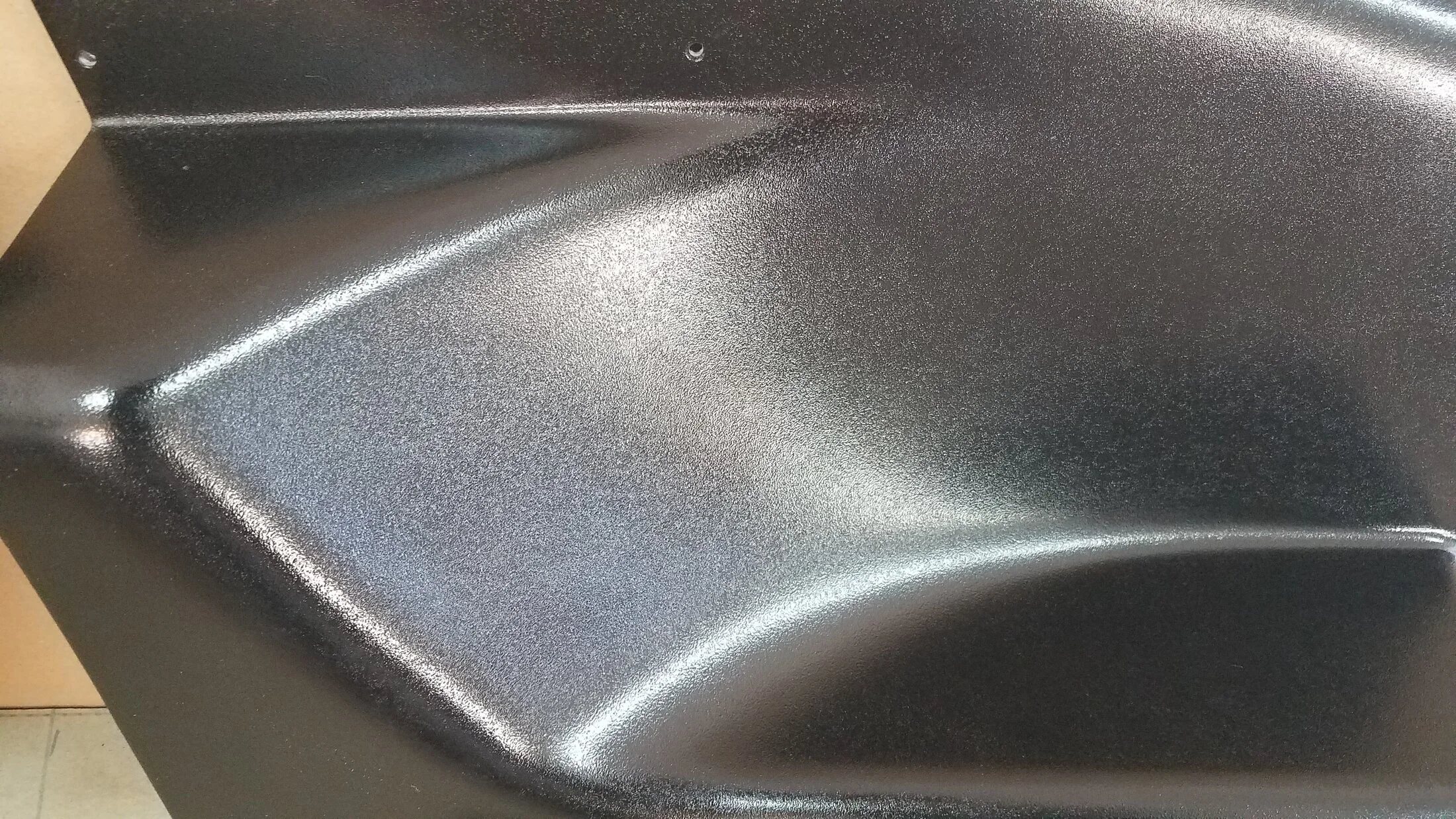

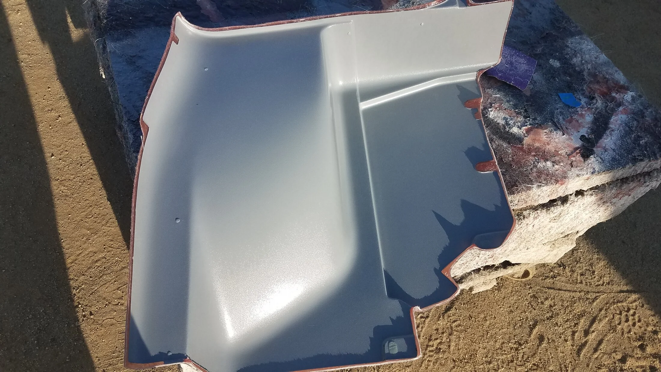

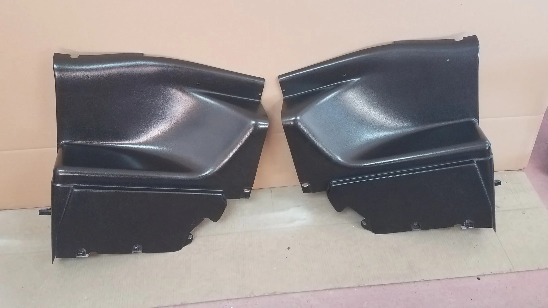

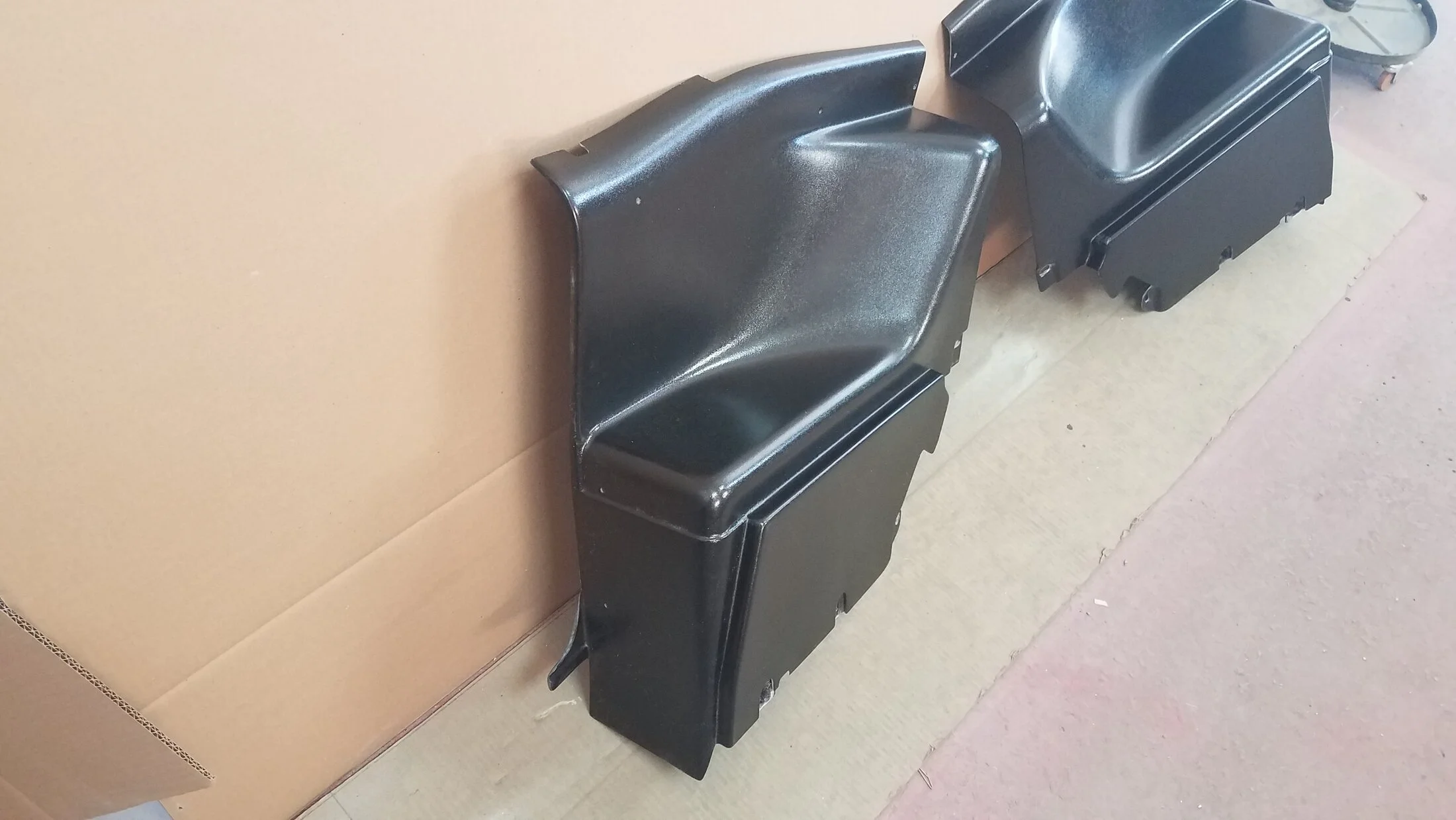

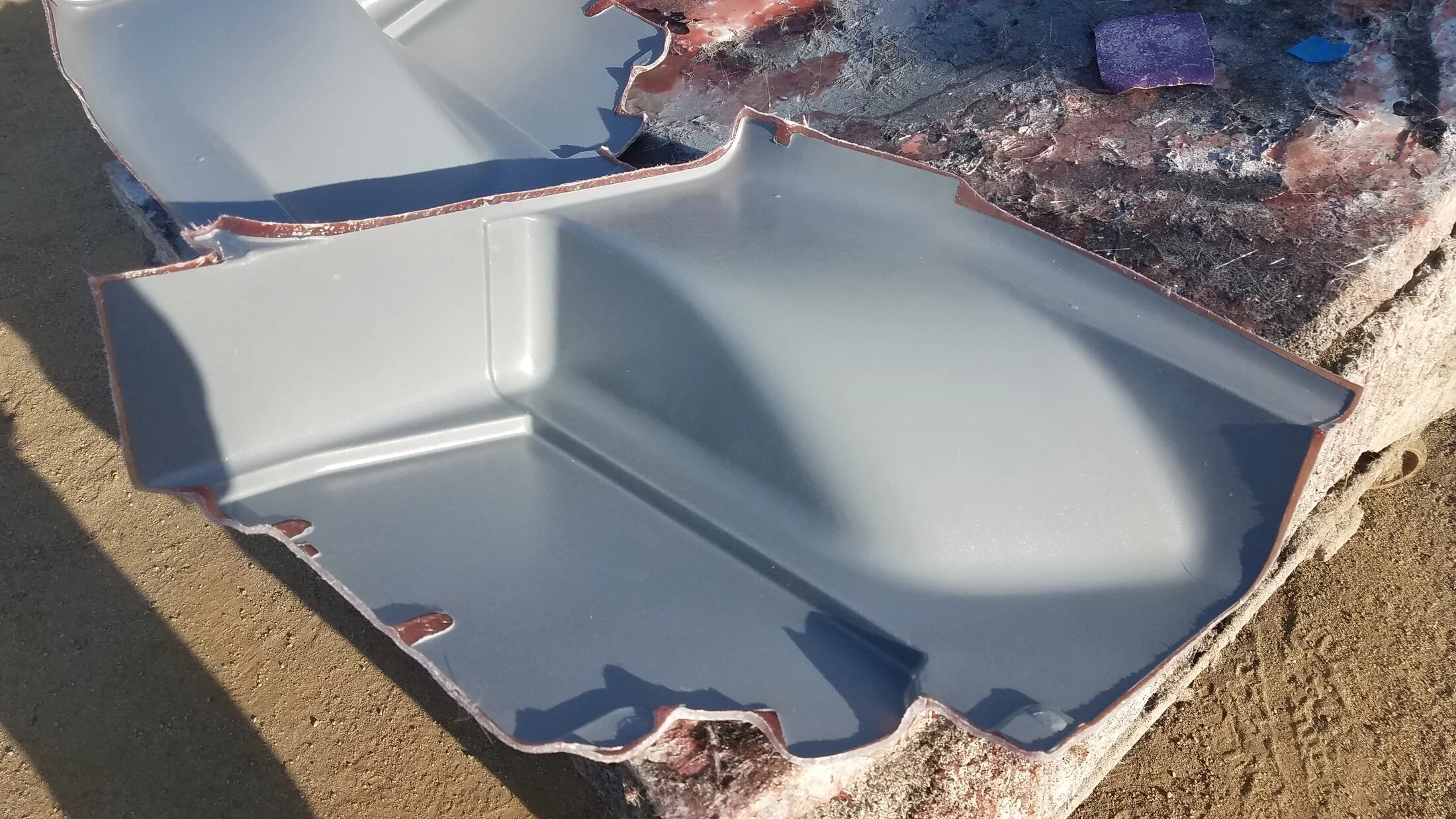

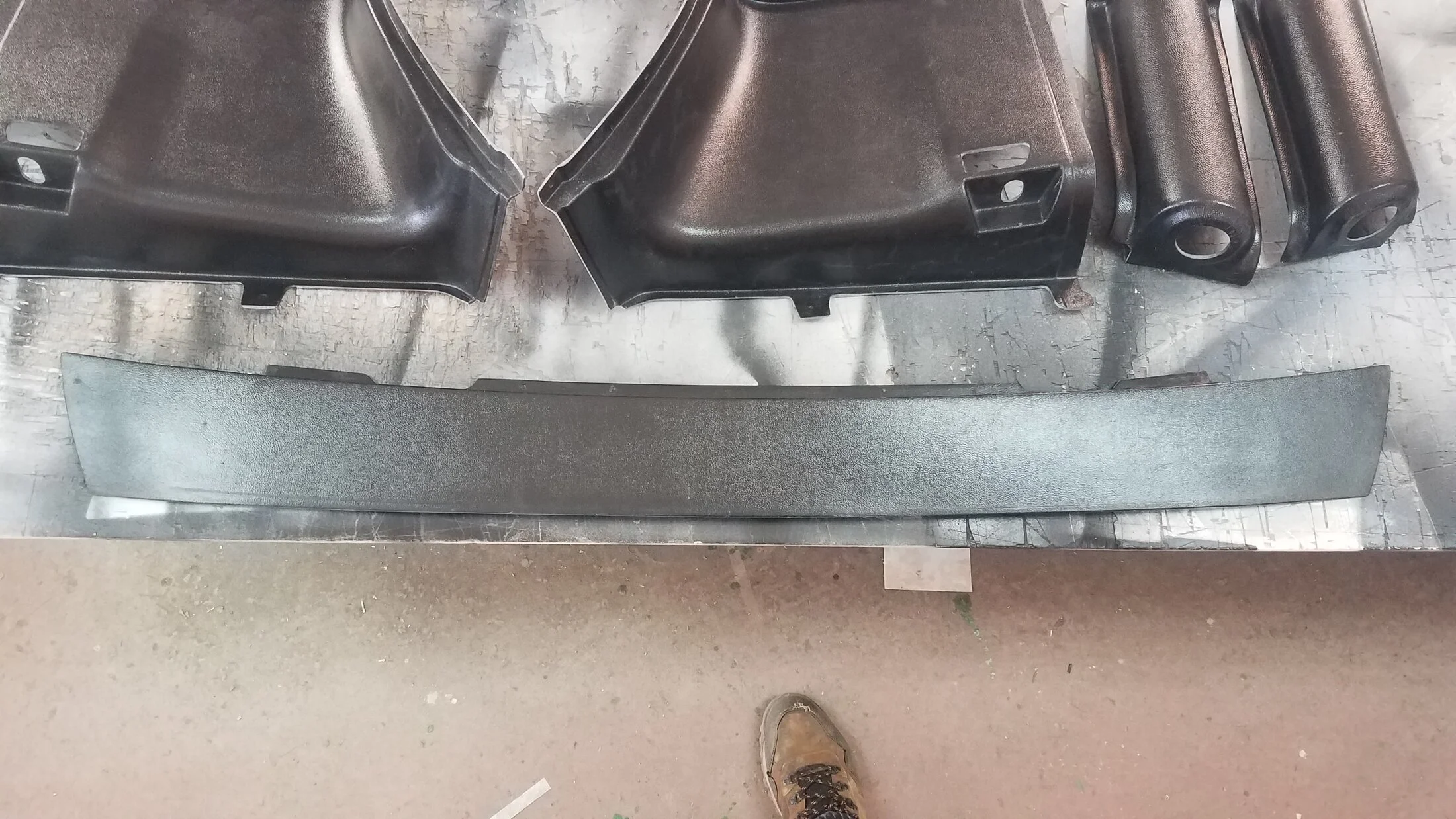

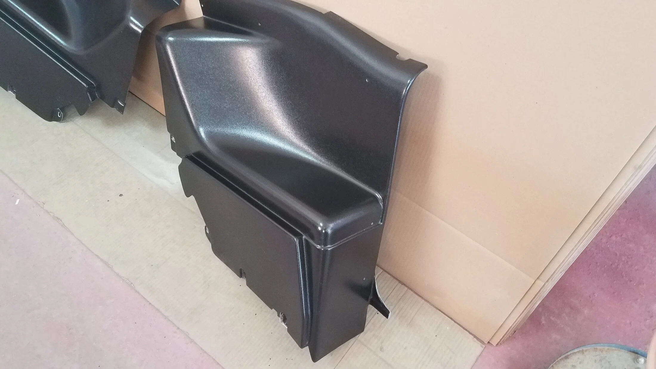

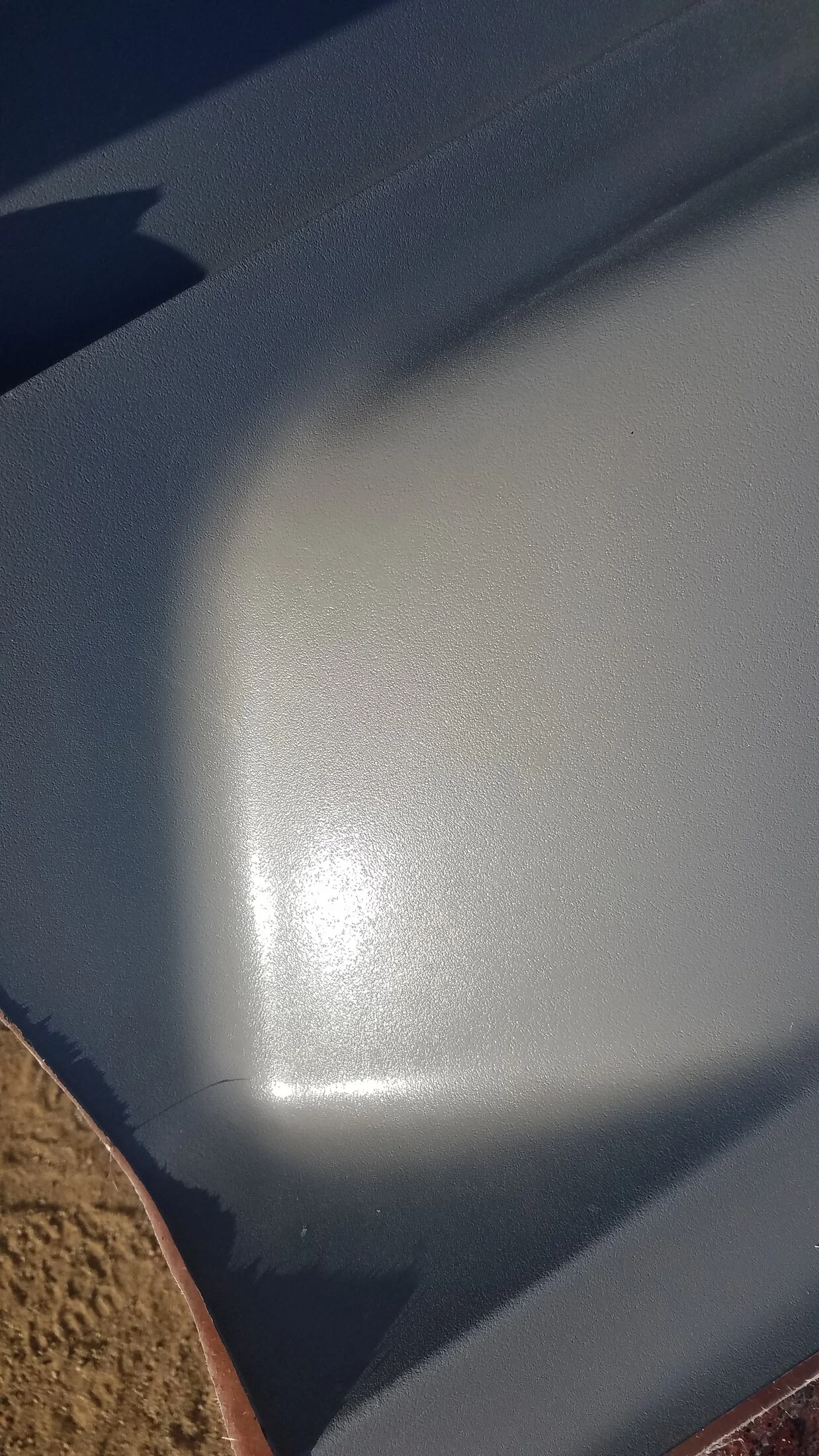

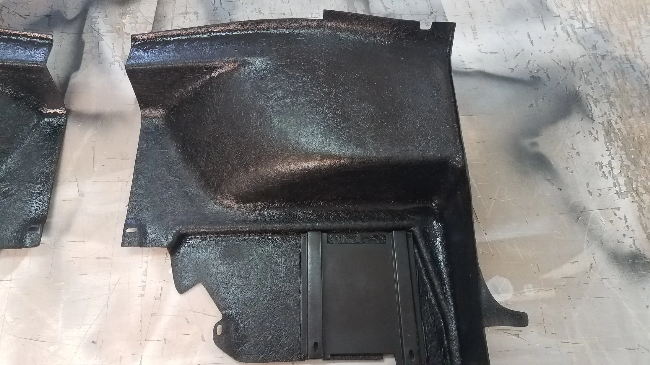

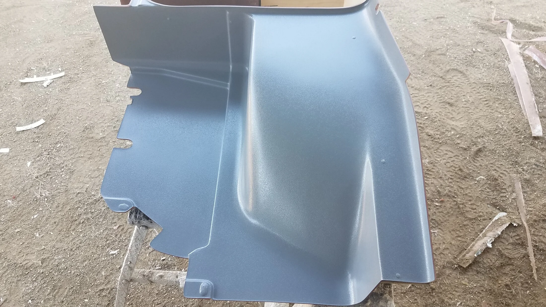

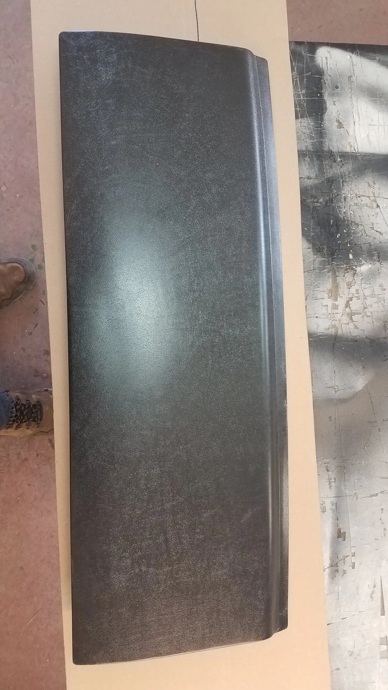

Close trimmed the mold and popped the panels out ,this time i am happy with the texture ,of course it is a reverse image because its the mold but it came out fantastic.
I just have to finish trim ,mount to a backing and wax and they are ready to use .

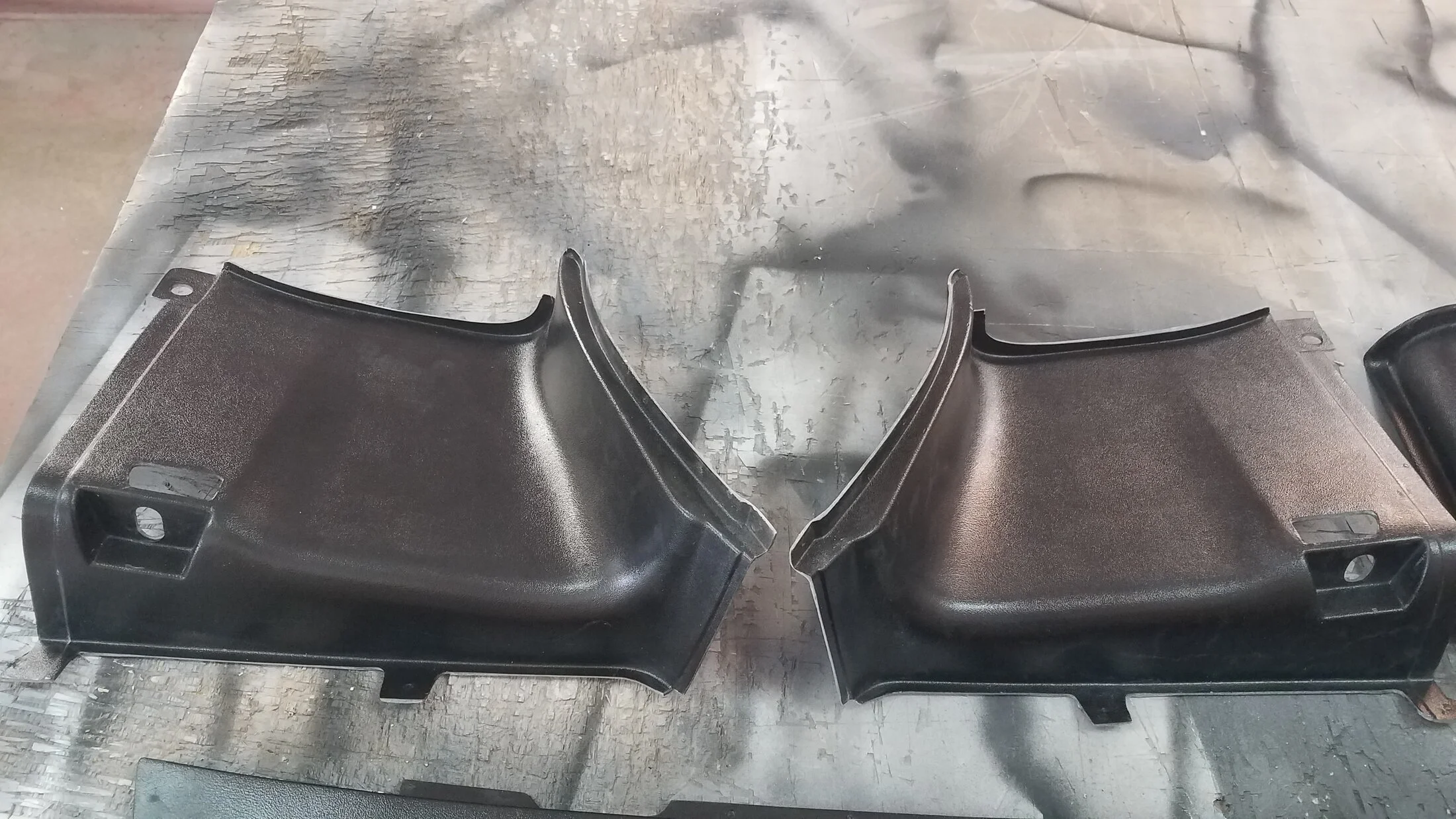

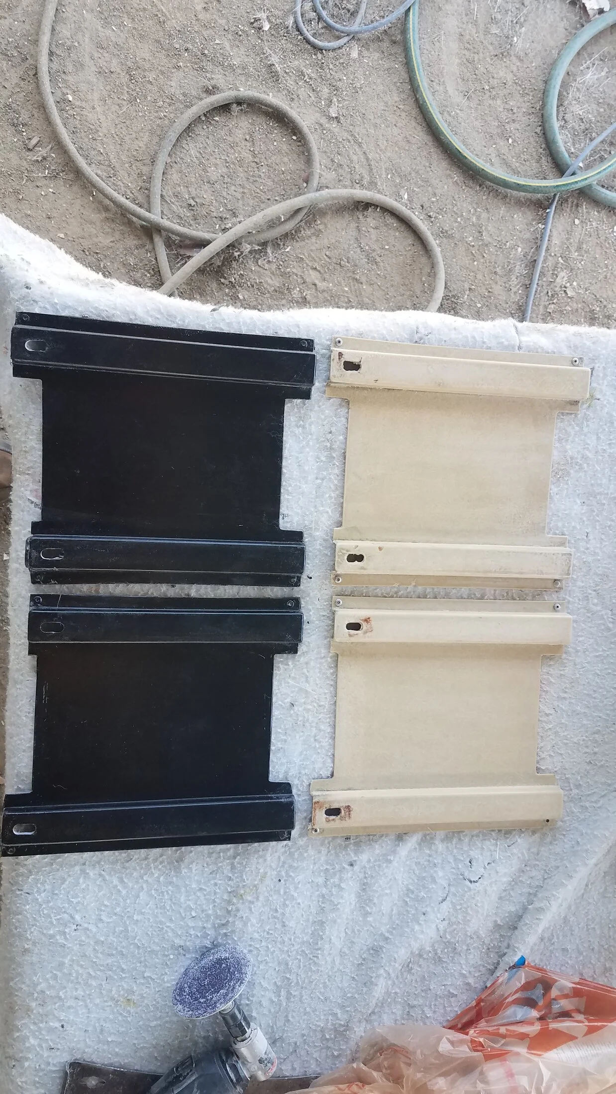

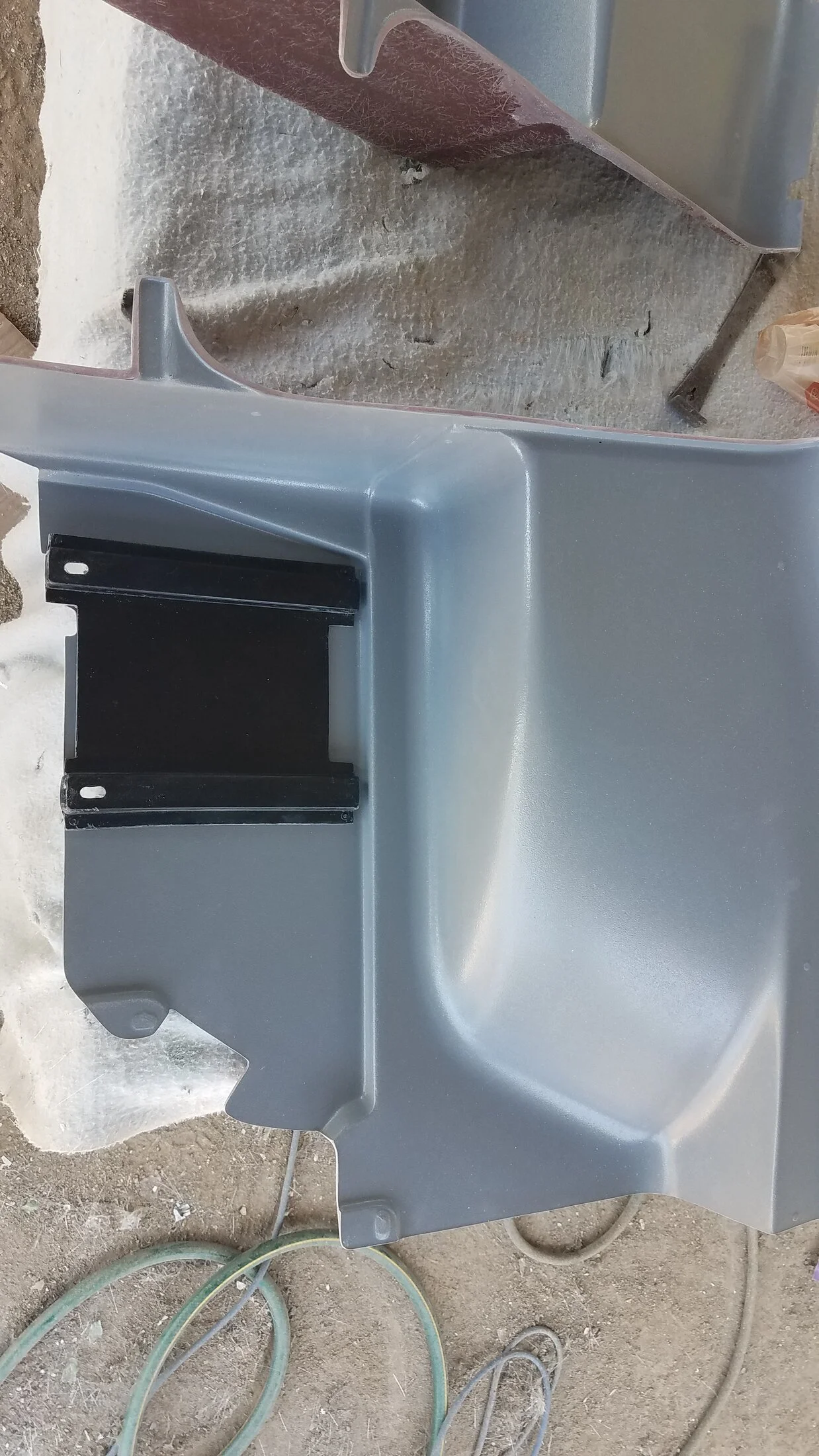

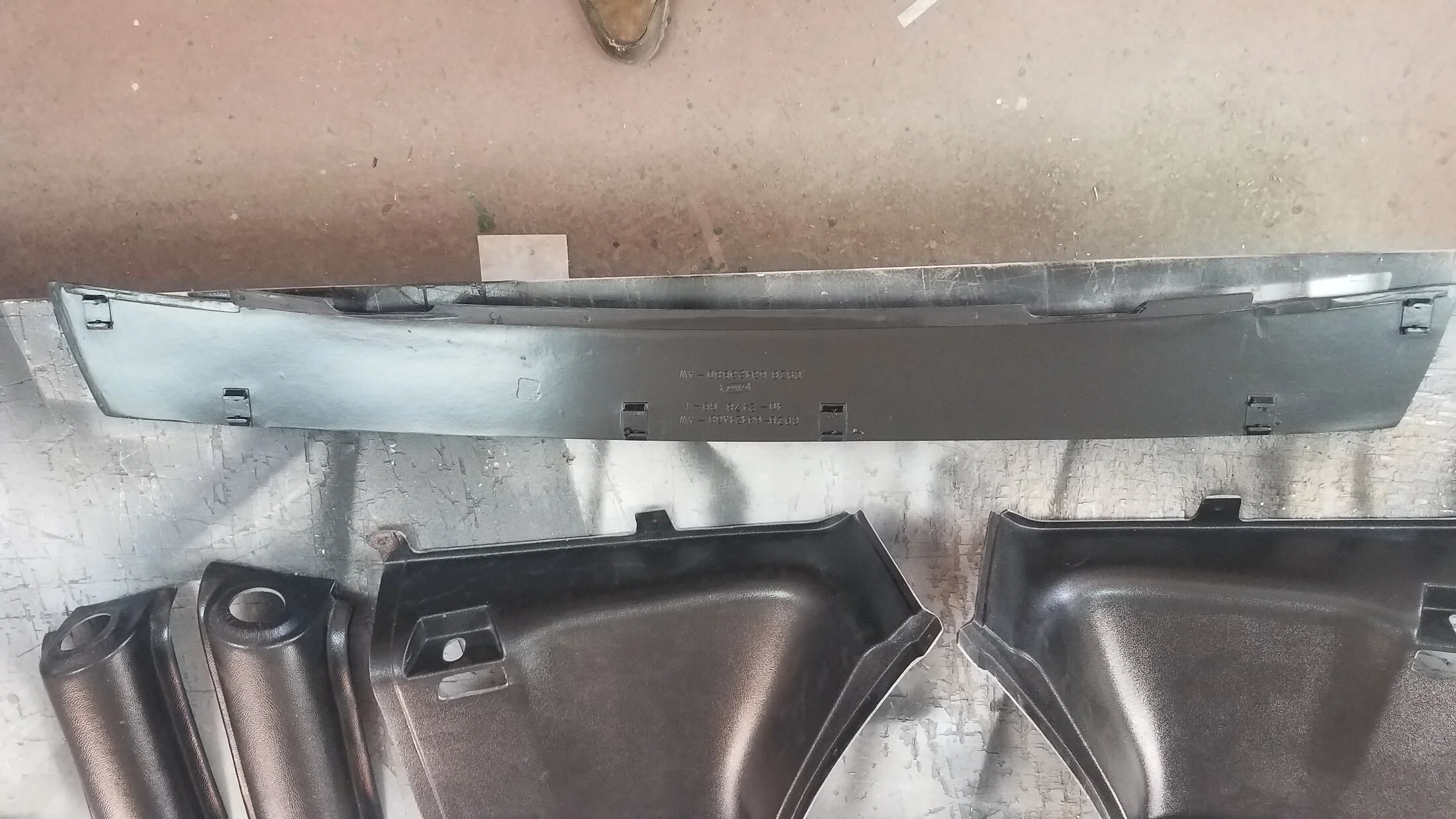

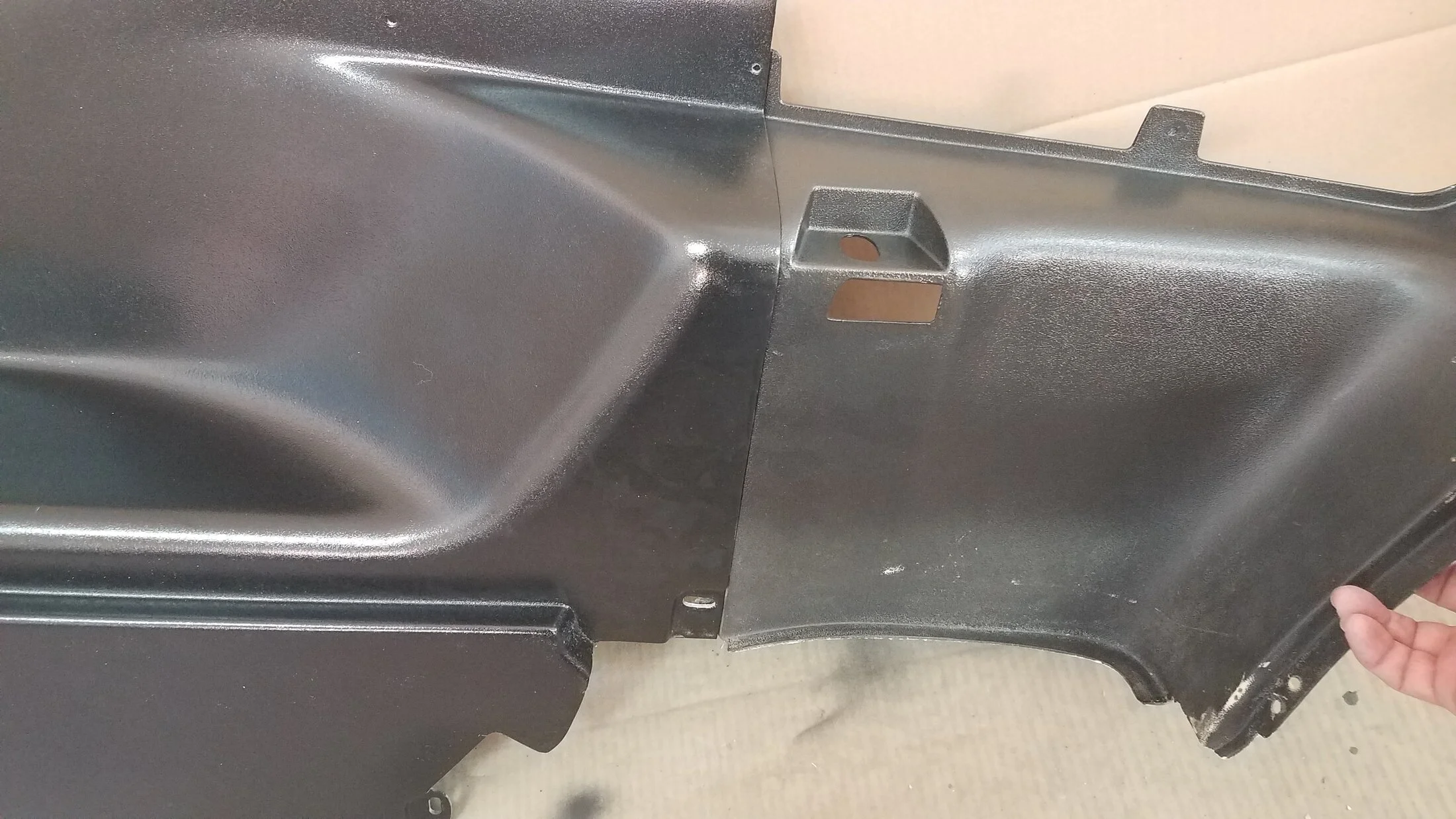

The front and rear pieces are hard plastic. The three center pieces are a more flexible plastic (I don't think rubber).
The center OEM pieces have a metal backing on them but I don't think that would be necessary for repros (I think this was not only for attaching but helped keep its shape over heat cycles etc.)
The front and rear pieces have attach points and use hardware but I don't remember them exactly off the top of my head.
There are replacements available for the Aero Nose but not pre-86. The pattern on them is different.
