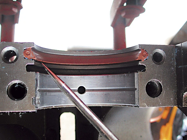

The older blocks look something like this...As you can see there's no way to get to it without removing the main cap.
