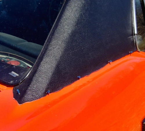

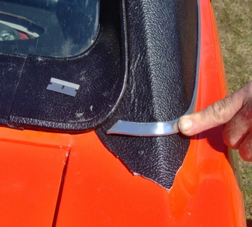

Pictures of trim pieces
I put the blue connectors in the factory drilled holes in the vinyl top.The rest of the pictures are of how the trim pieces fit.

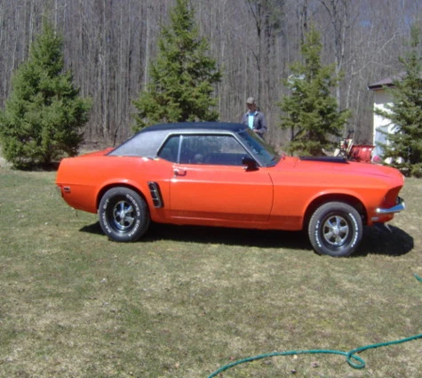

Pictures of car
My son thinks a black rear trunk spoiler would look good.What do you guys think?They are listed for the fastback only in the parts book,has anyone ever put one on a coupe?Thanks for looking 75 mustang II

Bnickle,Thanks for the pictures,Nice car by the way.Was searching e-bay and noticed how all the trim peices came to a point.Where mine are angled and going over the back part.Hard to beleive I can get the same wrong peices from two totaly diffrent parts of the country,Arizona and florida.Read somewhere that someone had some custom made,maybe I should be checking someplace like speedy auto top? 75 mustang II
