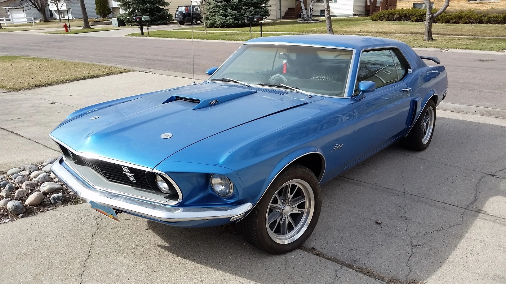

I got my car this way. The back corners of the hood stick up maybe not an inch but is very noticeable. I recently took it to a body shop and the guy said it's because the hinges are bent back by like pushing the hood back while it's open all the way. Like a person leaning on it a lot I guess. So I asked if new hinges would fix it and he said no. How that can be I don't get. He said I'd have to shim up the fenders to get it as close as possible which I'm not gonna do. And to make sure the hinges are bolted to the firewall as low as possible. Like if the bolt holes are elongated at all for adjusting. And of course he didn't want to touch it. Any ideas about replacing the hinges?

I think you need a second opinion from somebody else.. If you wiggle the hood up and down while it's open, do you see any play in the rivets or flex in the hinges ? Have you tried to adjust it any ? Can we see some pics of the car with the hood closed ?
The hinges are mounted solid. I've been trying to track down more local classic body guys. Got some leads. I loosend the bolts on one hinge and it's as low as possible.
If that hood is bent it doesnt show it from the top. Lower the hinge all the way to the bottom of the slots ,Loosen all the bolts but the one in the back down at the fender apron,but dont make the back bolt really tight ,lift the front of the hood and watch for the hinge to lift at the front and tighten the bolts while you are holding it up and carefully close the hood because it may have shifted back and may hit the cowl .Lifting the front of the hinge will lower the rear of the hood .If the hood did shift back loosen the bolts directly at the hood and slide it forward until you have the best gap between the hood and the cowl . Lifting the rear of the hinge raises the back of the hood .

I agree that the hood looks good. You should be able to get a lot of that out with adjustment. Lay some wide painter's tape over your fender and cowl edges to help keep chips away while you get your hood gap adjusted right. That's a sharp looking car by the way.
